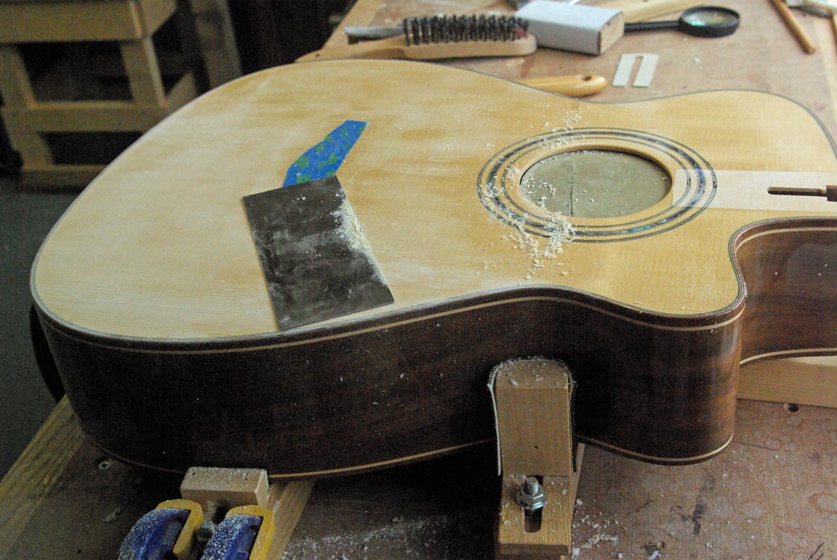

I had to remove a bridge and made a bit of a mess so decided to refinish the top. (I wasn't too happy with the finish anyway)
And Gosh it's hard work isn't it! The nitro had been on for a while so was fully hardened and it's tough stuff. Welcome I suppose in terms of wear. It has also demonstrated that I am definitely putting the stuff on too thick.
It is also improving my performance at sharpening scrapers!

I've taken the nitro off a few times on the last ones i tried to spray but was it new and soft so was fairly easy. So now I've swapped to FP i only have to brush it with a fingernail and i have a scratch while its freshly done.

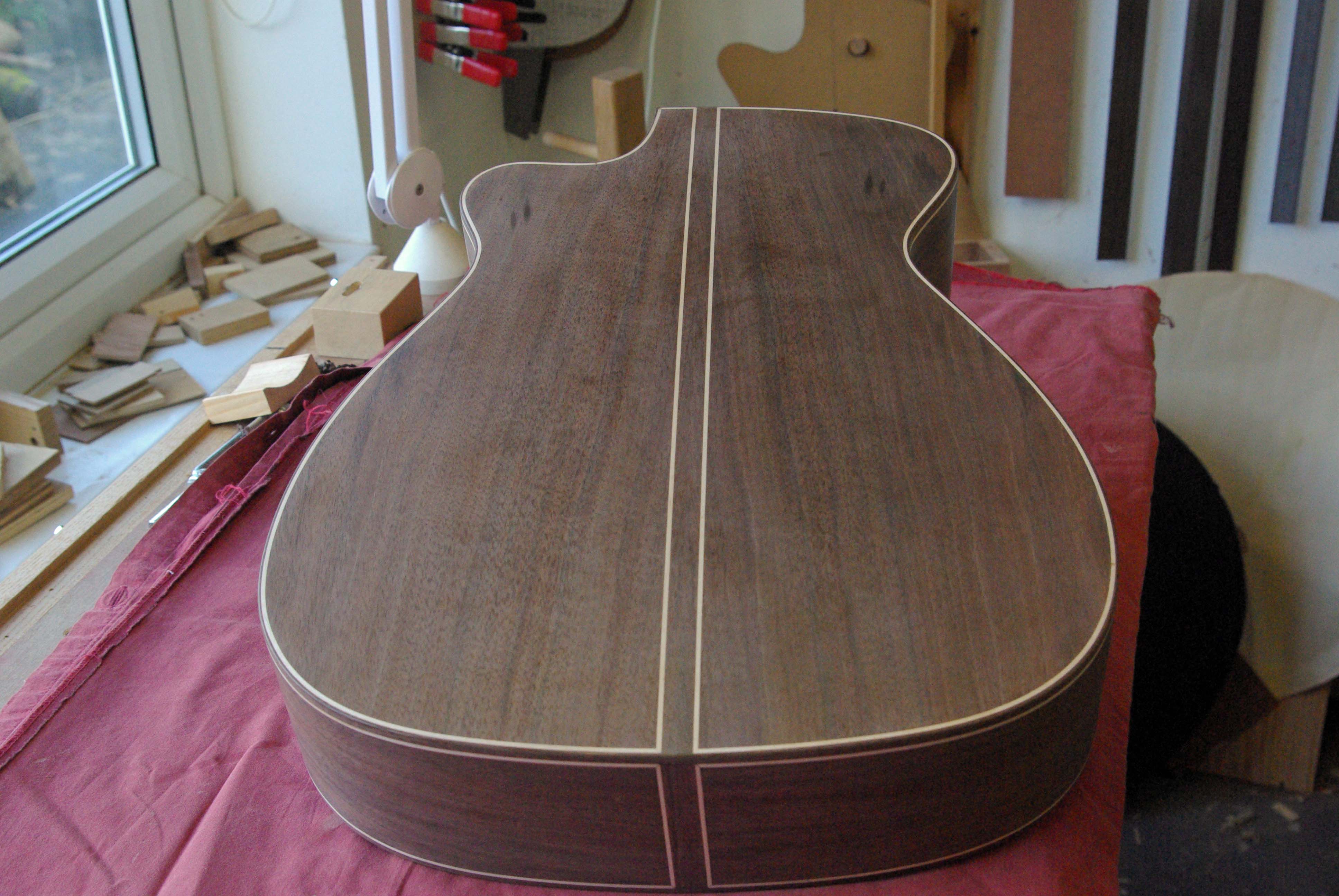

Richard I go for nitro for it's wear resistance, this one in particular being a steel string.
The binding is made from strips cut from the side so is a good match. The purfling is maple, cut roughly to size on the bandsaw then taken to size on the thickness sander. I keep trying different binding/purfling schemes and on this one I specifically wanted to separate the two halves of the back given the dark and relatively plain grain of the Walnut. I would probably use a thinner line on another build though I am pretty happy with this one.

I think that thicker light line looks great Dave. You've "nailed" it!!

I like the jig for holding it down on the bench, what a great idea!

I make no claims Cutty. It is Trevor Gore's design for a cradle for use with the binding channel router jig. The idea to use it finally came to me after I had chased the box around the bench for a while !
