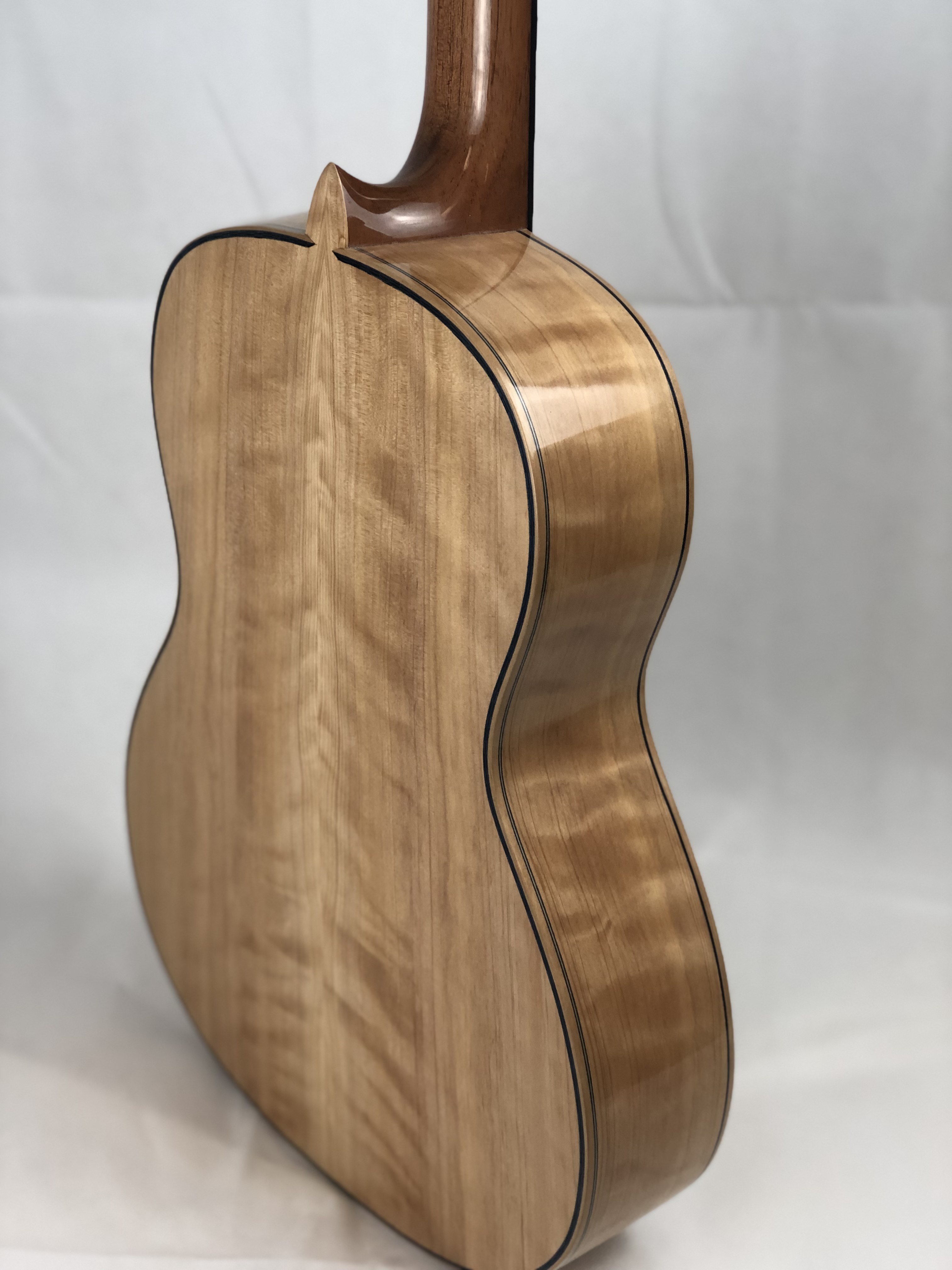

I also recommend Robbie's course, I now used a bit of a blend of Robbie's method and Trevor Gore's azeotropic hard shellac method and am finally happy with my FP
Re: french polishing courses/tutorials?
Thats a pretty nice finish.
