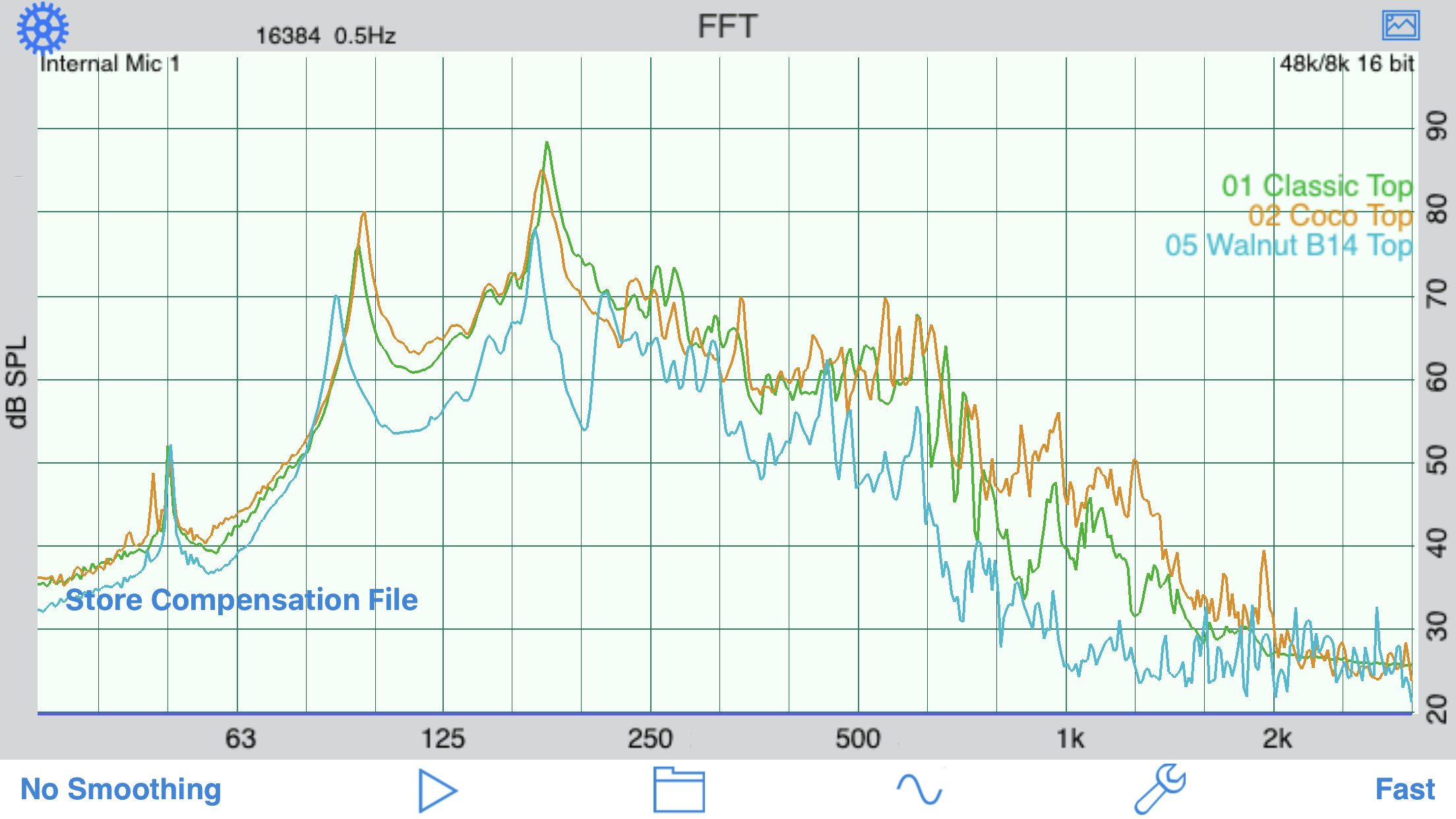

Like many on this forum I have built beautiful instruments that sound amazing.
Like many in this group I have spent months on a guitar and wonder in sadness why it sounds like a shop bought guitar or worse.
Attached is the sonic signature of 3 guitars all the same model but different woods, large body steel string, X-Braced.
01 Classic - Well rounded mellow, gorgeous sound
02 Cocobolo - Very powerful, big and booming, but balanced, sound, great for fingerstyle, love it
05 Walnut - Lacking any real complexity in the sound or joy in the playing - built with a live back.
The three graphs were all generated using the same method, 20 taps to the bridge pins and bridge at slightly different angles, averaged.
The graph for the 05 Walnut is markedly different, less amplitude across the frequencies, T(1,1) monopole levels all shifted down a few Hz, but I also read, perhaps significantly, much less ability to generate tones in the 600Hz to 1500Hz range, which may be reflecting its lack of complex sound.
So my question, is this graph a smoking gun, can it be remedied?

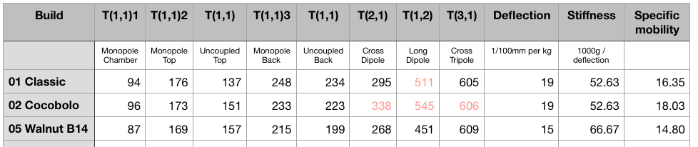

Would you mind listing the T,1 T,2 frequencies please. It might be good on this forum to have a standard for X and Y axis when posting Visual Analyser type images...I usually copy the graph, then use 'paint' to insert text above the peaks so that there is an immediate frequency read for every peak on my saved Visual Analyser images.-Ross

Hi Ross
If you think it might help here is a table with the frequencies taken from the graphs. The numbers in pink haven't been verified by use of Chladni patterns yet.
The specific mobility was also measured similarly for all guitars on the same day. Whether the calculations are correct I just don't know.

in my limited experience, those monopoles seem rather low...Ross
Do you mean the ones for the 05 Walnut weak sounding guitar or in general across all three please?

The weak guitar does have lower monopole frequencies. I don’t quite know why. The soundboard was thicknesses according to equations as opposed to look and feel and sound. However the bracing was optimised by sound and feel the same as the others.
Could it be that the top was thinner than the other making it more responsive to lower frequencies and less responsive to higher ones?

Post by Trevor Gore » Fri Sep 04, 2020 8:39 am
The figures from the walnut guitar seem to imply it has a heavy bridge (relatively low T(1,1)2, relatively high stiffness). A heavy bridge would explain the lack of excitement in the sound, as it will be less responsive to higher frequencies. How heavy was the bridge?

Post by TallDad71 » Fri Sep 04, 2020 6:11 pm
Thanks for this Trevor. The bridge weighed in at 35 grams, so quite heavy, yesterday I spent some time feathering the edges and back in order to reduce the mass after studying your bridge designs. It hasn’t made a right fat load of difference to the tone to be honest, I haven’t yet studied the monopoles.
My investigation today is based around stiffening areas of the Tone bars and or x bracing in a bid to make the board board responsive to higher frequencies. This is a tricky job for two reasons, one because I’m not a trained gynaecologist and two because I have the largest hands of anyone I have ever met. If you think it’s simply not worth losing the skin on my lower forearm please speak now!

Post by Trevor Gore » Sat Sep 05, 2020 9:47 am
The bridge weighed in at 35 grams, so quite heavy...
Yes, that's over double what mine typically weigh. Is it much heavier than the bridges on the other guitars?

Post by TallDad71 » Sat Sep 05, 2020 7:47 pm
Have you and O’Brien rescheduled your class dates yet from July 2020, early days I guess?
No, not yet. Still too many unknowns, unfortunately.
The bridges are all identical, made of Ziricote, as they match the fretboards beautifully so that's not necessarily a factor between the three.
I guess the difference in mass in mainly down to the densities of the wood, compared to something like Padauk, there's always be a trade off of form over function I guess. My second build had a Padauk fret-board and bridge, it reminded me of a ginger bearded Scottish highland warrior fighting the Macdonalds, to be fair it sounded a bit like one too!
