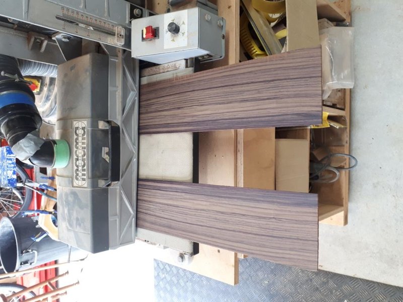

This one is going to be EI Rosewood and Engleman Spruce so more traditional woods. I'm going to try to bling things up a bit as otherwise I find that combination a little boring. This one will also have a bolt on neck a la fender. Feedback I am getting is that it is much better than having a heel. Off we go.

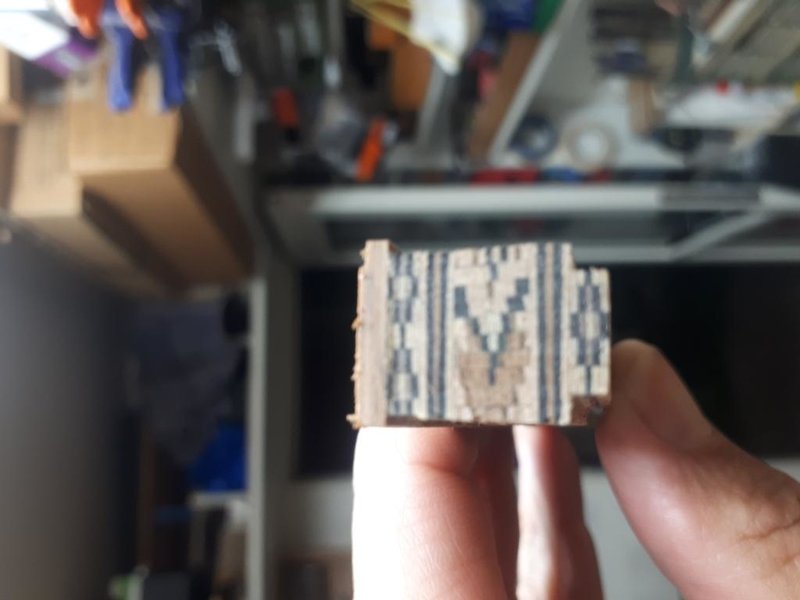

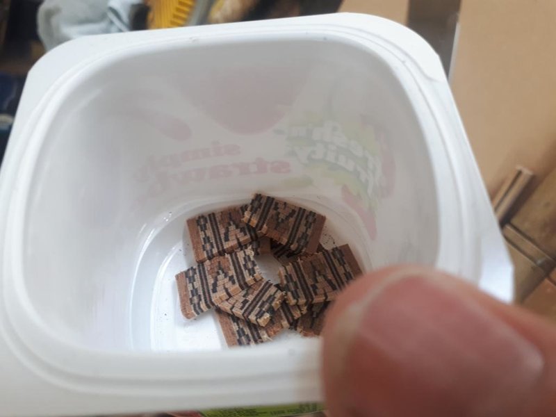

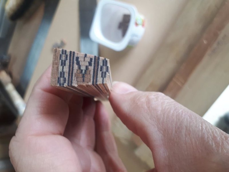

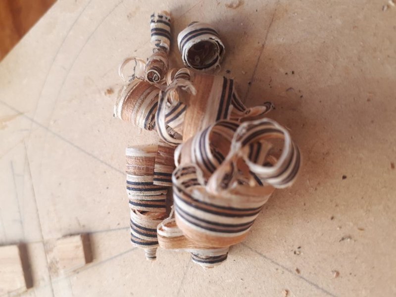

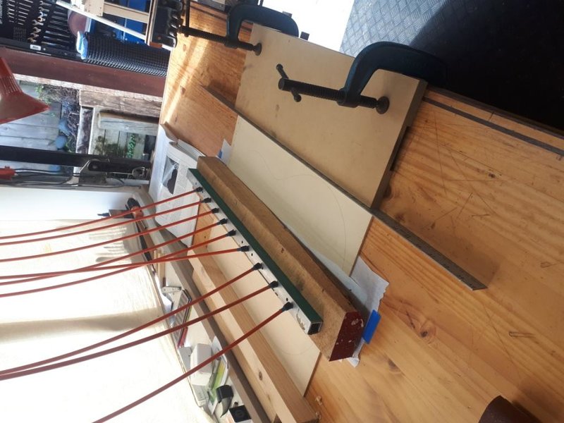

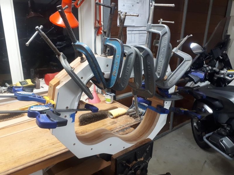

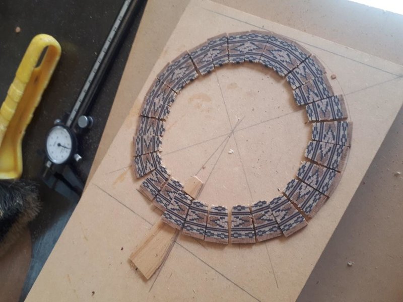

Some progress made this weekend after a few nights faffing with the rosette mosaic block. Thats now done. Nearly 200 pieces of wood glued together.

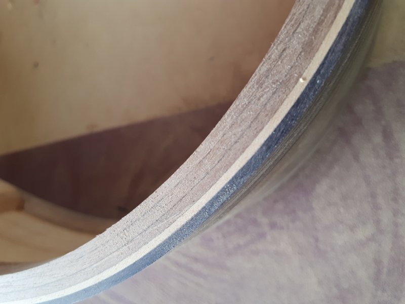

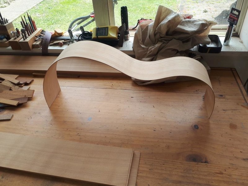

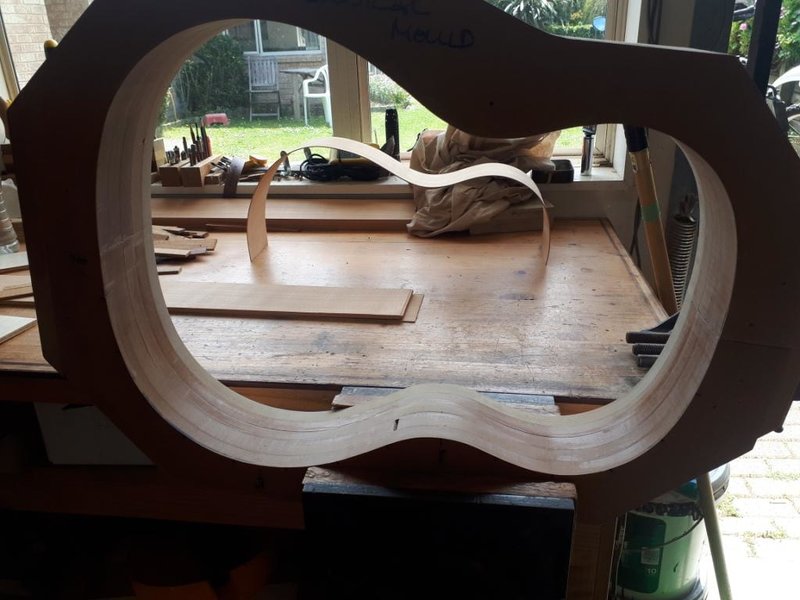

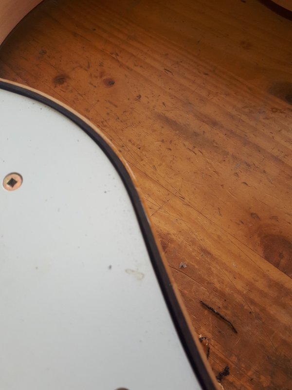

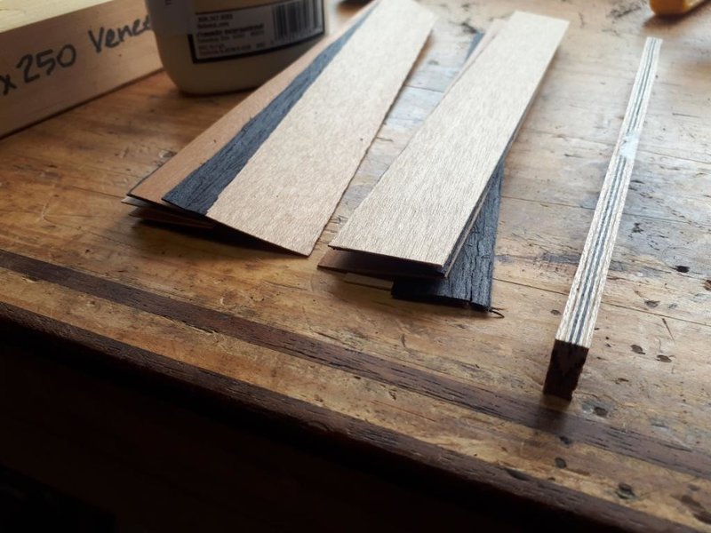

Decided to repeat the laminated sides, was very happy with that last time, keeps the sides nice and flat and helps get the shape a better fit to the mould. When I've laminated in the past I have always had a few gaps, nothing serious and you cant see them but I knew they are there and it bugged me. So this time I spent a lot of time with the bending iron and got the laminates as near to perfect as I could, then glued them with epoxy and clamped the living daylights out of them. No gaps
Lesson learned, take your time and get it right
I find lots of advantages to laminating the sides, in addition to the above. For a start I don't build frequently and bending on the iron always seems to take a while to get my mojo working (yes I am leaving it to heat up properly). So, starting on the inner laminate and using the not so expensive wood, generally very thin, got me back up to speed before I bent the rosewood. Plus with a little patience and care, you get rims that are the right shape with little or no spring to them. All helps for later stages.
While the iron was out I bent my linings and as I had already prepared a heap of them (cant remember when I did it) I have gone with laminated linings top and bottom, a bit wider at the top. The second set of top linings are curing in the mould and I have to the two bottom ones to glue up during the week.

Nice, I love the rosette design. I have yet to make my own classical style rosette. Are you showing how it looks when all are stacked during installation or is that one, two or three tiles?
Re: Falcate Classical #2 Build (in NZ)
Hi John and thanks for your comments. The rosette block is one piece and I will cut slices off that and build up the rosette in the routed groove. I'll mitre the edges as I go and reverse each adjacent slice to get a nice pattern. I'll post pictures when I get there. It's a time consuming but relatively easy process and you end up with something very original which appeals.

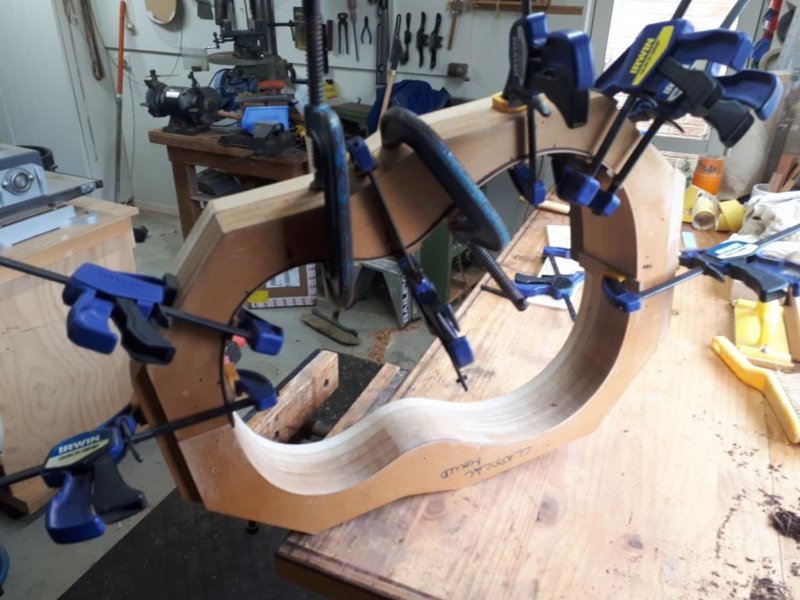

Time for a bit of an update on this one. There has been progress albeit glacial.

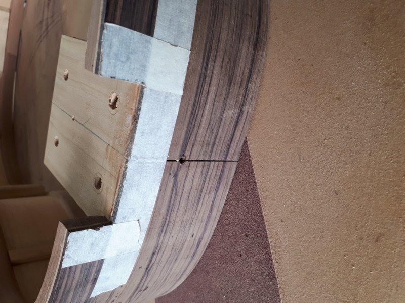

At the end of last year I glued the side laminates together and clamped them in the mould to set. That turned out pretty well and much better than my previous attempts, no significant gaps. I took a lot more time to get the bends just right…. Having completed the side laminates I used them to form the linings. I like solid linings I think they look nice and tidy so I use them for the top and the back. These are made from bits of NG rosewood, heat bent and then glued and clamped into the sides, with a release layer of masking tape between them. Once formed I put them through the router to round off the bottom edge and generally tidied them up. I then glued them into the sides and put all the side splints in and of course the mass block anchors as well. All of the splints and anchors are macrocarpa to match the linings. The composite turned out pretty well and I was happy with all the glue joins. At this point, I need to cut out the top of the body to accommodate the neck, so that when I glue the neck block in, I can clamp the bolted on neck to a perfect alignment. (There’s still some tolerance in the final assembly). I built the joint up from macrocarpa and as you can see below it’s a bolted joint. In the last guitar the bolts were all accessed from inside the guitar. The two nearer the sound hole weren’t too bad but the two near the body were really difficult to get done up as, until I cut the sound port much later, I am working blind. I decided I could improve that this time and so the two bolts near the body go right through the block and are inserted and tightened from the outside of the body, a la telecaster bolt on style necks. Yes you are going to see two bolt heads but I think it will look OK and the ease of use is well worth it. Later in life the neck doesn’t get taken off much but when I am building it’s on and off a lot and I got fed up with spending 15 mins every time I wanted to do the inner bolts up.

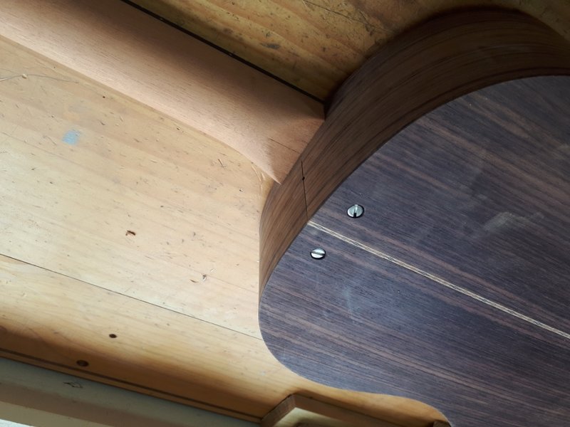

Incidentally, feedback from the current user of the last one is hinting that the neck screws don’t stay tight. I guess that’s not too surprising, especially as the wood can expand and contract with humidity, etc and you cannot get the same clamping force you can with steel plies. Might need a bit of loctite on the thread. (works on my motorbikes!)

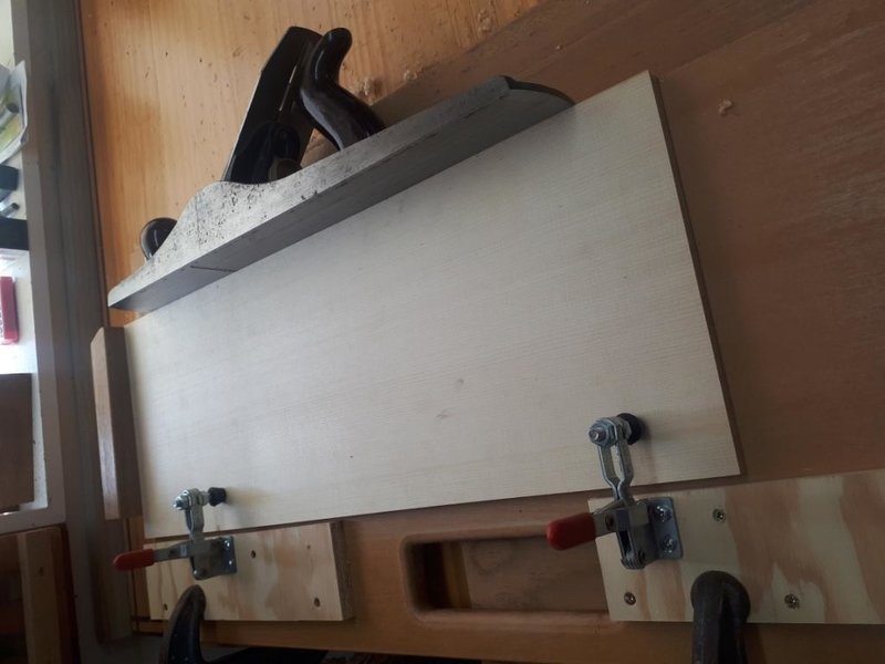

With the neck block glued in, I joined and thicknessed the back, braced it and put it onto the guitar (with neck clamped in perfect alignment). Then I glued two “cheeks” either side of the neck, to form a neck pocket in exactly the right place. These connect into the UTB, which forms the back of the pocket. This means that the UTB is actually fitted to the sides first, before the top goes on. By now it’s February and time to ride motorbikes so nothing much happened in the workshop. I did get to go to some amazing places though….

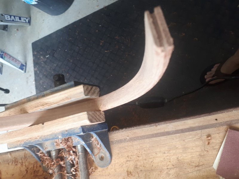

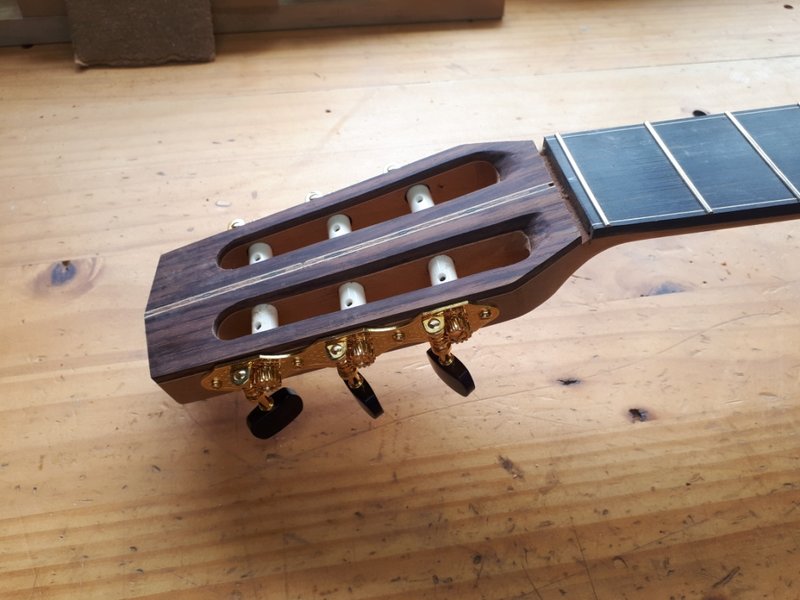

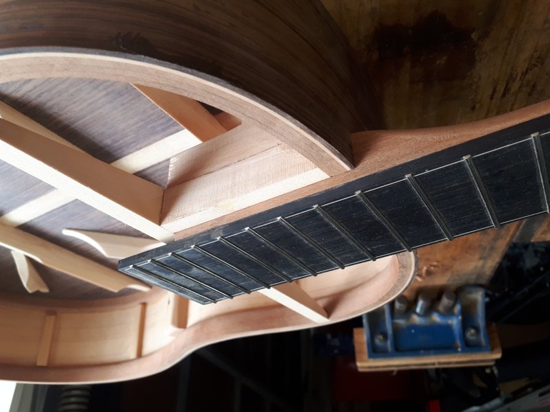

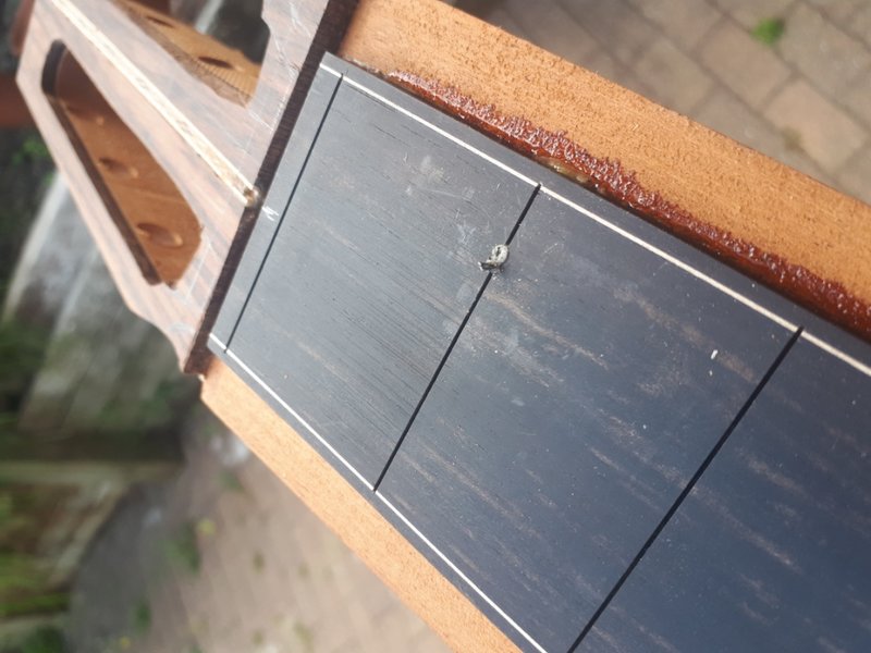

Back to reality and it’s time to finish off the neck. I’ve had trouble in the past with the fretboard slipping under clamp pressure so decided I would go the “two panel pins through the fret slot” route. All good as the fret board staying in the right place. But, drama drama drama, when I went to pull the pins out, the glue had got at them and they wouldn’t budge. Being super careful I got one out OK but I managed to cut the other one off with the pincers instead. I tried pulling with pliers but only succeeded in making things worse. After a bit of thought and using some motorbike technology, I decided to apply some heat and got my soldering iron on the nail. It took a while but eventually I got the second nail out, but boy that was close. I had no idea how I would have dealt with it otherwise. It was about 15mm away from the edge so punching it through would have been risky to say the least. A bullet dodged.
With the fretboard on I’ve finished shaping the neck and headstock and have left a fair bit sanding to later. Still a couple of things to do.

It is fun to see the progress of your guitar. I am interested in the neck joint. I use Belleville washers to help keep the bolts tight. I like them more than a combination of a flat washer and a lock washer. A Belleville washer can stay tight through an expansion-contraction cycle. Other washers can indent on the expansion and end up looser on the contraction. The Loctite will not help. I have been thinking of using solid linings on my next project. I have made them before but glued the laminates while gluing the stack to the rims. I will try using tape for a release to allow me to shape the linings off of the rims.

Love your super thick linings John, that should give a real sturdy rim for the soundboard to vibrate off, how big are they? They look 10mm wide and 25mm deep.
Have you thought about using cocktail stick instead of panel pins to line up your fretboard? You won’t have to worry about removal afterwards just trim them down.

Laminating solid linings in place would be a lot easier except for the fact that its then hard to get a neat finish on the underside of them. Even by using the side, in the mould, as the form there are still usually some small places where I have to clamp a lot when I finally glue them in. They look neat though, so worth the faffing around in my view.
I looked up Belleville washers, thanks. I've previously used normal spring washers and nylock nuts. Ill give them a try and see if they are better. I have glued steel washers in place in the neck block for the heads of my exterior screws to bear on, but not sure I can get a spring one on there.

Thanks they are about 10 by 20, which is plenty to deal with the binding and purfling I use.TallDad71 wrote: ↑Sat Apr 10, 2021 3:42 amLove your super thick linings John, that should give a real sturdy rim for the soundboard to vibrate off, how big are they? They look 10mm wide and 25mm deep.
I had forgotten about cocktail sticks....a better idea. Another is the plastic you use for side dots on the neck. That's the trouble with building so few guitars, I forget all this stuff and am just not methodical enough in capturing it. I do have a build schedule document that I am supposed to update every time I build but I have to admit I'm pretty poor at a) adding notes and b) remembering to look at it before I get going. Always room for improvement!!! (lots of room in my case) but I'm doing this for fun so I'm not going to beat myself up over it.

My linings have been around 5mm thick. If I were to make mine 10mm thick then I would effectively lose 65 square centimetres of vibrating plate all the way around the guitar.
I wonder whether this ‘loss’ would be balanced out by the ‘gain’ of the soundboard sitting on a much more rigid set of linings, therefore losing less energy into the sides of the guitar. I read somewhere, that the top is similar to a trampoline, if the frame is weak the energy will dissipate away.

The sides are infinitely stiffer than the top as they are both laminated twice the thickness and heavily curved. So that top lining is your method of "clamping" the edges to the very stiff sides, thereby "fixing" the edge of the vibrating plate. This will make plate stiffer, all other things being equal, compared to not so fixed edges. But whether that's what you want is another matter.
I've done it mostly because I use wide purfling and I don't want to risk routing off the top when I cut the channel.

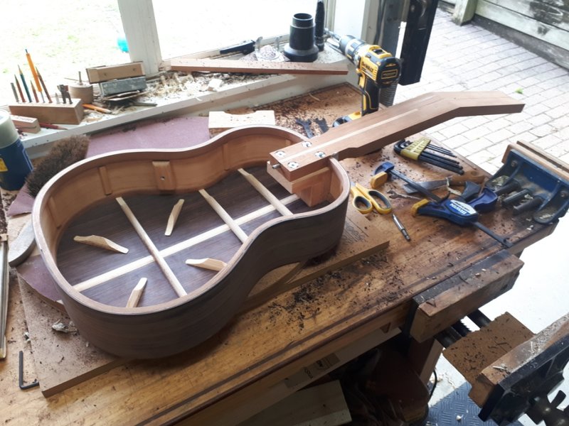

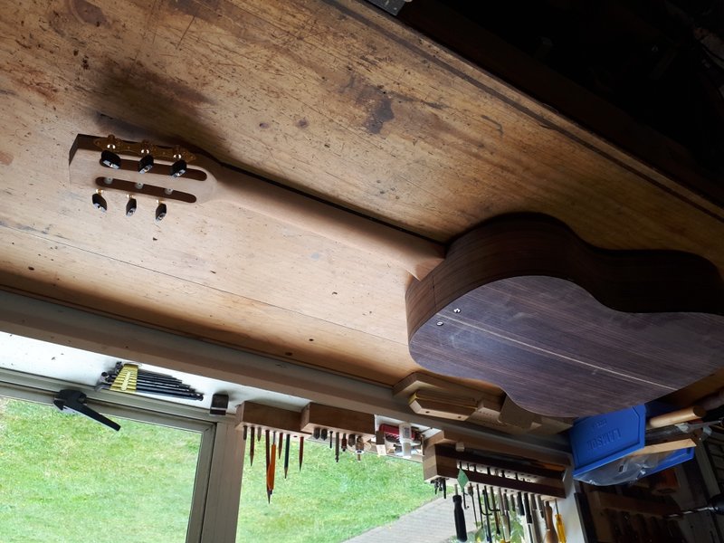

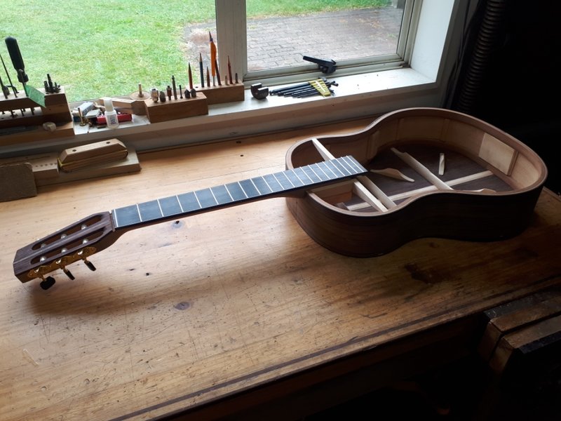

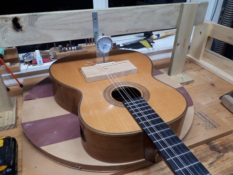

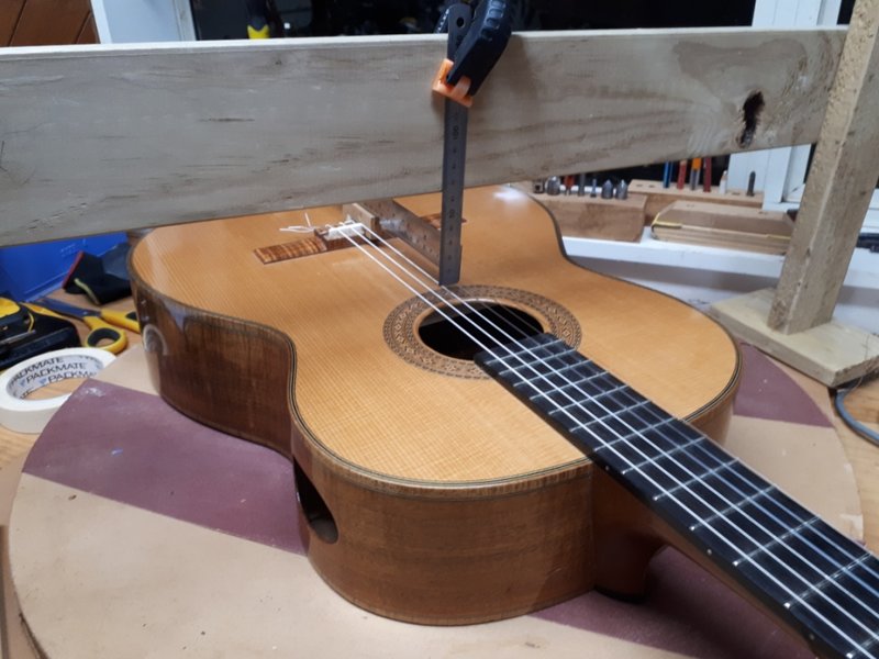

A few more pictures to round out the last post
Assembled, progress to date. Tuners trial fitted, neck on Headstock mostly finished, needs a bit of filling and sanding The neck joint, with the "cheeks" in place. These were glued on against a taped up neck so that the "pocket" is a perfect fit and alignment. View of the UTB and truss rod. Finger board extends over the sound hole (its just occurred to me that will change the T1,1) View of the assembly from the back. The screws will eventually be black, I think but not too intrusive as they are. There are steel washers under the heads, glued into the neck block before it was assembled. Close up of the screws. Considered a metal plate a la fender but decided less is more. We will see how this works.

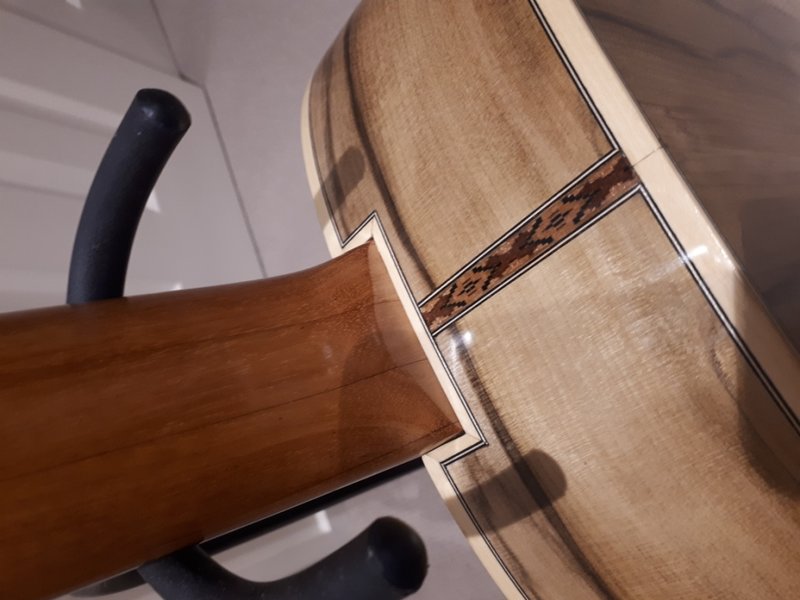

The guitar build is looking great. The neck design with no heal will be an asset for playing at the body joint.

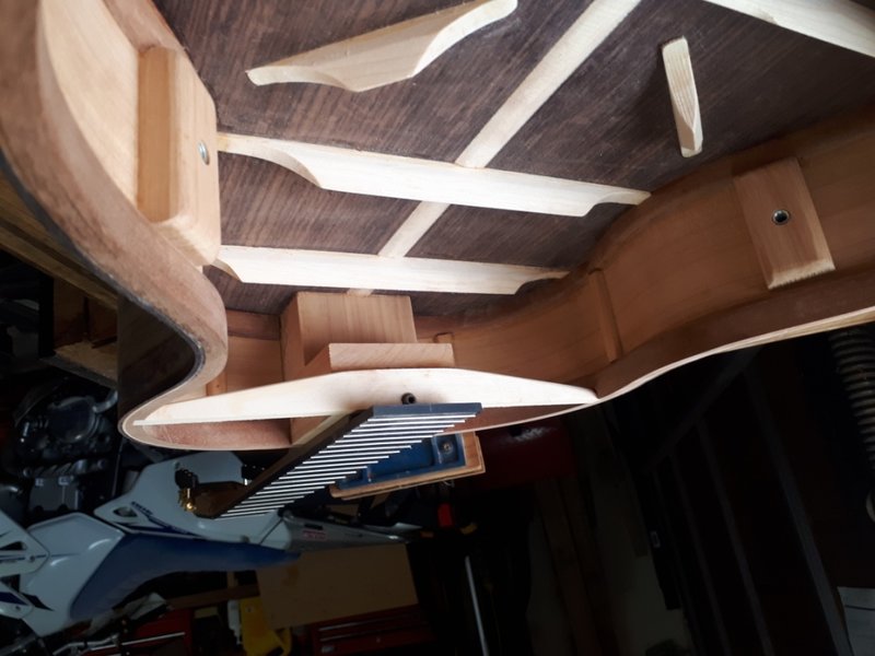

Interesting neck joint Richard. How do you plan to deal with the side end join where the heel block would normally be?
Like this
Except this time I hope to actually get it right.Richard
Feedback to date has been good. Helps with notes up the neck.WJ Guitars wrote: ↑Mon Apr 12, 2021 1:05 pmThe guitar build is looking great. The neck design with no heal will be an asset for playing at the body joint.

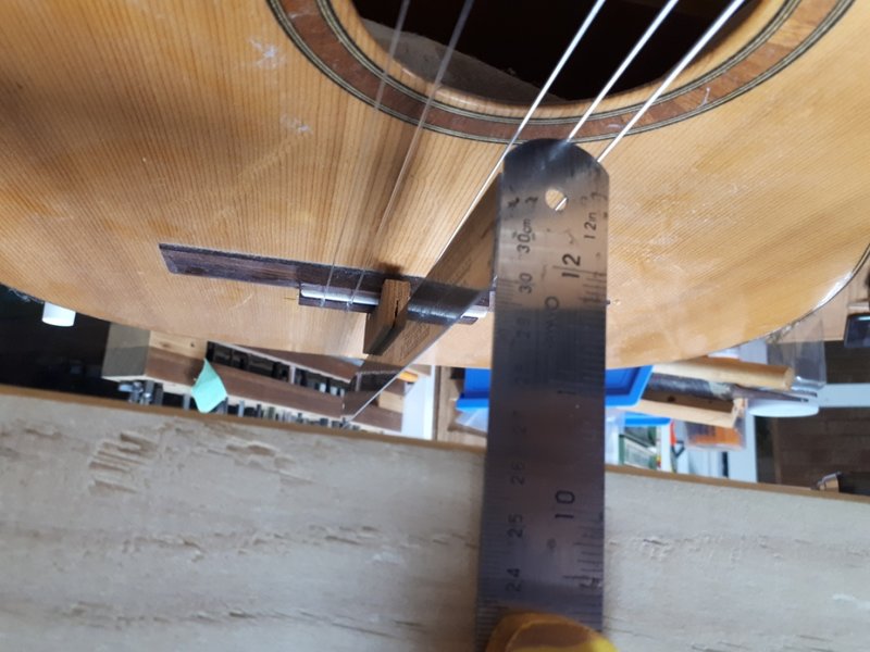

Tonight's efforts went into some bridge rotation checks and a first attempt to measure stiffness of my No.8 guitar. Ill get to No.12 tomorrow night hopefully.
No.2 bridge rotation check. Unsurprisingly it only rotated 0.5 degrees. This was the first real guitar I built, from a kit so I had no idea really what I was doing and just glued it all together. It sounded fine at the time but in comparison to No.8 its very tinny. Currently languishing in the back corner of one of the bedrooms...
No.8 bridge rotation test, this one rotates 1.15 degrees. Better but not at the desired 2 degrees. I didn't really know what I was doing on this one either tbh, I just followed the Cumpiano and Natelson bracing plan. It goes to show that with good materials and following a decent plan, you should end up producing a fairly decent guitar. This is my set up for the load test. I have a 0.01mm dial gauge fixed to a scrap wood bridge, which is screwed down to the bench. First attempts at loading it were a bit messy, as I was trying to use boxes of screws, which obscured the dial gauge (duh) and were not really loading the bridge, where I was measuring deflection. I need a better way of loading it. More thinking required. From this, for No.8 I estimated a stiffness of 25,000N/m, from 0 to 500g. I actually loaded it to 1500g and the plot is not linear, the top gets much stiffer after 500g. I got some differences between loading and unloading cycles so I plotted all the readings and then eyeballed the stiffness from that. I plan to test No.12 tomorrow night. I think Ill focus on the 0 to 500g part.
Haven't got my mike setup sorted yet, have borrowed my sons fancypants Behringer condenser mikes but forgot to borrow the leads to plug them in. I also need to sort out a way to block off the sound hole. Havent got any foam lying around atm.

Richard fascinating stuff please keep it coming. Having pretty much failed with falcates on classicals I have reverted to Torres style fan. You clearly have more stamina than me!
A small point: I have been using a 600 mm lightweight pointer for the bridge rotation measure - easier to measure the larger deflections. Alan Caruth has even talked about using an infra red pointer. Even better.

And thanks again. Some work to do on my deflection jig....

Woohoo...lockdown !!!! Means only one thing...shop time
After revisiting the tap testing on my remaining spruce tops, I went with this set of Englemann spruce. They all came out much the same thickness, 2.00 to 2.15mm thick. Whether I actually go that thin, well maybe. After playing my falcate guitar my music teacher (who this is for) said he would prefer conventional bracing so thats what is going to happen. Ill do another falcate next time and give it another go.
Onwards...shooting the top panels Glued together Time to start on the rosette Cut into slices Have I got enough? yep, as long as I don't stuff it up again One of my favourite things about this bit is the shavings you get....I like looking at them but they go in the bin lol.
