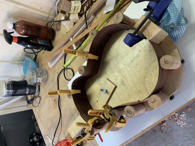

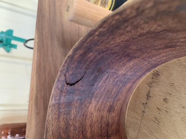

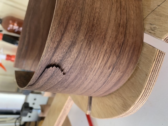

I am a very inexperienced maker, and this is my second time bending wood for a ukulele. First time was Australian maple and I got an outcome I was very happy with. Second attempt was with Tasmanian Blackwood. The photos show the results- from the inside and outside. The wood seemed to become very stiff, and the popped, with a hole opening up.
I’m trying to understand what I did wrong. My theory is that I was too slow, or the iron was too hot, and I cooked the wood, making it too stiff to bend easily There seems plenty of scorching on the inside. When I bent a section that was untouched, it became flexible reasonably quickly, but then I would stop to compare the bend to the template and it would become more difficult to bend.
Any suggestions / observations gratefully accepted. Also, is this savable, or a “teaching moment “?

I think the problem that you had here is down to the grain orientation of the timber, more than the temperature. The way that it cracked in that rounded pattern suggests to me that it is mainly flat sawn, rather than quartered, and has delaminated between two growth plates which are oblique to the plane of the cut.

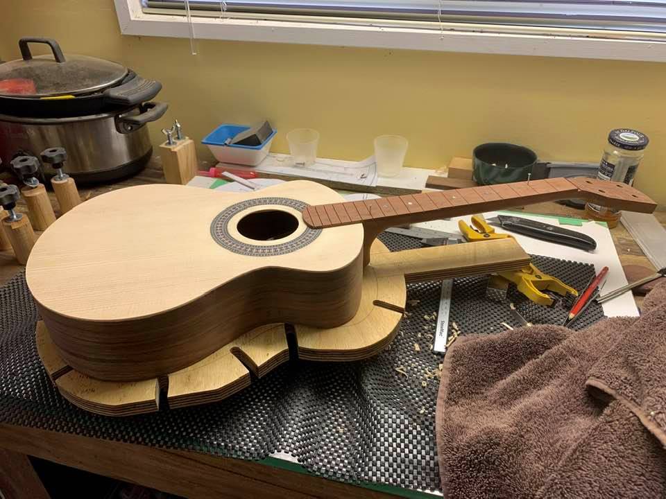

Coming along nicely now, I think.
