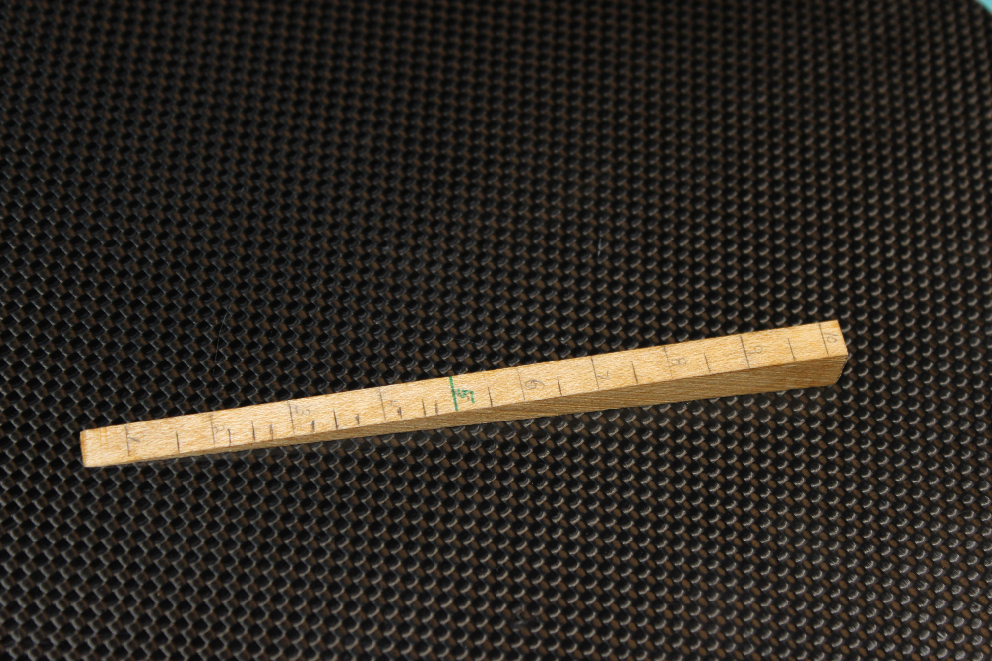

You can also make your own for about 10 cents.
You can get as accurate as want by by making it longer and using a shallow angle.
After cutting the wedge I just measured it with my dial caliper and marked it.
Re: It’s not your fault but
Show off!
It’s another simple but great idea. I may just make another one that’s a little shorter and just does measurements in the range I need for string clearances.
