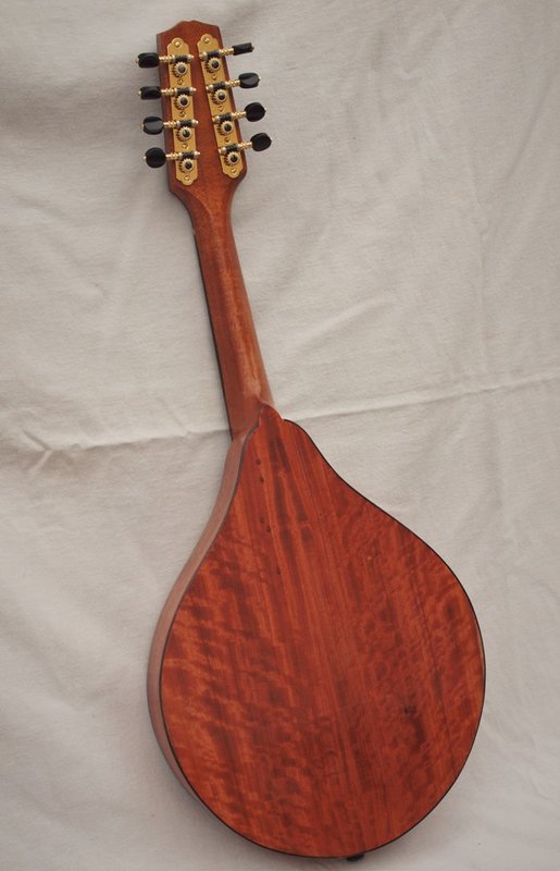

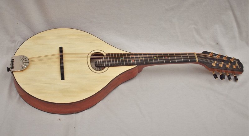

Post by peter.coombe » Fri Apr 23, 2021 10:25 pm

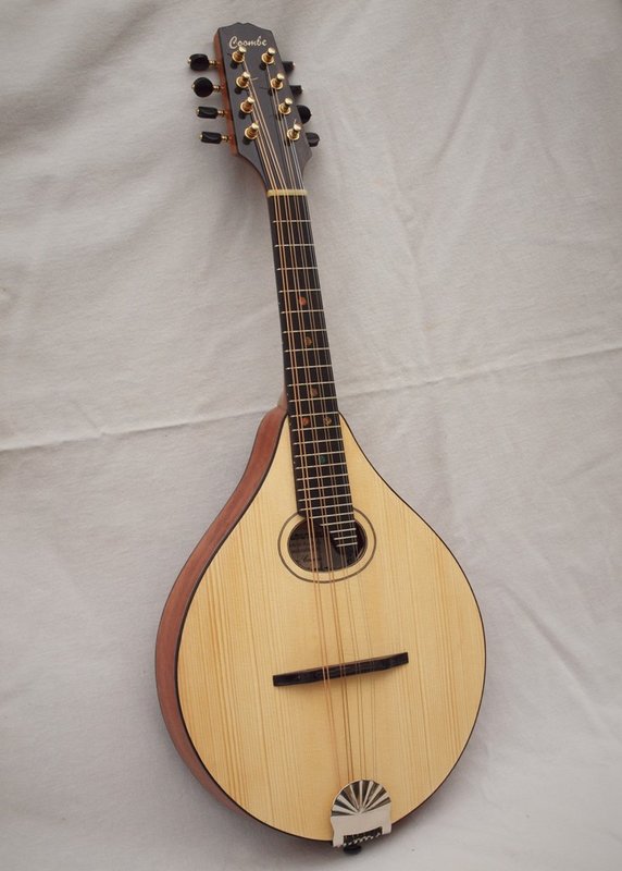

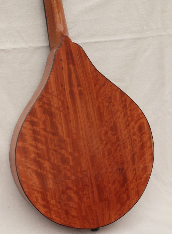

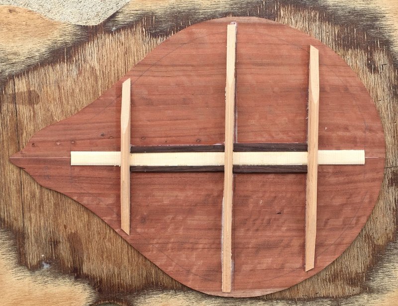

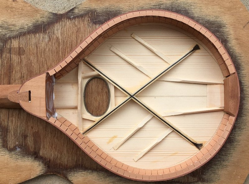

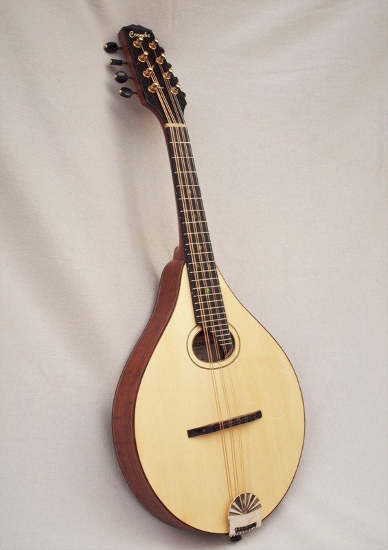

Well the red gum mandolin is finally finished. Took a while because I ran out of bridges and Vern Brekke is having problems at the moment with the CNC he was using so had to wait for a bridge. Was well worth the wait. All the nay sayers on red gum now need to eat their words. This is the best sounding of this style of mandolin I have made so far, but it is not the loudest. In comparison to my Ebony mandolin it has more depth of tone and overall sounds more refined, but the Ebony mandolin is louder. Lovely beautiful sounding instrument. Very pleasing and a big surprise bearing in mind all the negative comments I found for red gum as a tonewood.
Here are some pictures of the bracing and the finished instrument. I have not done any sound clips yet due to my left middle finger having an argument with the bandsaw and the bandsaw won. However, was not too serious and is now not far off being ready to play mandolin again. The red gum is not very stiff along the grain so I added some 5mm strips of indian rosewood to stiffen it up a bit. Seems to have worked. Thickness is 3.4mm and weight is 212gm, so not as heavy as the ebony even though it is thicker. So, red gum has beaten BRW, EIR, sassafras, blackwood, myrtle, rock maple and red ironwood. So, not so shabby. The red ironwood has just been strung up, so is early days yet, but is no match for the red gum mandolin, and red gum is a heck of a lot easier to work with. It is common as mud, but not around here because it does not grow here. Main problem is getting a clear piece that is dry and quarter sawn and with a bit of figure. It is pretty rough stuff, full of gum veins and worm holes, but the sound is great, and commonly highly figured. Whether it would work in other instruments I have no idea. Unfortunately some years ago I sold the rest of the plank where this wood came from because I thought it was too unstable for an arch top mandolin and I would never use it. Bugger.
Woods are Red Spruce top from RC Tonewoods, red gum back and sides, Mahogany neck, Macassar Ebony fingerboard, Indian Rosewood bindings, and ebony bridge and headstock overlay. The fingerboad dots are opal.
Side view
Front

Back closeup
Back bracing
Top bracing

This is the first of this style of mandolin where I have managed to get the main top mode and main back mode 4 semitones apart. All 3 modes are also between notes, so I nailed it this time, and that is one reason why it sounds so good. The whole thing is a bit counter intuitive, but makes sense if you follow the Gore/Gilet books. Red gum is heavy, floppy and the tap tone is more thunk than diiinnngg. The vast majority of guitar makers would say avoid from those properties, but for a dead back system that is exactly what is needed. It probably would be a poor choice for a live back system, however. As for the stability problem, apparently it is slightly more dimensionally stable than BRW, but that is not very reassuring since BRW splits if you look at it wrong.
Yesterday I had an interesting day with the red ironwood mandolin. It sounded somewhat bland and a bit thin in comparison, but the main back mode was 4 & 1/2 semitones above the main top mode. So I stuck a bit of blue tack on the back. Significant improvement in the sound, and when I measured it the main back mode had dropped 1/2 semitone. I added more blue tack and the sound got worse. A bit of head scratching how to make it permanent because internal access is difficult. Anyway I tried a round file stuck through the end pin hole and filed down the middle brace on the back until the main back mode dropped 1/2 semitone. Had the same effect as the blue tack, and is now quite a nice sounding instrument, very clean and clear sounding, but I still prefer the red gum mandolin, but the difference is now very much smaller. Red ironwood is heavier than red gum, but is a lot stiffer and rings almost like rosewood. I had great hopes for it because of the density, but probably won't use it again. It ain't easy to bend.
So what does all this mean? It just confirms that the principles in the Gore/Gilet books can be applied very successfully to flat top mandolins. They are really no different from guitars, just the frequencies are about an octave higher.

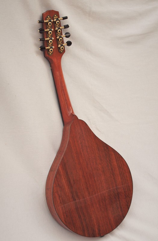

Post by peter.coombe » Thu Jan 13, 2022 2:47 pm
Following on from this, I have made 2 more Red Gum mandolins, and they all sounded very similar. So the first Red Gum mandolin was not a fluke. All 3 sold quickly. I had some left over Jarrah from a bed I made around 30 years ago so thought I would give that a go. I made 2 Jarrah mandolins 27 years ago and they are both still going strong, but I stopped using it because although they sounded great, potential customers were complaining about the weight. With a flat top mandolin, the weight is not so much an issue. It is now finished and the sound is great. i had a hard time choosing what I prefer, the Red Gum or the Jarrah mandolin. The sounds are different, but at about the same level. The Jarrah mandolin sounds more like my Ebony mandolin, but cleaner. The Red Gum is a tad sweeter, but does not ring so strongly and is not as loud. In the end I decided I preferred the Jarrah, and after it has settled down I can't put it down. So I now have a worthy Ebony substitute, and am sniffing around for more Jarrah. At least it is far easier to find clean Jarrah than clean Red Gum. I don't like paying for splits, worm holes and resin deposits.
I would be interested in any comments about Jarrah from anyone who has used it. Certainly works with mandolins, but I would be a but concerned about movement in bigger instruments.
Here is the Jarrah mandolin

I've used jarrah, but it is laminated - veneer. But if you're going for a dead back, this approach may well work for you. There are a few new quirks to using veneer but it does allow you access to beautiful woods you might not otherwise consider because of stability issues.

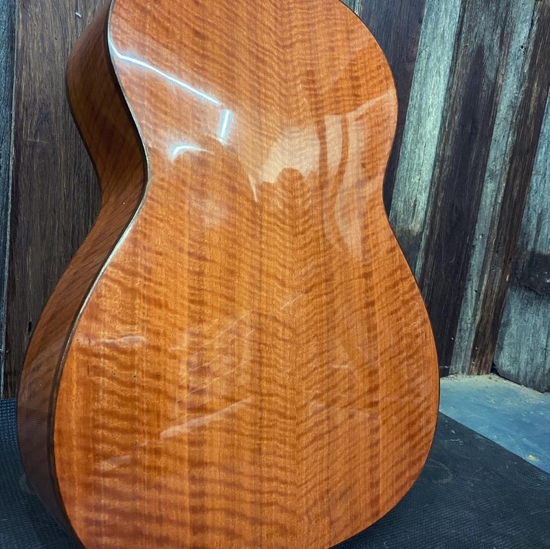

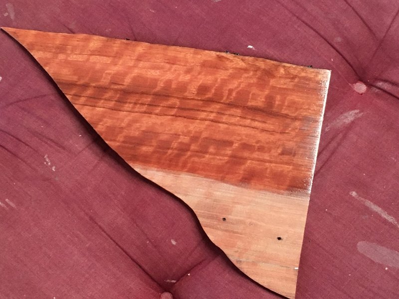

The first pic is some Regum Back and Sides. It Is also Laminated Back and Sides.
I have been using Jarrah in the Guitar Making School but we always pit a layer of epoxy over it to sure up any cracks and make it stable. I also use Jarrah Veneers for Back and Sides. Looks Beautiful!!
