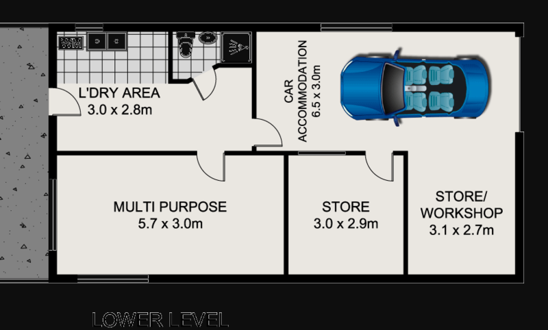

I'm pretty excited, I've just gone unconditional on a house. It is a high set house with an under height "built-in" which I intend to convert into a workshop (53m2). While I wait for settlement, I am busily watching youtubes and reading old threads about dust control, soundproofing etc.
But I would grateful for any advice anyone would have for setting up. What would you do with this space? How would you arrange it?
Things I have in mind are:
I'm thinking I would like to climate control (temp/humidity) the whole workshop. My kiwi blood struggles in the brissy summer.
I'm thinking of soundproofing at least a 'machine room' but maybe the whole thing
There is not a lot of head room (maybe 2.5m tall)
Eventually I would like to run classes in the space
So I am currently thinking of making the multipurpose room into a machine room, remove the north & east walls of the store room...

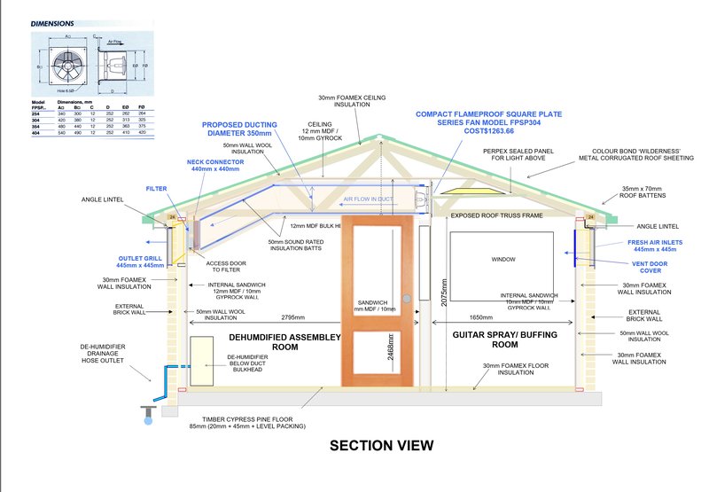

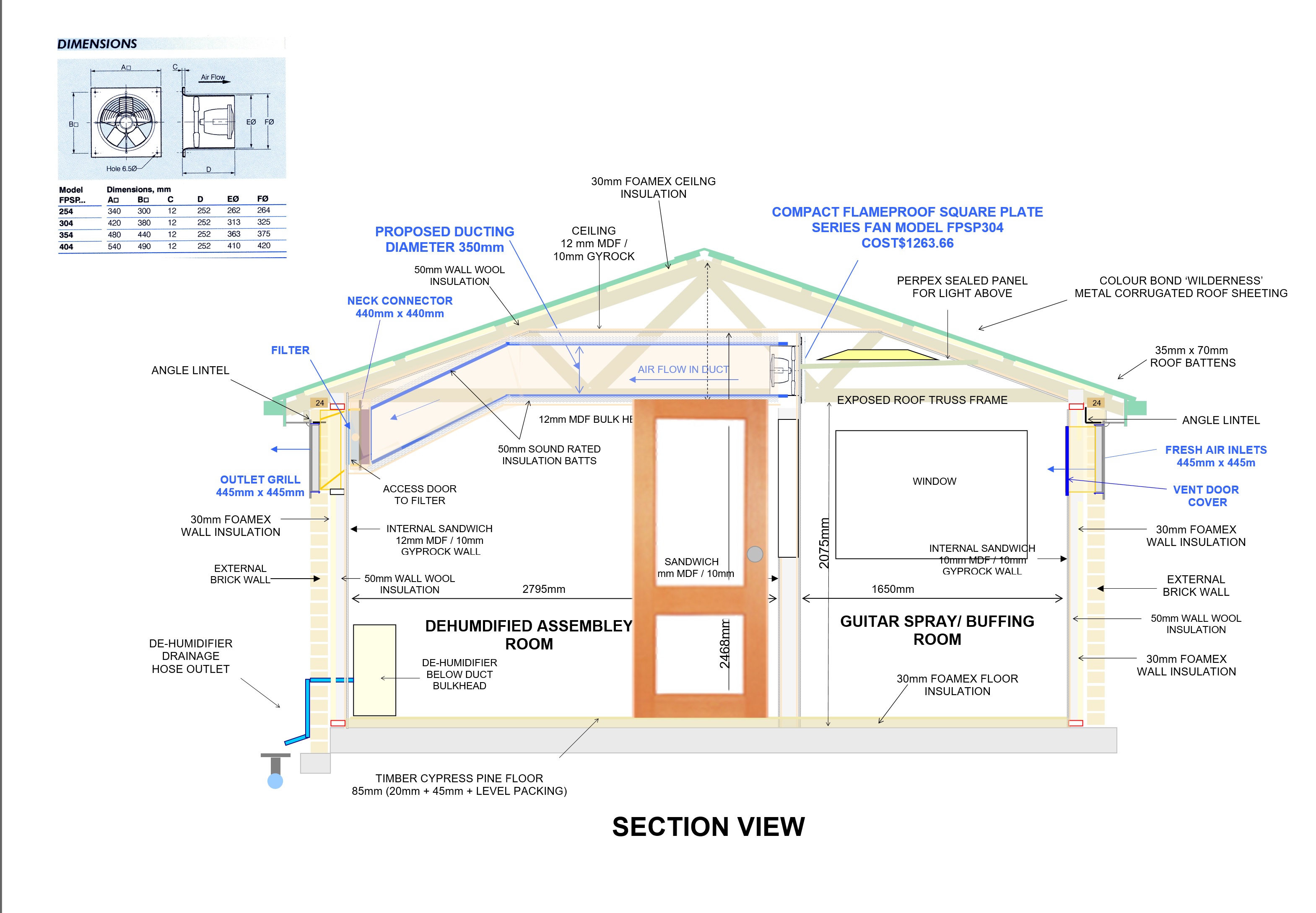

Trent great project to plan for!
In regards to sound rating your workshop, acoustic insulation wool with sandwich wall and ceiling treatment helps to drop the db levels. See example section view. If you want have a spray room suitable for nitro lacquer I would recommend an explosion proof exhaust fan with enough power to drive through a carbon filter. Then no issues with the environment or resident complaints.

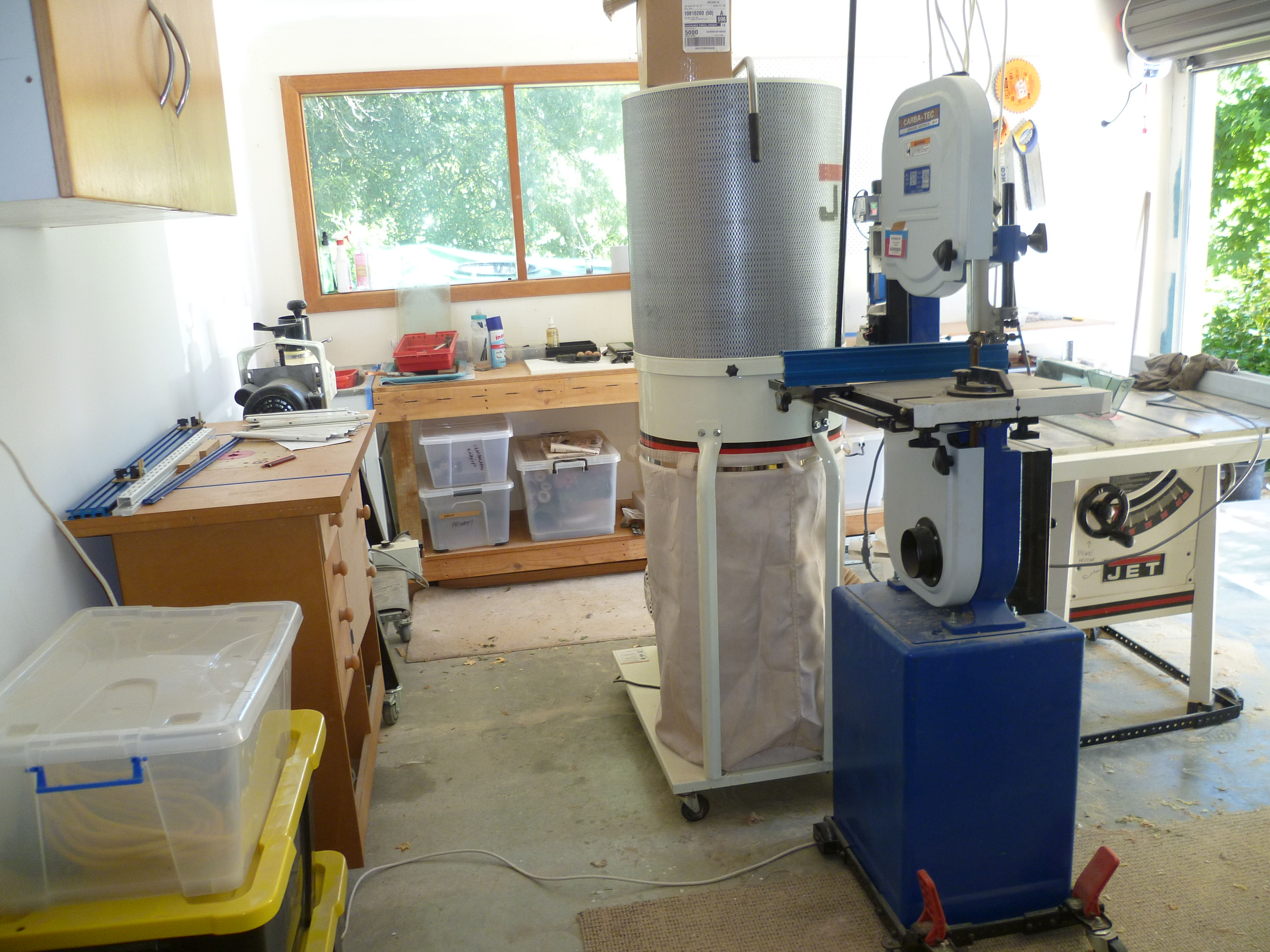

Re: New workshop to be

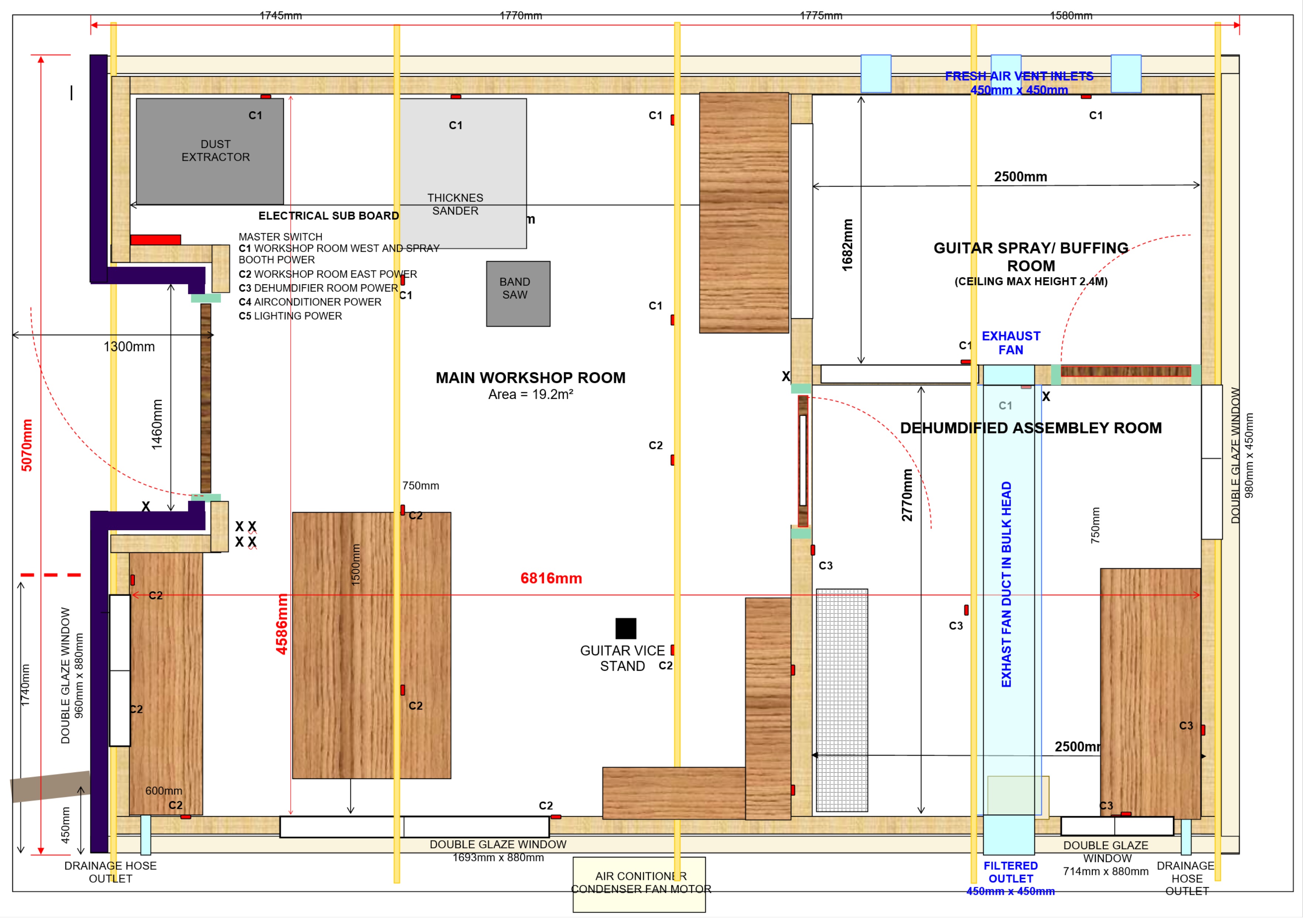

One thing Ive done with my machinery is locate it around a centrally located dust extractor.

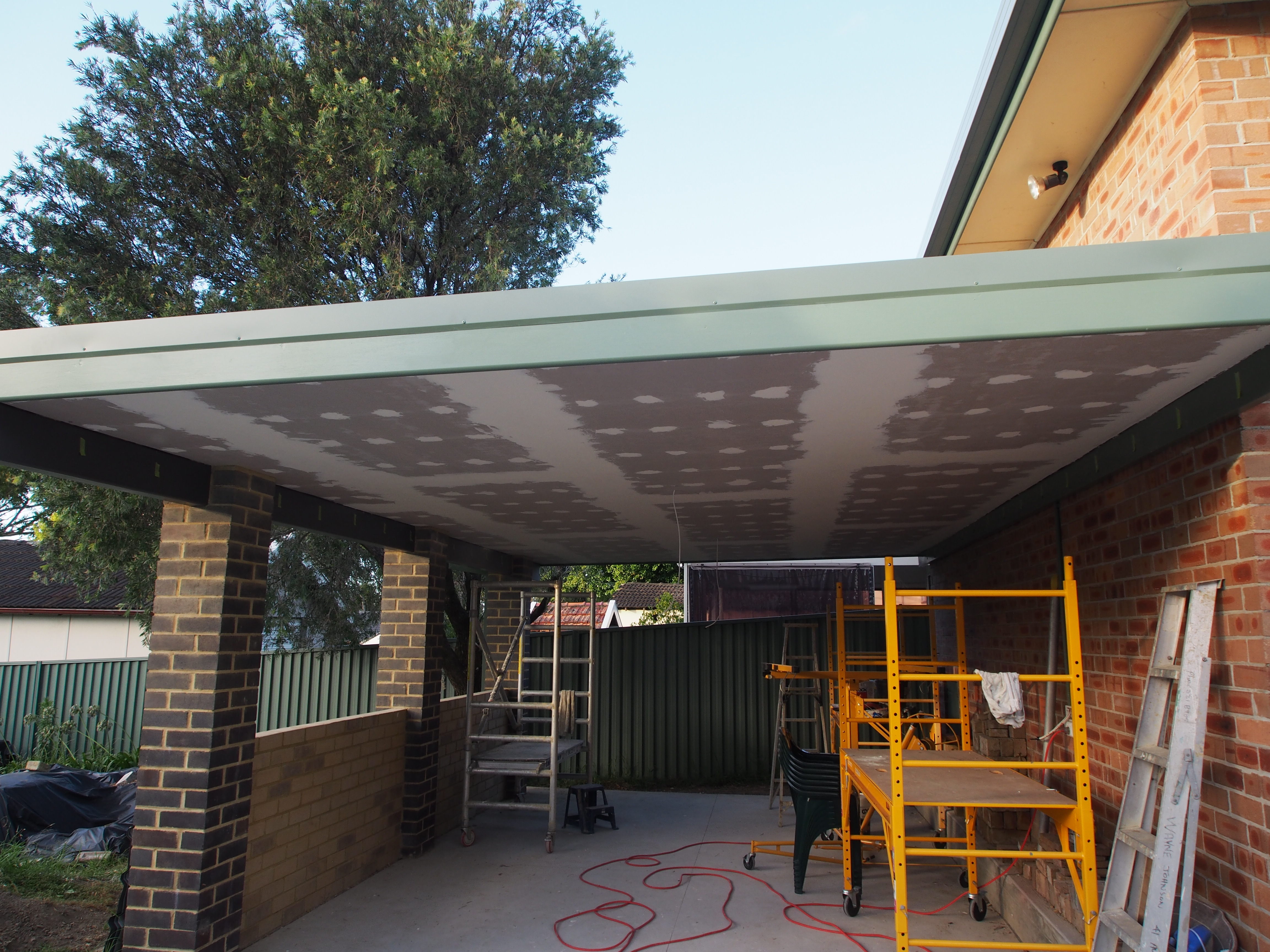

As mentioned having machines on wheels and strategically locating power points on the walls and ceiling if feasible avoids running power cables on the floor and avoids trip hazards in the workshop.
The guitar building is the priority not the car! 0h well, I almost got away with it Martin until the wife caused a detour turn for me to build a new garage behind the house. The wife had no understanding what the important priority was.
Oh well, the guitar builds had to sit on the side line again.
