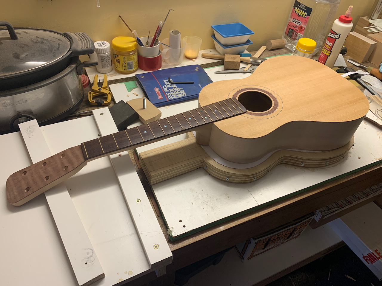

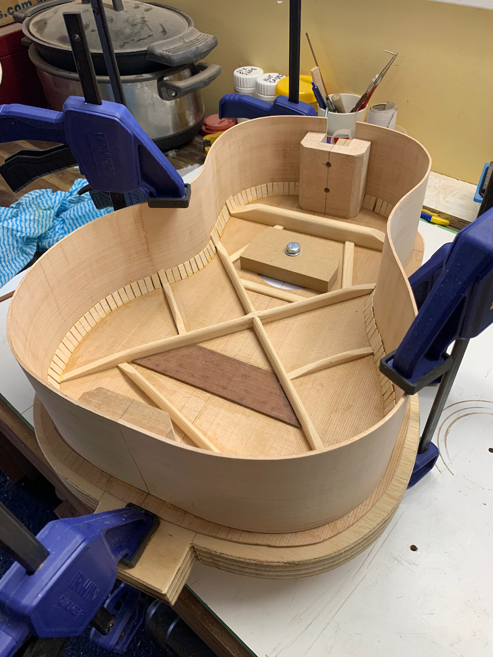

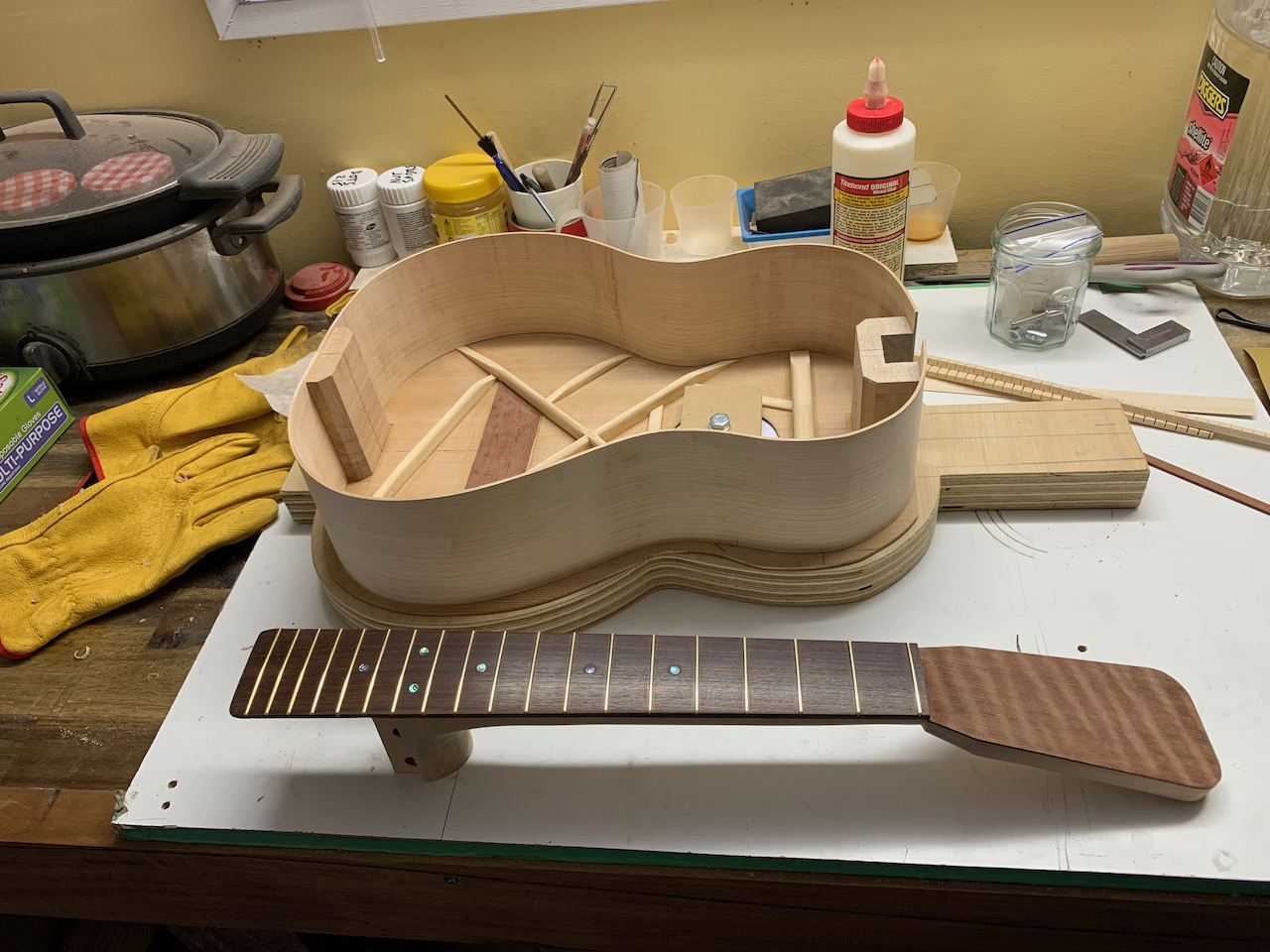

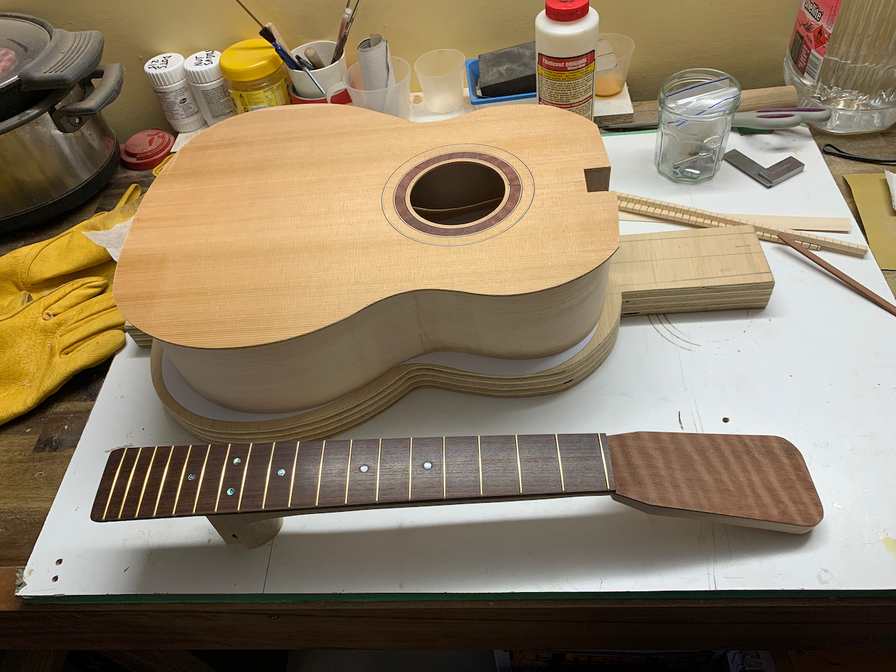

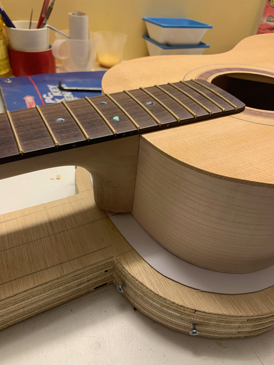

I am making some progress with my current project, a Martin 5-style small steel string acoustic guitar (LMII plans). Big leaf maple back and sides, western red cedar top, Queensland maple neck, gidgee fretboard. Will be making a gidgee bridge, and applying some Blackwood bindings.
Pretty happy with things so far, although with much to learn. Box is closed, and after some adjustment, neck fits nicely. Should have left the final finishing of the fingerboard till later - next time!
