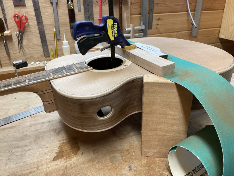

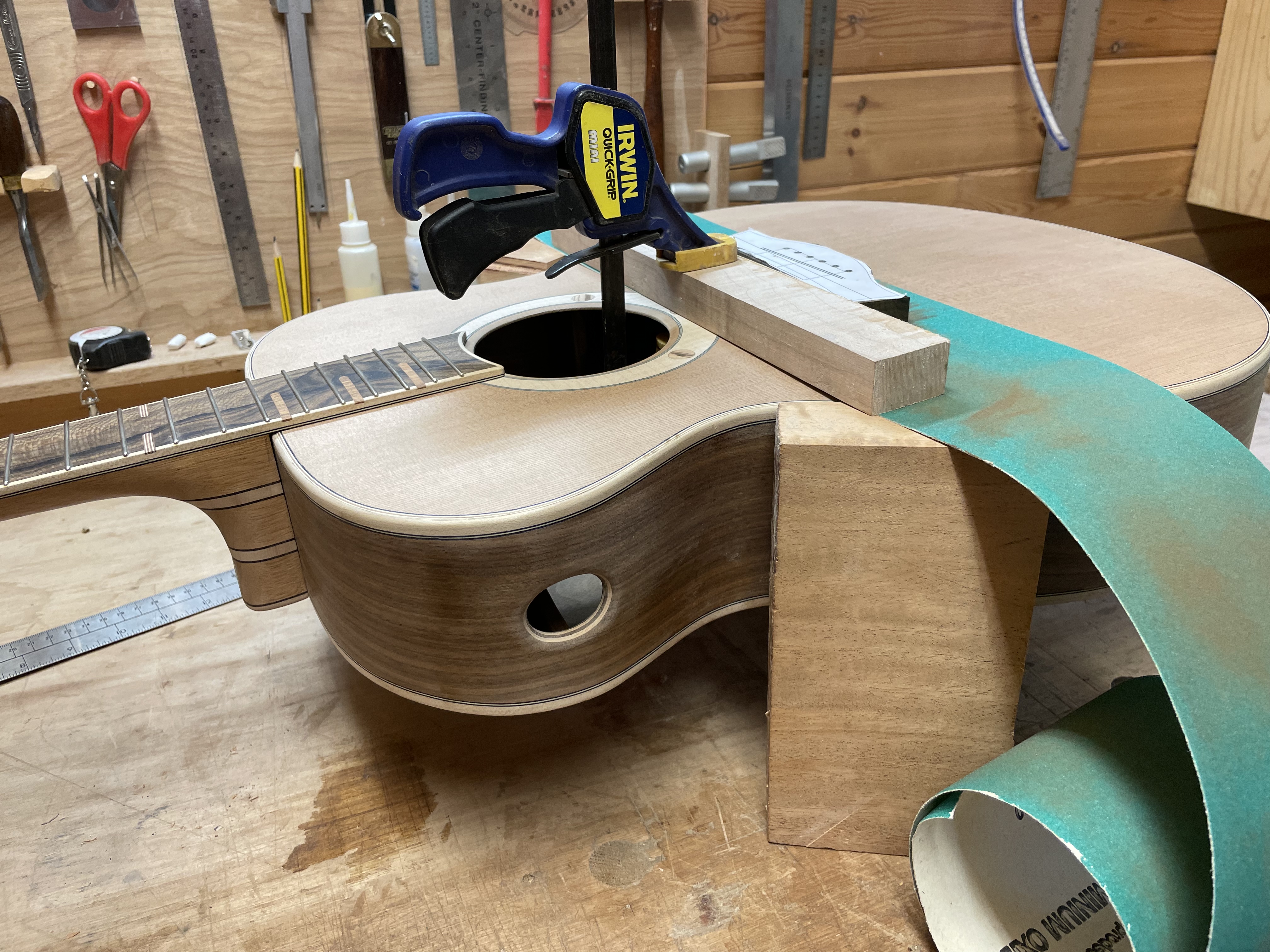

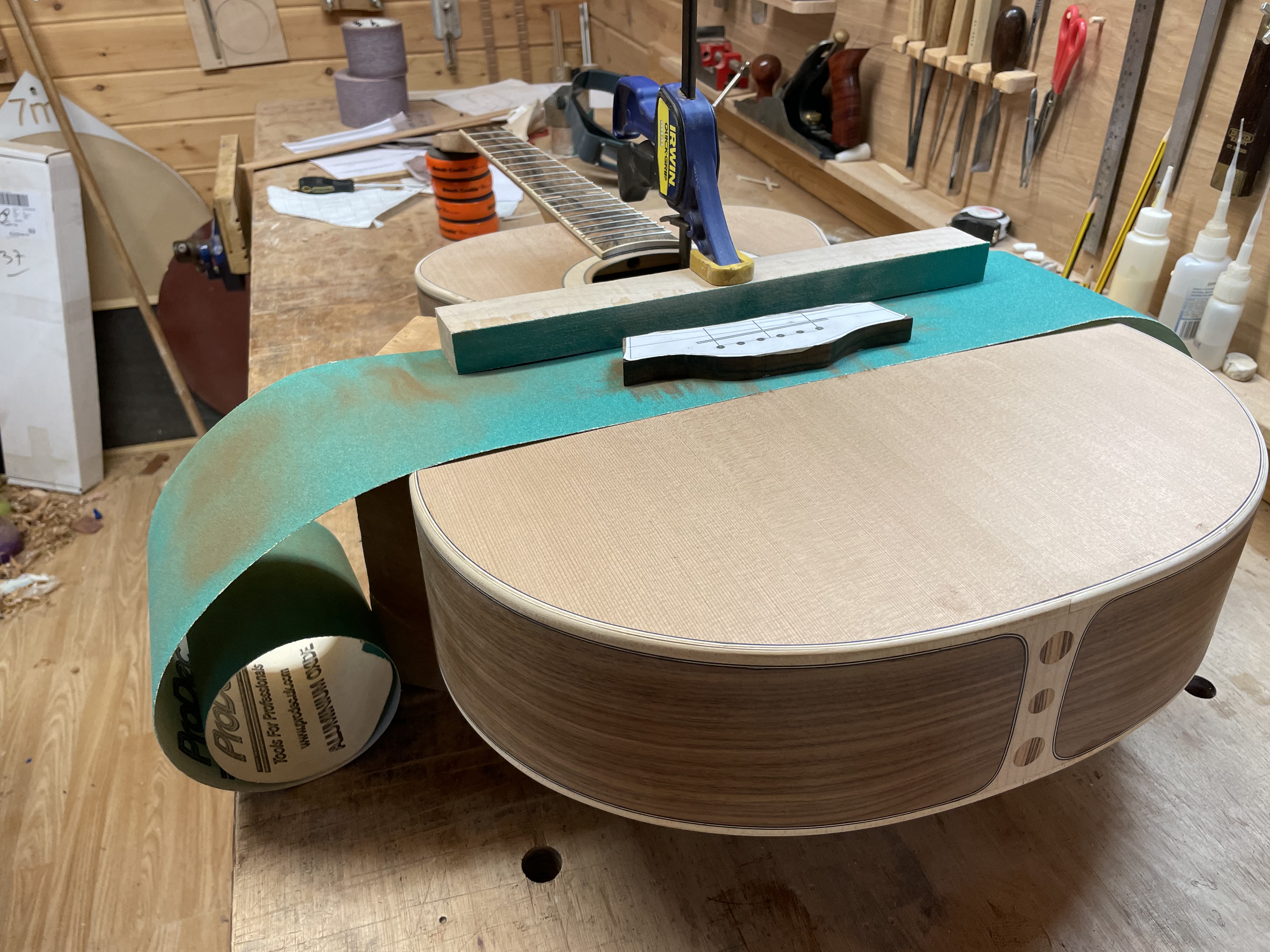

I have always loathed profiling the underside of my bridges to match the dome of my sound boards, I think I always will, unless someone can tell me an easier way.
My set up so far is to hang the guitar by the sound board using a clamp and some stilts, lay down some 120 grit and grind…. And grind ……and grind
I used to do the same but lay it on its back to sand , I didn’t like the idea so much as the act of sanding with pressure compressed the shape of the dome. This way I amplify the shape of the dome, which is also not great but is closer to the effect that the strings have.
However I hang the guitar it still takes forever. How do you do yours?
