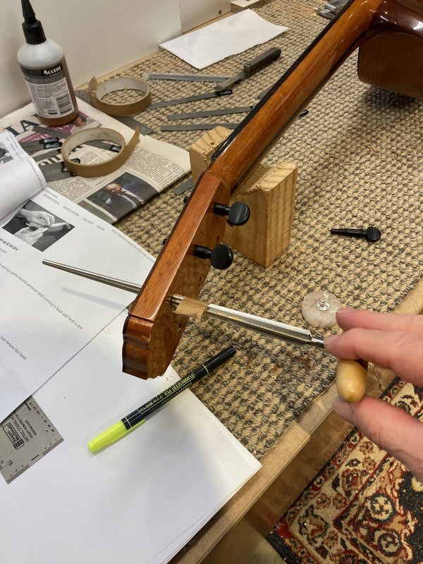

First job is to ream out the old peg holes to fit the new pegs. This job needs to be done with care as a small amount of reaming results in a significant enlargement of the hole. The hole is reamed until the top of the outer barrel of the tuner is just nudging above the top of the headplate.

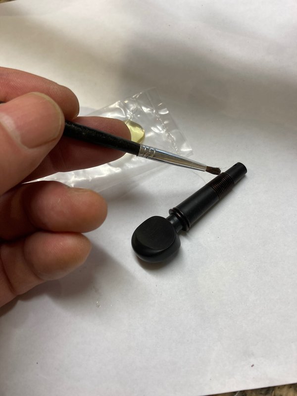

Applying polyurethane glue to the threaded section of the outer barrel of the tuner.

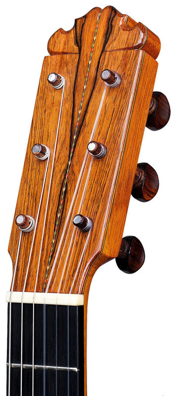

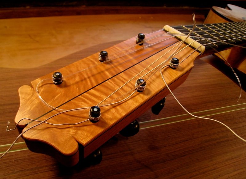

What really did my head in was when I got to the critical moment when I wanted to reproduce the "traditional" method of orienting the way the strings wind onto the two E string posts (See photographs as examples - not my guitars), my brain began to twist and jibe, trying to work out exactly which peg went where.
On a flamenco guitar it seems traditional - but, I suppose, not essential - that just these two strings wind around their posts from the outside, in, to keep the path of the stings over the nut as direct as possible!
