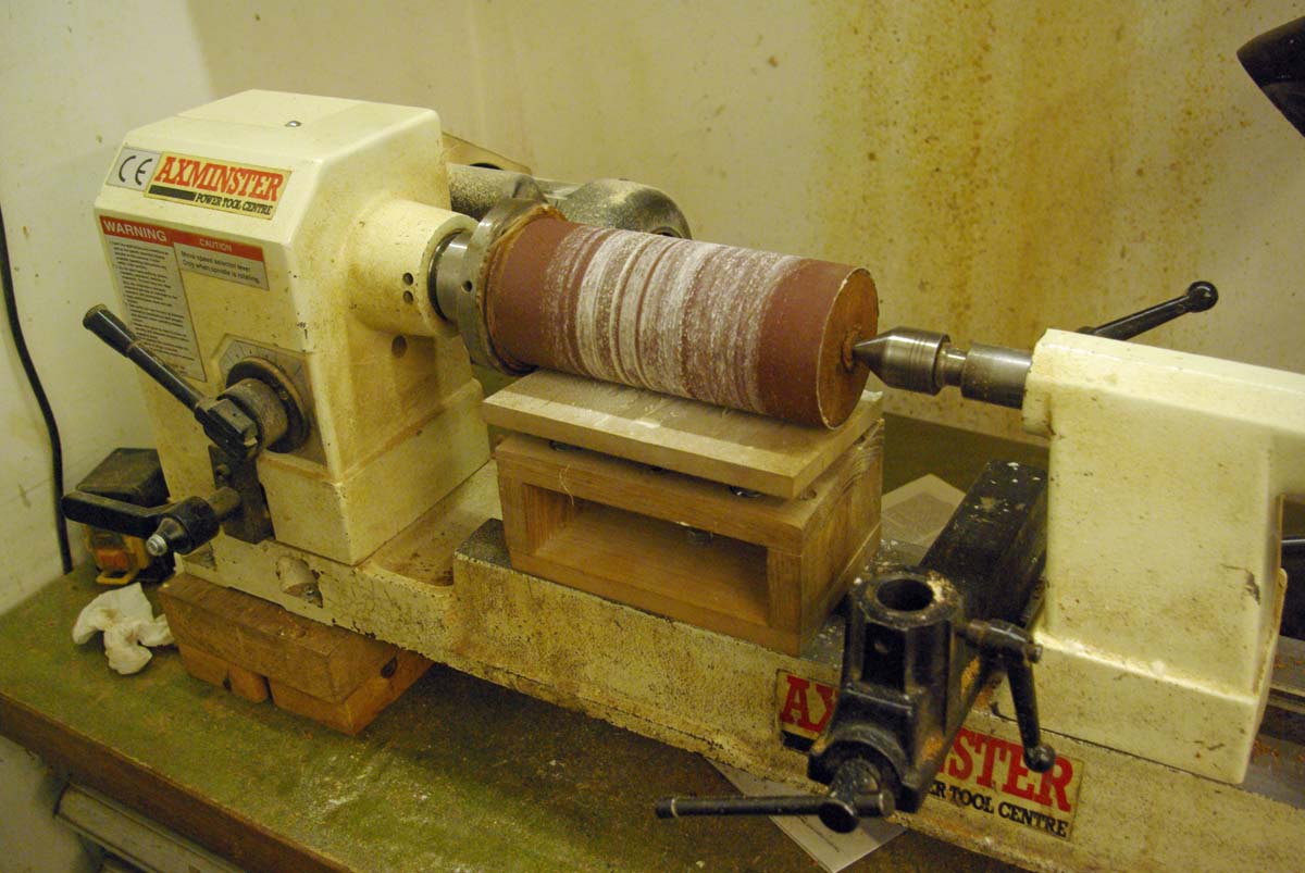

I do have a full size sanding thicknesser but still like to use this lathe based one for three jobs: thicknessing bone for nuts and saddles, scalloping the end of braces, and scalloping the ends of bridges.
Couple of things. The drum should be reasonably large diameter to give plenty of abrasive surface. To deal with the dust I suspend the hose from my shop vac to be very close to the drum - not shown in the pic. If you get it real close it picks up most of the dust. Given the direction of rotation you have to feed rom the back which can be a bit dodgy safety wise. Much better if you have the situation to have it mounted backwards.
The mdf table is hinged at the back and raised and lowered with a couple of bolts. One could do something a bit more sophisticated but this works fine.
You could do a velcro attachment of the abrasive but I just glue it on and replace when too worn. It doesn't do that much work.
So all in all a useful tool to have.
PS looking at the image it looks terribly messy. That is because I sometimes do some green turning which throws sap everywhere!

Would you mind running through how you made the drum itself? How do you have the drum securely connected to the lathe? How do you secure the table assembly to the bed?
I plan on building a larger table so I can run tops, backs, neck blanks, etc through it. The tip to use it for bone parts and scalloping is a good one, thanks!
I also plan on making the drum quite large, but thanks for the tip. I plan on using a section of 6 inch PVC pip as a dust hood and connecting it up to my 2HP 4" extraction system. Dust-B-Gone!

Joel the drum is made from a bunch of layers of stuff that I had around in the shop. Mahogany or it's subsitutes. And of course with the lathe you have the tool to make the cylinder. It does need to be fairly stable timber - changes.of humidity will cause problems with roundness.
The drum is screwed to a face plate and supported by a free running centre at the tail.
I did use it to thickness sides in the early days but the lack of a steady feed made it a bit hit and miss.
I also built a full scale thickness sander - which was a fun exercise - but the lack of a motorised feed really meant it didn't work that well.
So in the end I cringed and forked out for a Jet thickness sander. And really am pleased I did. It does all sorts of jobs apart from tops and backs. However that is not what you asked!
