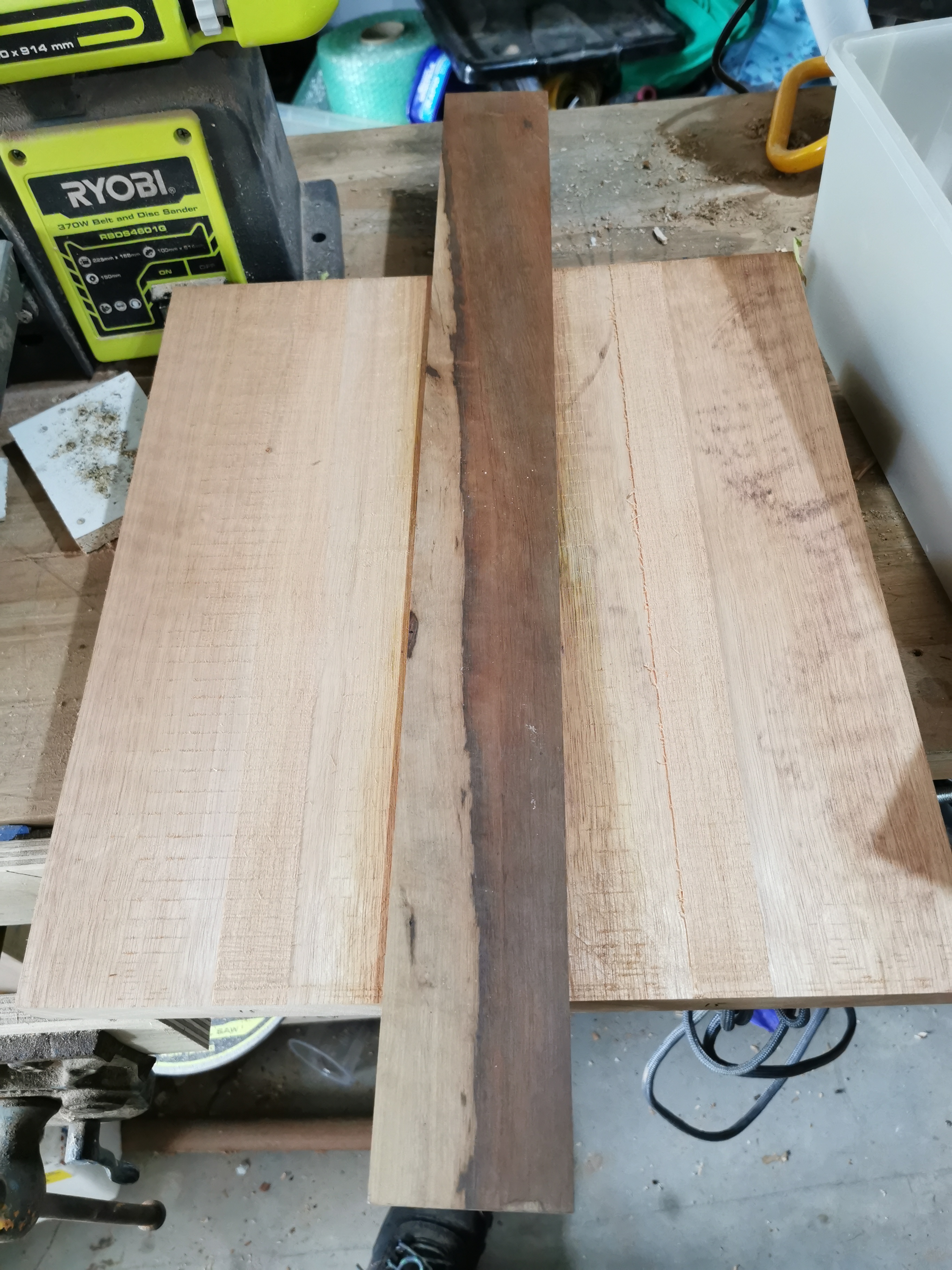

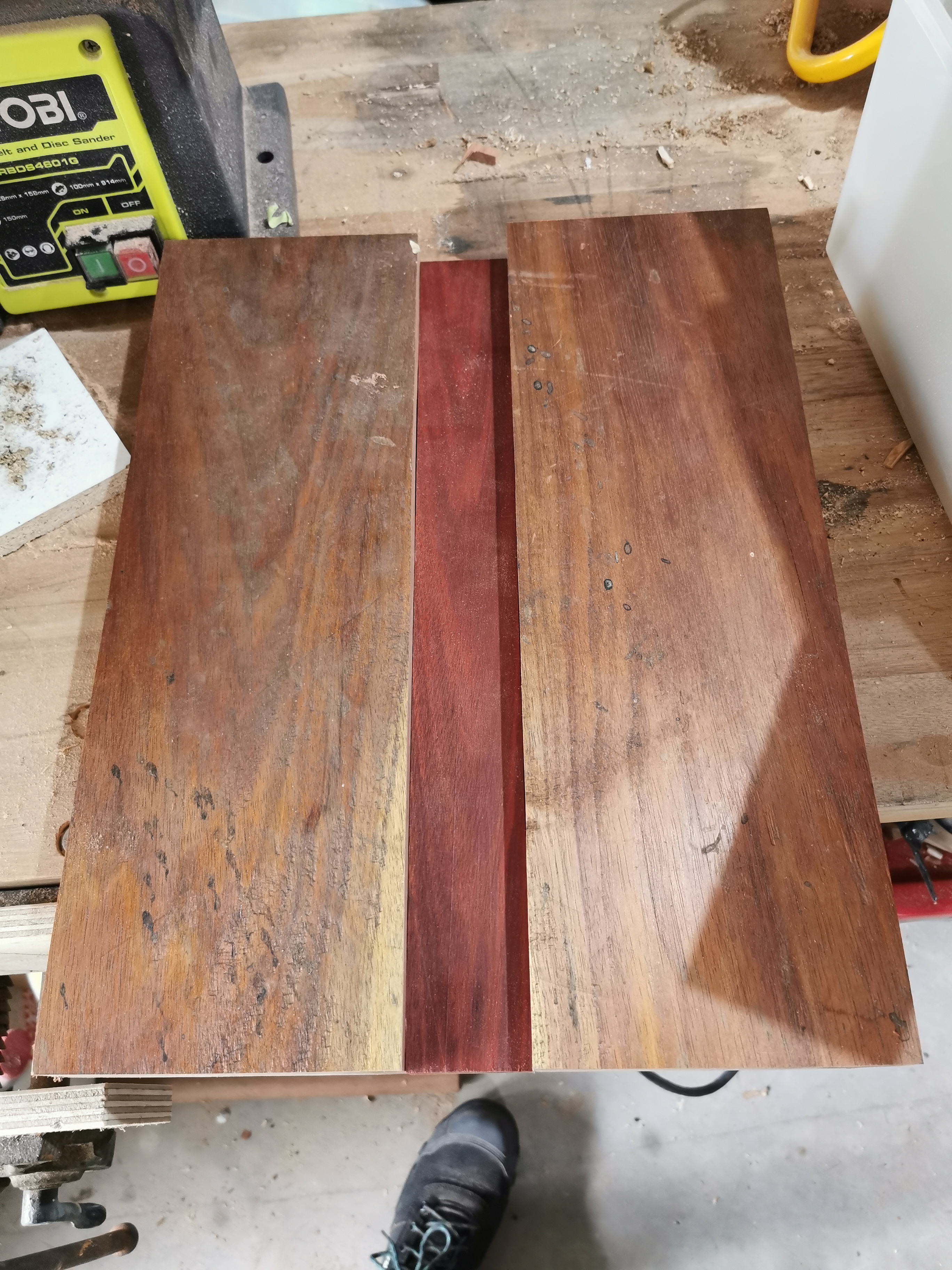

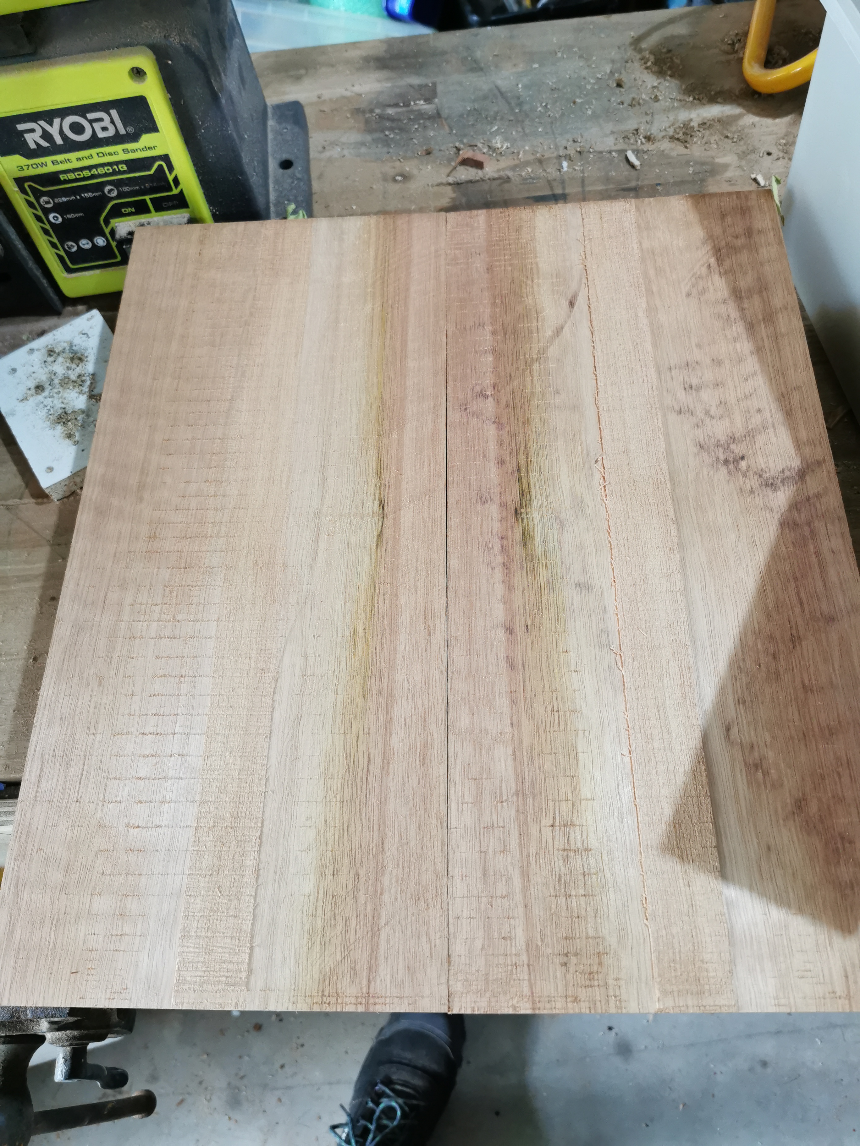

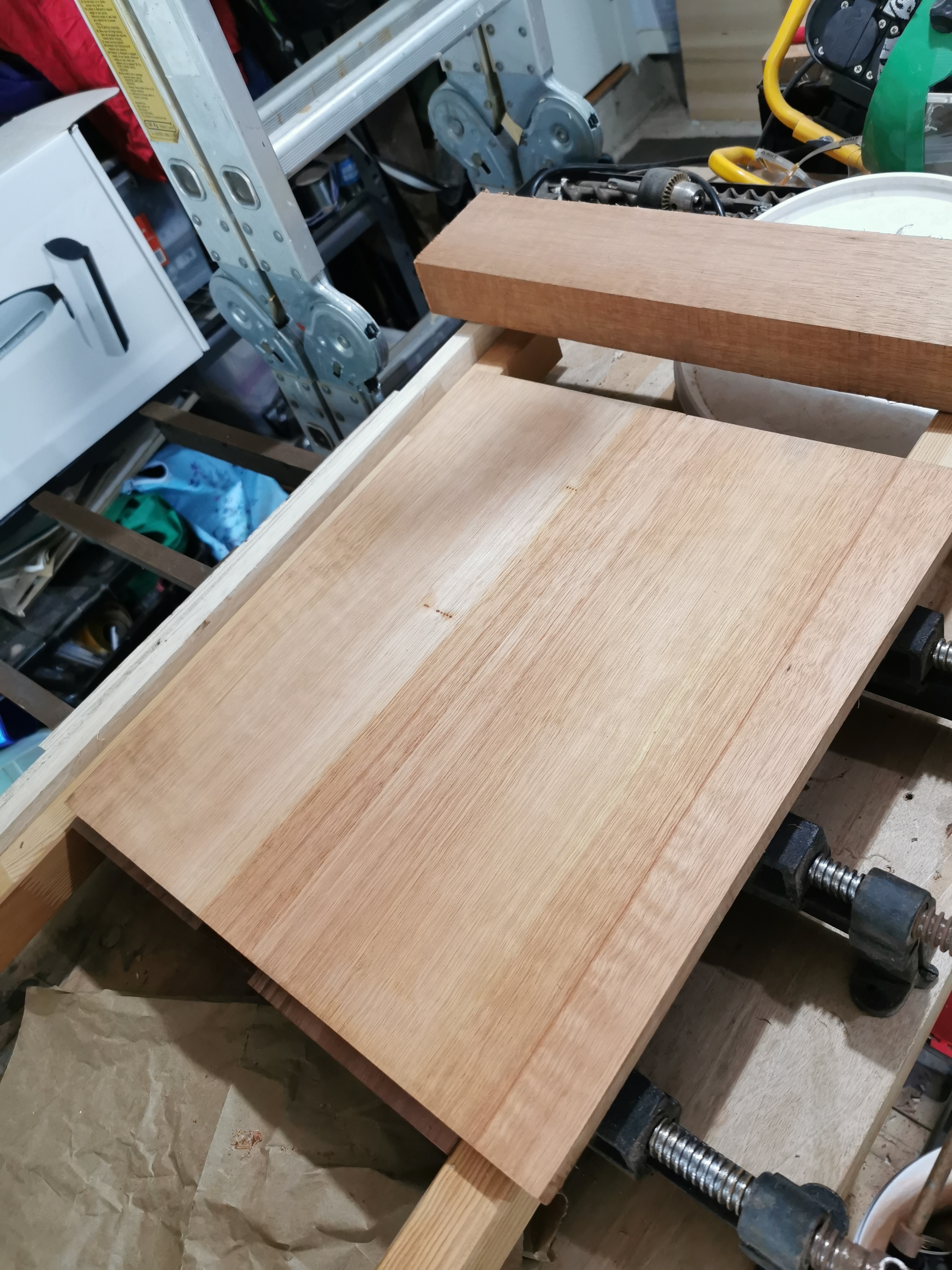

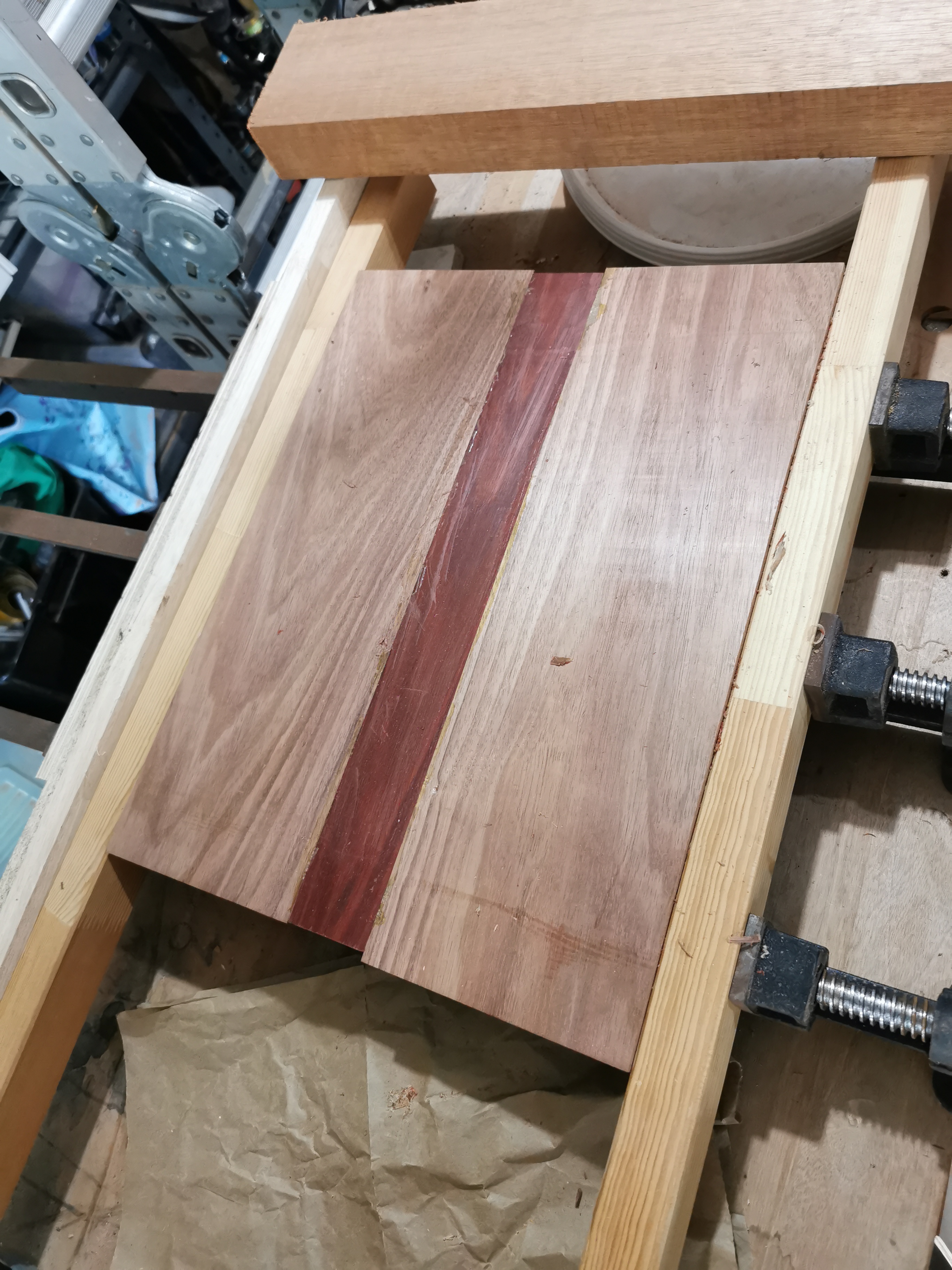

Top and body blanks run through the thicknesser and glued up. Neck blank is sitting on top in both pics (there was plenty of the QLD maple for the neck - and another one for another project too...)
I'll hopefully make a bit more progress soon.

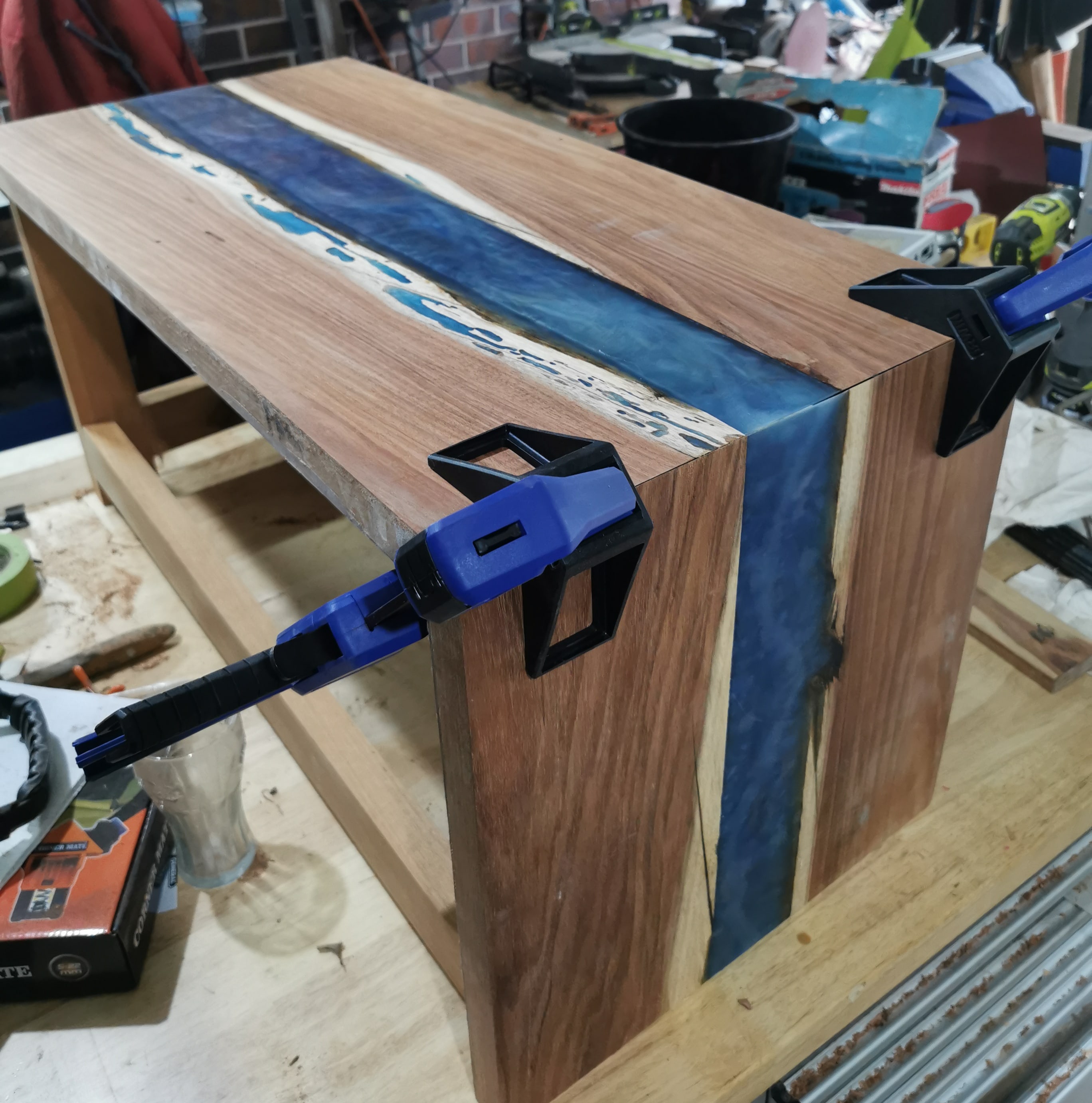

This is the project I have to finish up before I can get properly stuck in on my guitar build. River coffee table in Tassie Blackwood, white cedar and epoxy resin. There will be a shelf going in from some highly figured red cedar too...

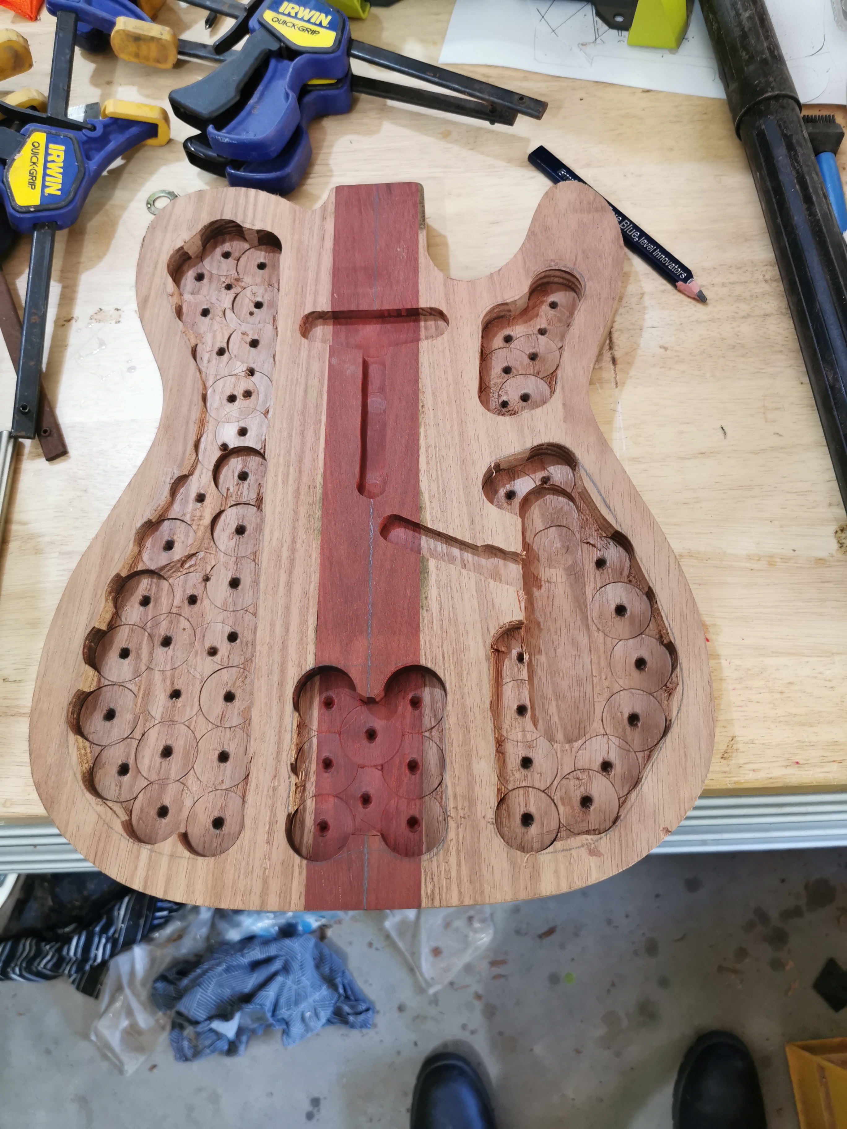

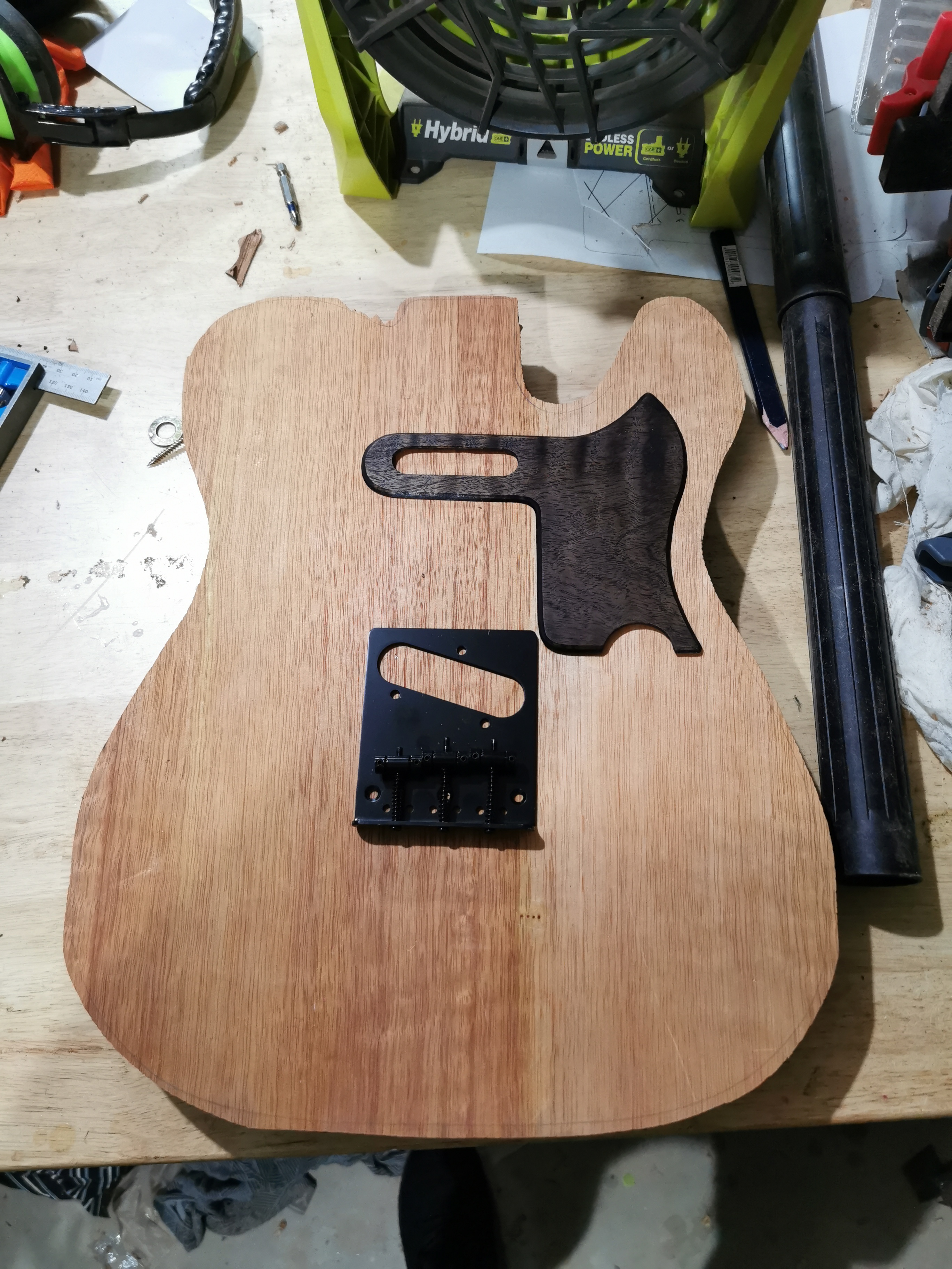

Some progress pics. Body glued up, shaped, and hollowed (as much as it's getting hollowed anyway...) I realised to late that I took this pic before I cleaned up the sides with a couple of chisels, but the top is glued on now and I'm not opening it back up!
The pick guard is made from a highly figured piece of Meranti I found at Bunnings. It was a $60ish board that was warped, (but incredibly highly figured), so I got it for $5! It's laminated to a piece of 1mm G10 (a fibreglass type composite material) and run through the thicknesser down to 3mm thick.

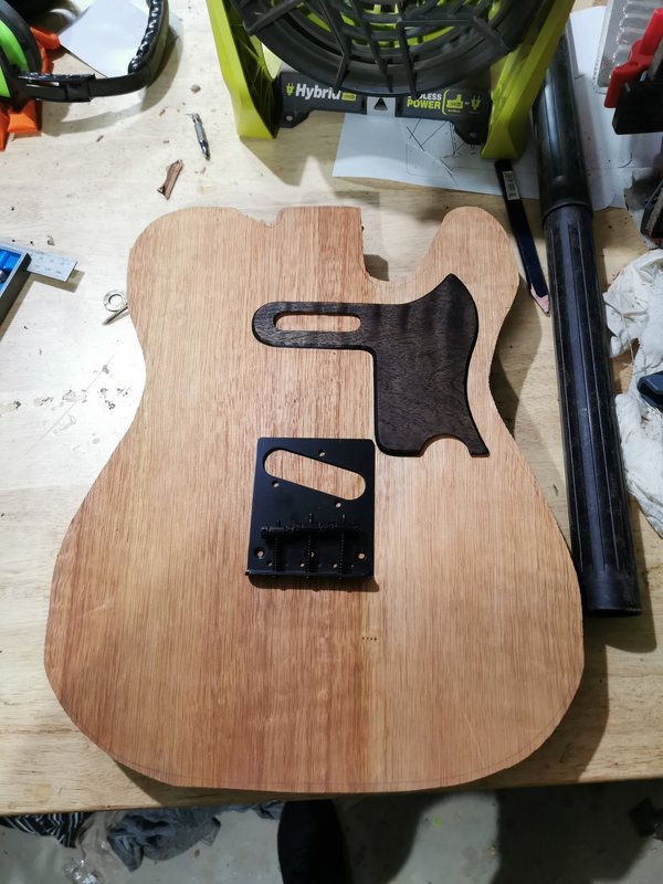

Top glued on, bridge and custom pick guard sitting in place to give a rough idea of how it should look when it's finished. The pick guard is made from a highly figured piece of Meranti I found at Bunnings. It was a $60ish board that was warped, (but incredibly highly figured), so I got it for $5! It's laminated to a piece of 1mm G10 (a fibreglass type composite material) and run through the thicknesser down to 3mm thick.

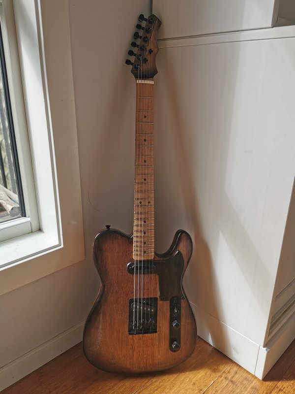

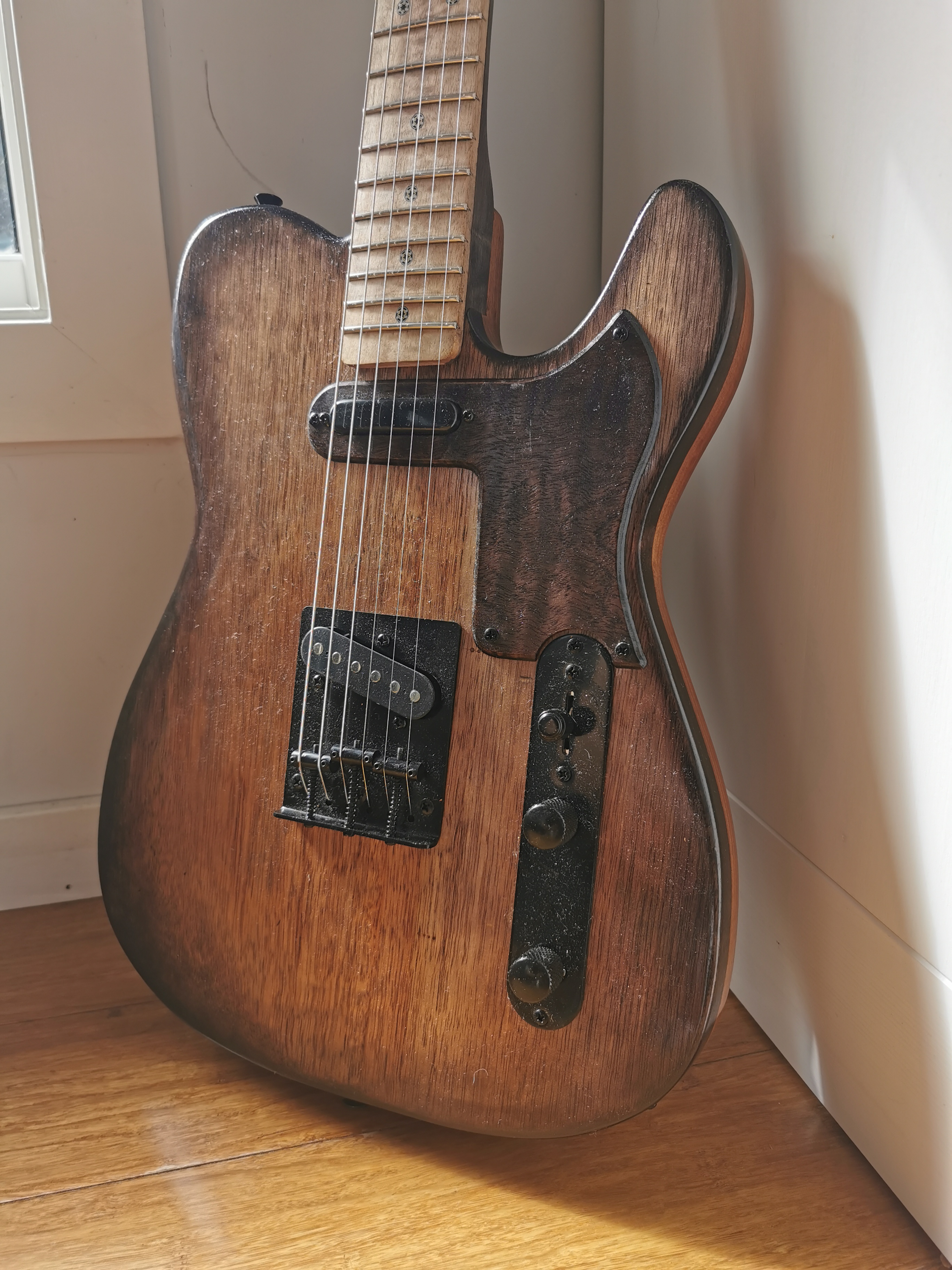

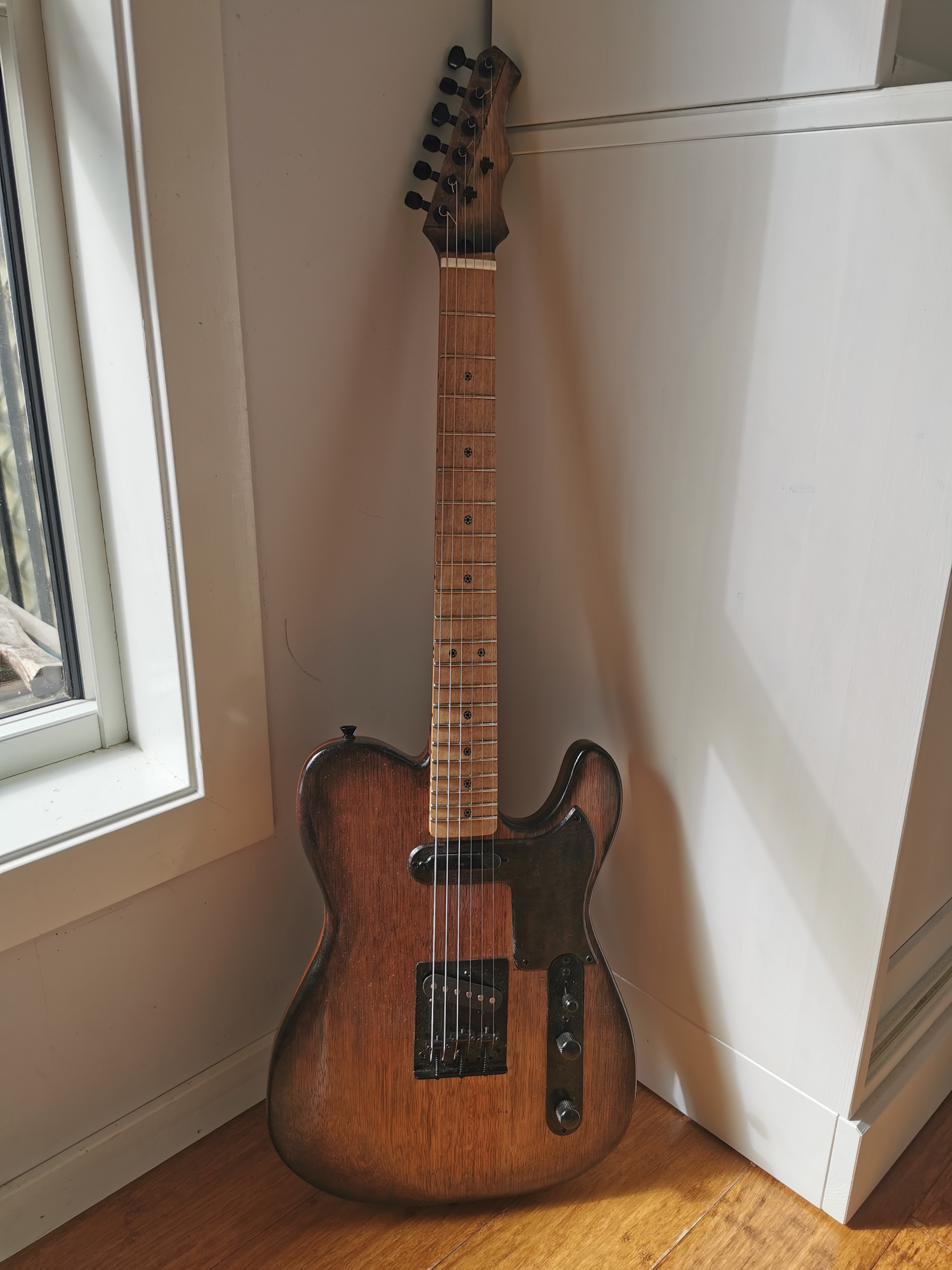

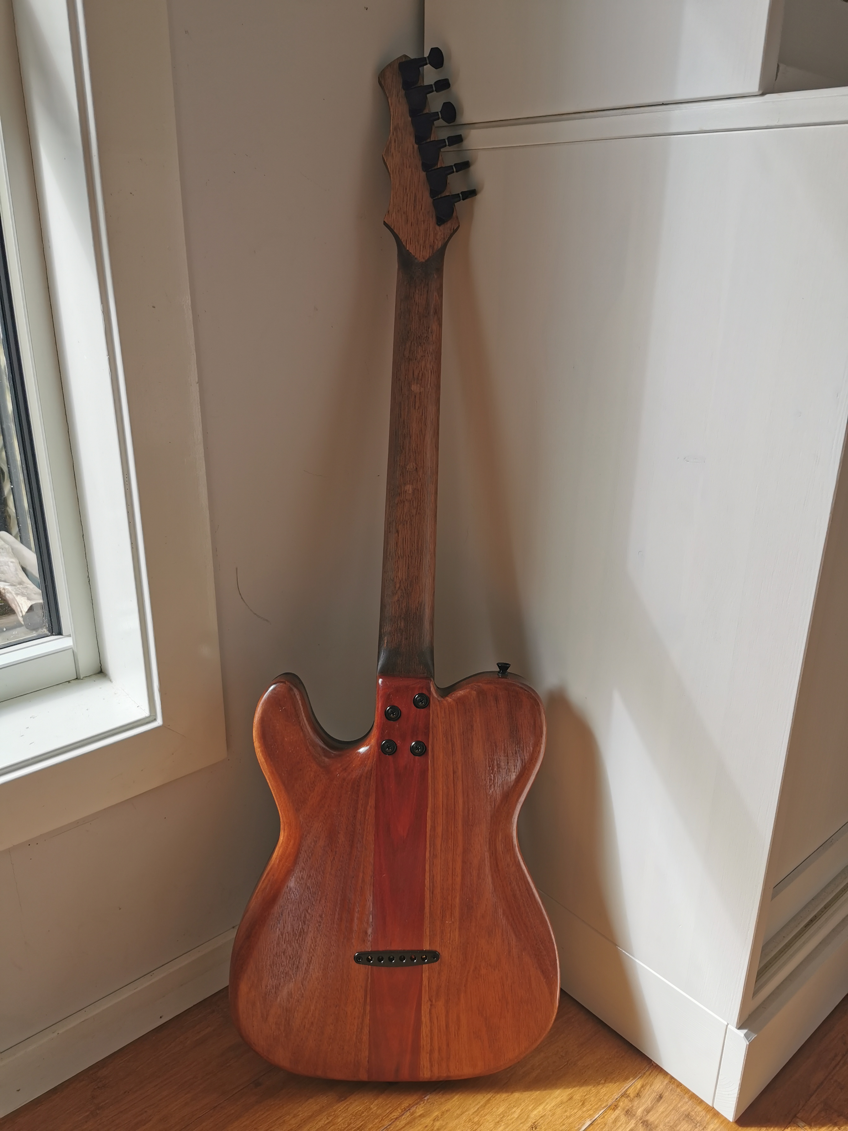

So it turns out I realised I never posted more pics of this, and it's been finished for quite a while now. When I have time, I'll try to go back and post some more of the progress photos, but here are some finished pics of my first ever build.
It's definitely not perfect, and there are a lot of things I would do differently if I were to do this same build again, but I'm happy with it - particularly given how long it took me to actually stop procrastinating and just start the damn thing!
