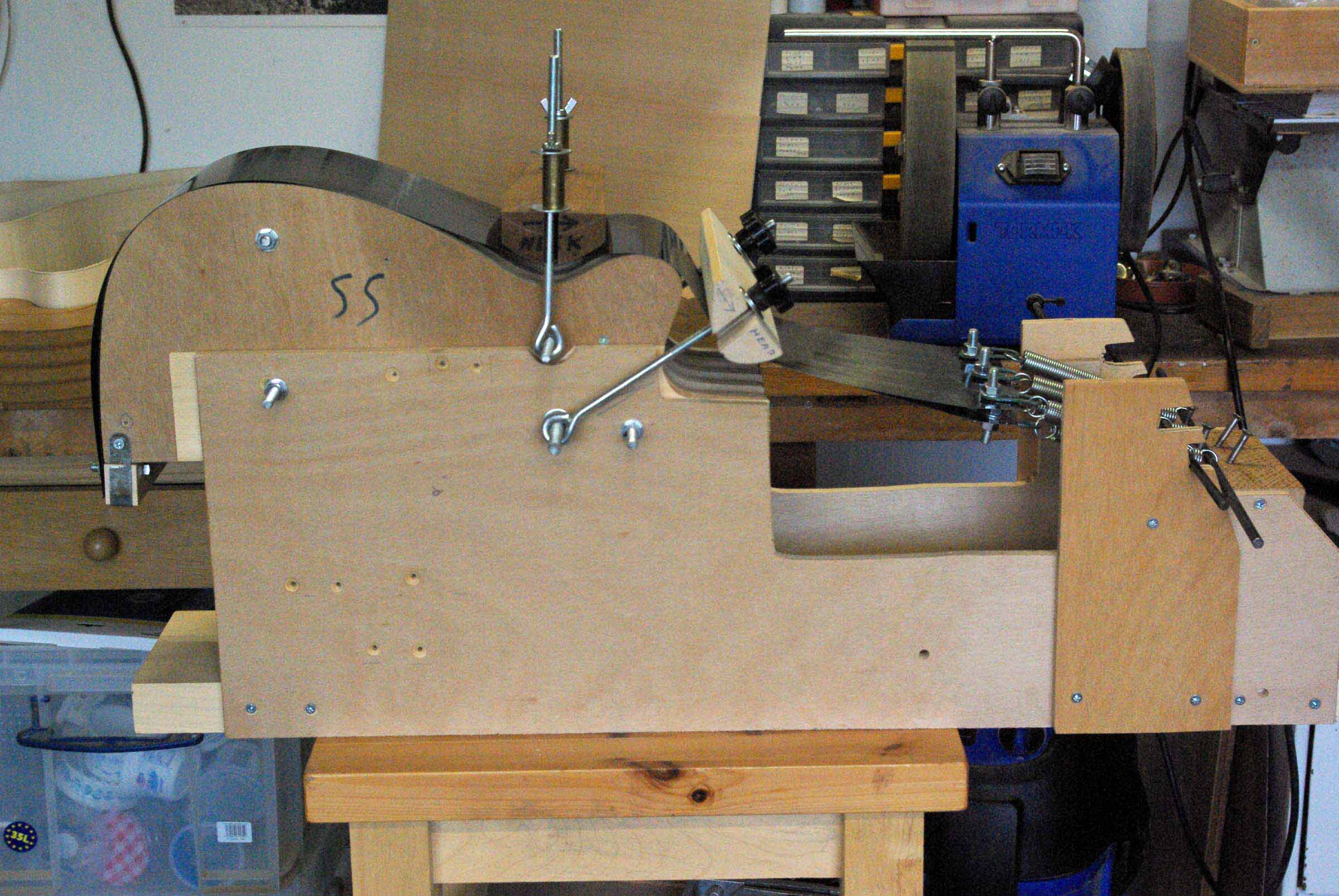

Bending non cutaway sides is fairly straightforward on an iron. Doing a cutaway is something else entirely. I know lots of people tell you it's doable, go slow etc but I have found it just really difficult. As a low skilled bender I decided to go with using a heating blanket and a fairly elaborate bending form that keeps tension on both sides of the double bend that constitutes the cutaway. ie keeping pressure on the outside of the bend which reduces splittting out.
This also means that I can bend the bindings at the same time so they come out pretty closely to the side bends.
This photo should give an idea of the jig. I have had no problem with cracking since using this for half a dozen or so sides. and I do do some pretty sharp cutaways I also go down to around 1.8 mm thickness on the cutaway sides.
