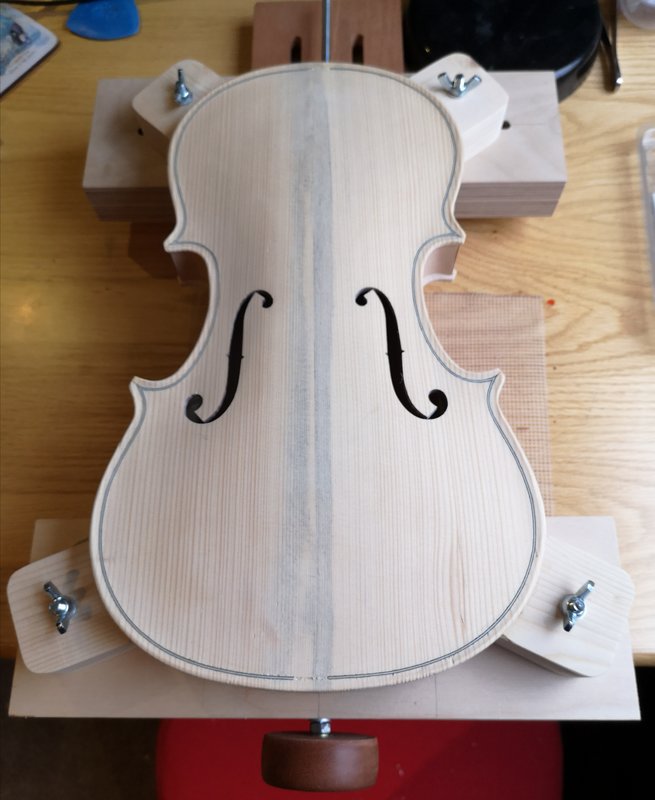

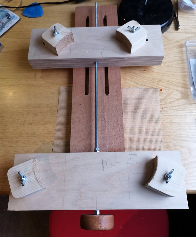

Just finished a violin vice/clamp based on a series of photos of a device made by Stephen Churchill, an American violin maker.
Seems to be functioning OK ; about to start my first solo - without my tutor breathing down my neck - neck mortise...bit nervous, hope I've measured it correctly.

Looks cool Simon....nice work.

Looks good. Im assuming it’s clapped to the bench? Where did you hide the clamp?

It’s funny that was what I thought. (As in clamping to the bench)
I guess we always try to imagine how we would use such a jig in practical terms.

See here for how Churchill secures the violin vice: https://stephenchurchill.ca/page/3/

Hi Guys, sorry for the long delay in replying. I added a 25mm battern on the base board that can either be clamped into a bench vice or used as a bench hook - not very stable, in bench hook mode but passable for some actions. The clamp makes life much easier for a lot of tasks and I'm glad to say it's been sometime since an instrument has unexpectedly left my work bench for the floor.
