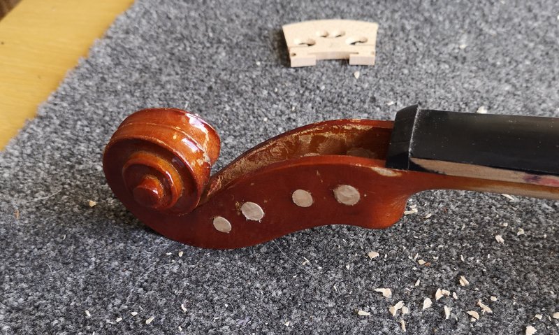

On more than one occasion, after bushing a violin pegbox, I've managed to ruin it by re-drilling the holes badly. I've always found this task difficult as there isn't an obvious reference point.
I've thought about making a jig for some time now and having just made a complete pig's ear of another bushing...

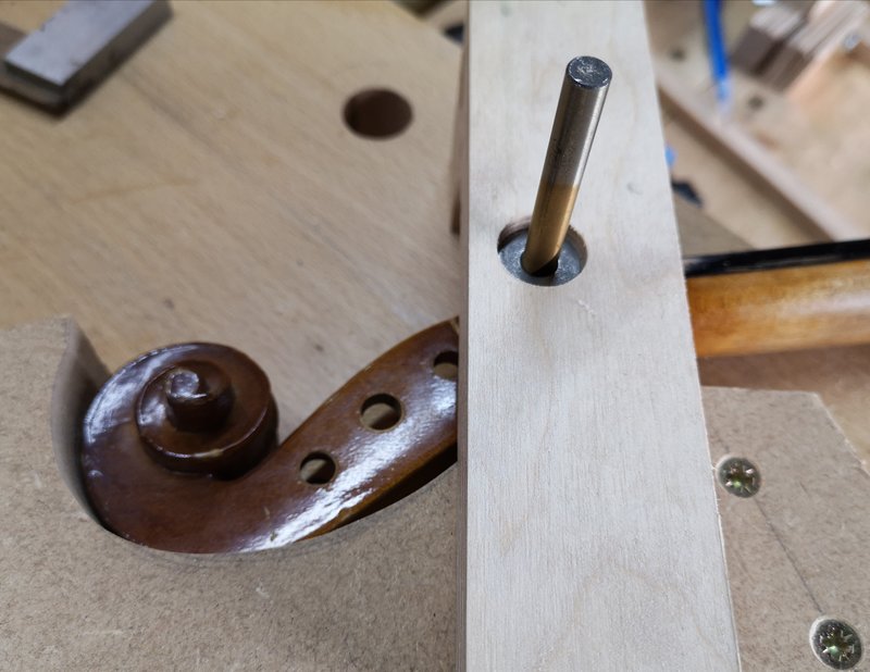

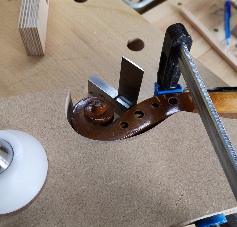

The jig, made from MDF, allows the pegbox to be firmly clamped in place onto my bench top bench, which in turn, allows sufficient clearance for the violin body.

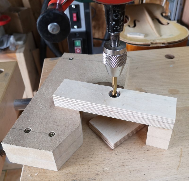

An engineer's square is used to ensure the upper walls of the pegbox; the most reliable reference point, are parallel to the axis of the drill. A steel drill guide is mounted in the bridge attachment which can be moved to the required position.
The jig could be used with a drill press but I always feel I can restrict the potential damage if I use a hand drill. There may be some shouting and throwing of heavy objects about later this afternoon on its test run, if I manage to destroy another bushing.

Unfortunately it wasn't too much of a success. Even with the drill guide clamped very firmly to the bench it woobled horribly. I ended up just drilling freehand with the engineers square along side as a reference. That gave a better result than my previous attempts. I thought I'd try drilling a guide hole on the bushing; I usually turn my own from pen blanks. Have you ever done this?
