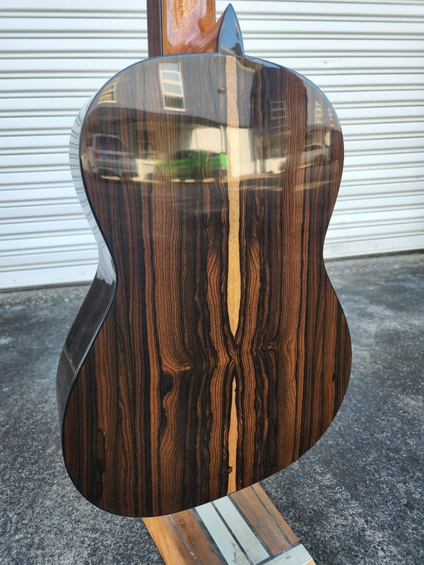

Steve.Toscano
Posts: 495
Location: Port Stephens NSW
Re: Ziricote splitting
Post by Steve.Toscano » Sat Aug 27, 2022 3:03 pm
I build a lot of ziricote guitars (solid NOT laminated).
A few things:
I leave everything a little thicker ~2.5mm sides, ~3mm backs.
Always flood with thin CA on the outside prior to finishing, and i seal off the insides with around 10 coats of brushed on shellac.
You'll find if its going to split, it will usually do it early on - as soon as sides hit a bending iron, or as soon as back goes into a radius'd dish. I have a had a few sets do this and have abandoned them - chopped up for headstock veneers/rosettes etc etc.
Yet to have any returns or hear about splitting in a finished instrument.

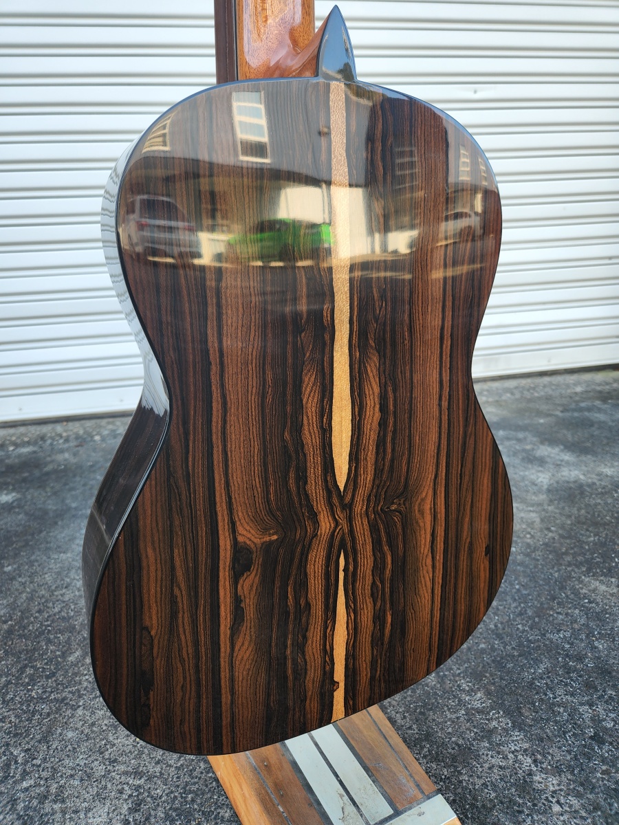

Bob_H
Posts: 166
Post by Bob_H » Sat Aug 27, 2022 6:25 pm
A few things:
Thanks Steve. Sounds like a solid approach.
