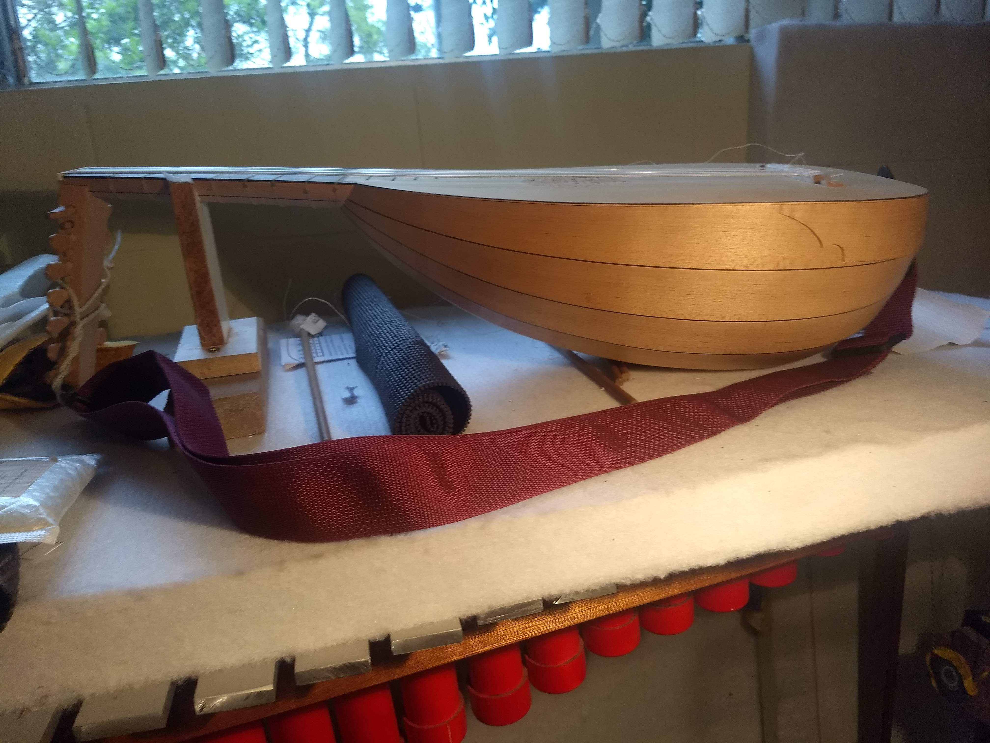

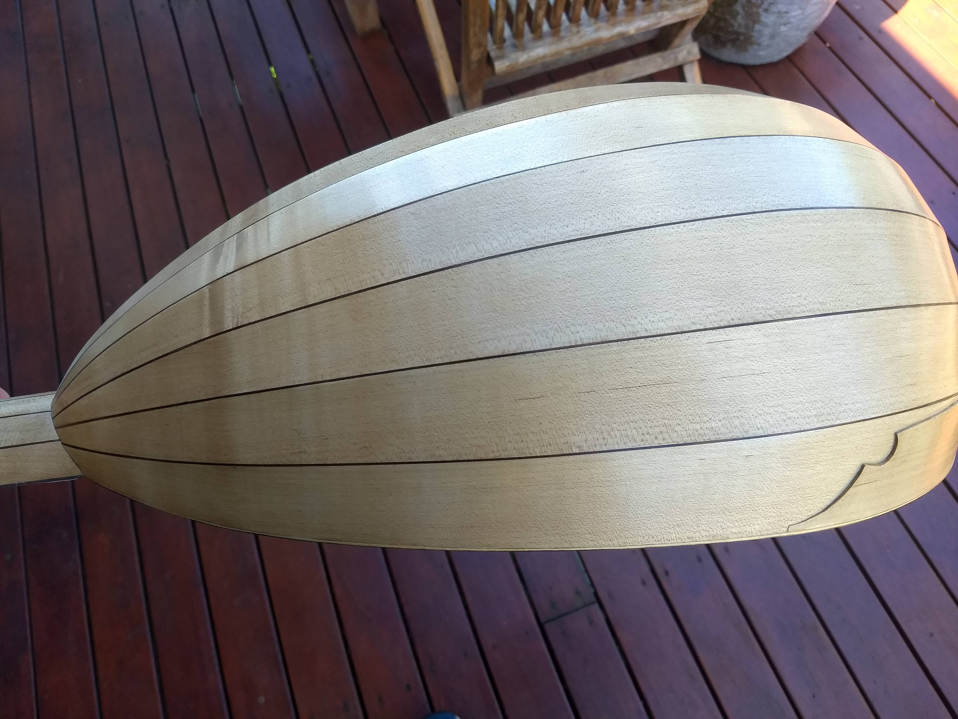

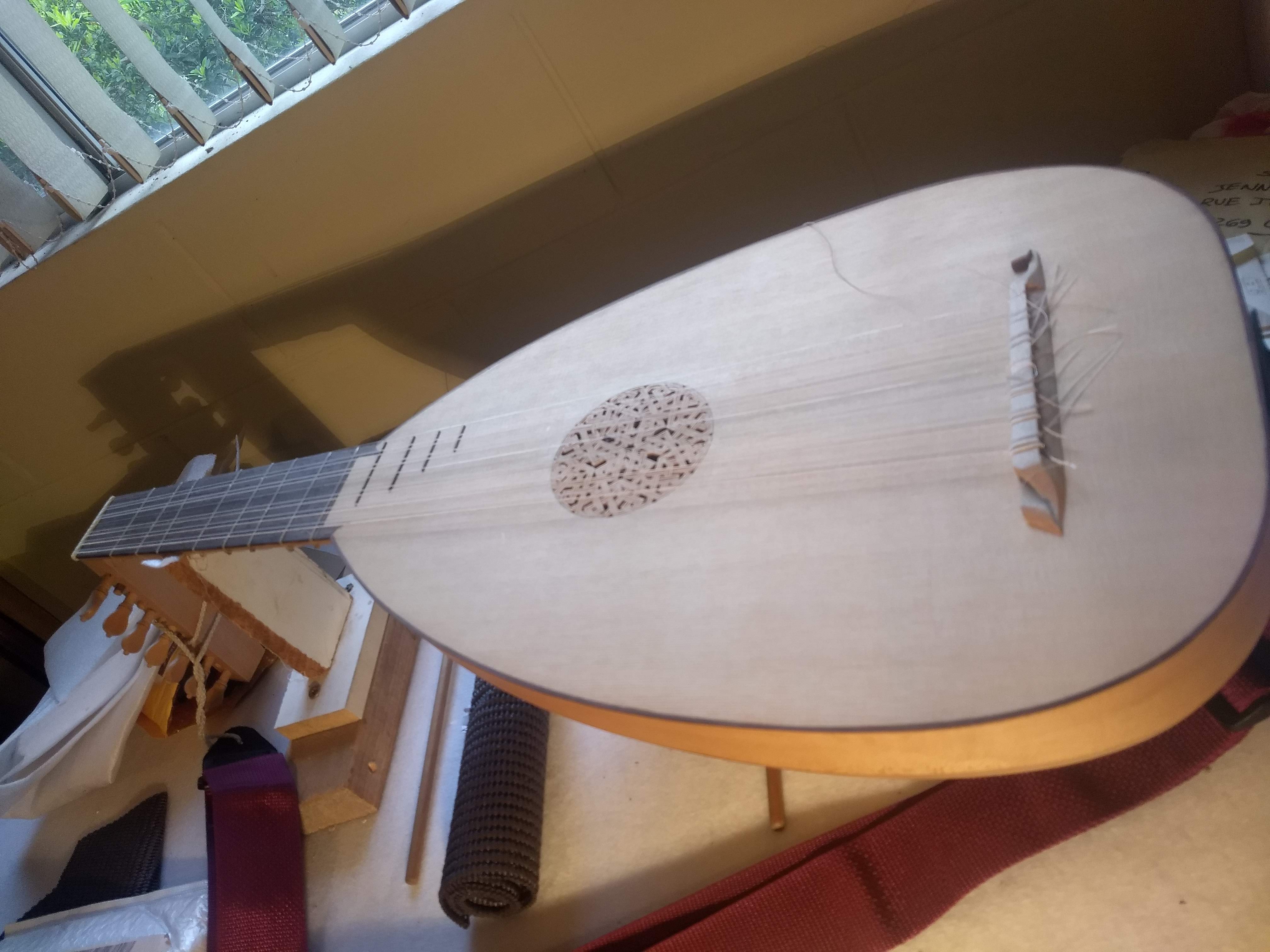

So this is my lockdown lute made according to the David Van Edwards tutorial.
I strung it up to see if it would fall apart, but so far it seems it holds together. Before I learn to play I need to decide on the finish. So far it has just a little bit of Danish Oil. Van Edwards says a beginner should avoid varnish if possible, but for lutes made of light wood (mine is all maple) you should varnish it to look like honey. The picture attached is in a halogen lit room and the lute looks a lot lighter in better light - if the rain stops I'll take it outside.
Before I do that I'm looking for advice. The tutorial says 3 layers of clear varnish to protect the wood, 3 layers of colour, 3 layers of clear to protect the colour, then polish. The Sydney String centre website says they stock Hammerl violin varnish but I haven't asked them in person.
Do I have options, or are there other products available (the String centre is only 10 mins away and I have to go past Bunnings)? Martin in response to my introduction said he plans to French polish his own lute. I've never done this and it sounds even more complicated.
Should I be happy with my oiled lute and just learn to play it?
Thanks for any ideas

Re: How to finish a white lute?
You did a fine job on that lute...magnificent looking instrument. What strings did you fit and where did you get them from? Did you turn the tuning pegs yourself?

Thanks Martin. I've very happy with it, even though I know where all the imperfections lie
The strings are La Bella nylon from Strings by Mail. Only about $20 for a full set, but the 3rd course kept breaking, even tuning to A415Hz. I don't think it's a sharp edge on the nut, so I'm going to try nylgut from Aquila once I've decided on the finish.

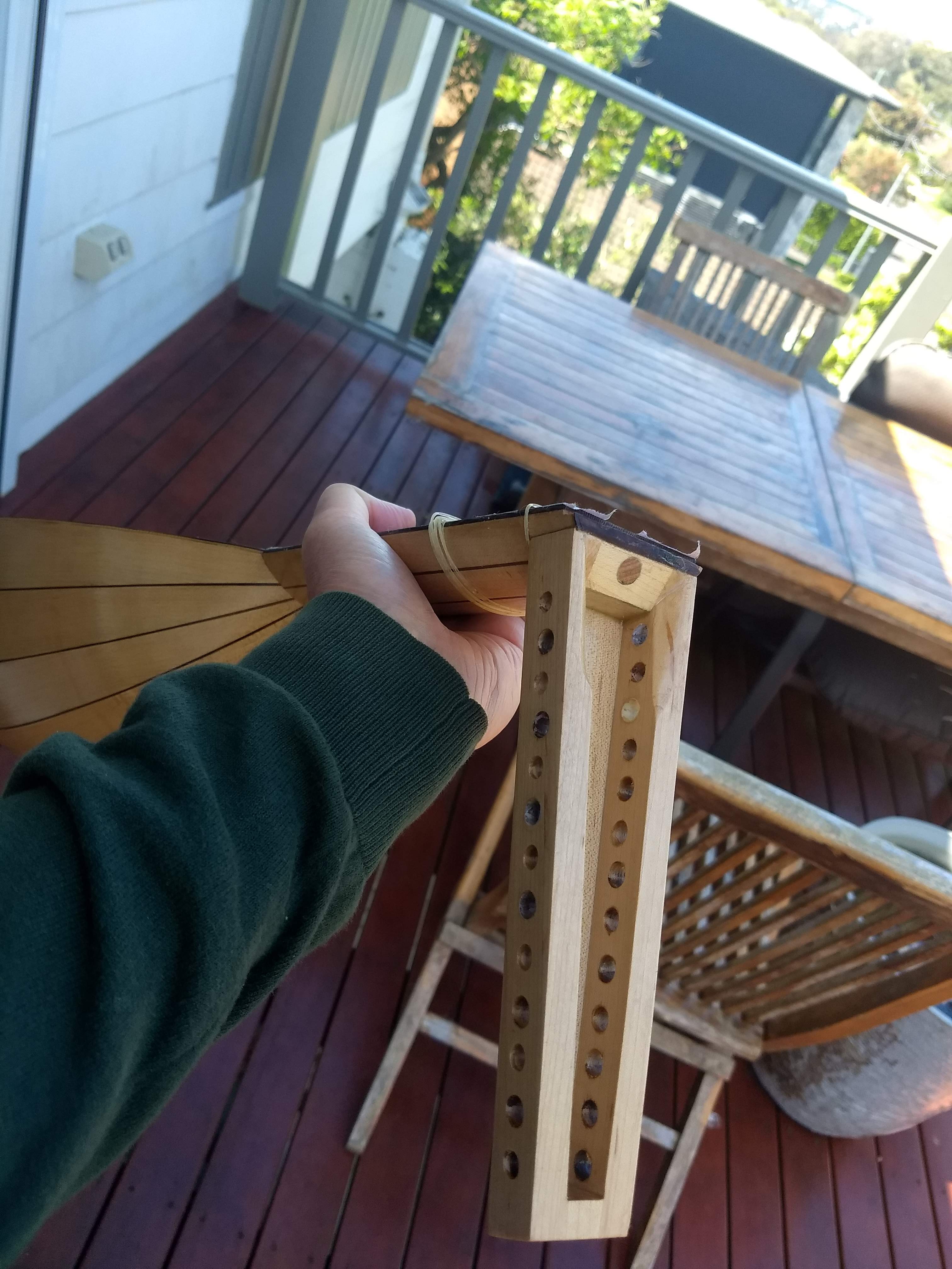

I was going to do the pegs - the local woodturners club has moved to my suburb and I went up to say hello. They were happy to help but Covid stopped it. So I bought some from ebay made in India (about $50 for a set of 13 in boxwood and delivered in a few days). They are a bit narrow, don't match my reamer properly and I made the holes a bit big. But I made some bushings for the worst holes and it all works ok. There is plenty of wood to ream up for larger diameter pegs if it ever comes to that.

I will add my congratulations for a fantastic looking instrument, which definitely deserves to be played so you need to get about learning to do that!
As far as finish is concerned there are many options. I agree that a traditional instrument like this probably doesn’t want a modern spray lacquer finish, and you are probably not set up for that. I would go with a hand applied finish and the two main options are French polishing with shellac, or a hand applied oil finish. FP is traditional, can be managed with a DIY setup, and can look great. Drawbacks of FP are that it is slow, requires many many sessions of application, and is not the most hard-wearing of finishes. Some of the regulars on ANZLF are very successful FP experts and can advise you.
My personal vote would be for an oil finish. You have already applied some Danish oil so you know how easy it is to do. But Danish oils (there are many different brands and recipes that carry that name) don’t tend to have great durability either. Best for instrument finishing IMHO is either Tru Oil or Evo Hard Wax oil. Both have the same ease of application as any oil finish but they produce a very hard and durable finished surface. Like all finishes they are repairable. If you need to fix something you can just sand it and then apply more oil on top and it blends in invisibly. You can get them to high gloss if you build up any layers and then level and buff. But if you want a nice satin natural look you can get that after 4-6 coats and rubbing back with steel wool.

This is what it looks like with 3 layers of Osmo PolyX. I've polished off some dags with 3000 which seemed to leave no trace. Didn't even take off the frets. The soundboard I will leave for now. It's got a light layer of Danish oil - mostly to stop masking tape pulling fibres from the Englemann Spruce. I might try the egg white on a scrap to see how it goes over the oil first.
The Osmo was available in a shop nearby so I bought it despite the price (about 4x per litre than Chivas).
I'll give it a couple of days to cure a bit more then get cracking with stringing up, and now the nut is off I can go over the grooves again.
