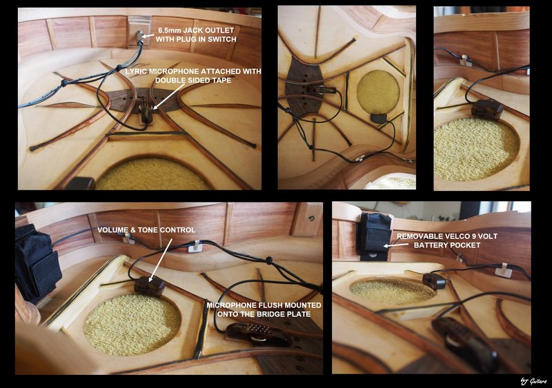

For a guitar pickup I like the sound quality of the LR Baggs Lyric Microphone. For an 'X' braced guitar the microphone is normally mounted horizontally on the front of the bridge plate. To get the best performance the microphone needs to be mounted flush on the bridge plate and this is not feasible on a Falcate braced guitar. My solution is to rotate the microphone 90 degrees and add a patch above the bridge plate so the microphone can be flush mounted. Mounting the microphone this way has not affected the sound quality.
I also prefer to mount the removeable velco battery pocket on the neck joint. This involves glueing a plate with holes to access the bolt on neck bolts. I glue on a cloth for the velco to attach.
See photos.
Installation of LR Baggs Lyric Microphone on Falcate Braced Guitar

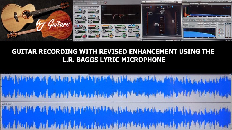

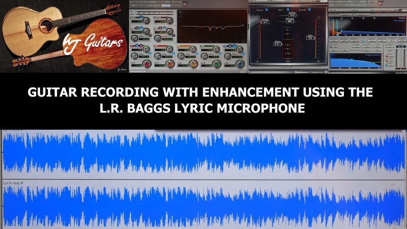

Re: Installation of LR Baggs Lyric Microphone on Falcate Braced Guitar
As an addition to the acoustic 'Guitar Recording Comparison' youtube video I have produce another youtube of the Audio track of the 'L. R. Baggs Lyric' microphone with enhancement and effects. See link below.
https://youtu.be/AfbvcSR1oUI
These improvements support the use of the 'L. R. Baggs Lyric' microphone for both live performance and recording using a suitable D.I. box with good quality EQ. control and adding reverb with a compressor certainly helps to achieve a high quality audio.
- WJ Guitars
- Posts: 411
- Location: Sutherland NSW
Sorry about this.
Please disregard previous post as I have not found a way to edit this posting. I have revised the video due to the previous video overall length being too long and had the wrong audio track. The edited video is now shorter with the long blank ending removed and enhancement tools used are now shown throughout the revised video with the correct audio track. See new link below.
https://www.youtube.com/watch?v=GRllrlRuEW4
