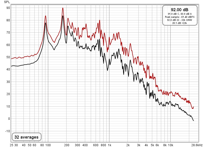

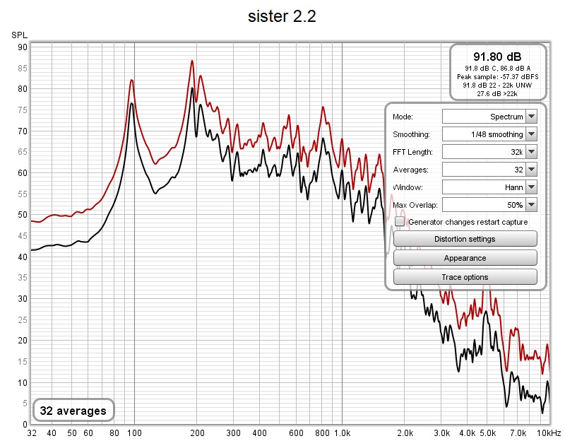

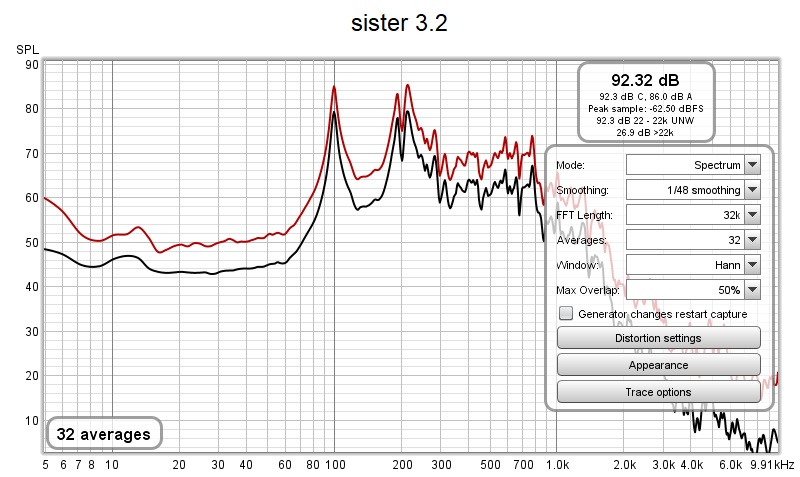

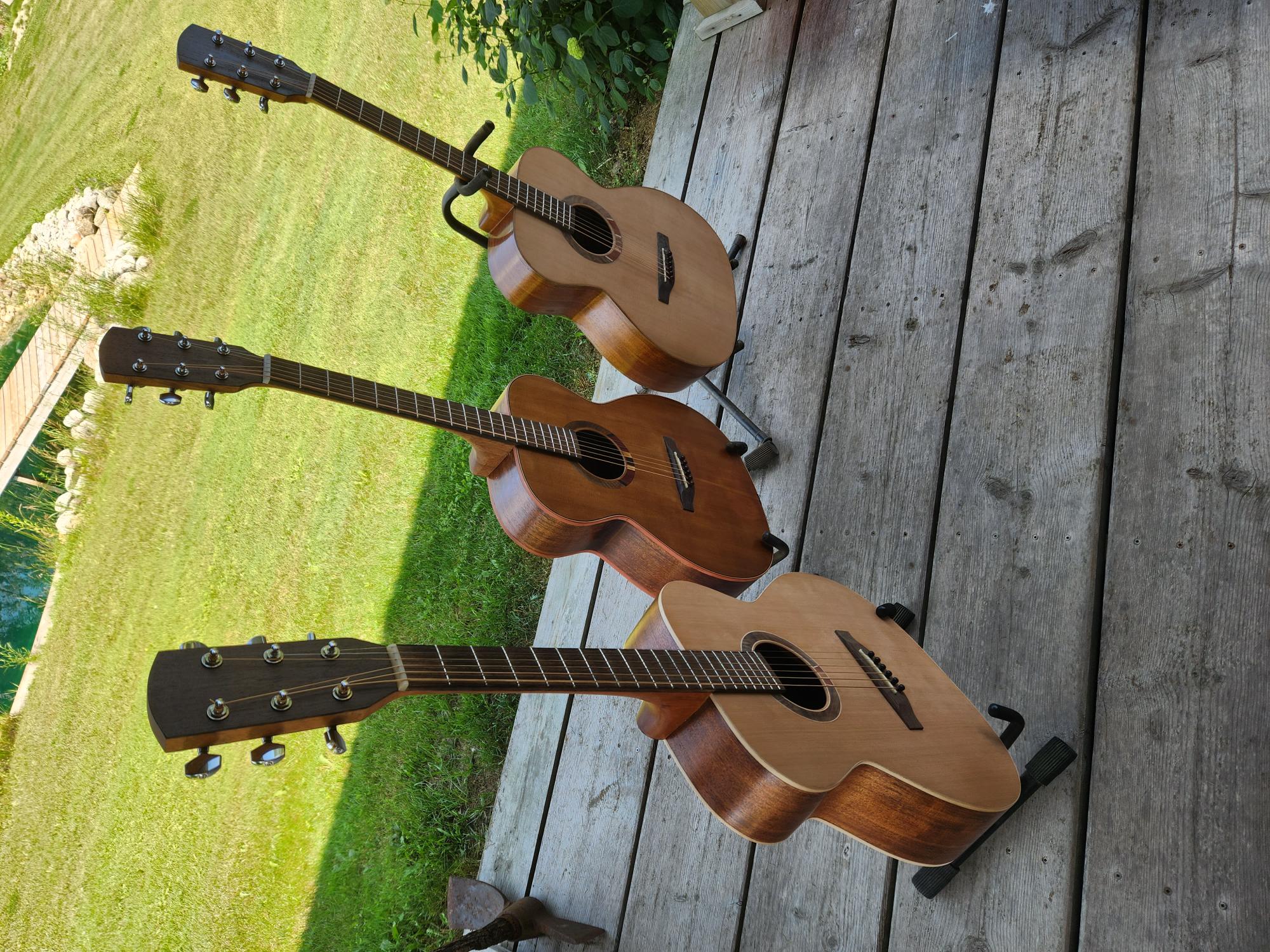

At long last I have managed to complete this years three guitars.
The three sisters proved to be more trouble than I imagined, that' sisters for yah!
The details of the guitars are in the conversation string.
I have attached sound profiles using REW software and UMK-1 mike.
Any thoughts on these files would be appreciated.
In my effort to build identically to see how much variation I have in construction technique I note the following
sister 1.1 file I had to sanded out scratches from thumb nail (careful with those cedar tops) so thinner than target.
sister 1.1 file I used solid linings (debate on this is still out) but I think directionally good.
sister 1.1 file has a body depth 1/8 greater than the other 2 at 4.375" (in the past I have made much thinner 3.5 for a punchier sound)
Subjectively they all sound like short scale OM's. The Cedar tops did not in any way make a lower volume guitar or less bass response.
My sound preference was in order 1 followed by 2 followed by three with one being the loosest or warmest of the three.
I note that I did laminate the main cedar X braces with 1.25 mm mahogany on the outside edges. Using guidance from commentary on this site I used young's modulus to mimic the strength and weight of spruce to get a place to start the carve. They were 9 x 18.4 mm and much stiffer than any spruce brace I have started with. while I initially carved/tapered the bracing to specific dimensions, after closing up each box I began to realize that I could not recall the flexibility of the previous tops with any accuracy.
Any thoughts are appreciated.
That's the story for this year

Re: Bridge length on WRC OM build
Nice work Doug and thanks for putting up the data.
I've done a couple of paired builds and they were endless trouble.
