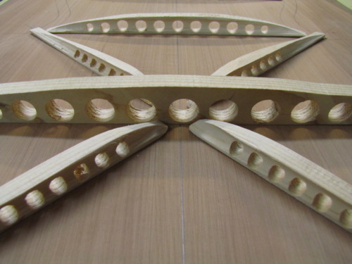

Re: Shape of Braces - Is conical cross-section the best shape?
Post by kiwigeo » Wed Feb 08, 2023 8:44 am
One makers take on I beam braces.......comments anyone?
Dave M
Posts: 629
Location: Somerset UK
Post by Dave M » Wed Feb 08, 2023 10:31 am
That’s interesting Martin.
On a classical the brace height is so small that putting holes in it probably won’t do much.
However the big x brace on a steel string may well be worth thinking about. As I understand it the stiffness of a beam is not reduced by much if you take material out of the centre. (And please correct me if I am wrong) so one may be able to get a significant reduction in mass for not too much loss of stiffness for these big braces.
A proper engineer could set me right on this. Is Trevor perhaps listening in?
Post by kiwigeo » Wed Feb 08, 2023 11:16 am
I believe that is correct but Trevor will be along to the pulpit at some stage to preach the truth :)
Post by kiwigeo » Wed Feb 08, 2023 11:17 am
That whopping great X brace...surely a tall conventional brace would have far less mass and just as much if not more stiffness?

Post by TomBeltran » Wed Feb 08, 2023 4:22 pm
On youtube, there is a video called "Guitar Physics and the i-beam bracing," which shows the construction of the I-Brace, using a router. It is at the 16 minute mark. I had heard somewhere that Mossman had changed from the I-Beam brace to holes in the braces to lighten them. A few builders are doing what Kiwigeo shows. Kinscherff guitars does them sort of like that. It might be fun to experiment with, but it seems to me that the I-beam could be the same height as a regular X brace, so it might work better.

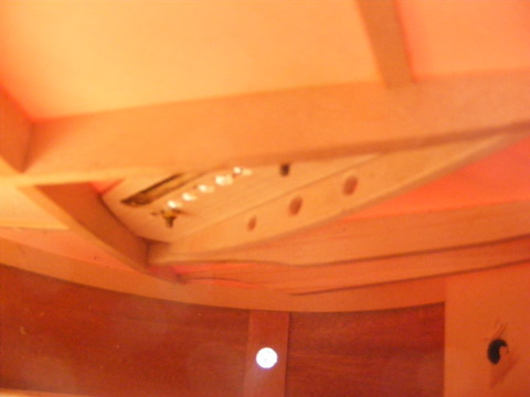

Post by Taffy Evans » Sun Feb 19, 2023 9:43 am
Hi, over the years I have often added a brace to a top to stabilize a repair on certain guitars. To limit the amount of extra mass introduced to the top I have at times put holes in the brace. Here is a photo of an early repair using this idea.
Sorry for photo quality
