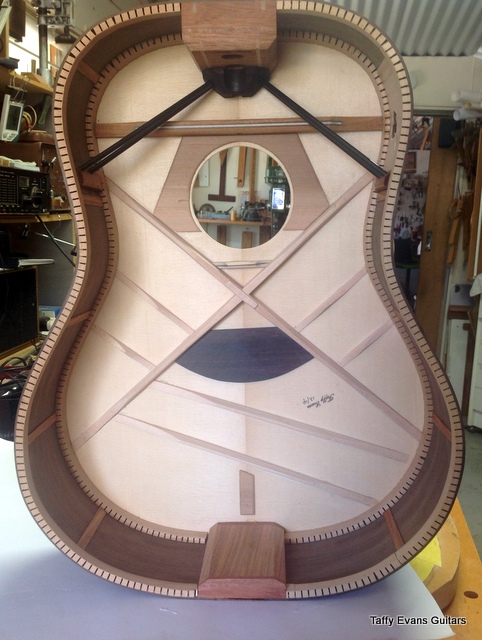

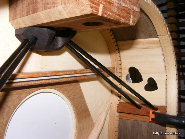

Hi, my use of carbon fiber has mainly been limited to neck reinforcement and at times brace stiffening and not much else. I only just recently saw its use in guitar tops when I visited Alans [ozzibluesman] workshop and he showed me how he uses it.
In the braces shown, the main cross brace and the smaller one at X brace, the carbon fiber was laminated with maple so that I could get it to be a tight fit in the saw cut in the brace itself. Also as can be seen I used solid carbon fiber rods to buttress the neck block in this twelve-string guitar.

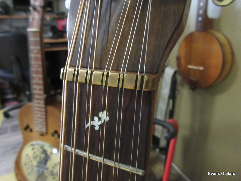

I had not given carbon fiber a thought for nuts and saddles. But I have just polished up this brass nut to go back on a Twelve-string guitar I built in made 1978 and nearly finished restoring.
Cheers Taff
What is the golden nut made of?
Posts: 1076
Re: Carbon fiber Nut n saddle
Post by Taffy Evans » Mon Feb 20, 2023 8:41 am
Hi, that fingerboard nut is made of brass. I'm putting this old 12-stringer [ #3 ]back to how I first built it so I'll try the brass nut and see how it sounds. Cheers Taff

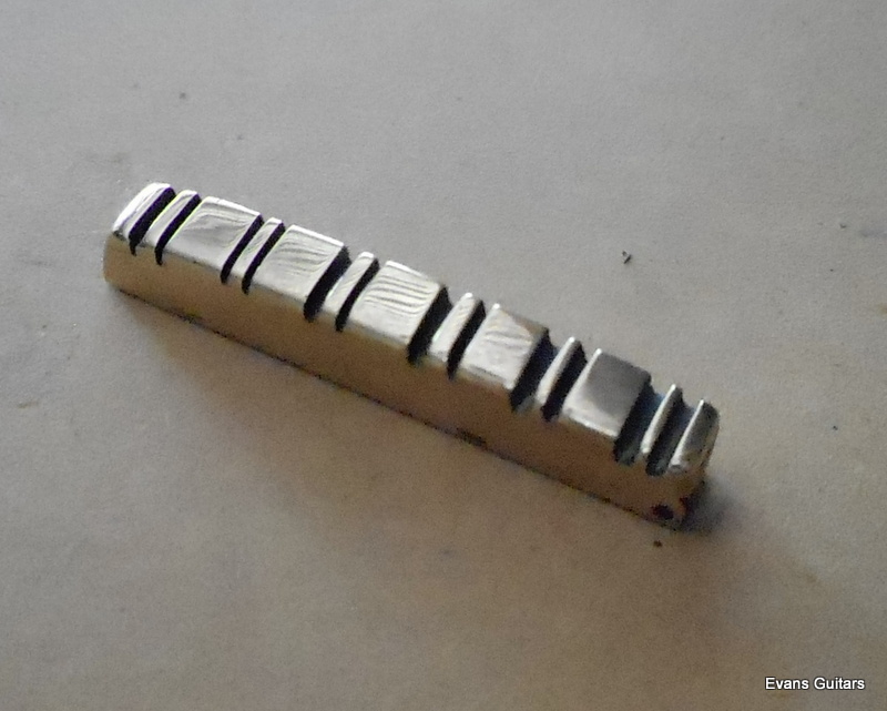

I made a couple nuts from aircraft grade aluminum for a couple electric bass guitars a few years ago. I was fixing them for this dude that was in a metal band, and the way he would beat the hell out of his instruments, I knew a bone nut wouldn’t survive long.

Hi, I have strung up this old 12-string guitar using the original brass nut, and have to agree with Alan's comment above, it does not add any more of a bright sound than do the frets when playing up the neck. No difference that I can hear.
:o I know, I know the strings are too low in their slots, I was new to the game in 1978. :lol:

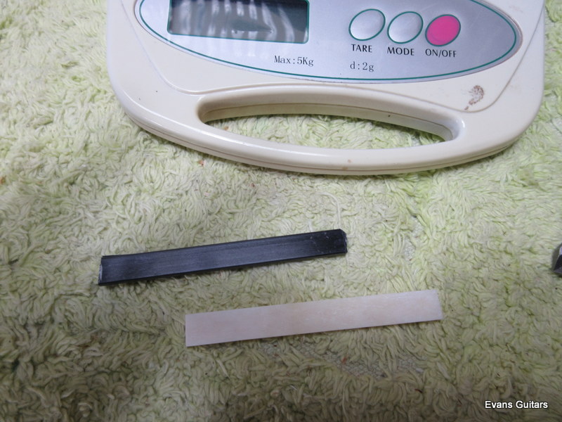

My main reason for this idea is weight reduction. I know it’s just grams. Did you do any weight comparisons?
I just weighed one of my bone saddles - 2.1 grams. I don't have a CF saddle handy, but i'd take a guess for the same size it would be 0.5 - 1 gram.
So yeah, a micro saving.
You'd be better off using tusq I reckon.

Hi Steve, I had some carbon fiber with the same dimensions as a bone saddle blank, so I weighed them. Bone 6 grams, CB 4 grams.
