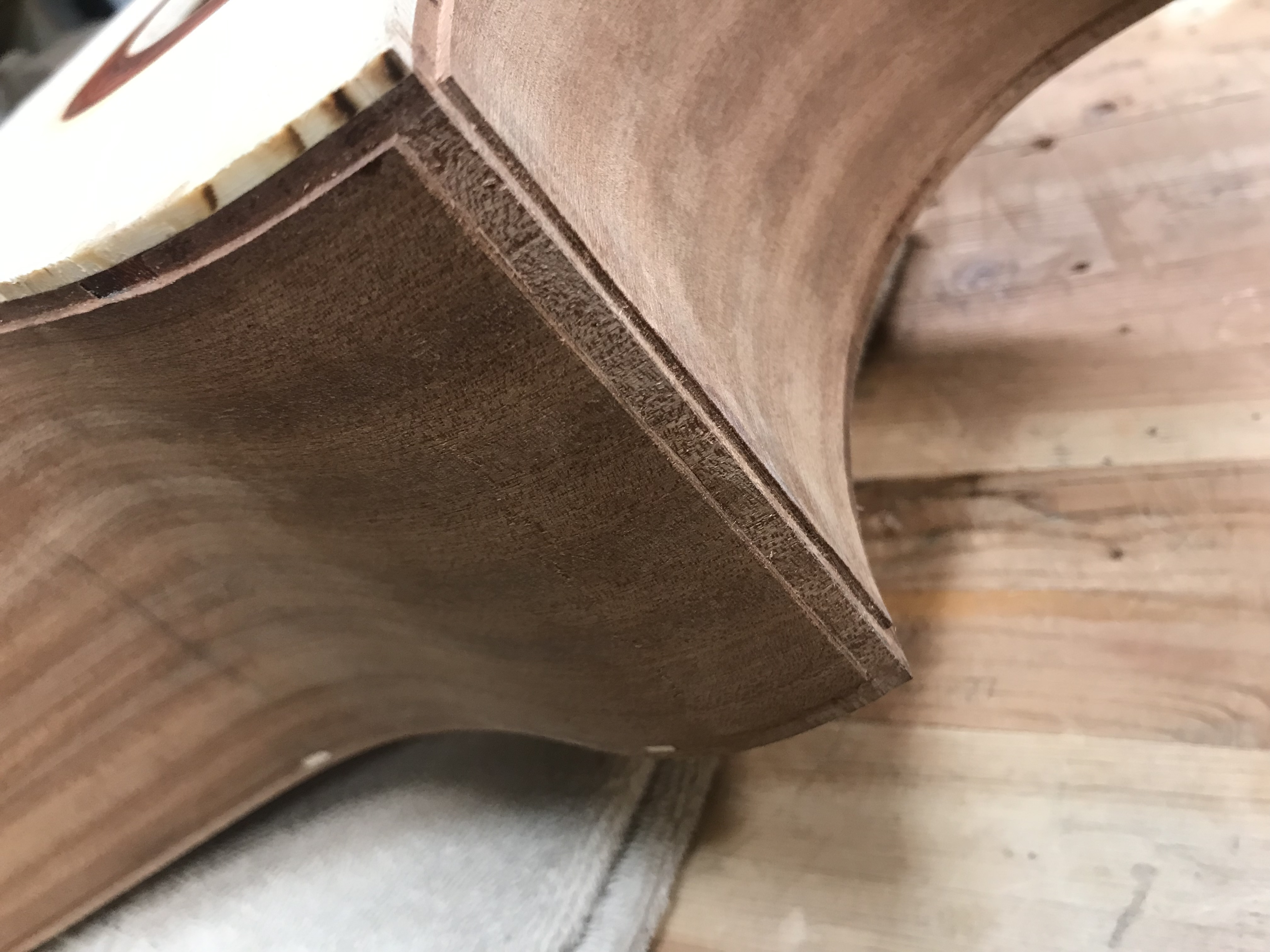

That’s a sharp tip on that guitar, I’ve never built tgat guitar but both of your options work. In my opinion cutting ledges in sides for binding size pieces with the miter carefully cut would be easiest and strongest. The entire tip being one piece would probably pop off if dropped or slammed.
I like this method which is pretty standard on acoustic. Impacts won’t jar it apart and it’s easy to repair in those unfortunate events. First line of the binding and score side with knife on each side, shallow and slowly use chisel to cut ledge and continue to score the initial cut as the depth increases. Use a flat fine grit file that has smooth end/edge to flatten, (it’s all round but the binding is flat, so I just run it flat, and after final sanding sides, there is no visual flatness)
Placing the piece of binding on the ledge, score the body side with knife for each piece. Then shave the miter with sharp chisel. Hit miter with sanding block lightly.
I get mine so tight there is no sign of joint.
Plus if you over cut the binding at all, it’s a small piece and just make another.
Idk if you’re asking for all this, but I figured I could share , hope you get it looking killer!
