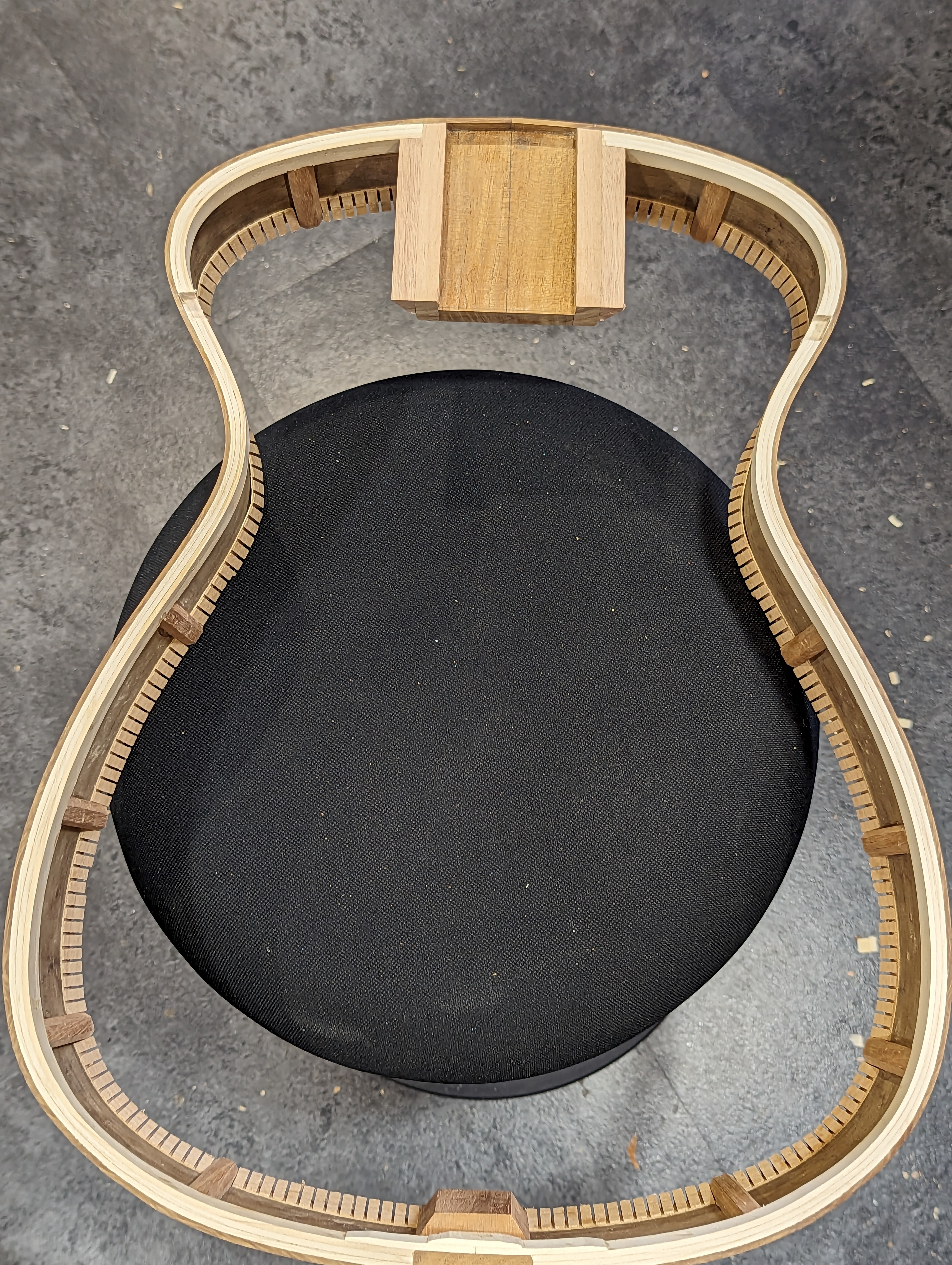

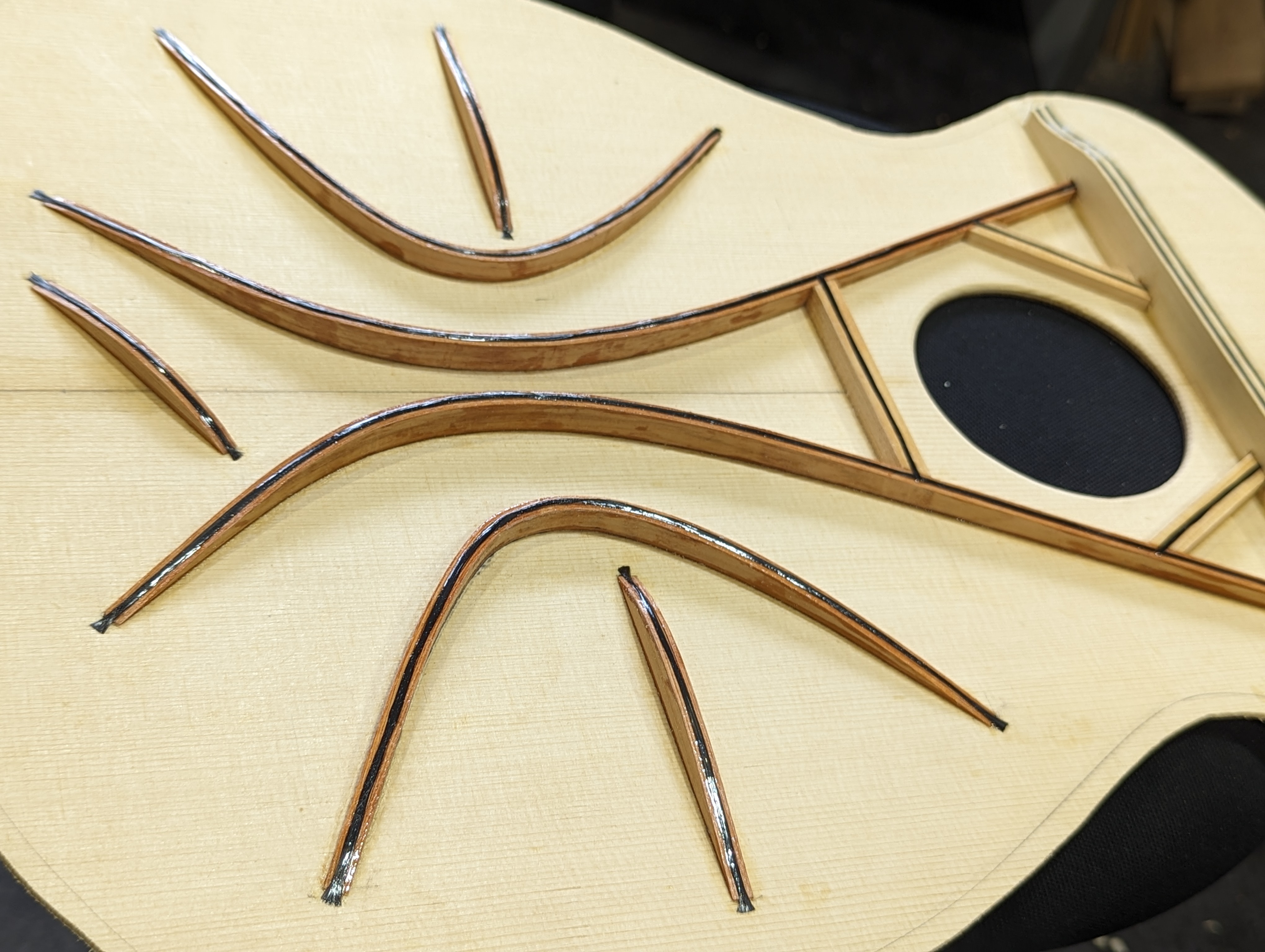

After a few distractions, I have made some progress on this guitar. As I mentioned, I am going heel less neck with elevated fingerboard. Here is my neck block. I plan to use 4 x M6 bolts, sort of like a telecaster. I should be able to put the bolts in through the sound hole.

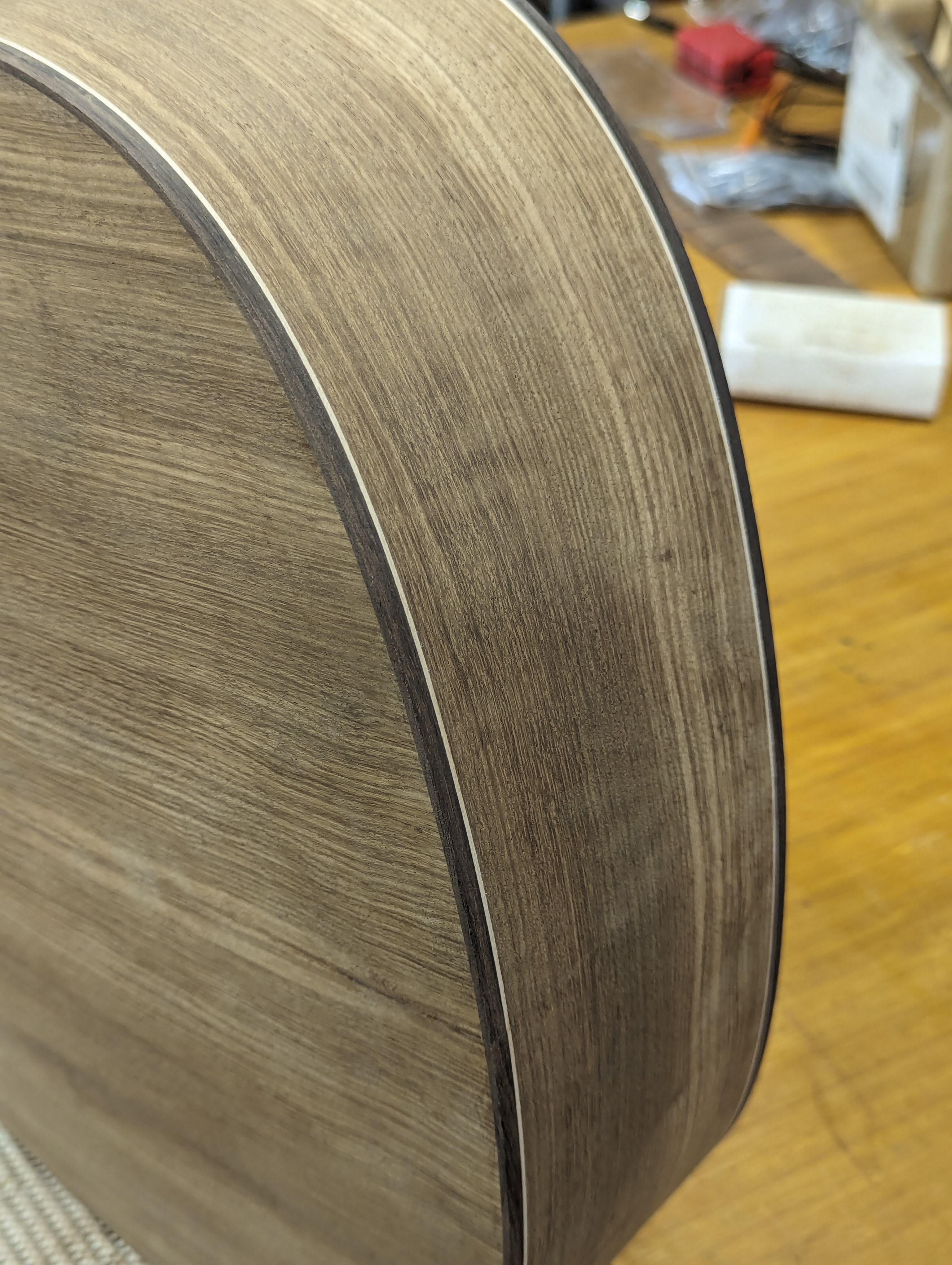

Re: OM size Nylon String Crossover

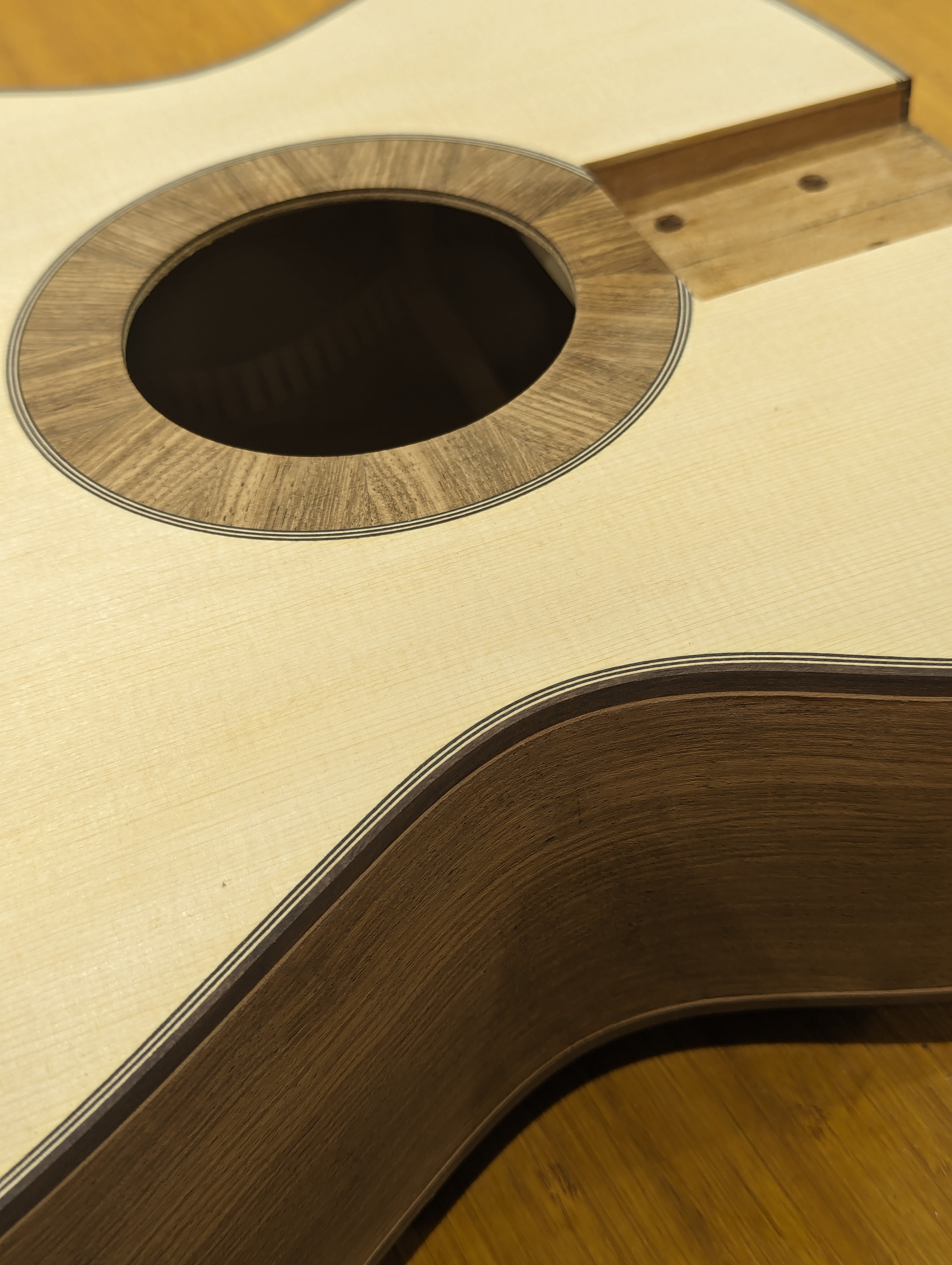

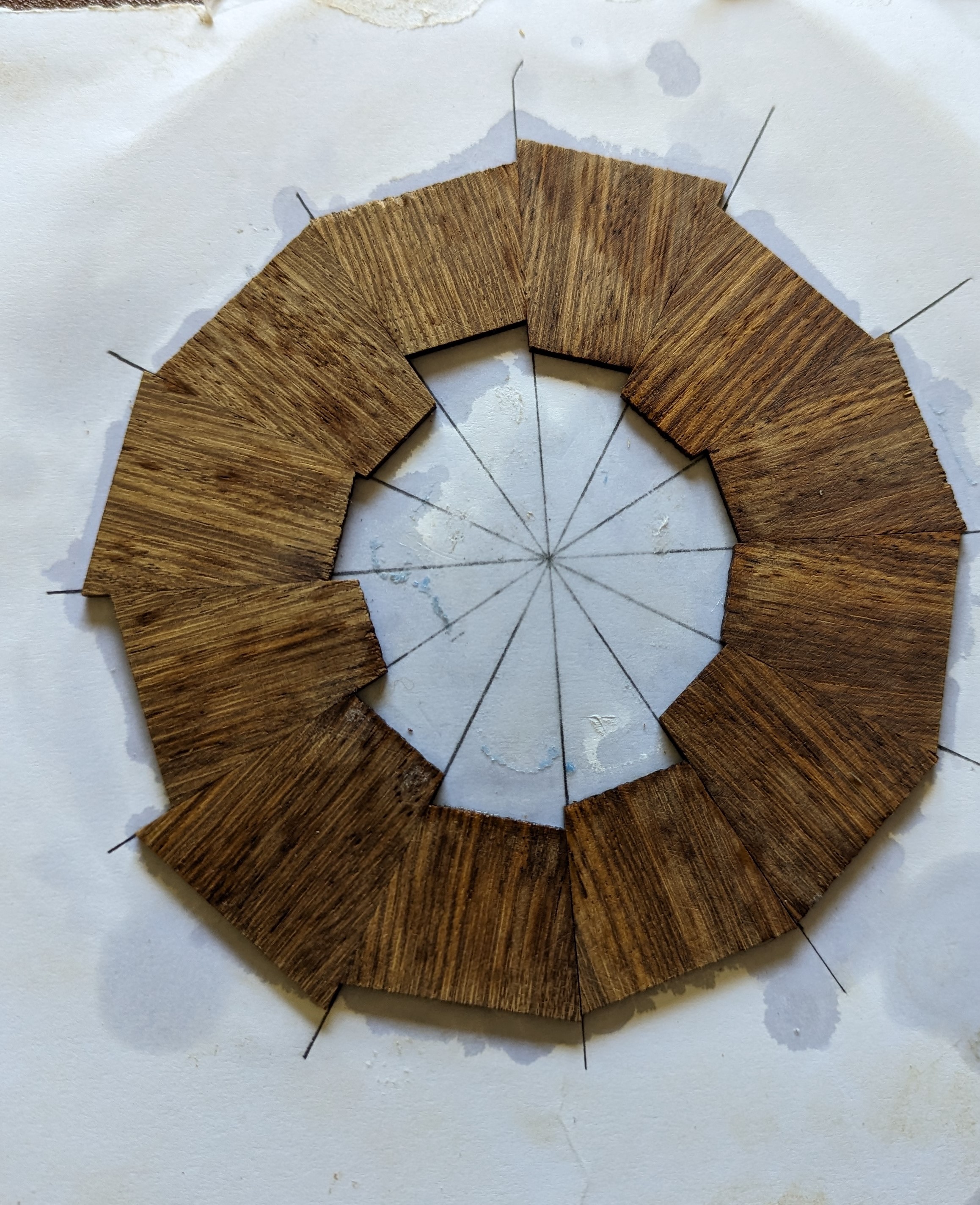

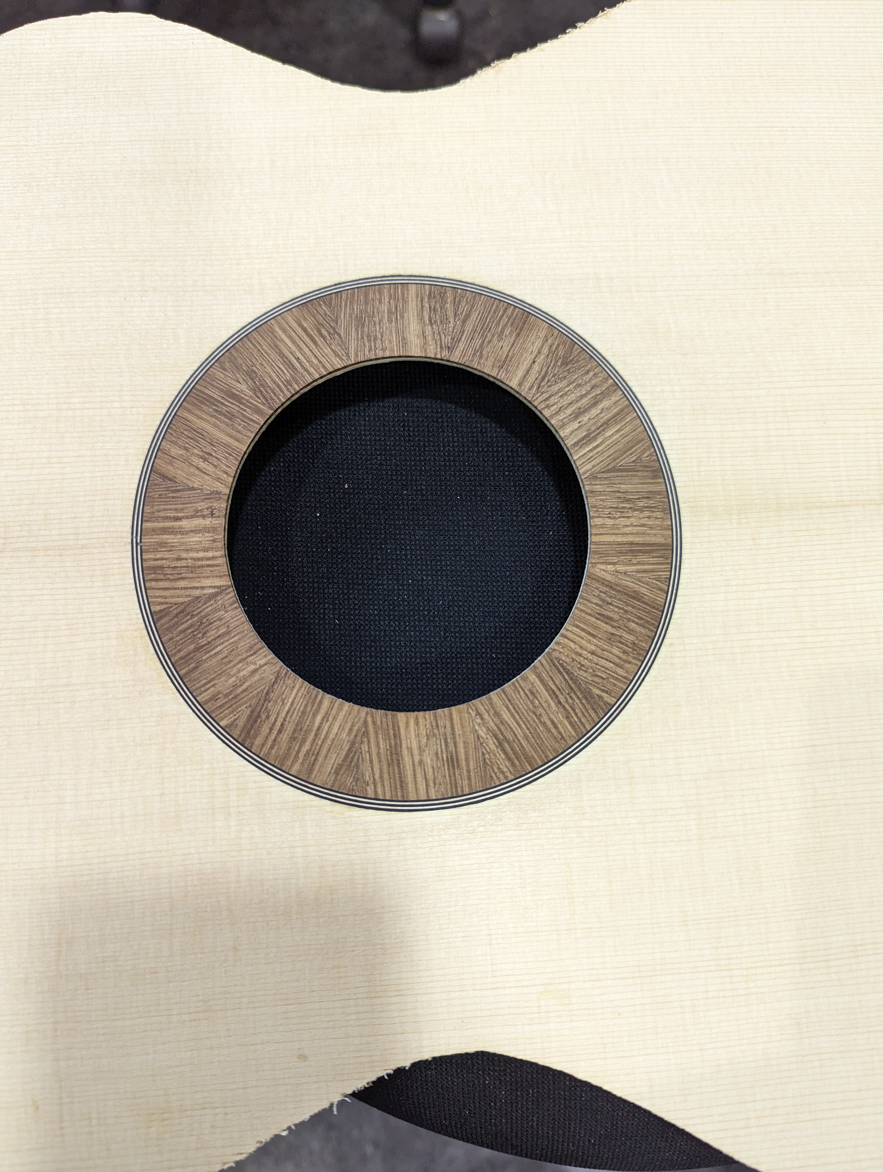

Here is my rosette, made using off-cuts from Black Bean back:

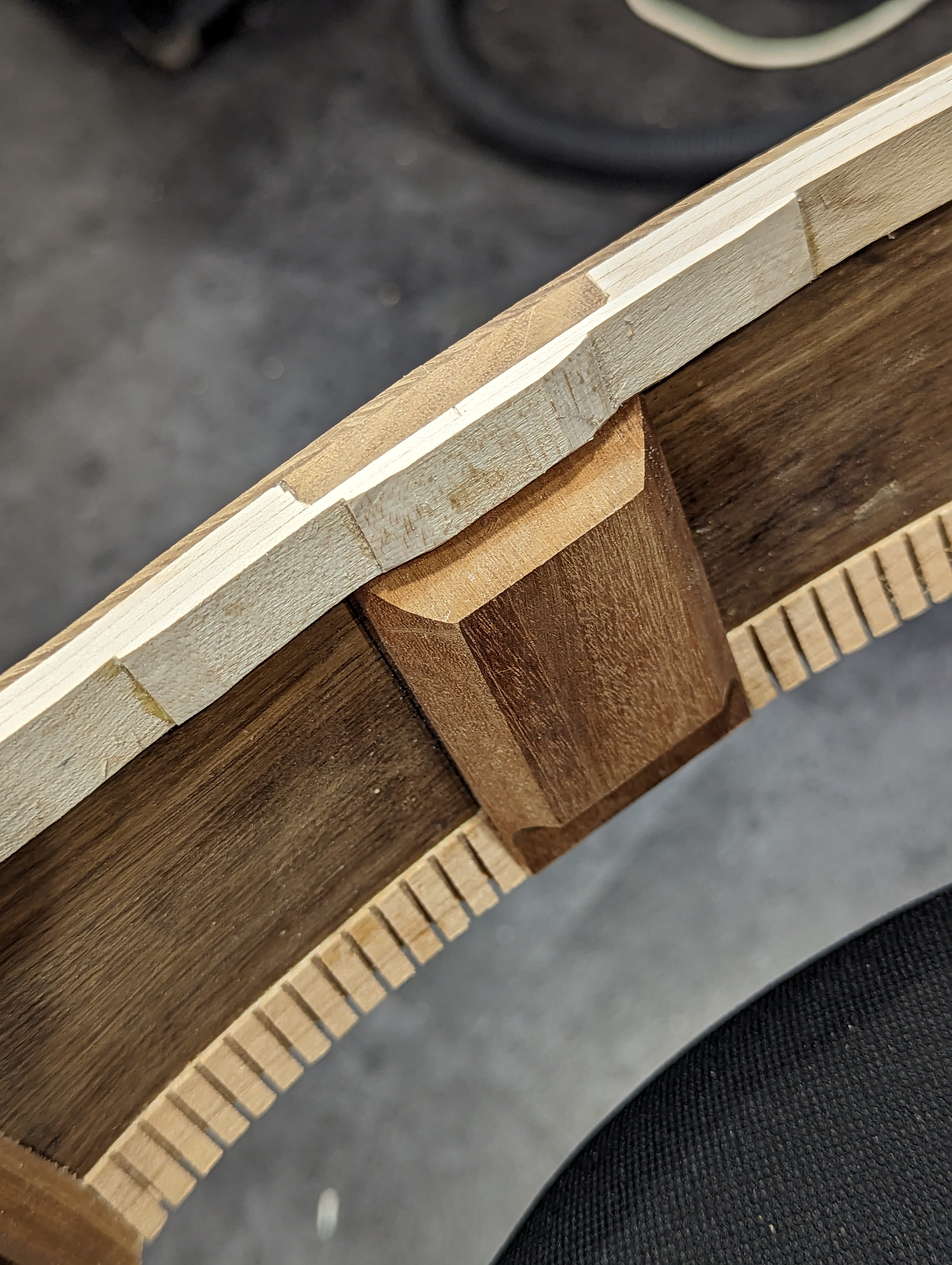

Back, Top and sides ready to assemble:

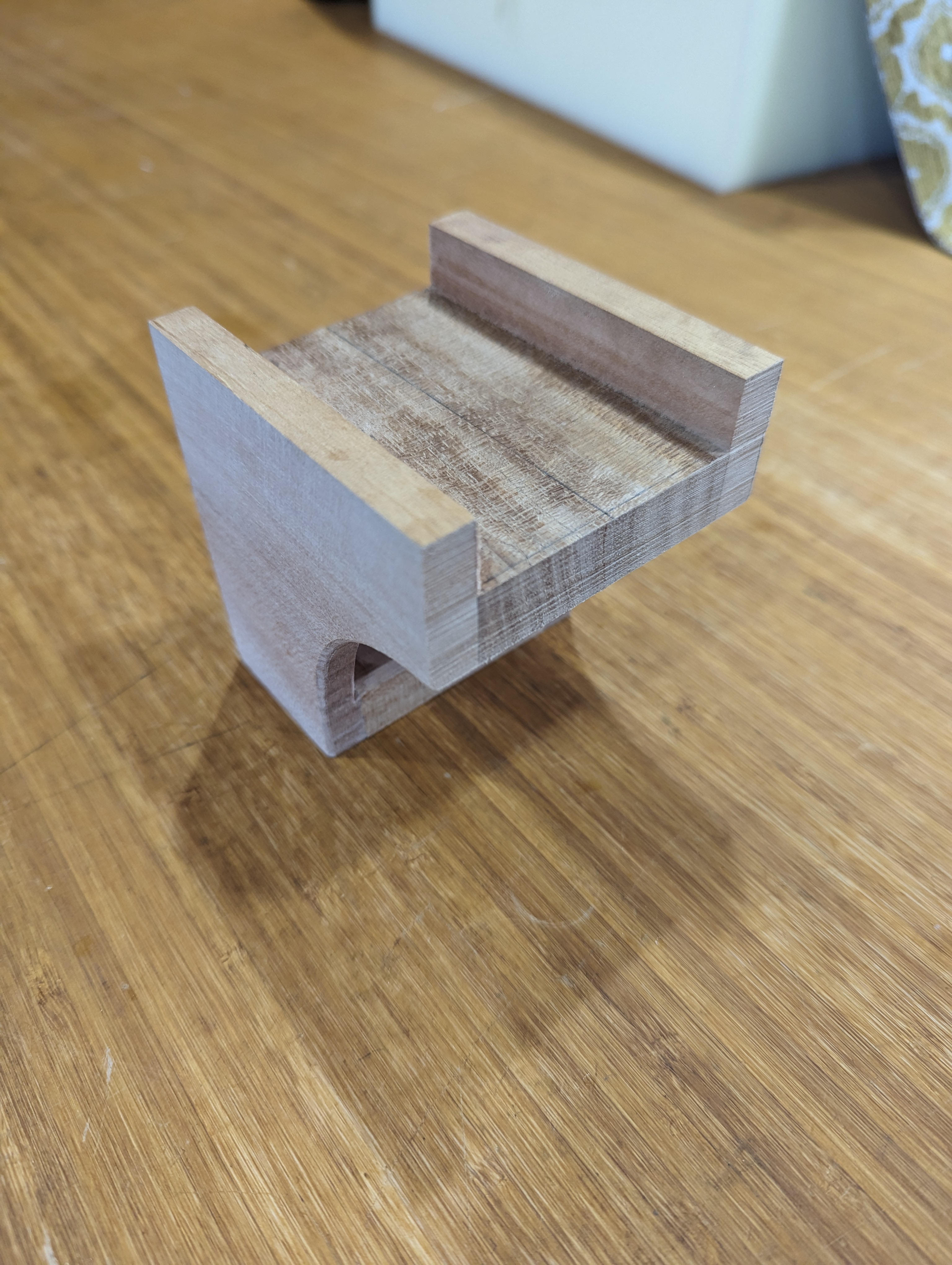

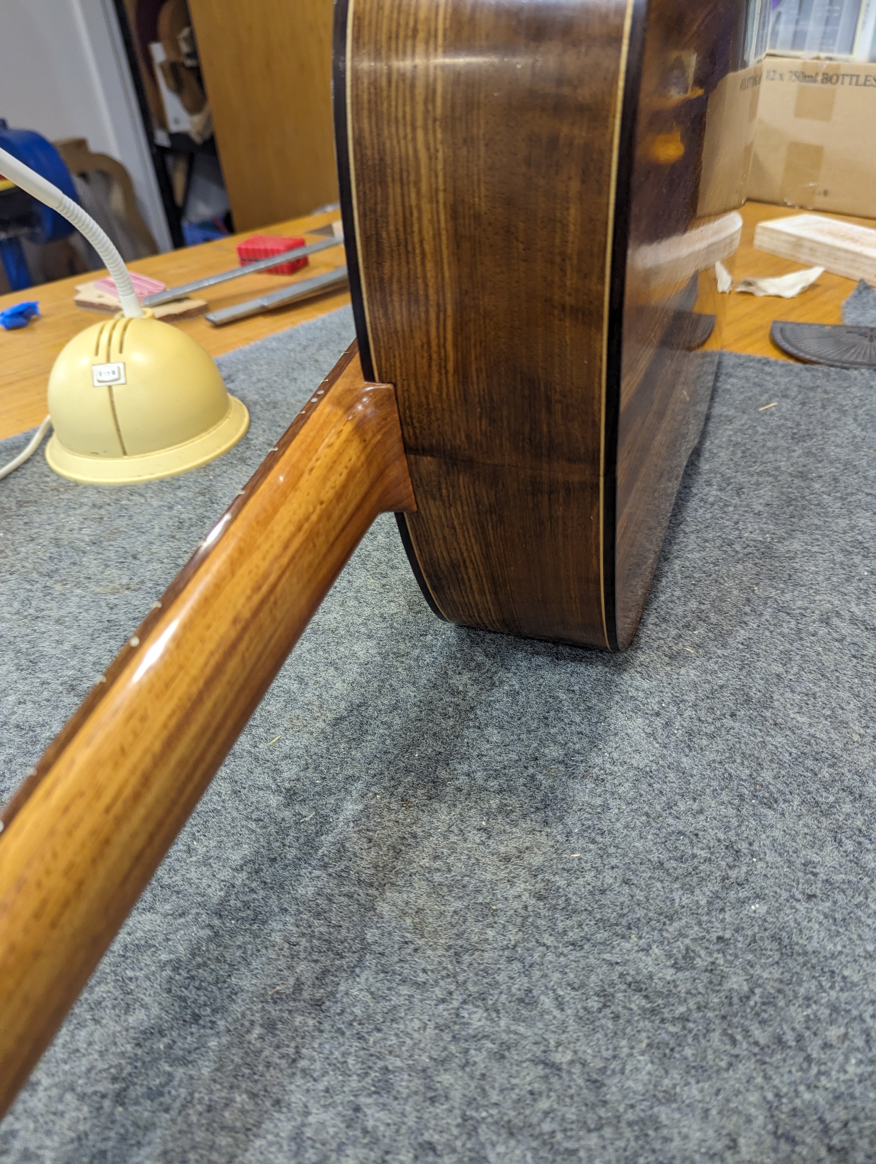

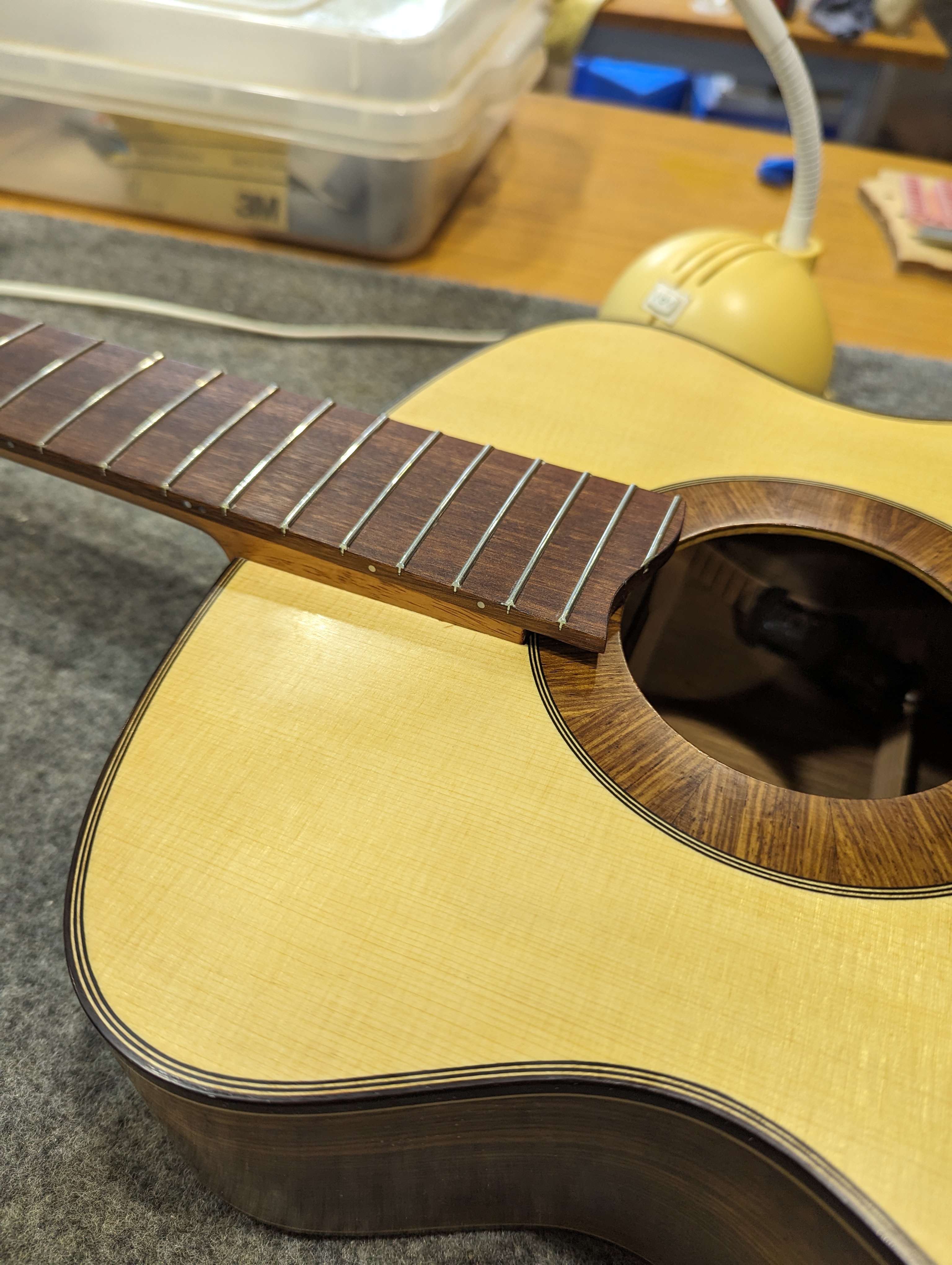

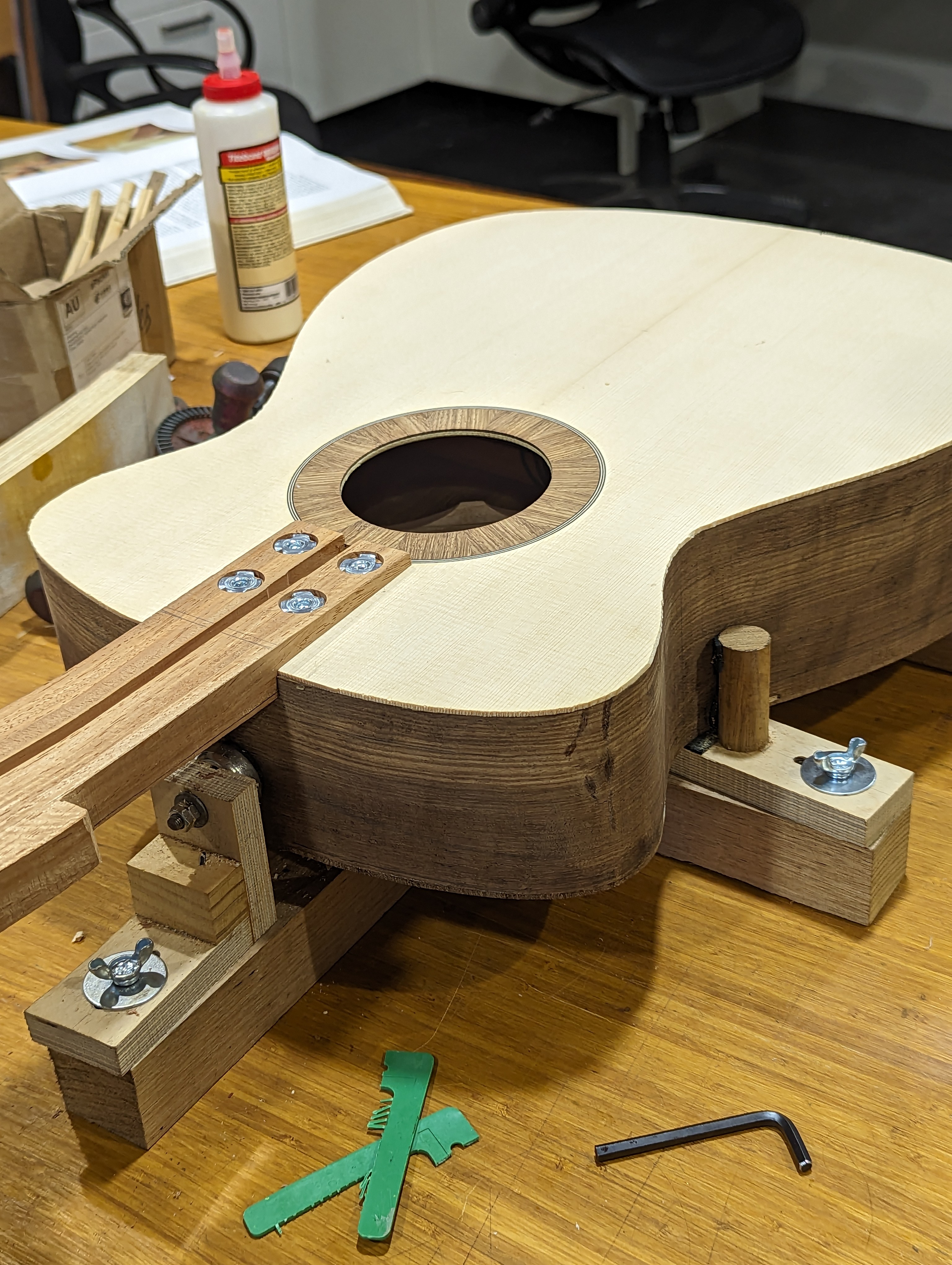

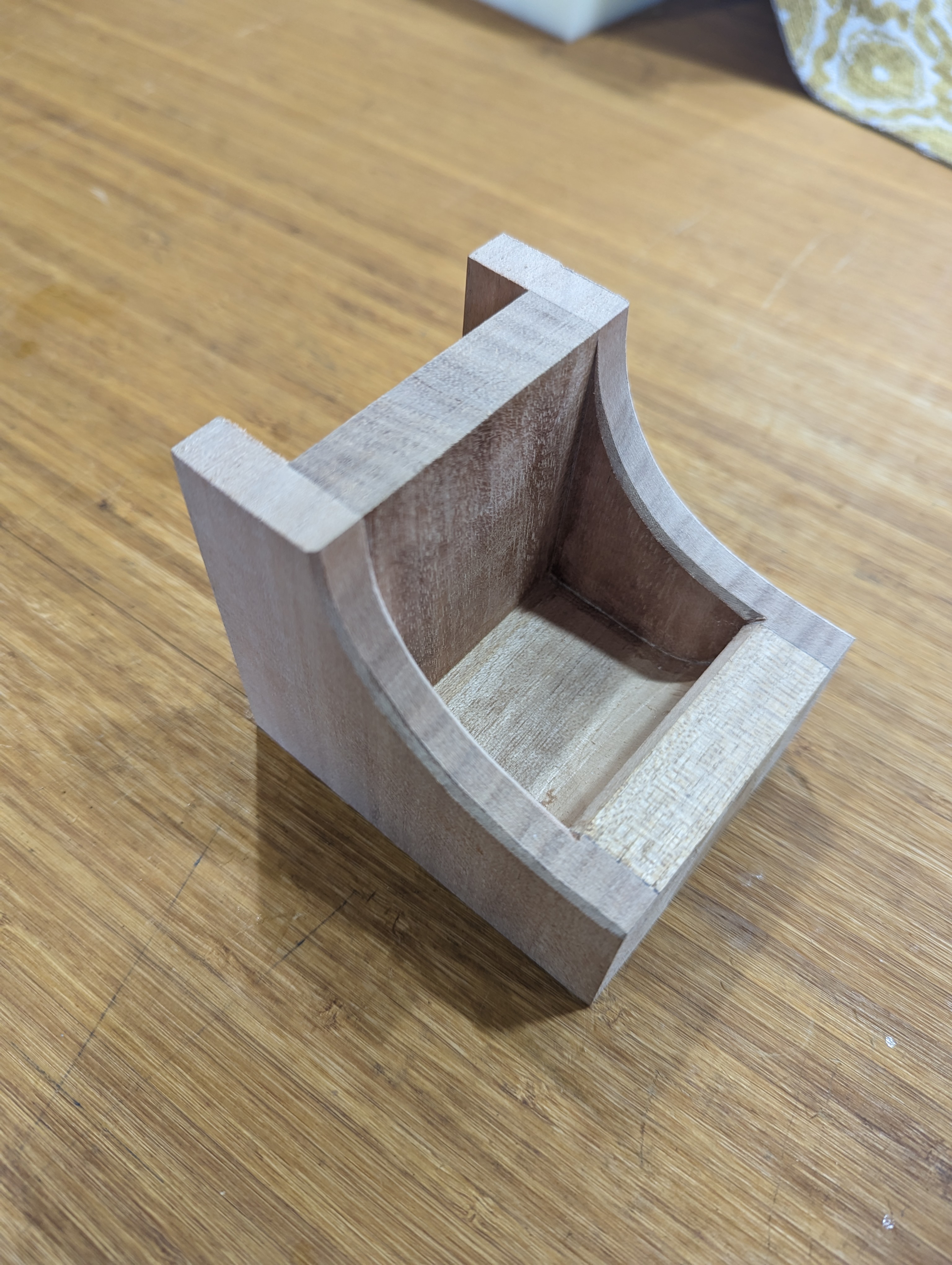

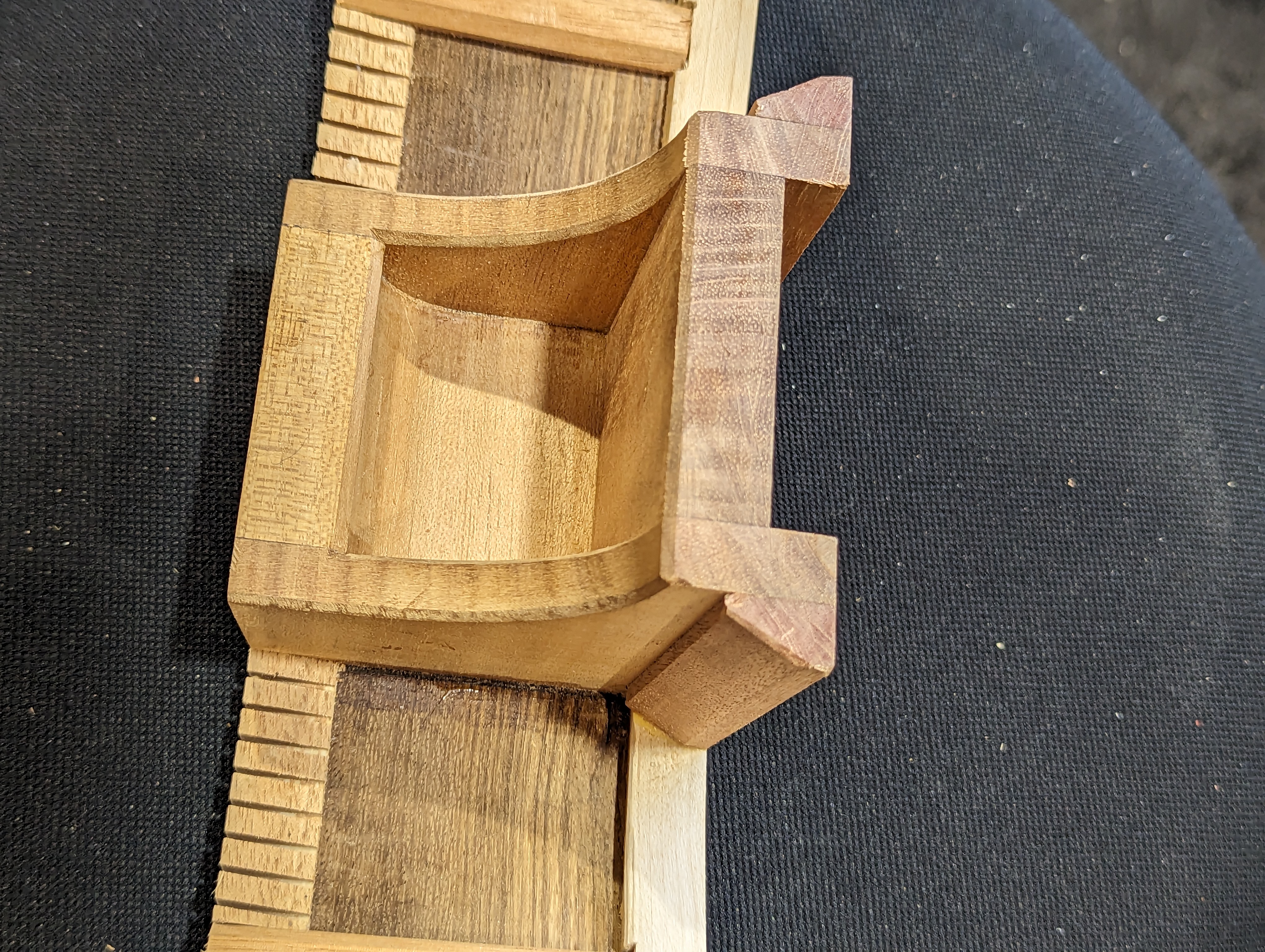

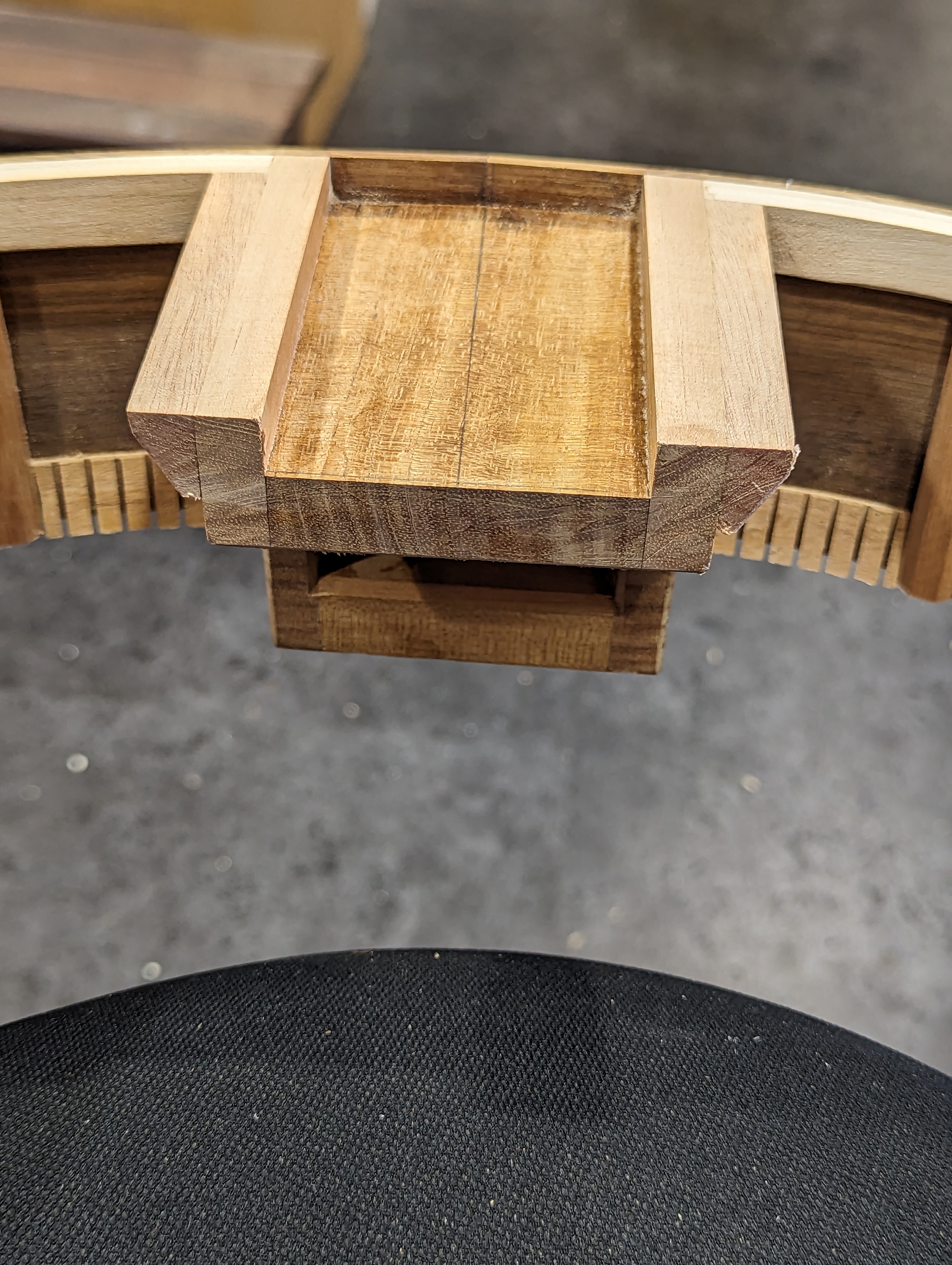

I spent a lot of time thinking about the neck joint.
I fitted the sides of the neck to the neck pocket before glueing the top on. It was easier that way as I could work with the taper of the pocket to gradually bring the neck into the correct position. The neck was aligned with the body centerline and the 12th fret was lined up at that stage. After glueing the top, I only had to plane a slight chamfer on the underside of the neck to get the pitch correct (2mm below the top at the saddle).
There has been discussion on ANZLF about heelless necks and my takeaway was that they can be plenty strong enough for steel string but 'don't look right'. This might change with Martin now doing a heelless model. My motivation for going heelless is nostalgia. My very first guitar back in the day was a Maton F10 Classical; I still have it.
Elevated fingerboard is a classical guitar trend, as far as I know not used for SS. For me, it gives more room for the neck bolts as well as making access to higher frets easier.
Here is complete neck set:
- Posts: 1174
That should work well. Graham McDonald's bouzouki designs include one with a bolts-through-the-back set-up like that and it is very solid, and nicely adjustable for neck angle. I like the idea of the elevated fingerboard too. This is a very interesting build!

Do you mind sharing what your widths were at the nut snd 12th fret? I’m thinking of a similar build.
Thanks
Jon
Thanks
Jon
Jon
Hi David, Love your work. Sorry for the what might be a dumb question to all in the know... Being wood, do you leave time for the joint to settle and redo the bolts before final glue up of the fretboard?
- Myrtle
- Posts: 51
- Joined: Mon Jun 24, 2019 8:49 pm
- Location: Sydney, Australia
Jon, I went for 48mm nut width and 58mm neck width at12th fret.
asgilbert, all the wood is well seasoned and the neck was cut to rough size at least six months ago so everything should be fairly stable now .
Changes in humidity will always cause some variance of the neck angle (height projected to bridge position). It is important to acclimatise the guitar body at 50% humidity when setting this up. If necessary, I should be able to shave the underside of the neck to adjust this angle right up to final assembly after varnish, & beyond. There is a double acting truss rod as well.

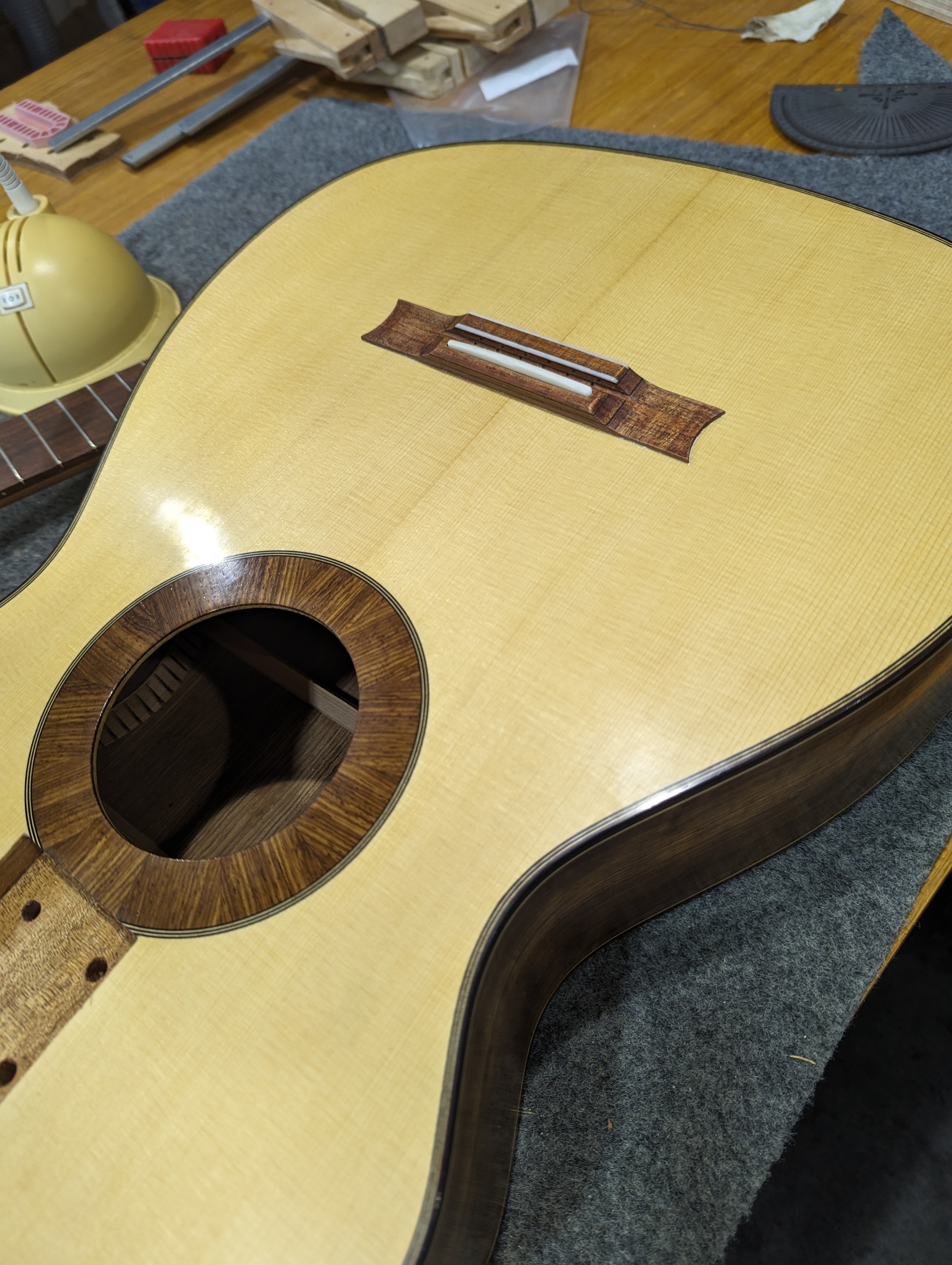

I have had made some progress. Completed the binding using off the shelf Indian Rosewood/Maple from guitarwoods.com.au
I thought the colour looks good against the Blackbean. I used double black/white purfling which matched the rosette purfling pretty well.

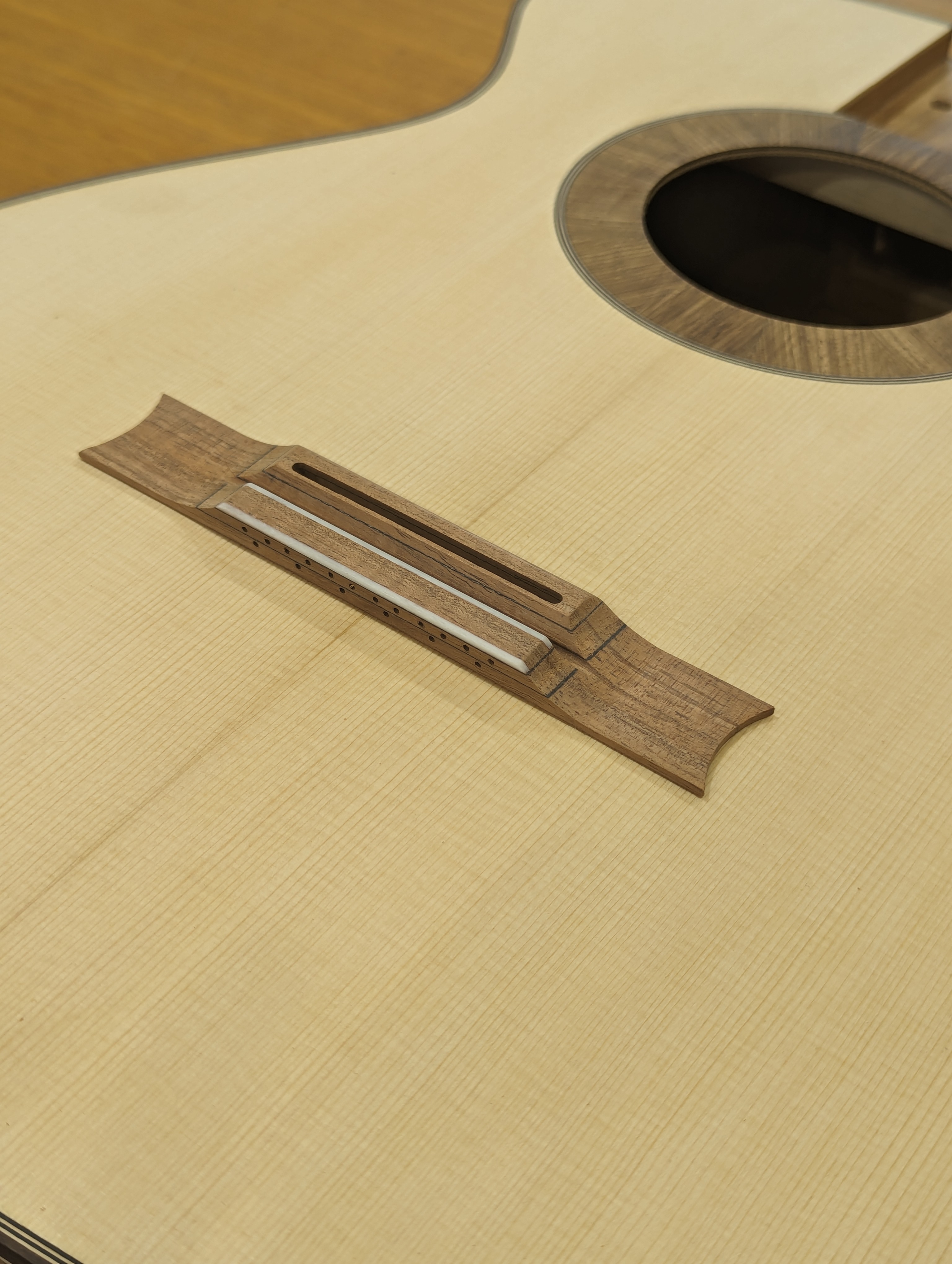

While I am waiting for some veneer for the headstock so I can finish the neck, I made my bridge. It's Blackwood with Carbon Fibre to the Gore/Gillet book design. It weighs 14g.
Rather than making it 12-hole, it has 18 holes but six of them are only a few millimeters deep. So, tying strings will be like a 12-hole bridge but the bitter end of strings will anchor in the half holes. There are pros and cons but it seems to me that this be the least fiddly way to tie when changing strings. At least, this guy makes it look easy in his video: https://www.youtube.com/watch?v=-oDlPbqQ2-Q

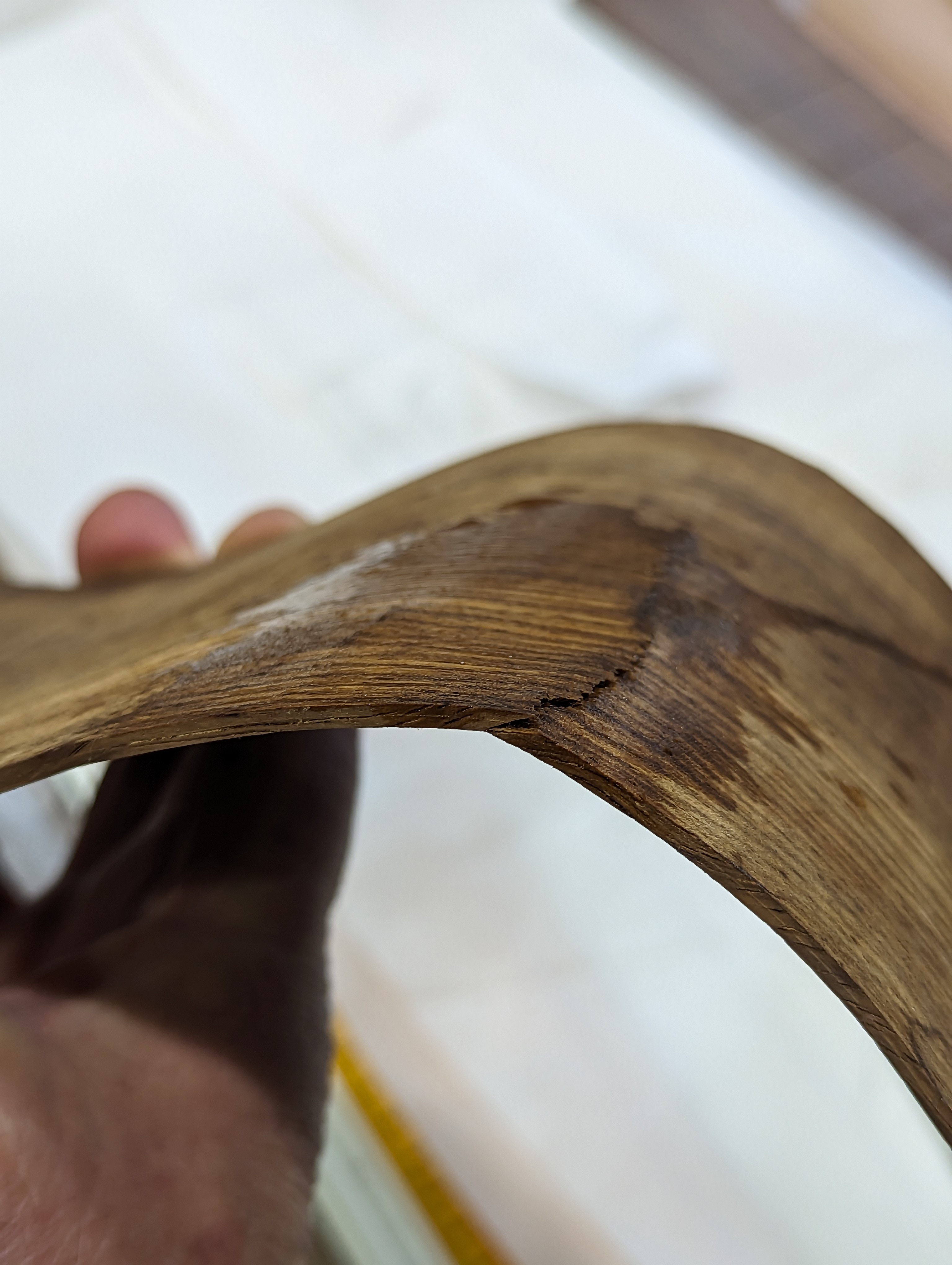

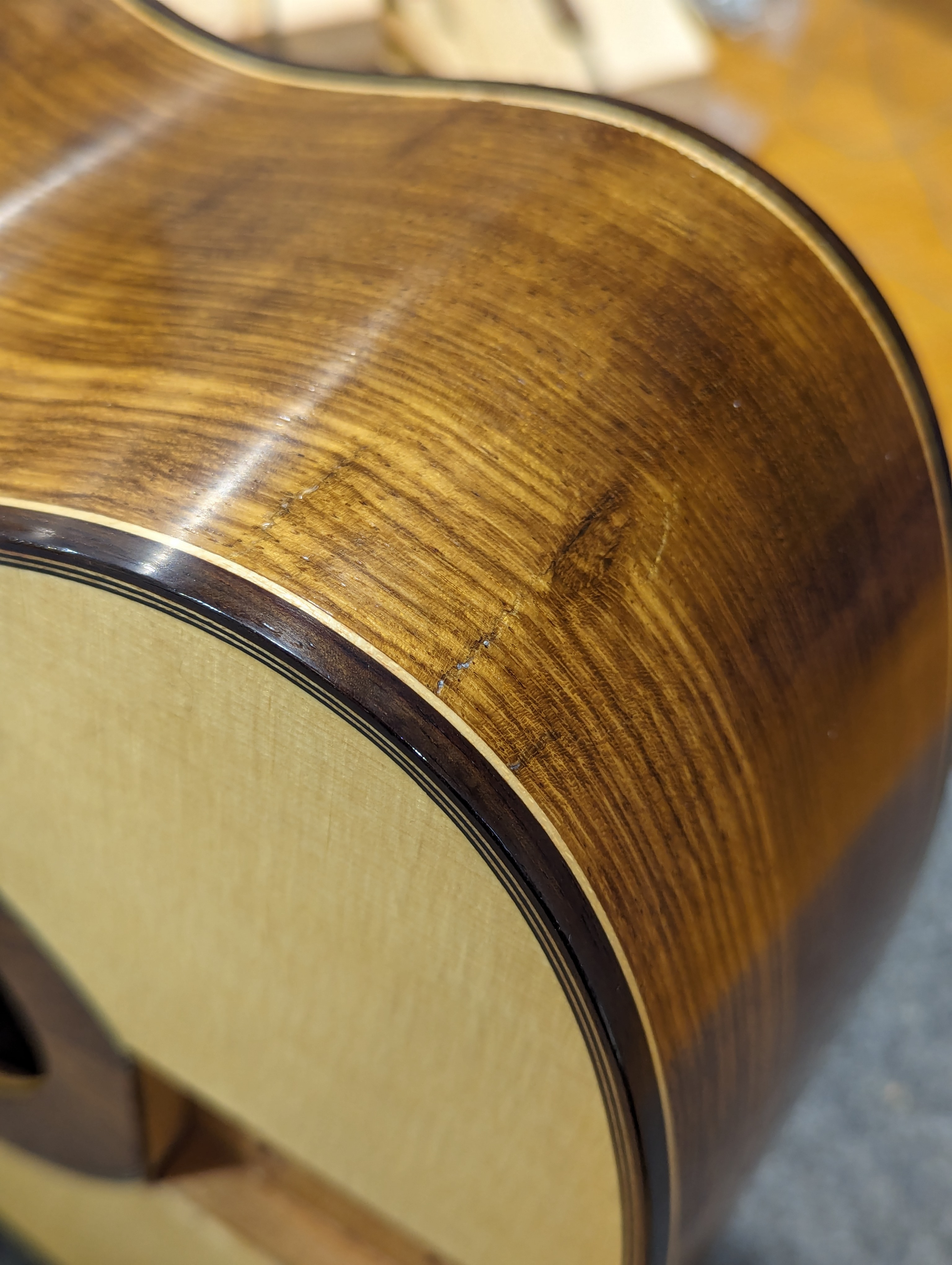

I have finished french polishing and fitted the bridge. There are some visible bending cracks on the top bout. I thought about getting some new sides but did a bit of epoxy work and I quite like the look of them now.
Here is the crack when it happened: And here is the result: The Black Bean is fairly gnarly so a few the cracks and other marks kind of work.
Bridge on: Neck Joint:

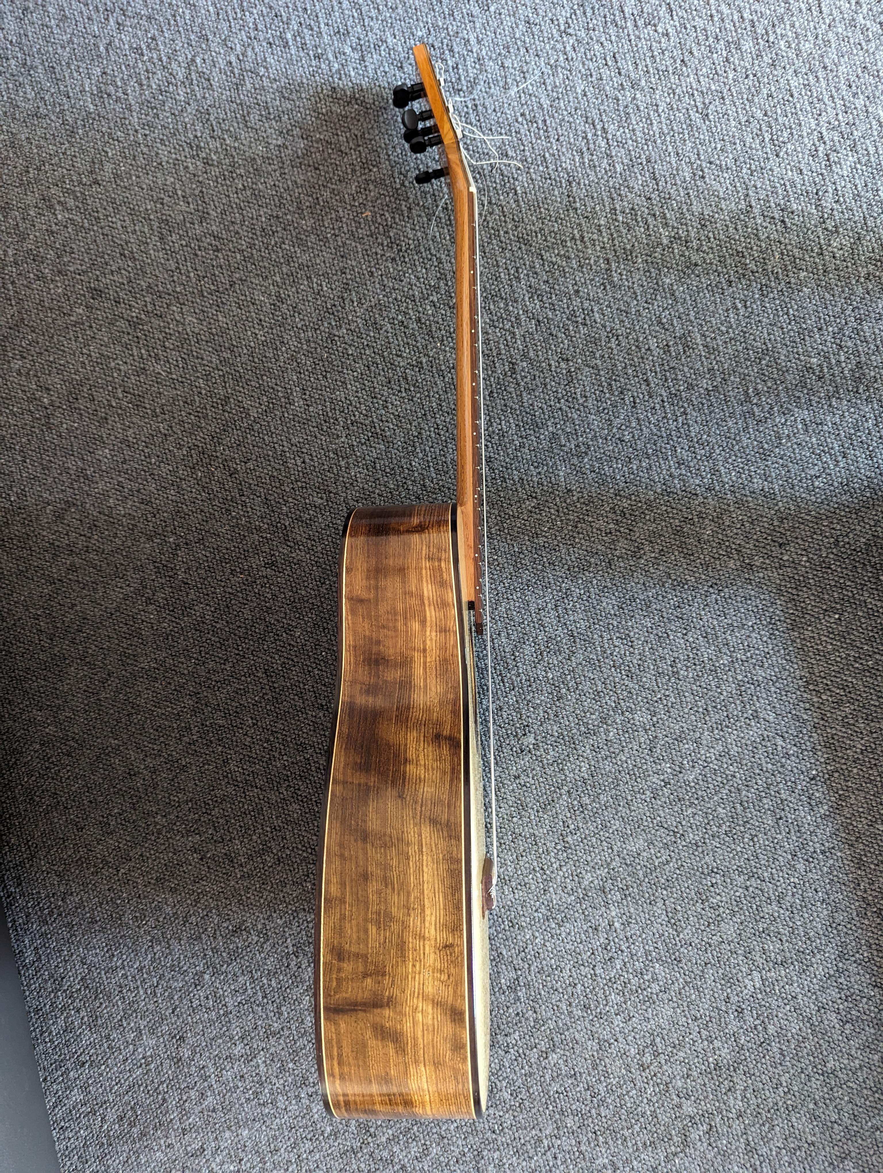

Just been looking at resonances. The main body resonances when the box was first closed were: 88,176 & 237
Now after binding, shellac and bridge, I get: 97,188 & 231.
The top went up because of the bracing added by the bridge; a bit more than I would have expected really. I guess the back went down due to the weight of finish. Can't explain the large increase in the air resonance; 88 to 97? Anyway, my target top resonance of 190 is not going to happen, but it should be all workable. If I end up with a problem resonance, I have scope to drop frequencies by tuning the back down.

Thanks Mark, the top is domed at 10m radius but the dome is tilted down toward the neck. When I was shaping the dome I took 5mm off the neck block and virtually nothing if the tail block. This way the neck meets the sides at closer to a right angle than it would have otherwise. Neck doesn't appear to be at a weird angle to the body.
On the subject of neck joint, I just finished putting a shim in the neck joint. When the guitar came together, I hit target classical string height but I realized that I would prefer a lower action in a crossover. I could have planed the heel however I went the reversible option and made a tapered shim out of maple veneer. That got the action down to 3mm/2.25mm at the 12th fret which plays nicely with no buzzing.
