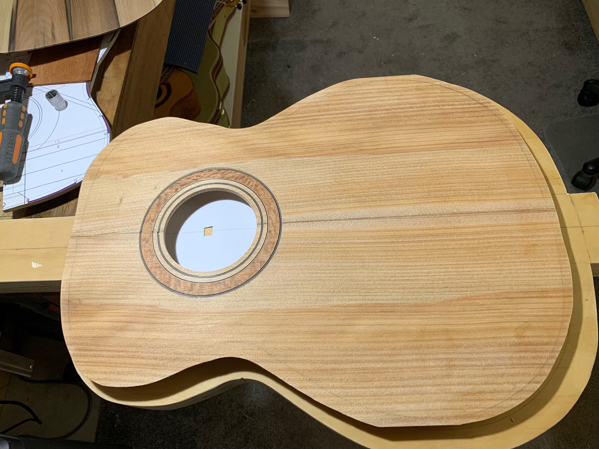

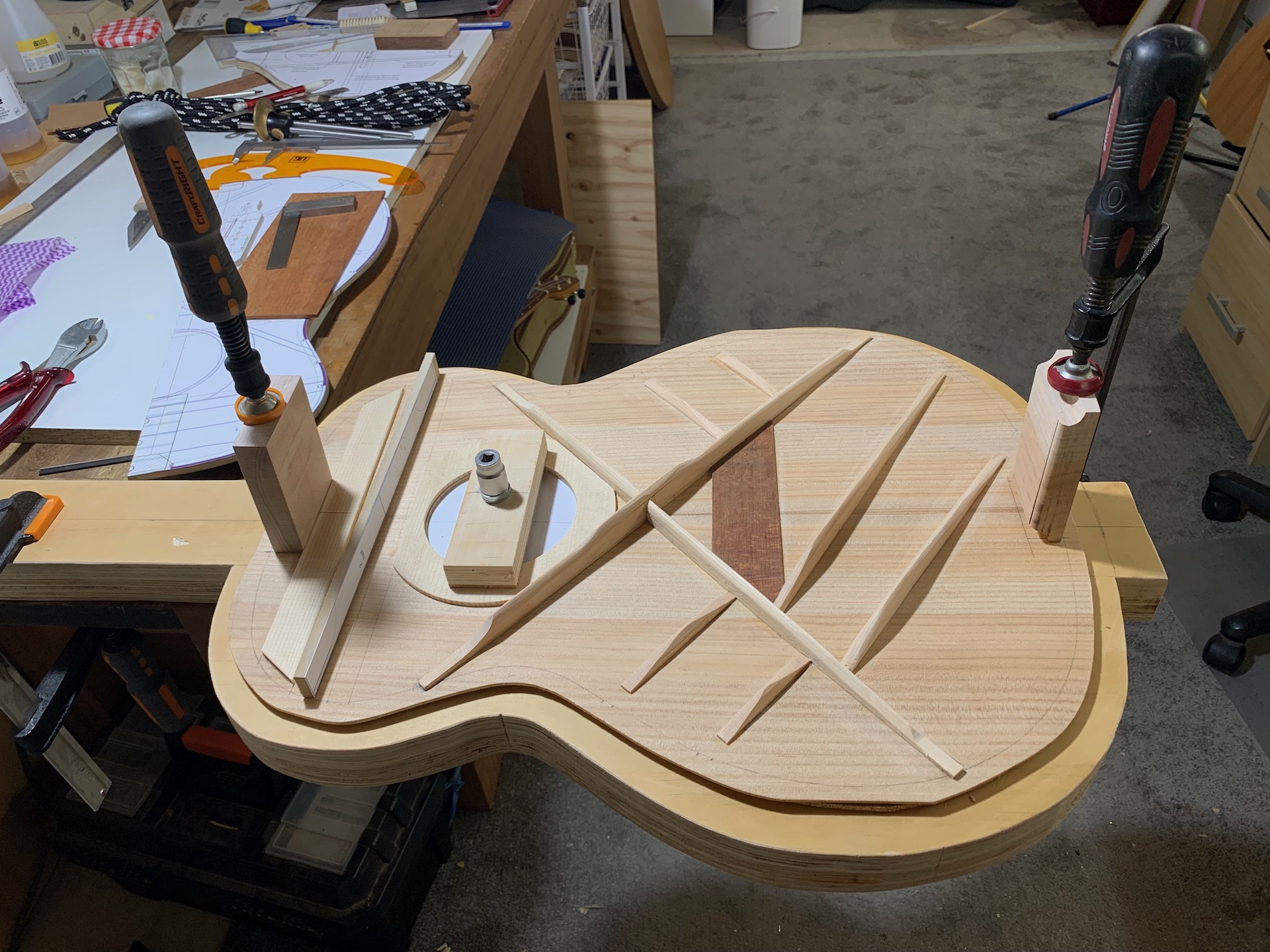

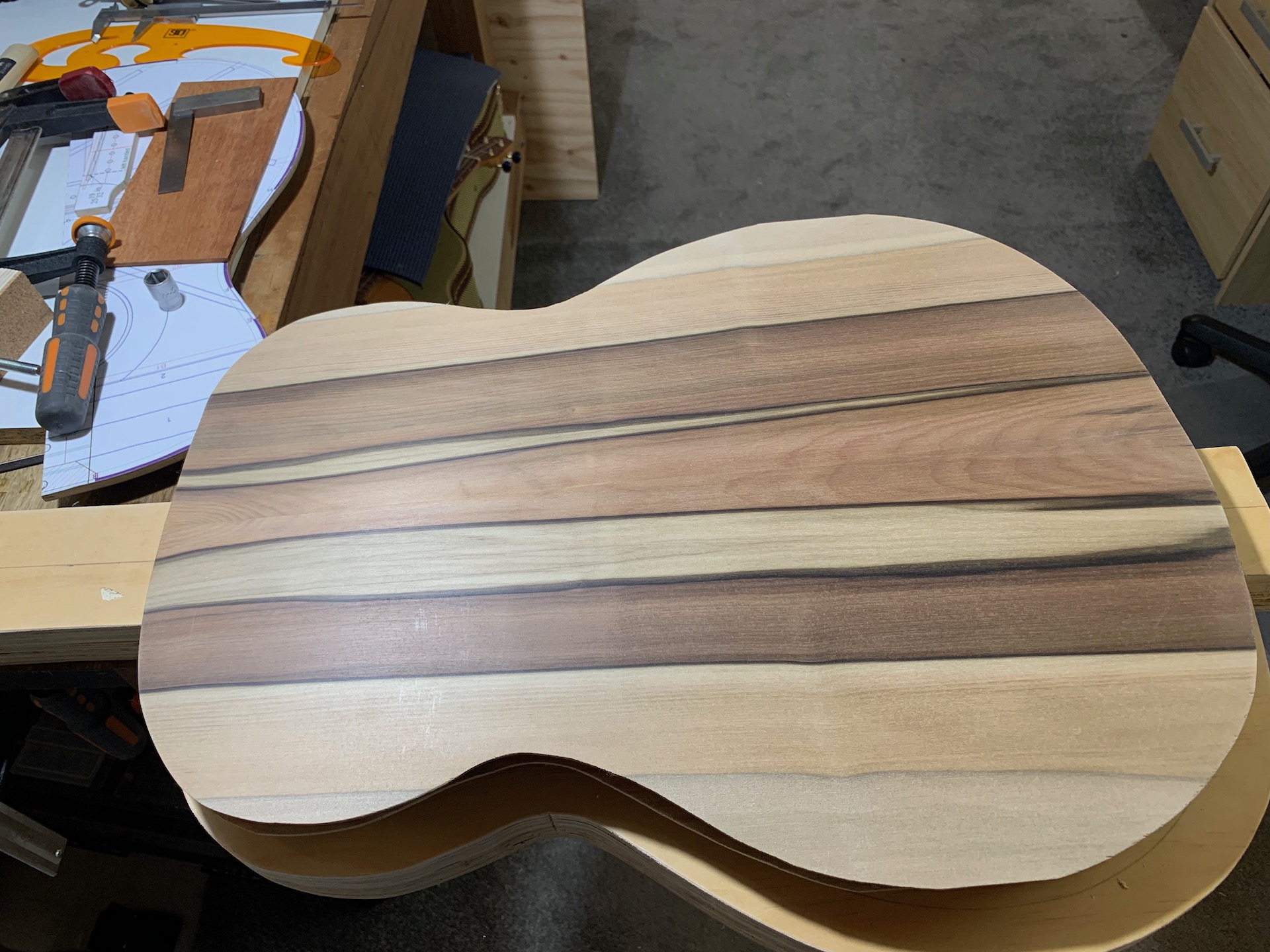

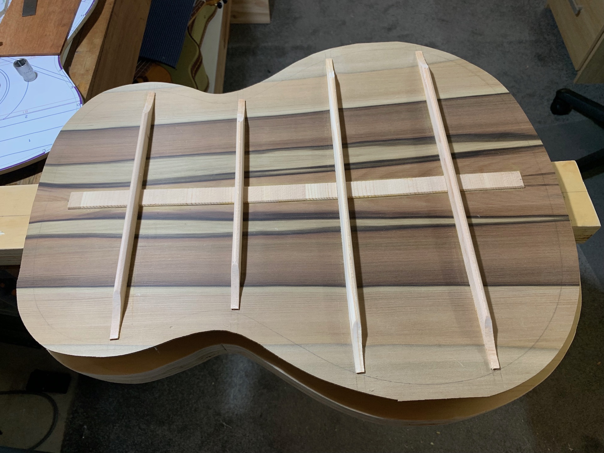

Just thought I would share by current project, which is starting to take shape.
This is build number 14. It all started with a StewMac ukulele kit at the outset of the first Covid lockdown, in March 2020 :)
This will be Triple O steel string acoustic, with a 25.34 inch scale length. Bunya Pine soundboard, Blackhearted Sassafras back and sides, Blackwood binding, bolt on Queensland Maple neck, Jarrah bridge and fingerboard, River Oak headstock, Lacy Oak rosette and Gotoh 510 tuners.
At this stage I am not using either an external or internal mould, but rather free air building on a solera of sorts, similar to the approach outlined by Natelson and Cumpiano.
The back and soundboard are thicknessed and bracing is largely complete (waiting on some brace wood in the mail for the transverse brace above the sound hole). Next step is to start work on the neck and fingerboard and to thickness and bend the sides.

That’s beautiful sassafras Bob. You must be very pleased with how it’s looking.
What made you choose which side to have on show?
The inside face seems to have more symmetry, the outside is nice but more asymmetric.

Thanks Alan - I was very pleased with the sassafras and the bunya pine, from Tim at Australian Tonewoods, now in Tasmania.
The side I chose to face inward has some issues with the transitions between shades, which while more symmetrical are less distinct - a bit blurry - than on the side facing outward - difficult to see at a distance but more obvious close up.
The texture and colour in the bunya pine was an unexpected bonus and might split the audience, but I like it, and this one is for me :)

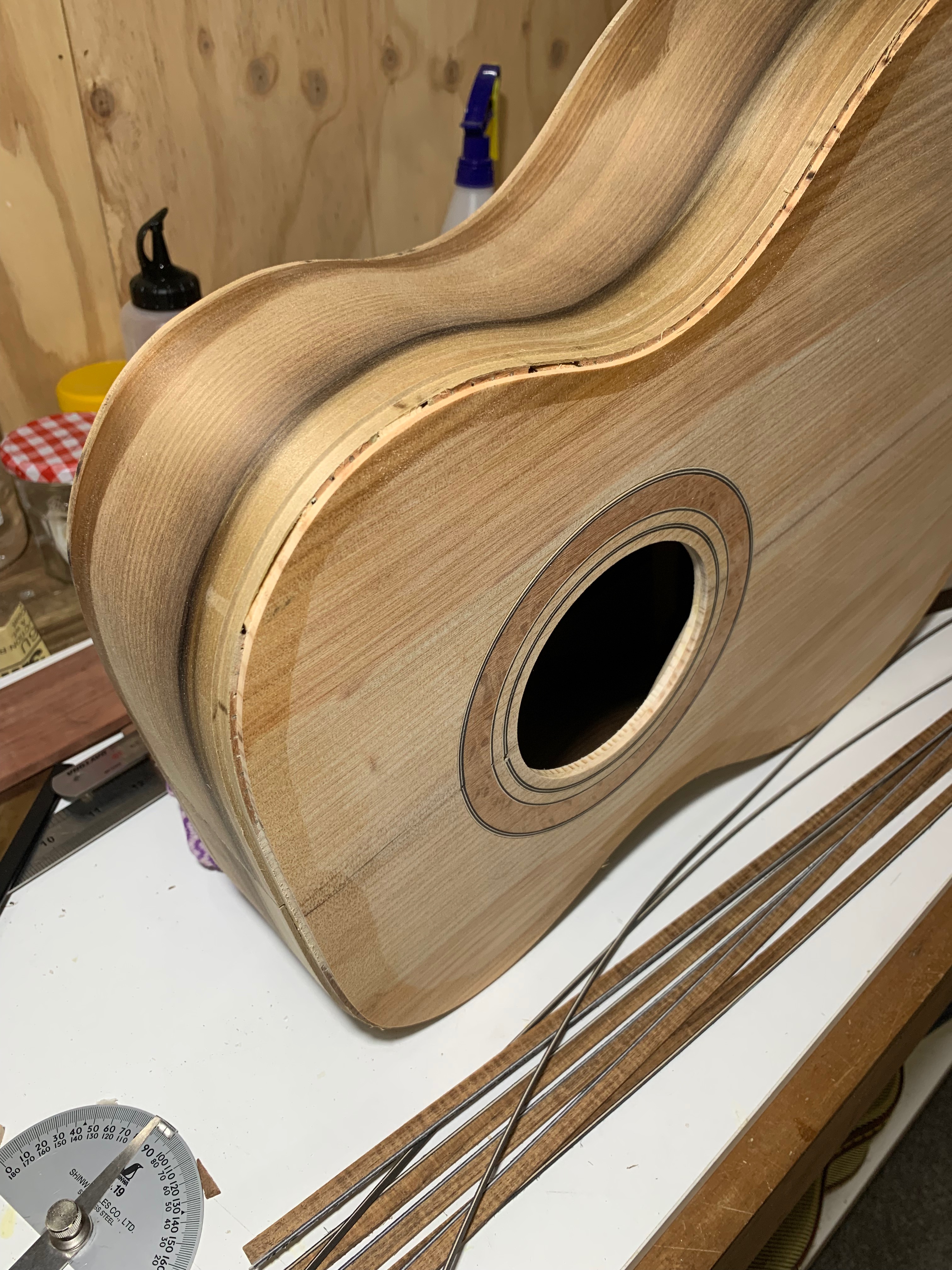

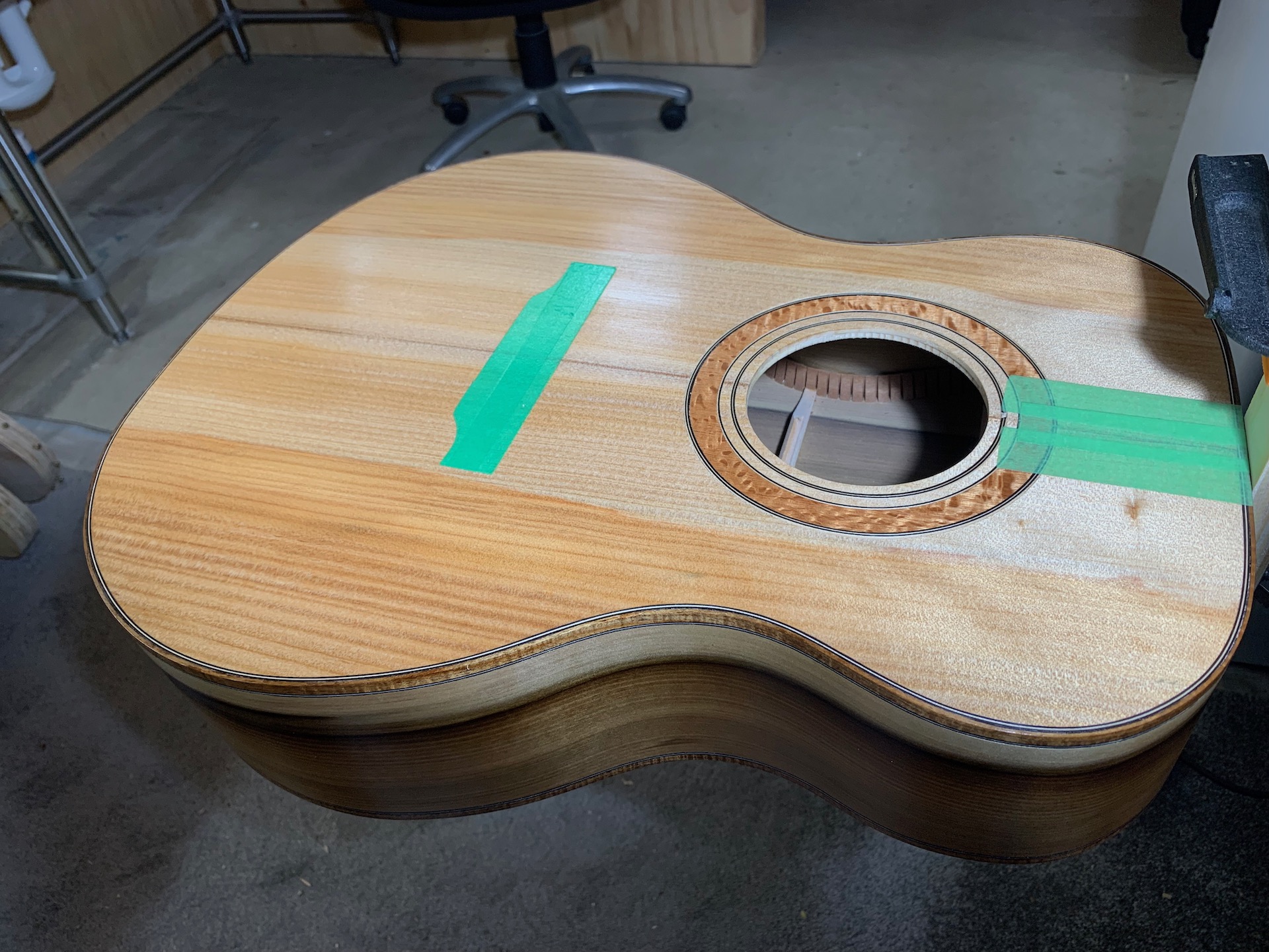

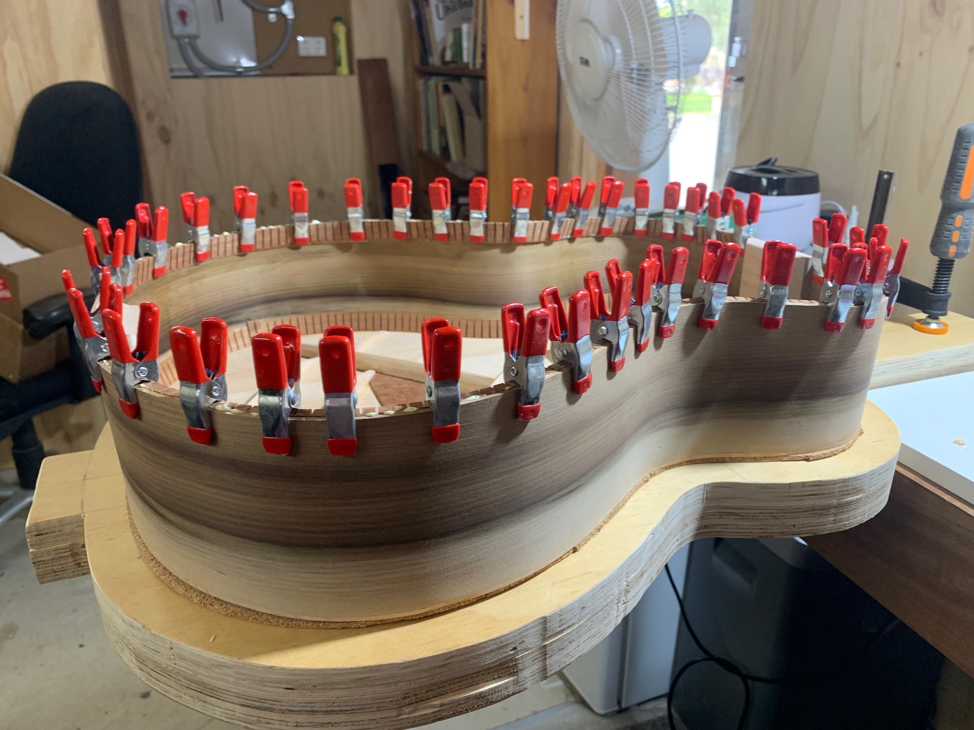

Post by Bob_H » Fri May 05, 2023 5:33 pm

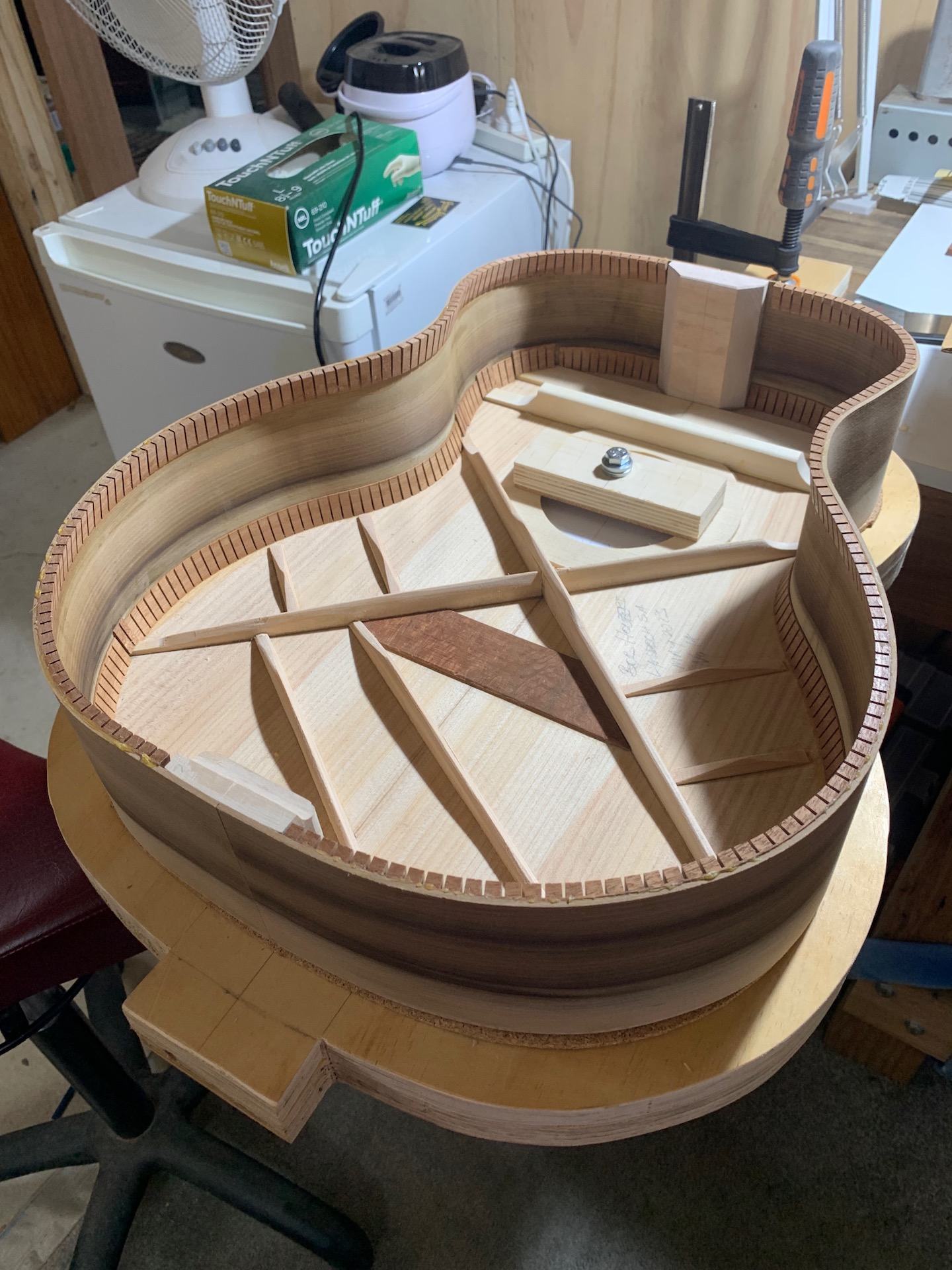

A very satisfying time of the project - neck and heel blocks attached to soundboard, sides bent, kerfing applied and attached to soundboard, sides profiled for the curvature of the back, and more kerfing applied. Closing the box next, and moving ahead with the neck and bridge.

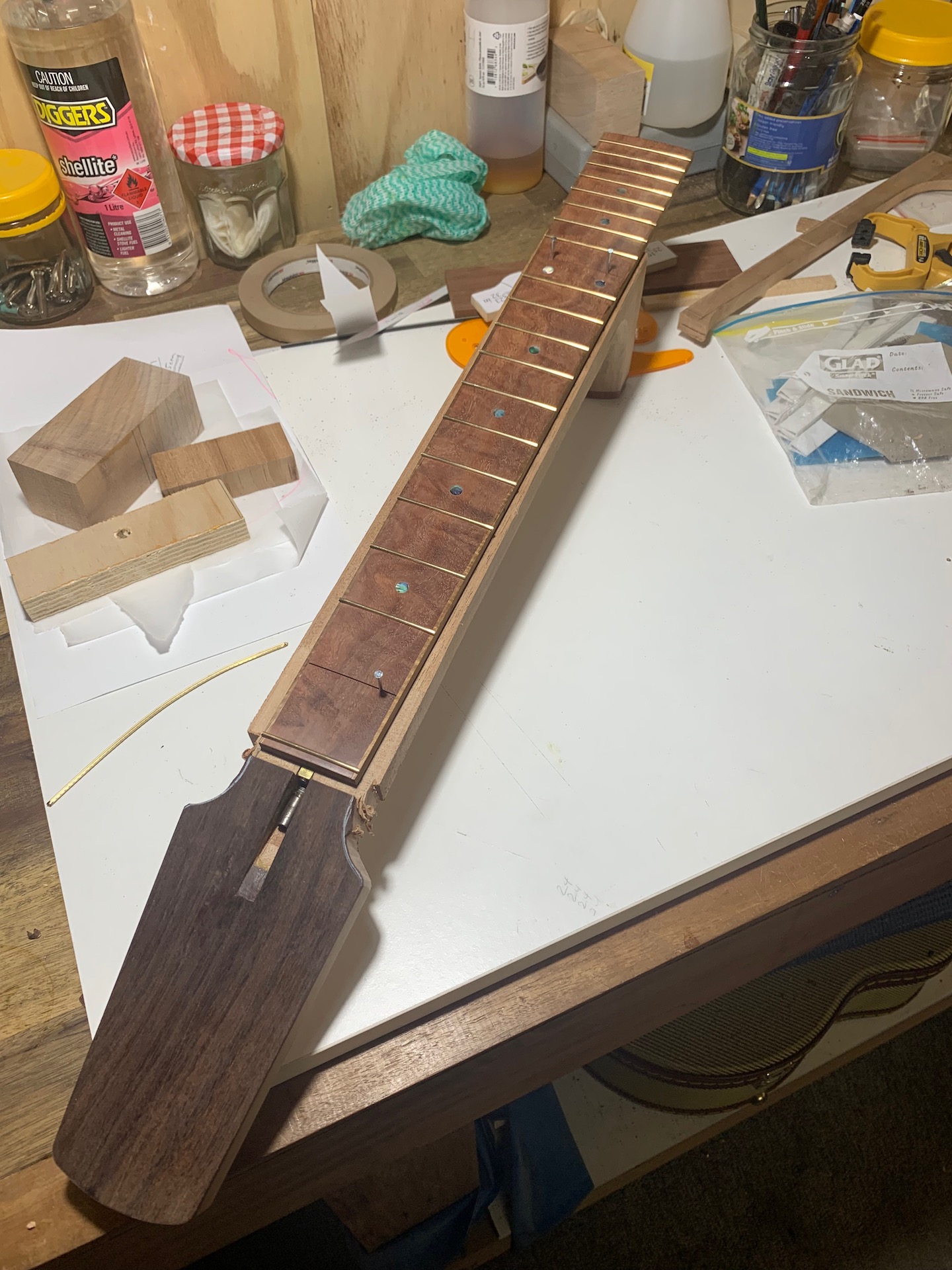

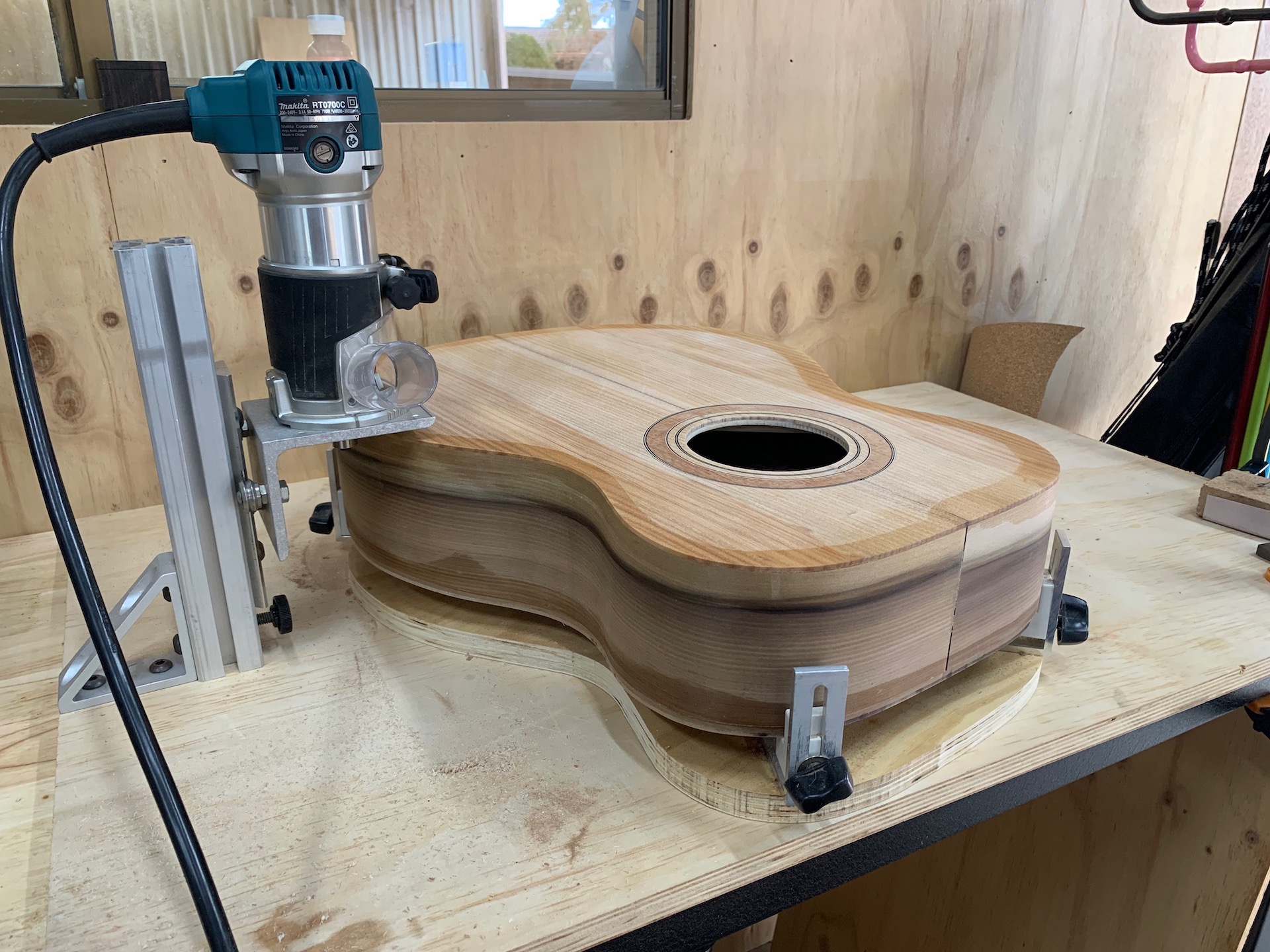

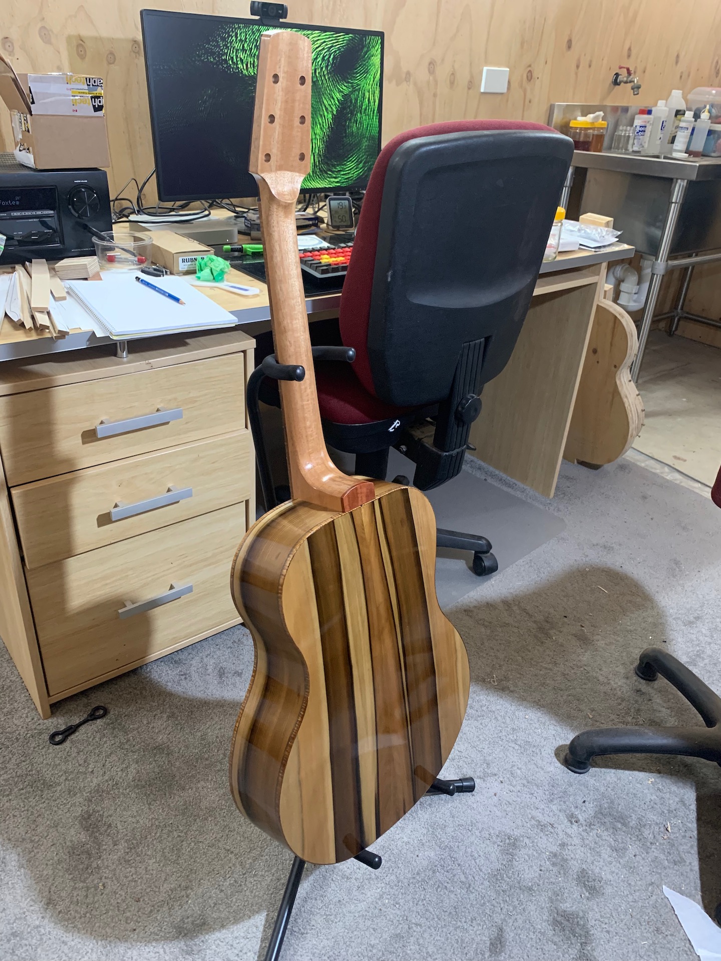

Post by Bob_H » Wed Jun 07, 2023 11:49 am

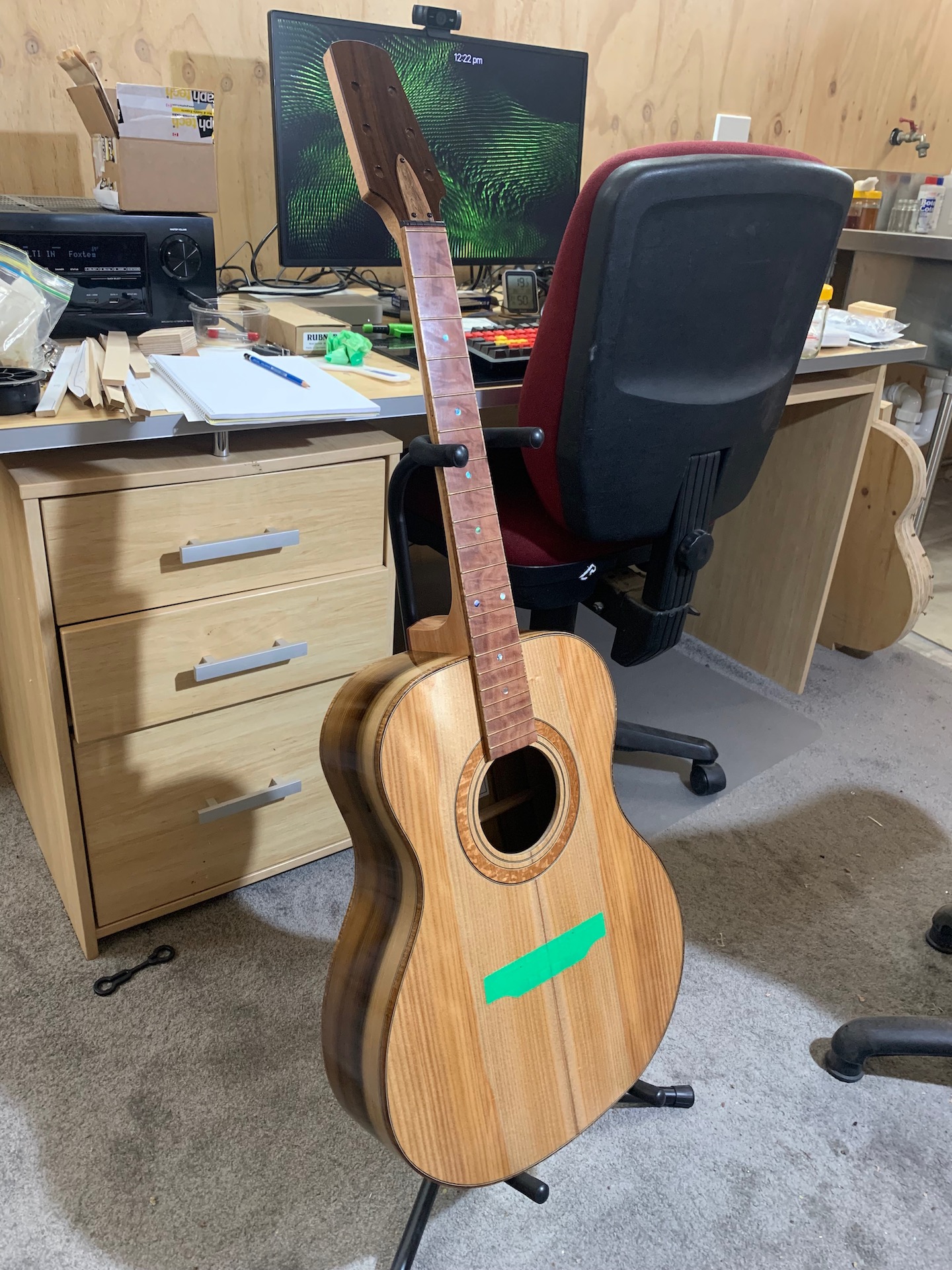

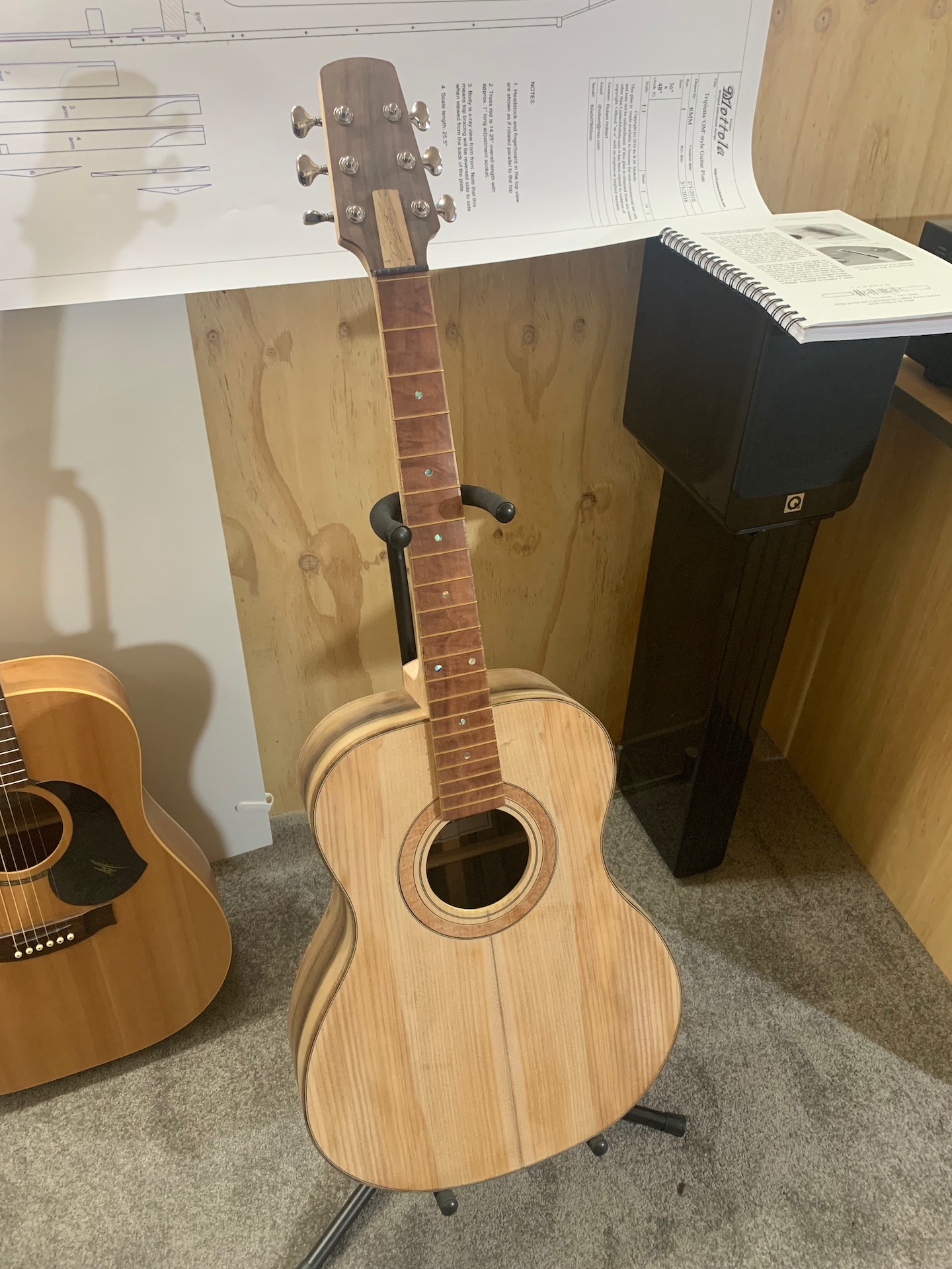

More progress.

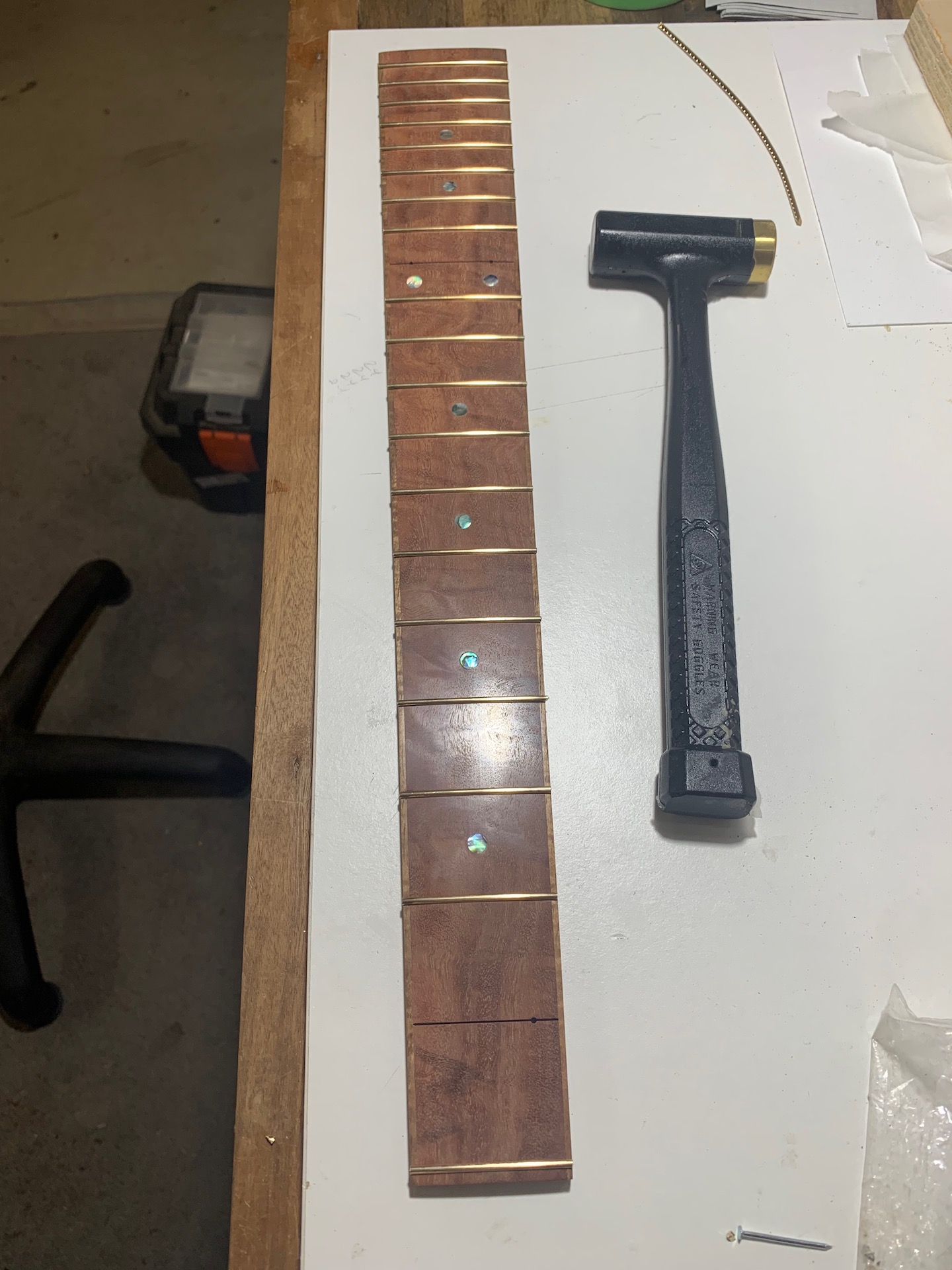

1. Box is closed, and binding channels cut with the StewMac jig. Fitting Blackwood binding plus black/white purling on the top. Still having some trouble getting consistent depths and a consistent cut - I think greater patience, and a new router bit, are called for.

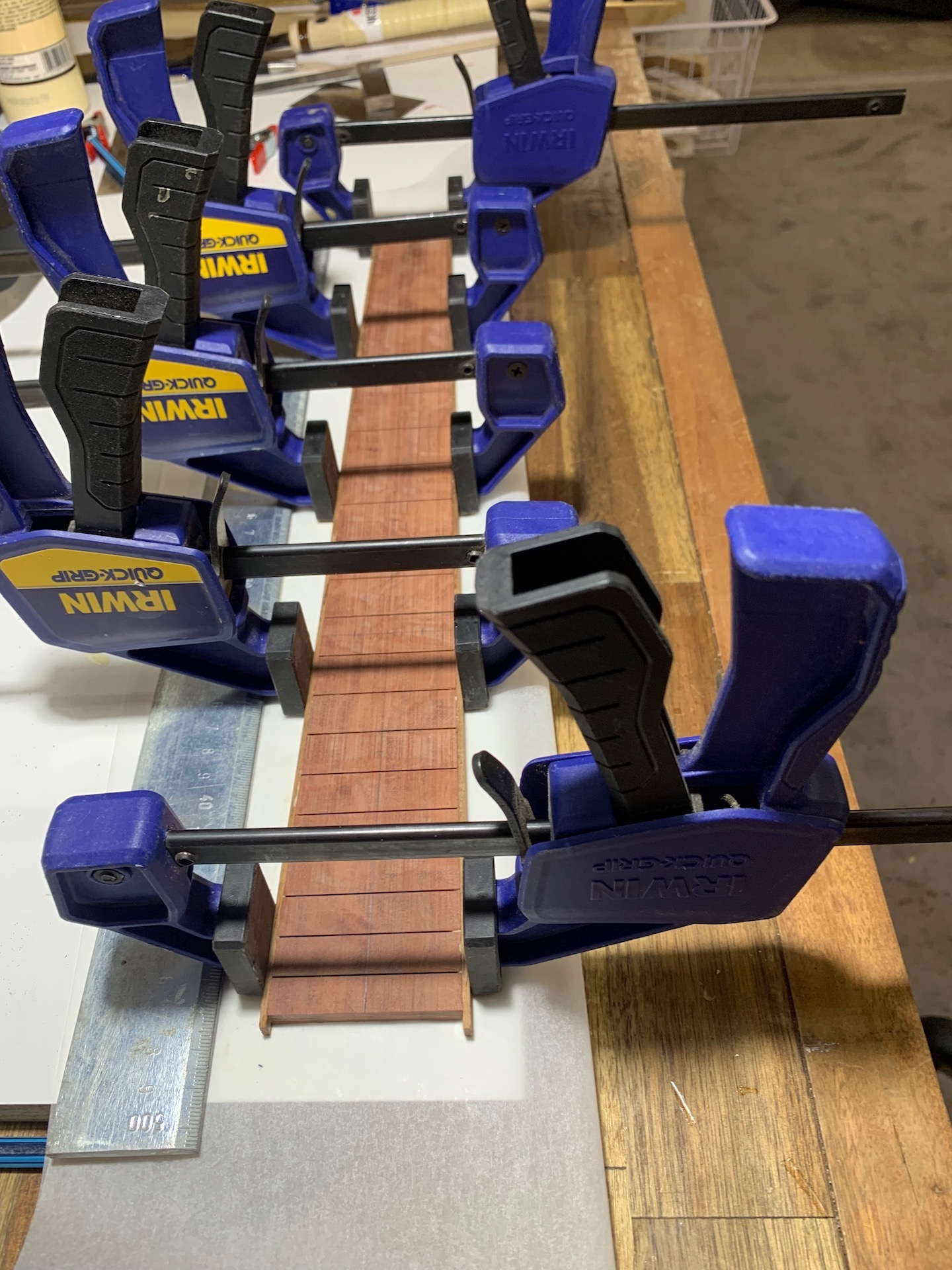

2. Installed sassafras bindings on the jarah fretboard, installed abalone dots, then hammered in some medium gold frets

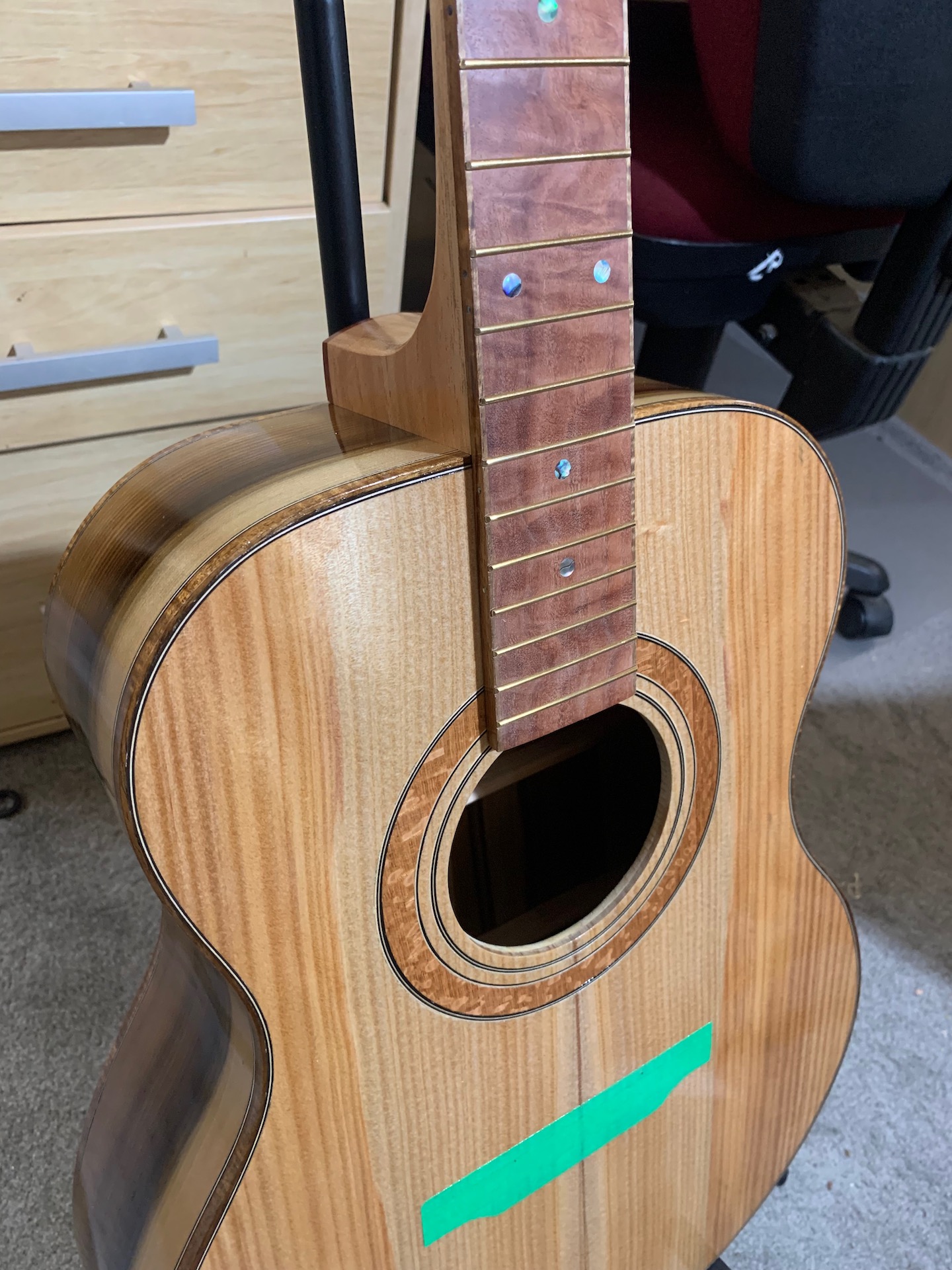

3. Installed a two way truss rod in the Queensland Mahogany neck, then attached fretboard. Some gidgee for the head stock veneer.
4. A bit of a dress rehearsal, a check neck angle and fit, before seriously cleaning and detailing body and neck. Very hard to exercise patience at this point - really keen to hear it, play it!

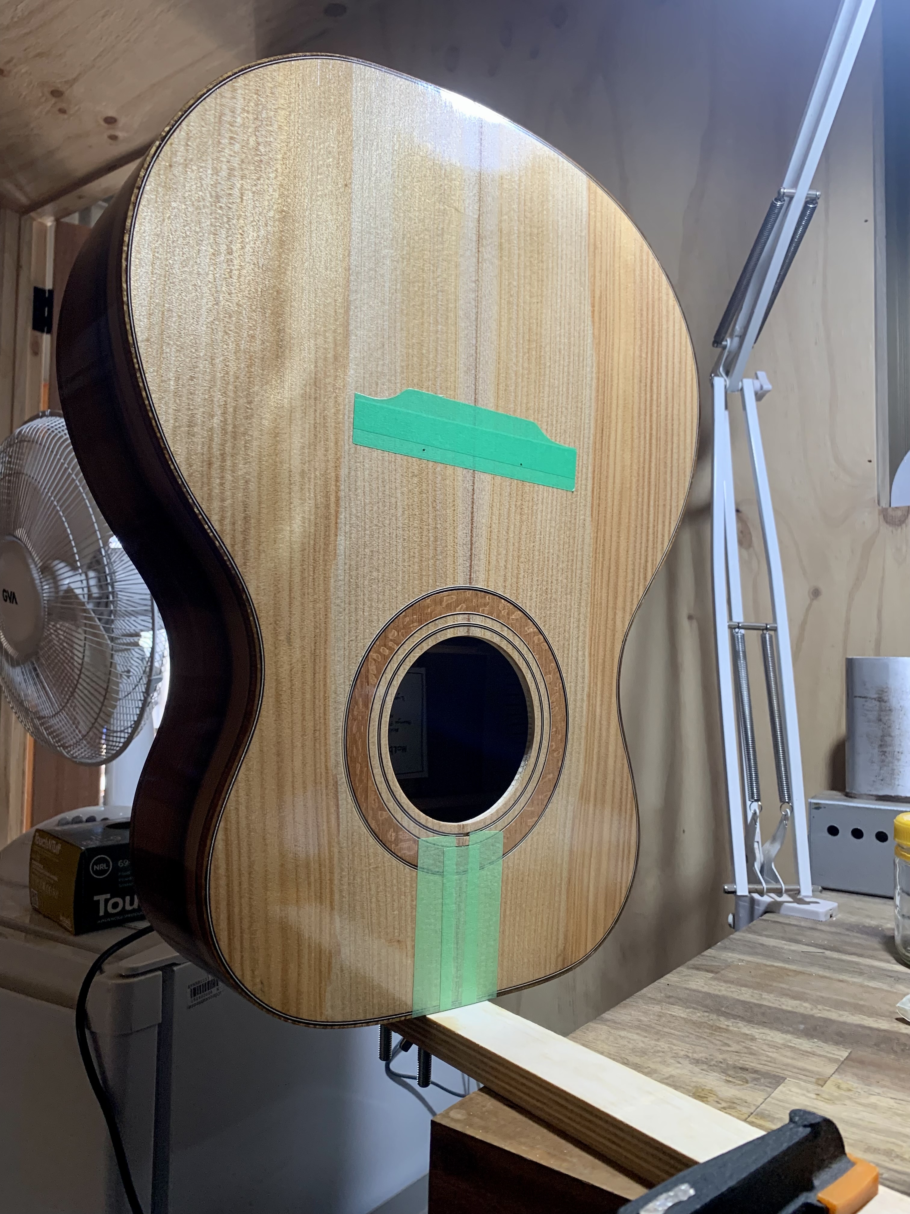

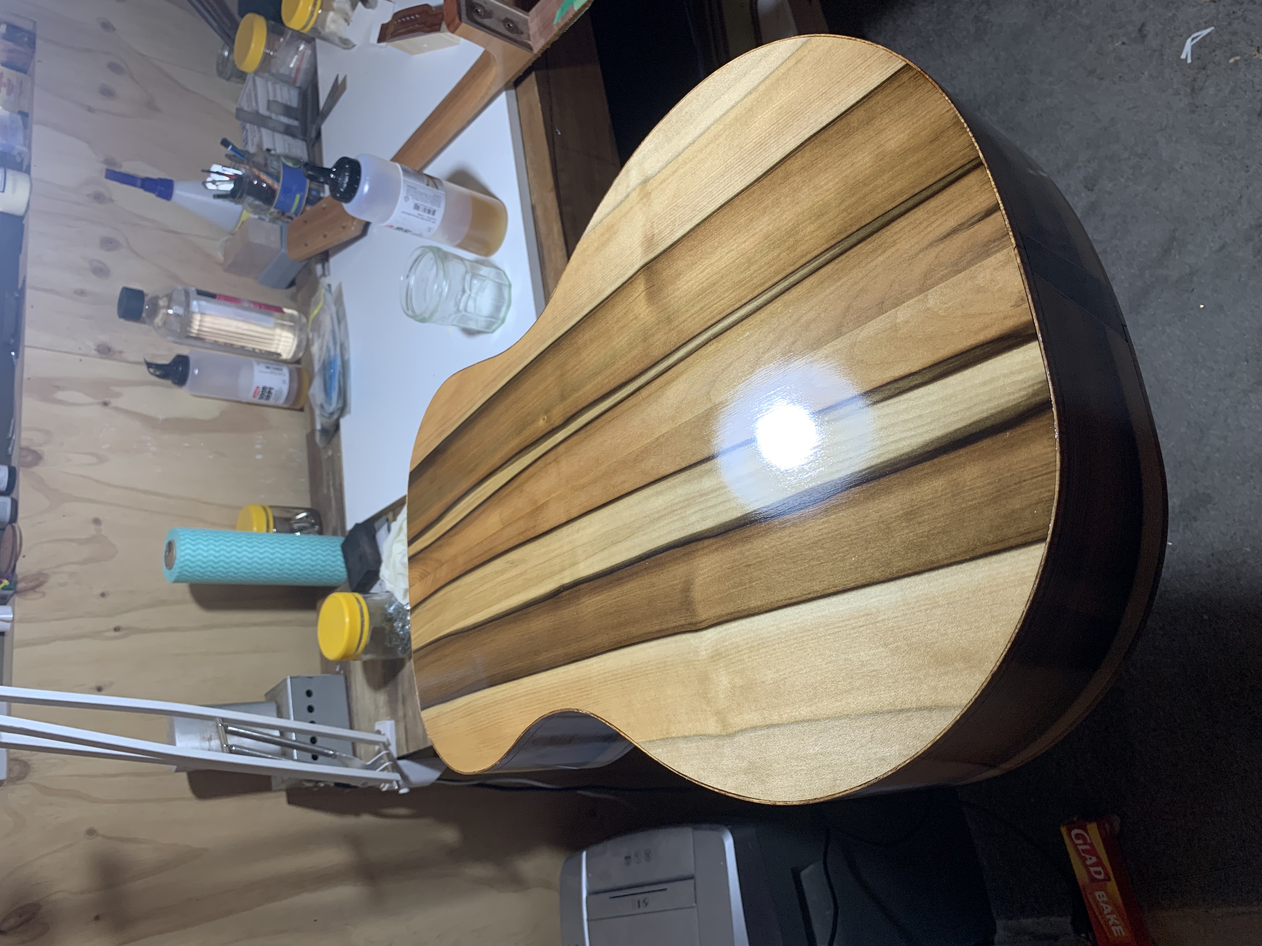

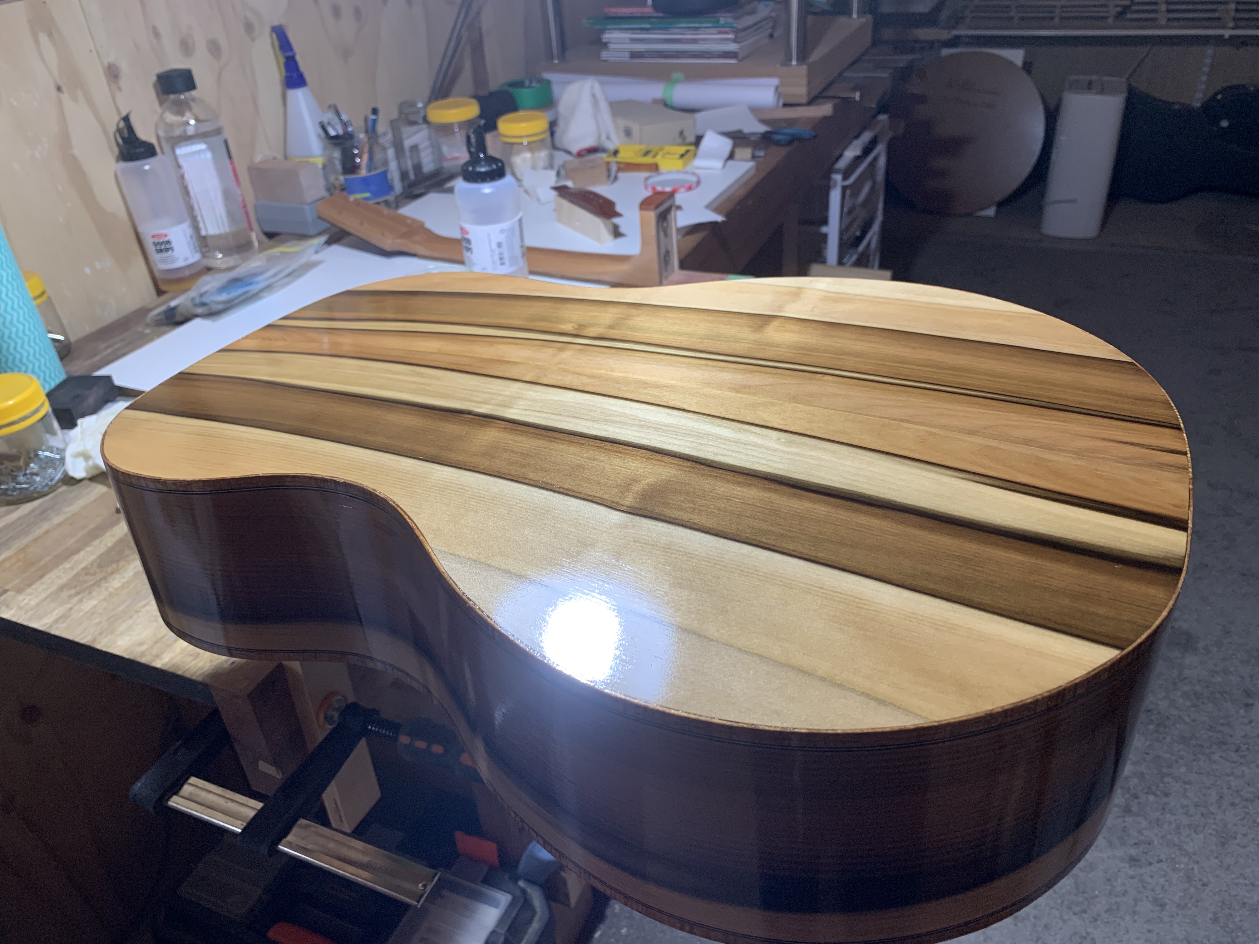

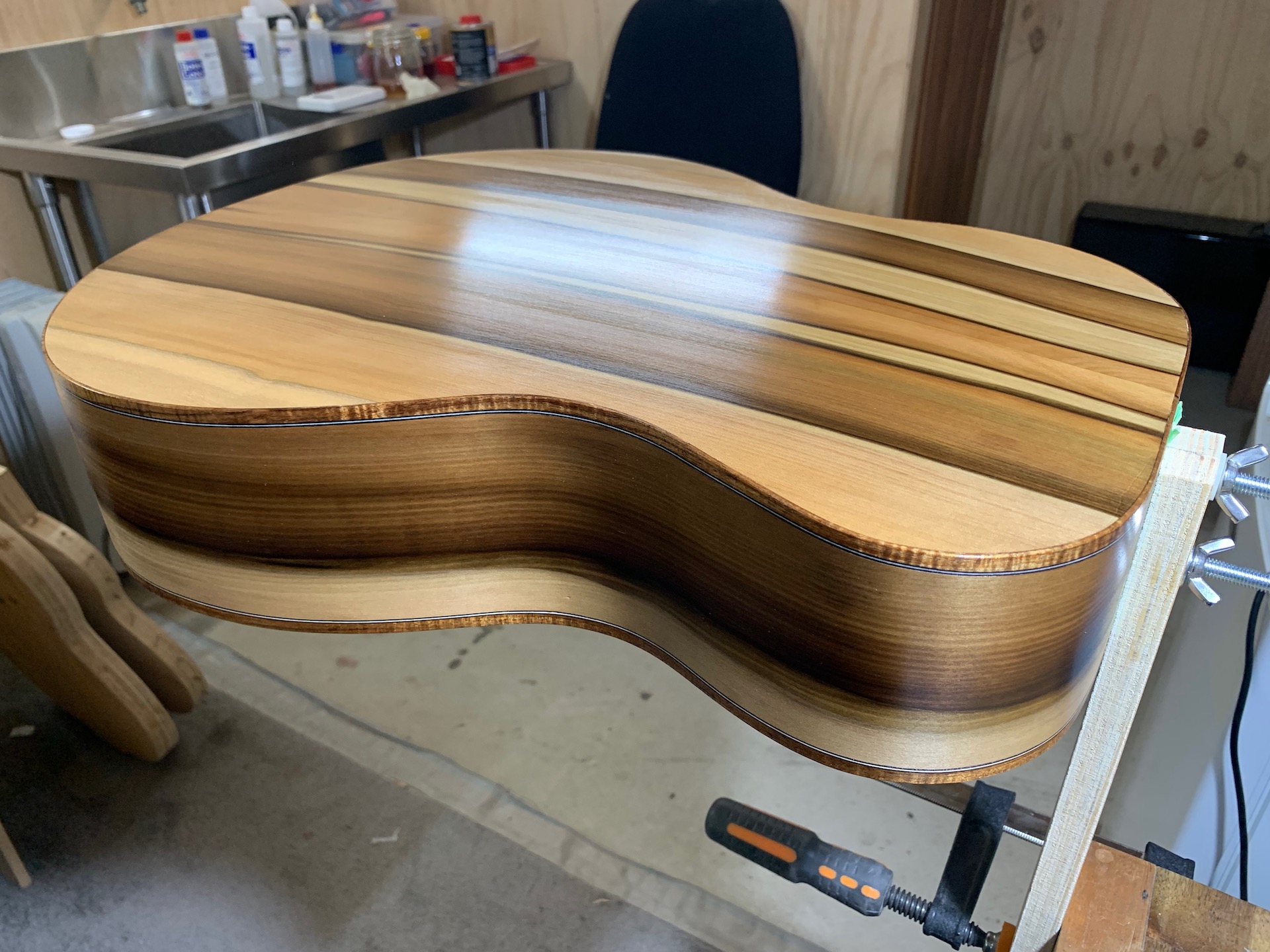

Post by Bob_H » Sat Jun 10, 2023 3:27 pm
A couple of coats of shellac for sealing - and to start to see the colouring. A light sanding and then time to start applying the hardened shellac finish in earnest.

Post by Bob_H » Fri Jun 16, 2023 6:40 pm
Colours coming up nicely. The soundboard is particularly interesting. Using a hardened shellac, wiped on, and will polish up after curing

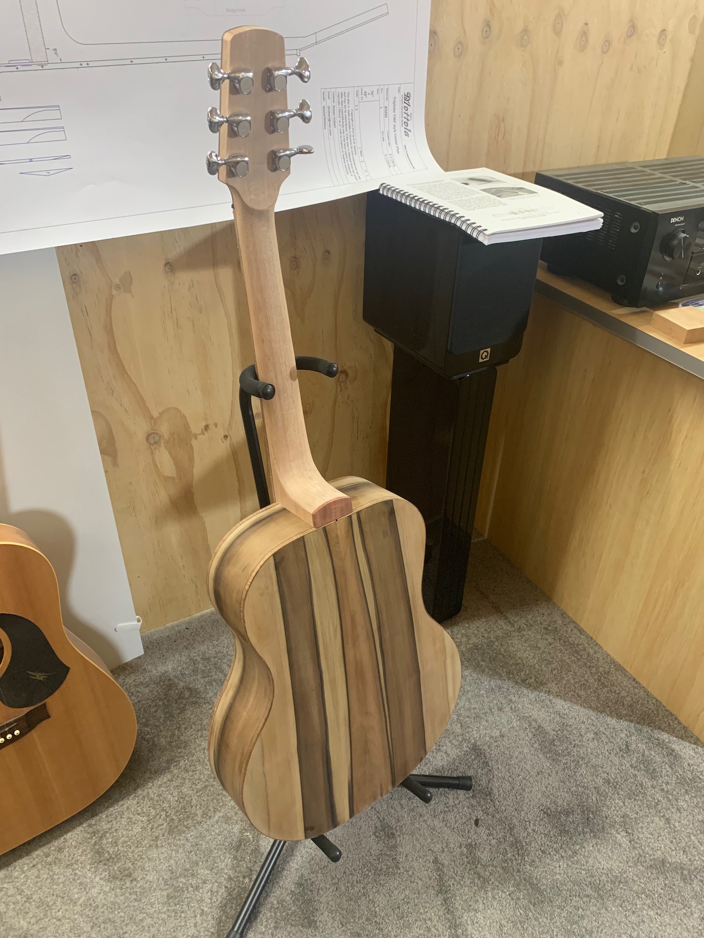

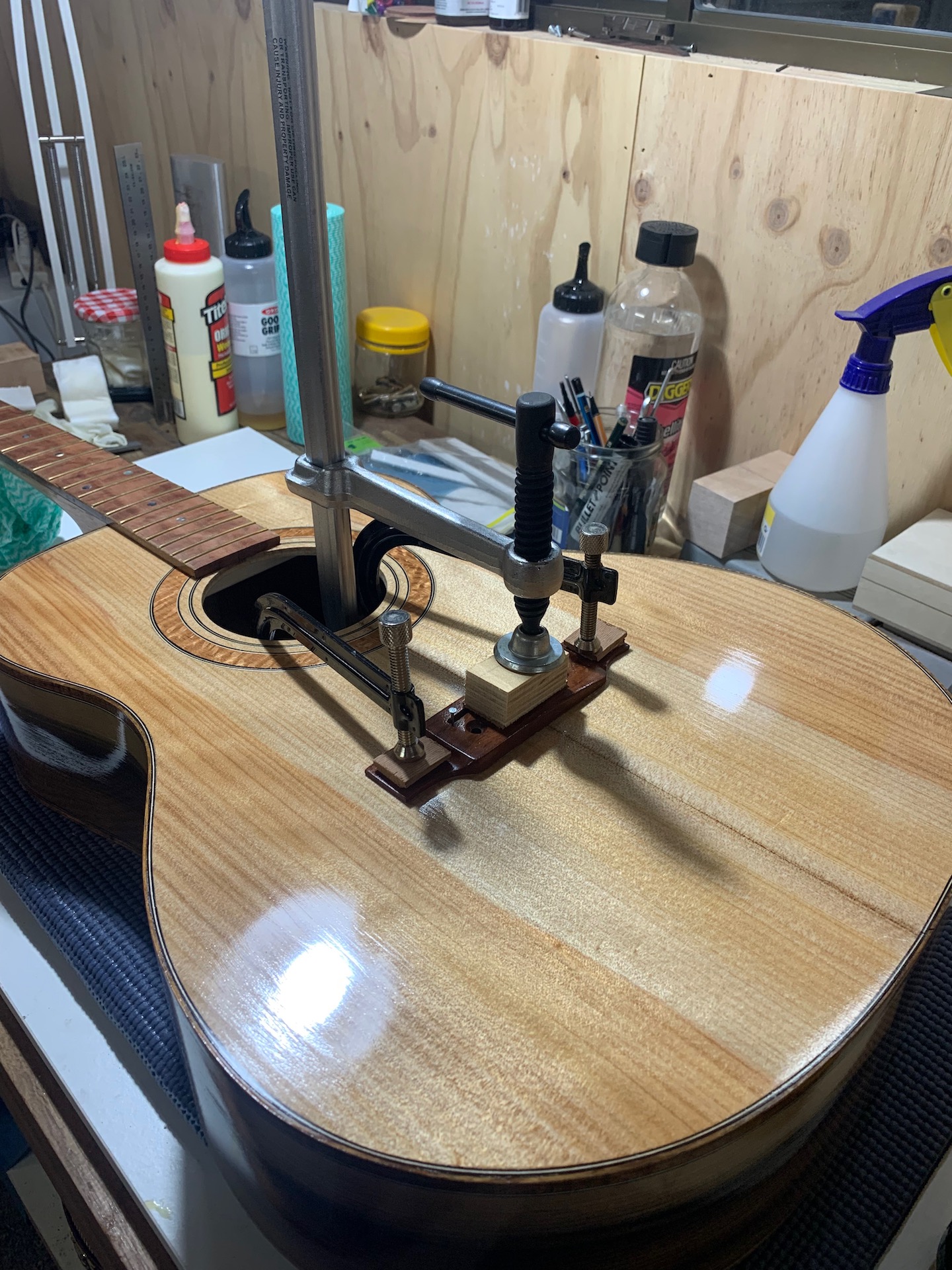

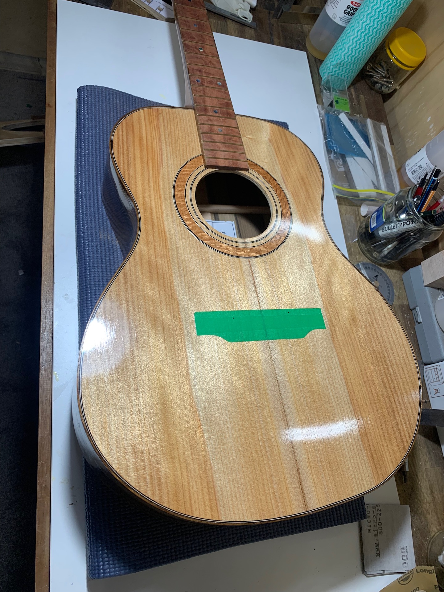

Post by Bob_H » Sat Jul 01, 2023 1:48 pm
Pretty happy with the fit and finish so far - really liking the colours coming through, including in the soundboard (thanks Tim). Time to glue on the bridge.
