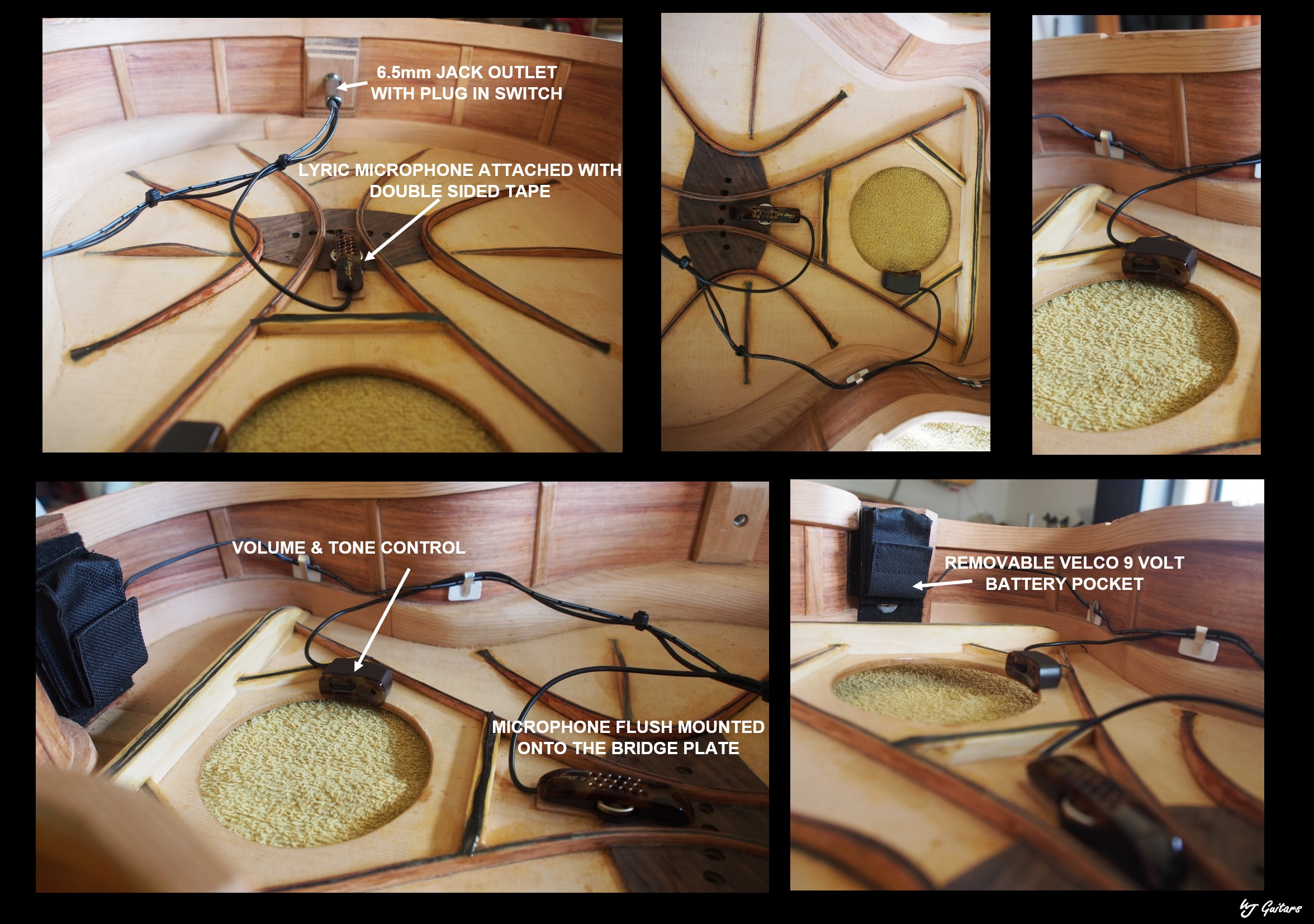

I have installed the ‘LR Baggs Lyric Microphone’ on many falcate braced guitars, see photo as posted. The sound quality is excellent. Musicians seeking a more natural acoustic guitar sound also like this pickup.

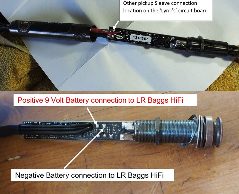

I have also installed both the 'Lyric Microphone' and the 'JJB 330 Prestige' pickup together for a blended sound in a steel string acoustic guitar that has a falcate braced top. This involved fitting the ‘JJB 330 Prestige’ pickup on the falcate bridge plate below the bridge pins and the ‘Lyric Microphone’ above as shown above in this posting. (Note: The ‘LR Baggs Anthem’ pickup is an alternate option for a duo pickup system that has a piezo under-saddle pickup and microphone setup with volume blend controls. The ‘Anthem’ duo pickups are sent to a combined single mono output).
The ‘JJB 330 Prestige pickup output cable is soldered onto the ‘Lyric Microphones’ circuit board. The ‘Lyric Microphone’ has a stereo connector with the tip, ring and sleeve. The tip contact is used to send the ‘Lyric Microphone’ output and the ring is used to send the other pickup to a external two channel preamp. There is a terminal on the ‘Lyric Microphone’ circuit board to connect to the ring contact. See photo below.
This type of setup works very well and takes the steel string acoustic amplified sound to another level that musicians love. The ‘Lyric Microphone’ and the ‘JJB 330 Prestige’ pickup systems can be blended together using an external two channel preamp that can be connected to a sound system. Two channel preamps such as the ‘Grace Felix 2’, ‘PZ-PRO’ or, the ‘K & K Quantum Blender are designed for two channel acoustic guitar pickup systems that work very well when connected to a sound system.

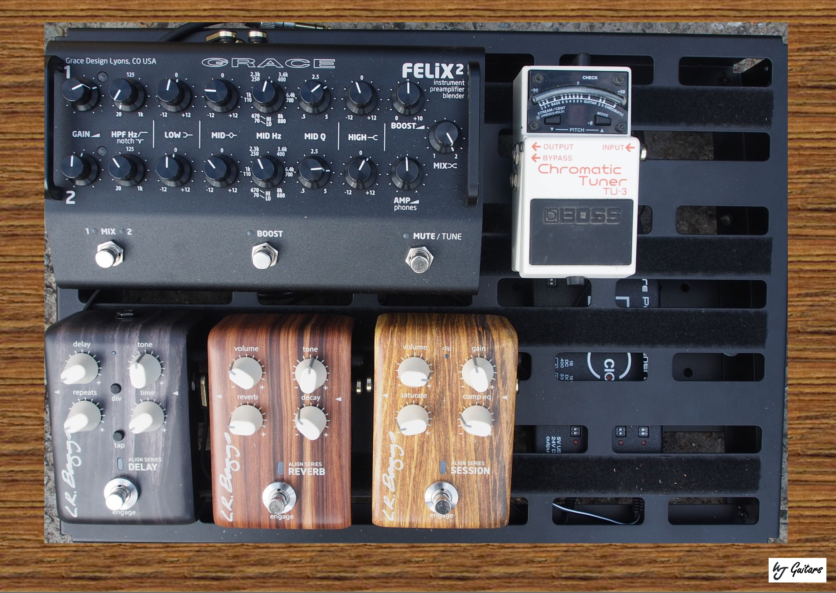

The Grace Felix 2’ has notch and parametric eq controls, plus a variable phase control to align the two pickups in phase that are spaced apart. This preamp has a feature to select and match the input impedance that will maximise the performance of the two pickup systems. This two-channel preamp is a great tool to craft the guitar sound to suit room acoustics with a sound system and overcome feedback problems.
I will be installing the ‘HiFi’ and the ‘Lyric Microphone’ together on my next guitar build. I will be connecting the wiring in such a way that only one 9-volt battery will be used to power both of these preamps.

Here are some links regarding the two channel preamps mentioned:

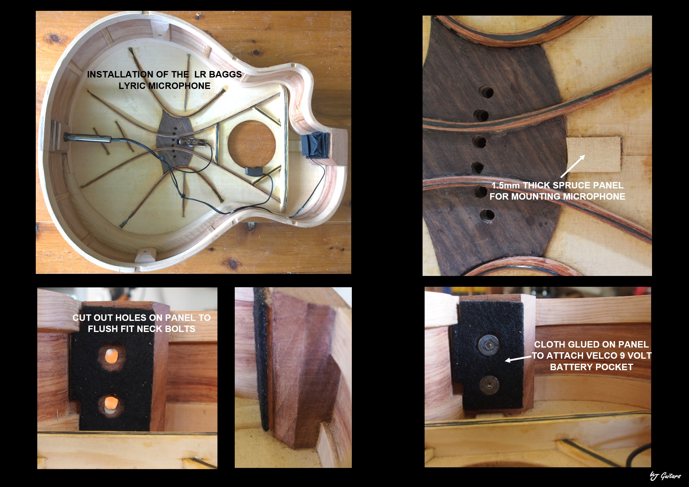

More information on installing the ‘LR Baggs Lyric Microphone’ in a Falcate braced acoustic guitar
The ‘Lyric’ microphone is a PZM (Pressure Zone Microphone) design. This is based upon a boundary zone principle where the microphone’s charged plate is positioned slightly above the falcate braced top. Generally, positioning the ‘Lyric’ inside the guitar box works well. On ‘X’ braced guitars the ‘Lyric microphone is placed parallel close to front of the bridge pins. For details refer to ‘LR Baggs’ installation documentation. This is not feasible to install the ‘Lyric’ microphone parallel to the bridge pins in a falcate braced guitar. Rotating the ‘Lyric’ microphone 90 degrees resolves this problem as it is important to have the ‘Lyric’ microphone installed attached to the soundboard top for the PZM principle to work. See photos in this posting.
For a 14-fret body joint falcate braced guitar it is necessary to install a spruce patch flush to the bridge plate to mount the ‘Lyric’ microphone correctly. For a 12-fret body joint falcate braced guitar the bridge and bridge plate are located further away from the sound hole and therefore, the ‘Lyric’ microphone can be mounted directly onto the sound board between the bridge plate and the sound hole brace.
The ’Lyric’ microphone as mentioned works on a PZM principle and is suitable for working inside the guitar box compared to other types of microphones installed inside the guitar box that have either a ‘omni’ polar pattern or, a cardioid polar pattern that require serve cuts in the low and low mid frequency range to work. This is not helpful when aiming to retain the warmth in the low and low mid frequency range.
Another aspect to consider is the musician playing the guitar with a microphone installed inside the guitar box. The microphone’s micro phonics may be an issue if the guitar is roughly handled. Generally, the micro phonics is not a problem with careful users when playing the guitar. For tapping or, drumming on the guitar box the 'Lyric' microphone also works well when amplified.
