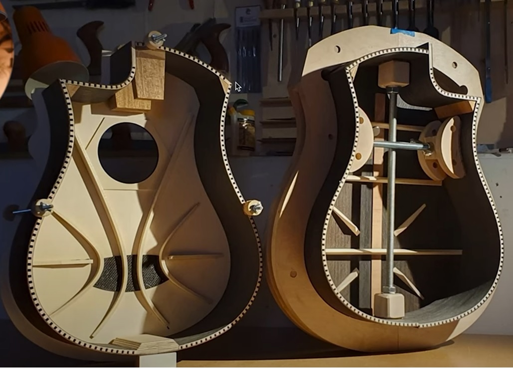

Tom was talking about some luthiers guitar builders and one of the samples included a Falcate braced guitar build by 'Salz-Guitars'. The guitar shown was a falcate braced guitar and appeared to have no CF on the bracing. See screen shot photo.
I like the sound quality of this guitar build. See youtube link
https://www.youtube.com/watch?v=Dyp5ZSXbvZw
Be interested to know the forum's thoughts are regarding the bracing with no CF for this guitar hybrid design build.

I wonder not having CF top and toe on the braces plus no upper transverse brace could be a long term structural issues. What are Trevor's thoughts on this 'Salz-Guitar's' hybrid falcate design?

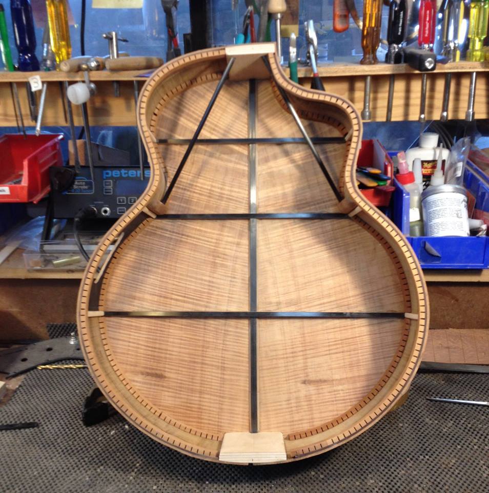

When Rick Turner was living in Tasmania, I asked him why he had carbon fibre only on the top of his braces, on tops and backs. He said that he felt it wasn't necessary to have it on the bottom of braces, because the top itself (or the back) was already doing the job that carbon fibre would do. However, personally, I think that I would probably err on the side of caution, and take Trevor's advice.

Im more concerned about the lack of UTB on that top..... :shock: :shock: :shock:
However, on closer look at the photo, i reckon that top is not glued to the sides yet (otherwise why have the spool clamps there, and why no side braces yet?), so who's to say the top didnt end up with CF on the braces and an UTB ?
Good pickup on the photo Steve about the top not glued in yet. I can't see any flared tails of carbon fibre on the toe side of the braces. Maybe carbon fibre was added only onto the top of the braces after this photo? Although you would have thought showing a photo of the top braces would have been shown as completed. I guess that we can not be sure unless 'Salz-Guitars' in the Czech Republic were contacted on their instagram.

Mike Thomas wrote:
Mon May 01, 2023 1:24 pm

Post by SalzGuitars » Tue May 02, 2023 10:02 pm
Hello everyone, David form Salz guitars here. I love how the discussion evolved from my instagram photo. As Steve wrote, the top is not yet glued to the rim. The photo was only a work in progress photo, staged to show my progress. There are however CF strands under the braces, I'm building the se two acording to the book. The only difference is that I'm using structured sides (credit to Jeremy Clark of 52instrment co.) so there won't be side braces.
