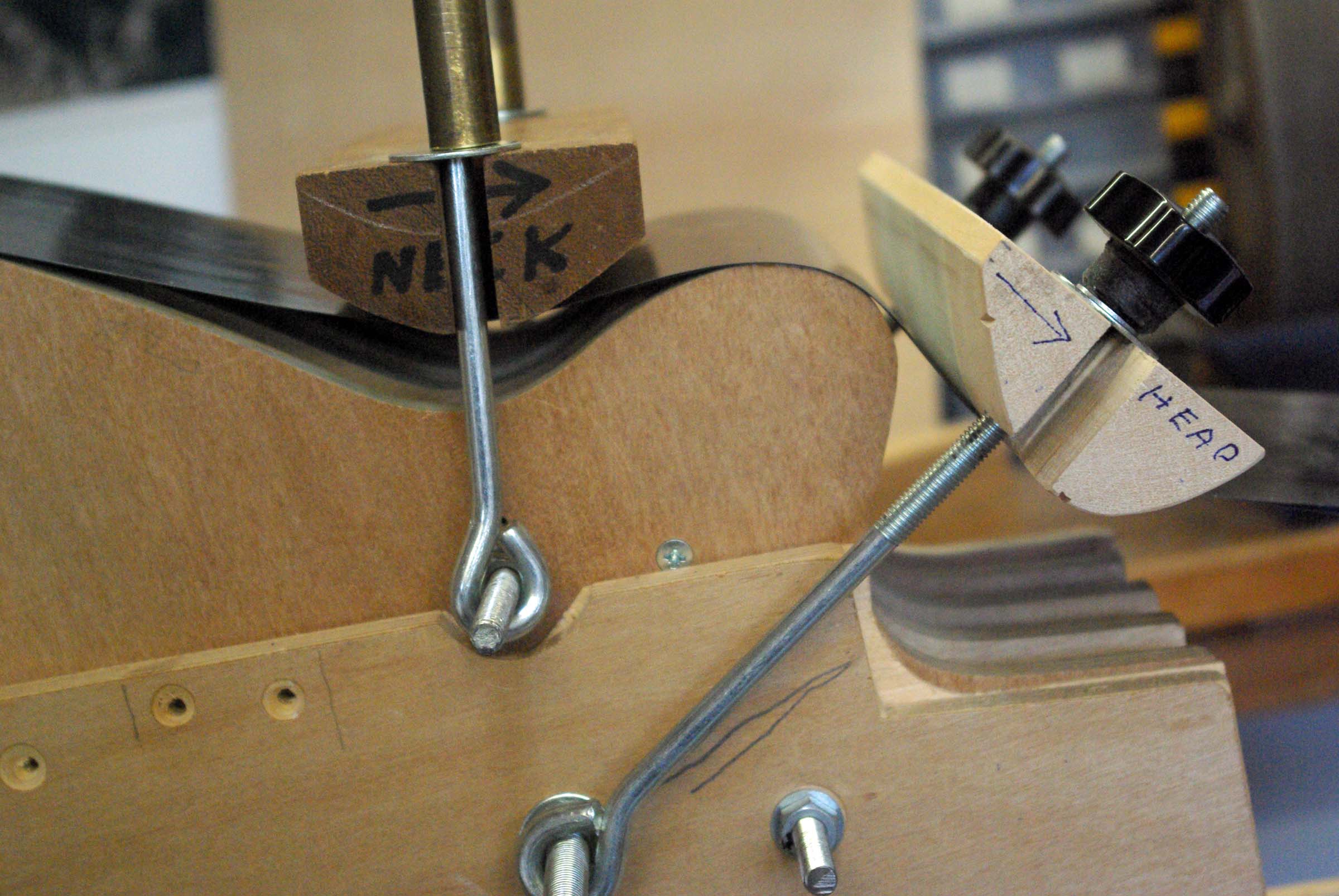

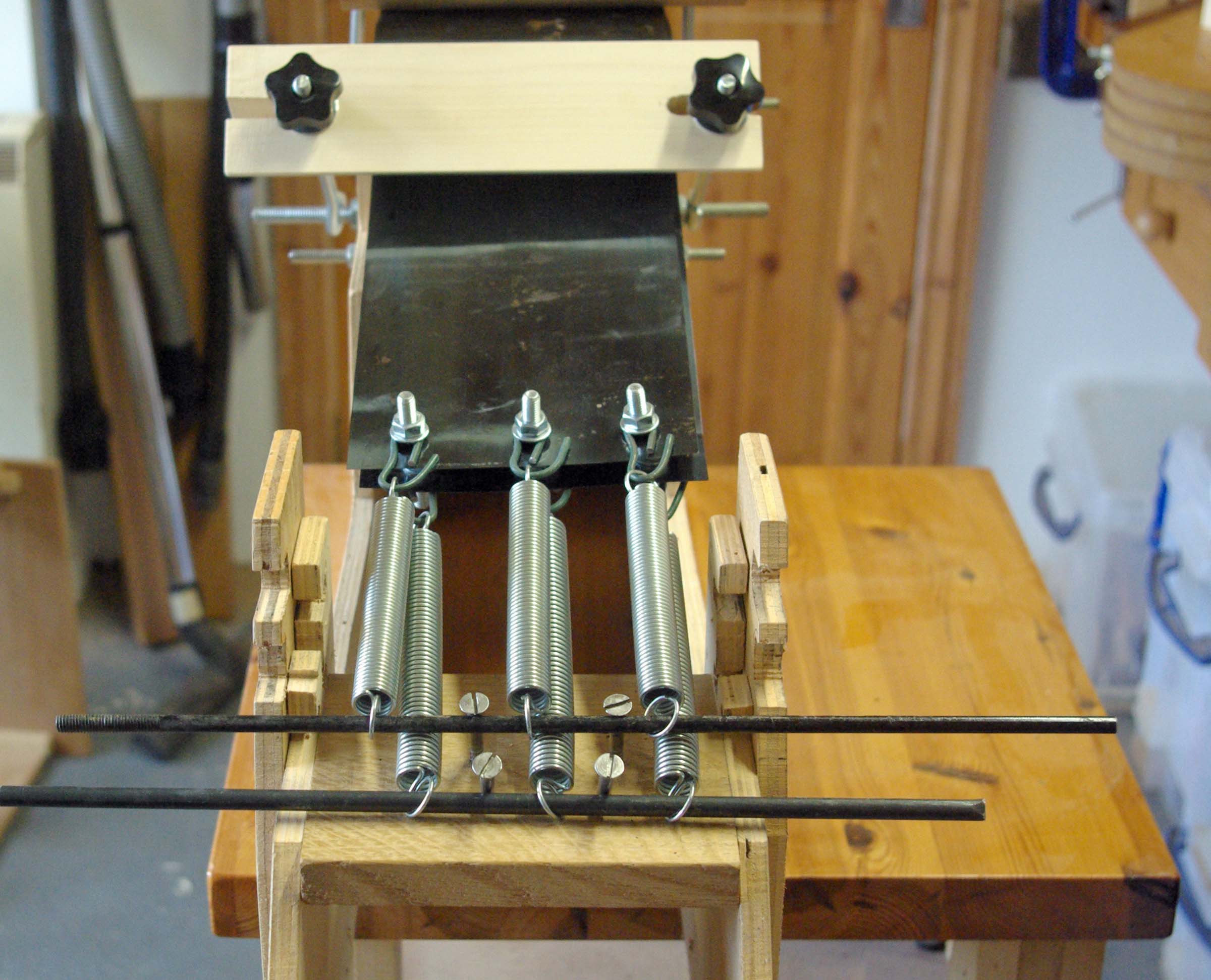

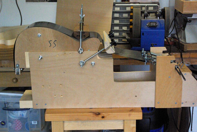

Any heat bending of timber requires support on the outside of the bend. The classic Fox bender provides this, particularly with the sprung support under the waist bend. You can find plenty of videos by the furniture makers as to how they do this.
The problem with the cutaway bend is that you have a double bend - an s bend if you will. So the steel slats on a conventional bender will only support the outside of one of the bends. I have a rather Heath Robinson bender which keeps tension on both of the spring steel slats. Not my idea but copied from someone generous on the web. It works well and I don't tend to get cracked sides even though I do quite sharply bent cutaways.
I think spring steel is the way to go. I bought mine from one of the two sites in America. I don't have an answer to your original question but they just work. You do though have to keep them away from the water and steam. I wrap the timber in Al foil.
A few pics should show the general idea.

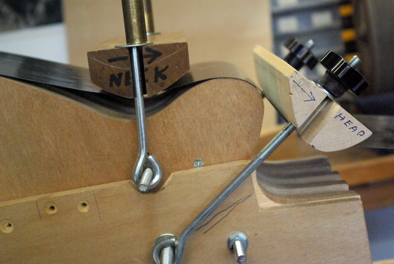

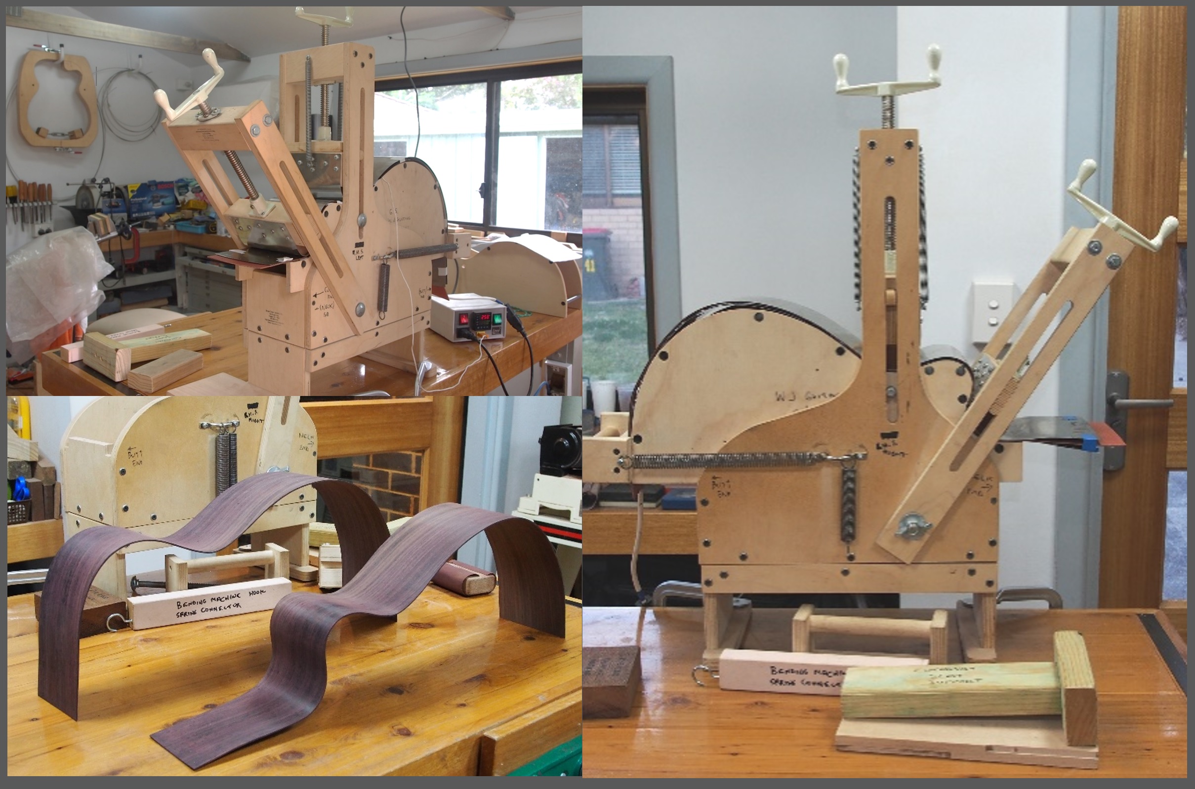

Here are some photos showing my fox bending machine of a cutaway. Of recent times I now use spring steel slats.

WJ Guitars wrote: ↑Sun May 07, 2023 8:50 amHere are some photos showing my fox bending machine of a cutaway. Of recent times I now use spring steel slats.

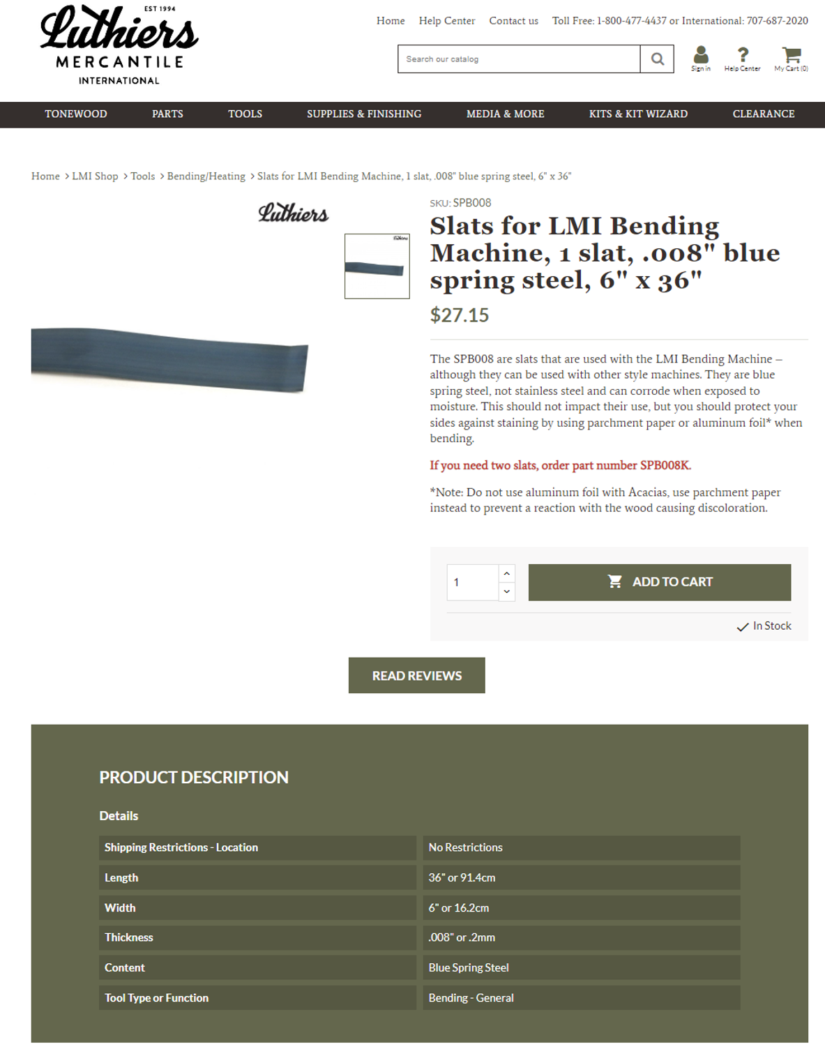

But the initial question is still not answered. If you´re using steel (or spring steel) which thickness are the slats you are using?
Btw. I like the idea of keeping both side under tension. Just need to find a way to incorporate it into the existing tool. And find some springs

I don't have a micrometer but the spring steel I'm using is a little more than 0.2 mm. As I said it is the standard product from one of the two US guitar making shops.

Thanks Martin. I hope that providing more detail is helpful for the forum.kiwigeo wrote: ↑Sun May 07, 2023 11:54 amLOL....you never fail to impress with the clear and neat labeling of everything in your photos. Impressive.

For spring steel slat sizes available from LMI see below.JurgenV wrote: ↑Sun May 07, 2023 6:55 pmThanks for your posts...
