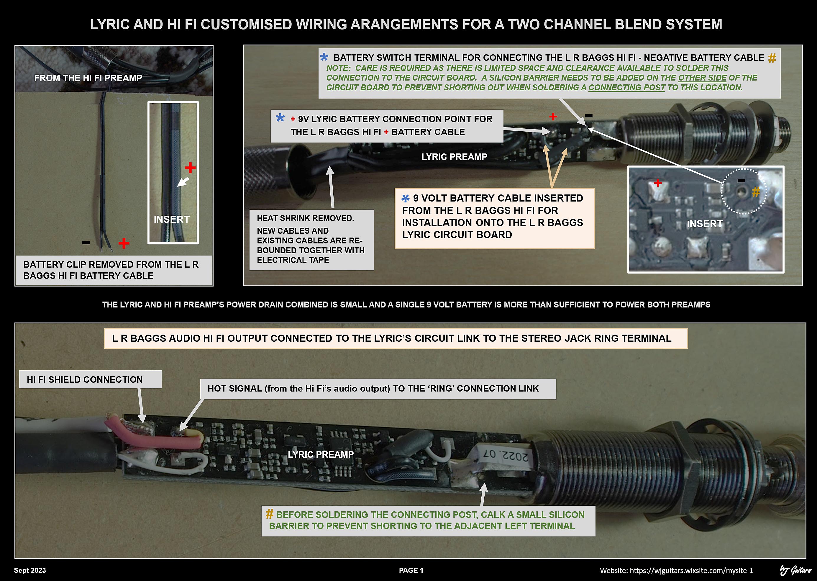

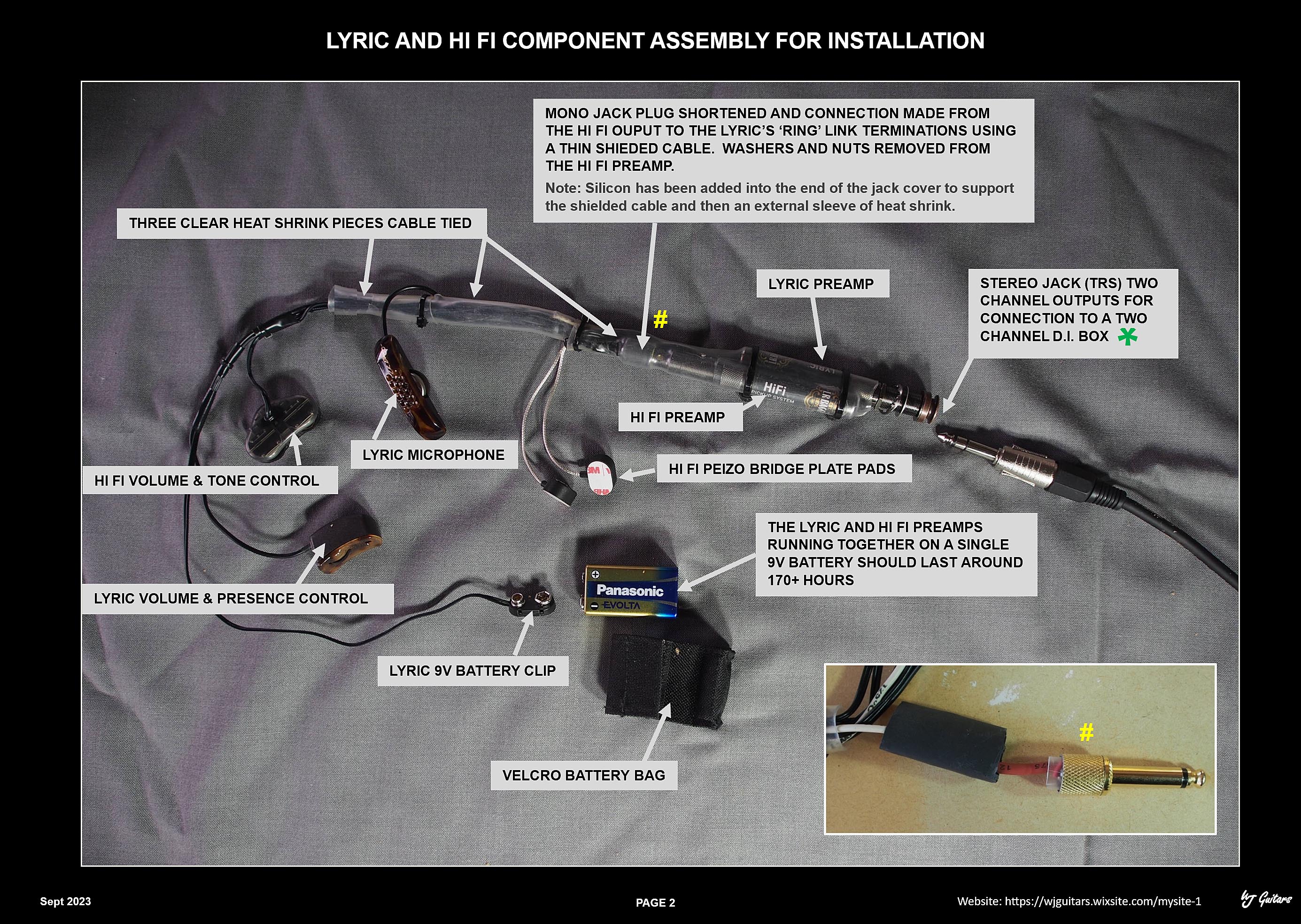

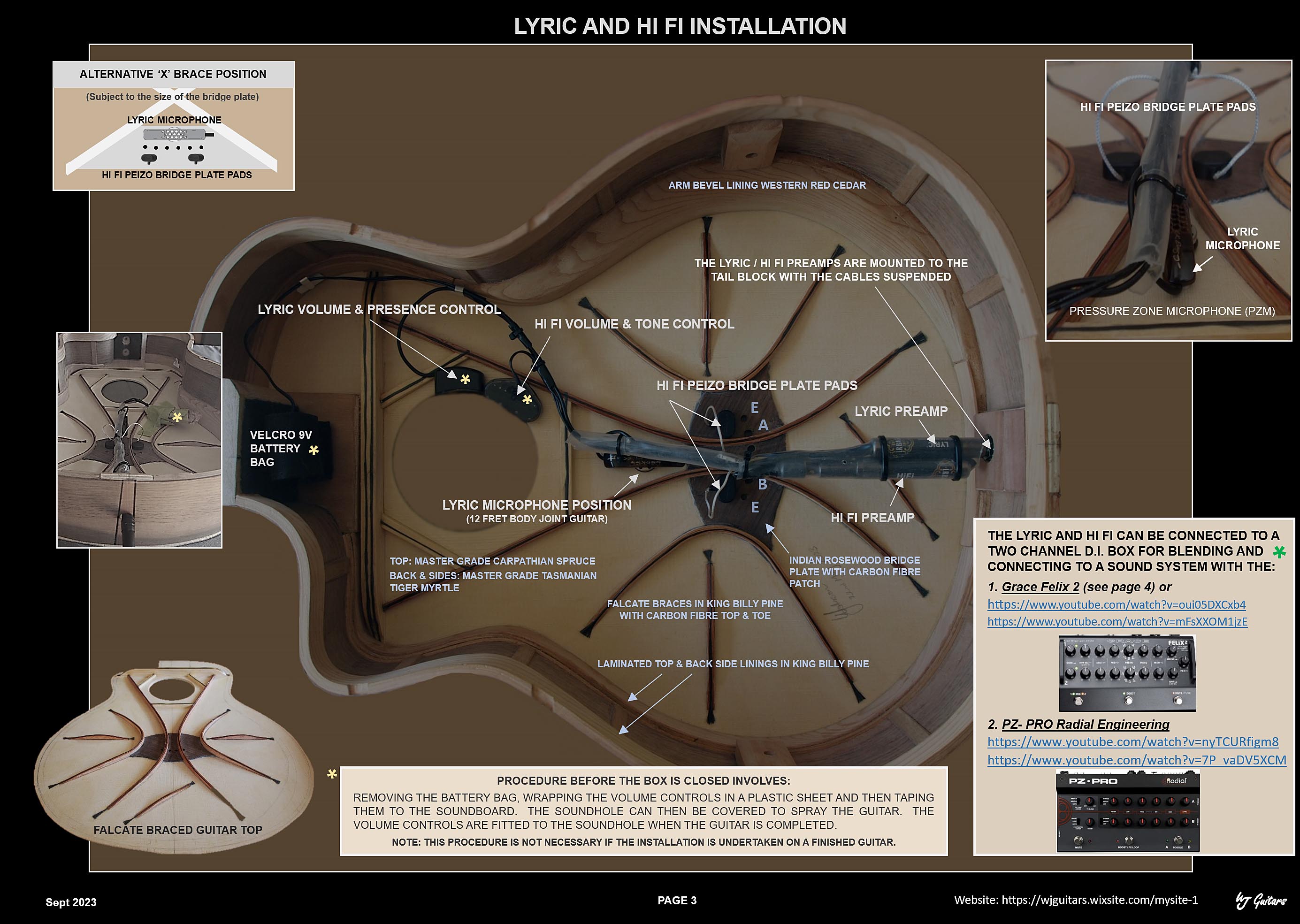

On a previous posting: ‘Pickup for falcate classical or steel string by JurgenV, 19th April 2023’, I indicated that on my next guitar build that I would be installing the new ‘L R Baggs Hi Fi Pickup System’ and the ‘L R Baggs Lyric Microphone’ together as a customised blend system. I have now completed the new guitar build and installed these pickups into this guitar. I have prepared a video to demonstrate how this setup works, plus photos showing the installation.

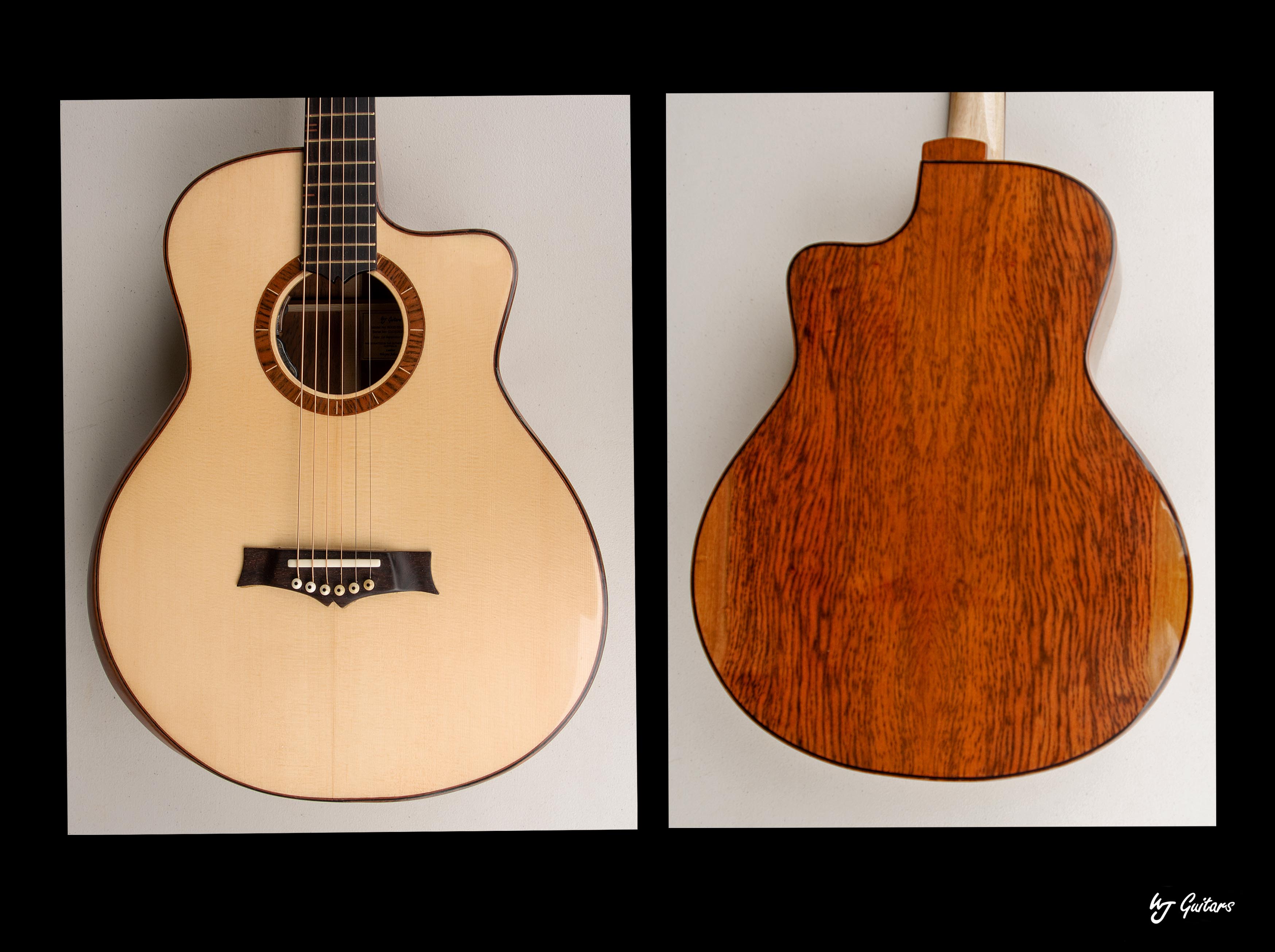

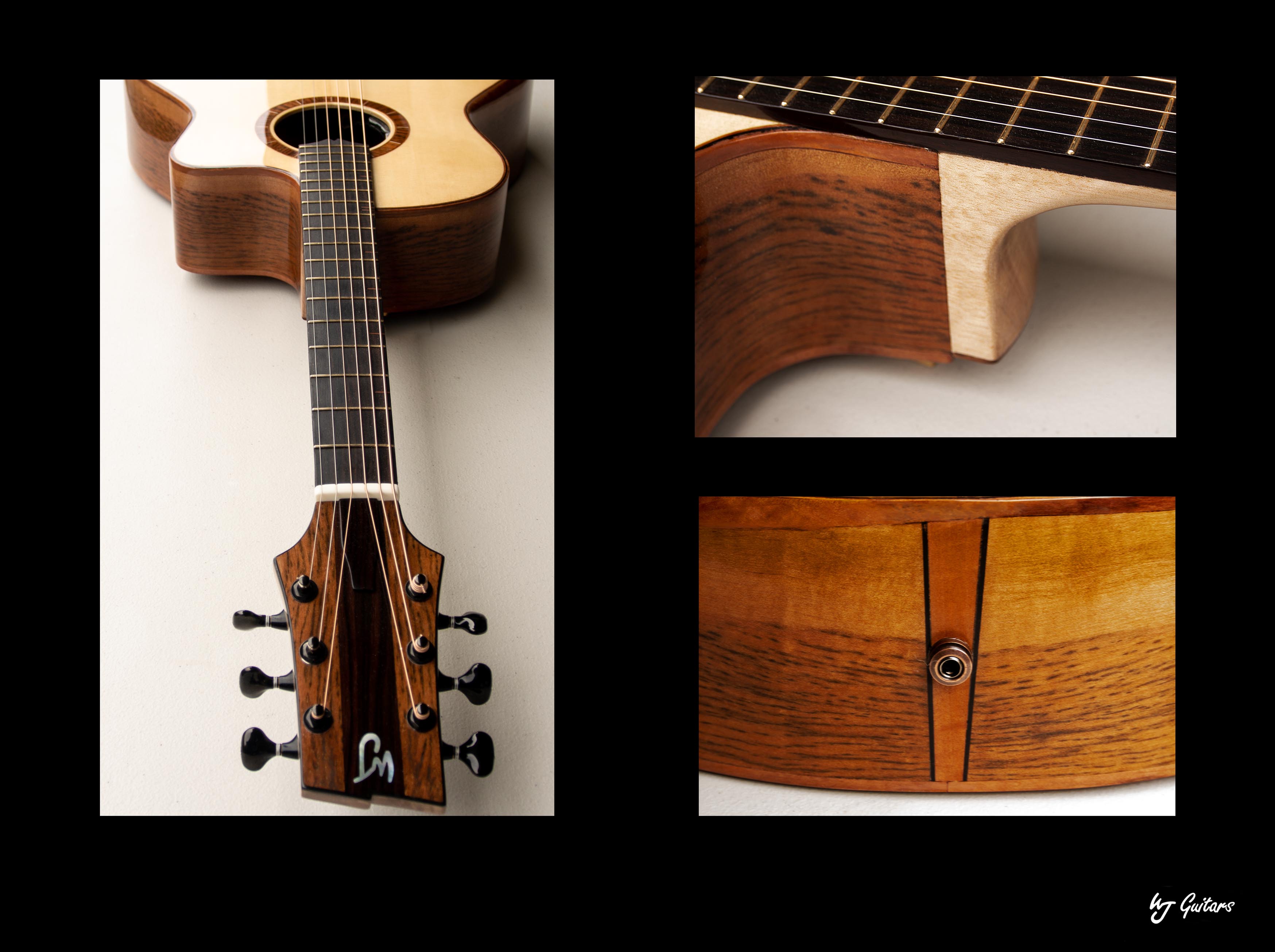

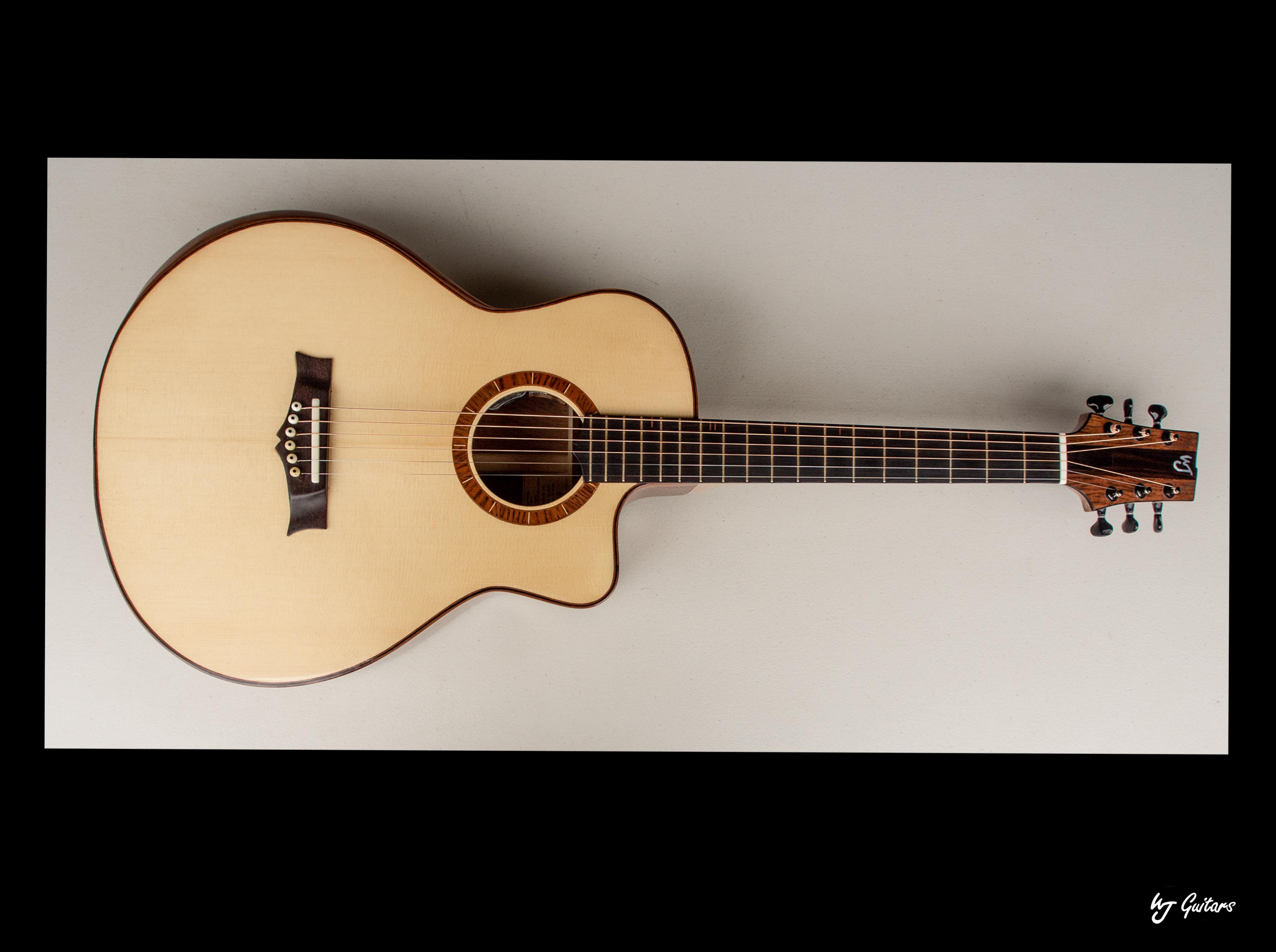

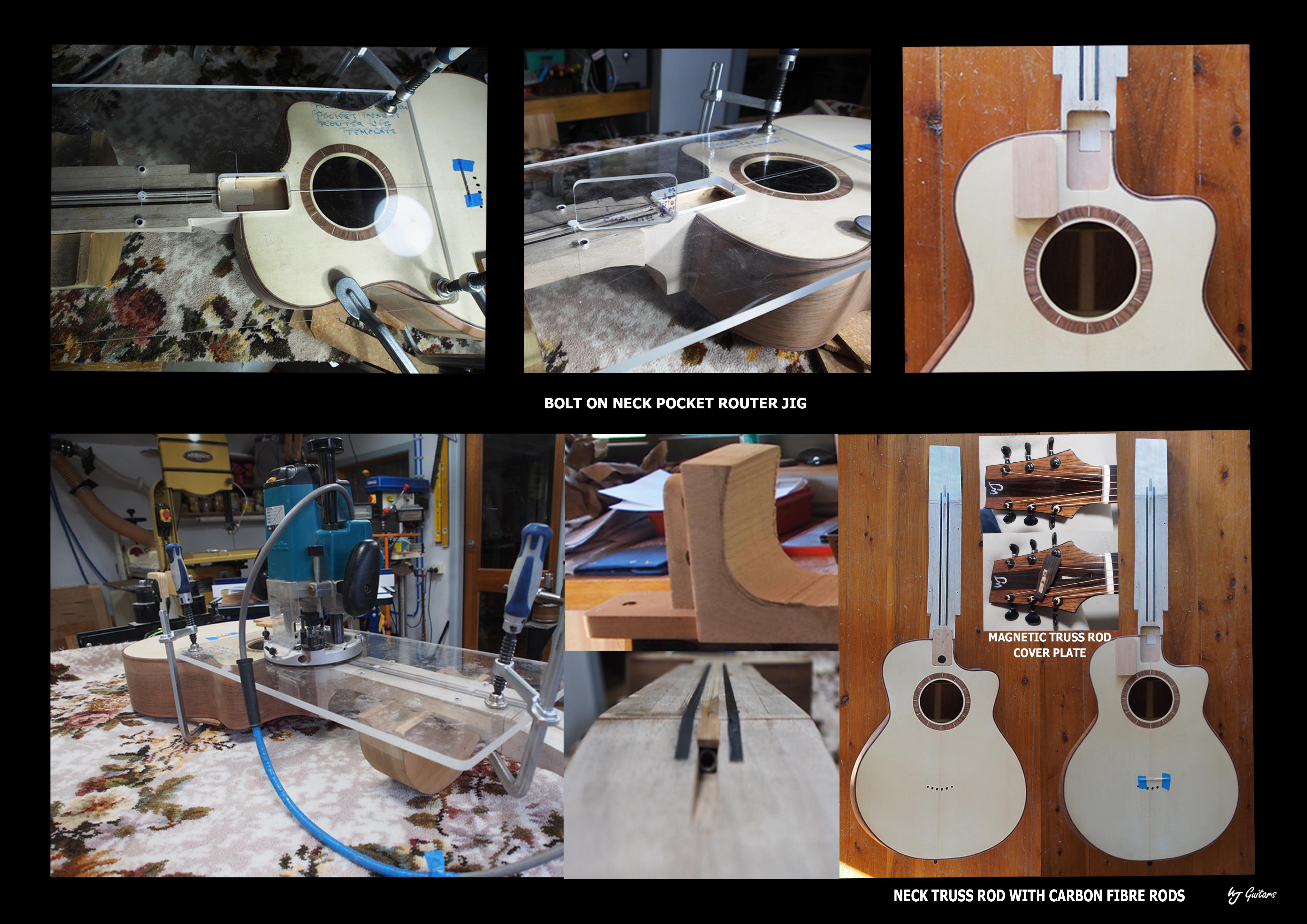

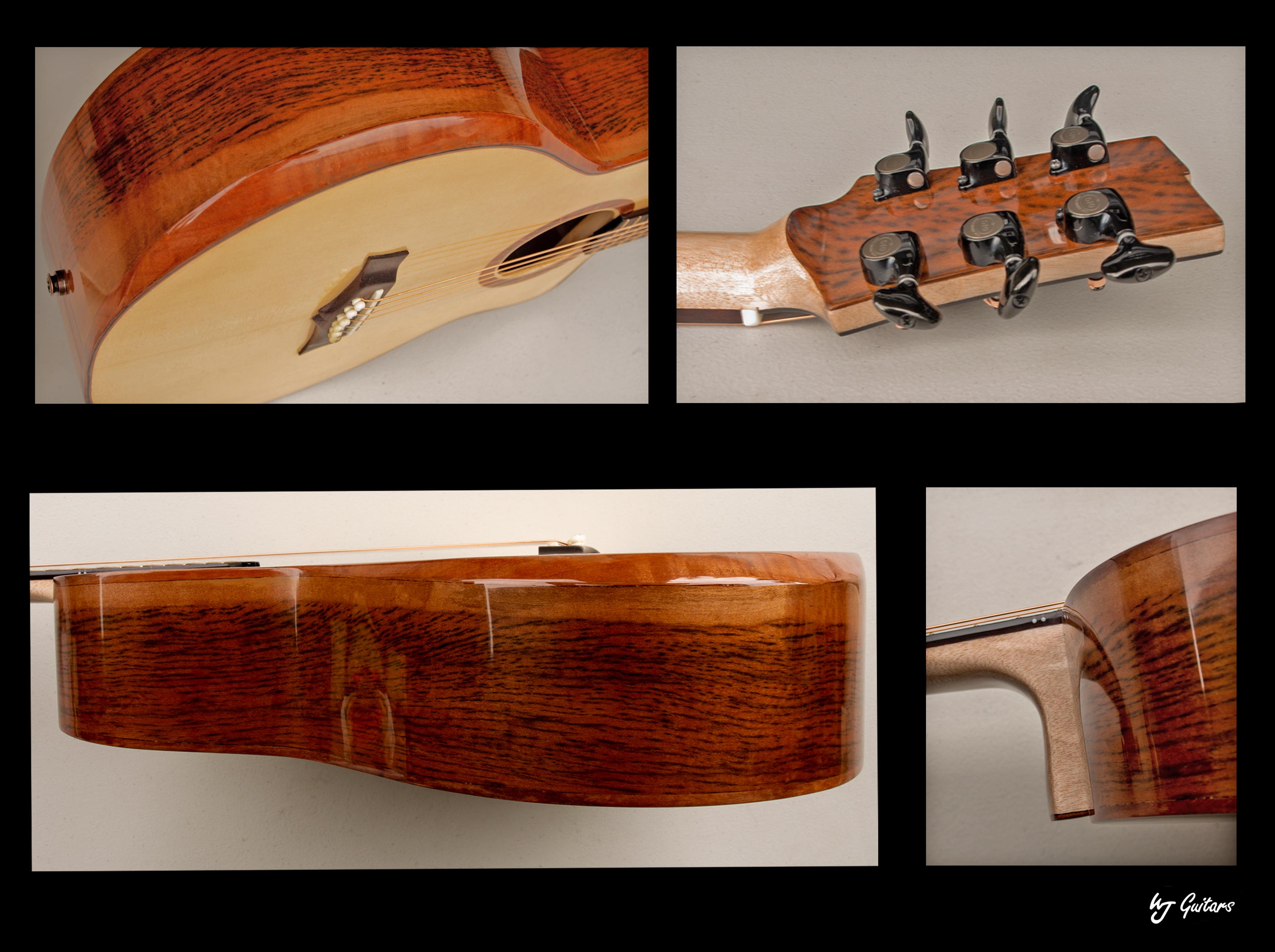

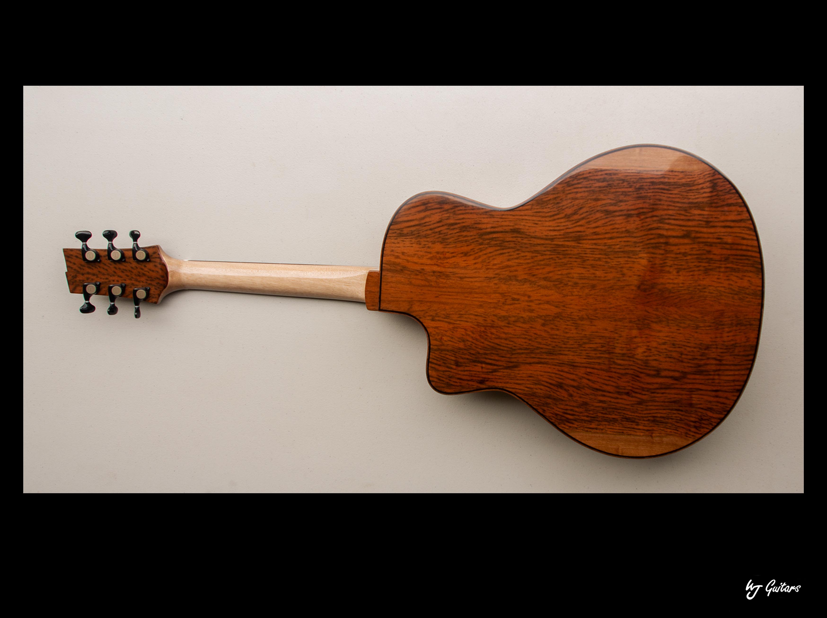

Manuals In regards to the new guitar build it has involved installing two Carbon Fibre Rods either side of the main two-way truss rod plus making the guitar neck a fully bolt on type of guitar neck. It was necessary to make some jigs to router and make the pocket. See photos. On previous guitar builds I only bolted the neck and glued the fretboard to the guitar body. It has taken a lot more effort to do this. I also made the truss rod cover plate magnetic and have eliminated the need for screwing the truss rod plate on. I am pleased with the results.
The guitar has been finished with ‘Mirotone Gloss 3220’. Previously, I have been using ‘Mohawk’ gloss nitro lacquer and a one-gallon tin is now over $200 compared to the cost of a four-liter tin of ‘Mirotone’ at $76. I found that fumes of ‘Mirotone to be a lot less than ‘Mohawk’ and the gas off period was also less than ‘Mohawk’. I did some spray tests first with ‘Mirotone’ and from the forum’s information from Allen helped me to learn how to use ‘Mirotone’. The finish turned out great on this guitar.

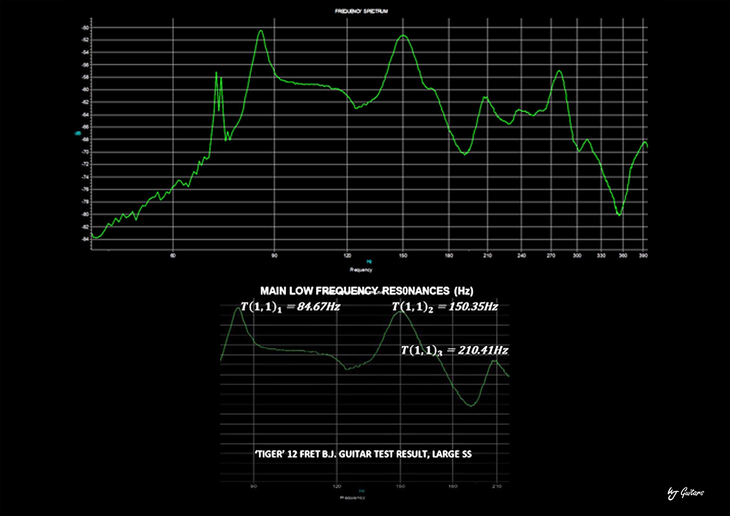

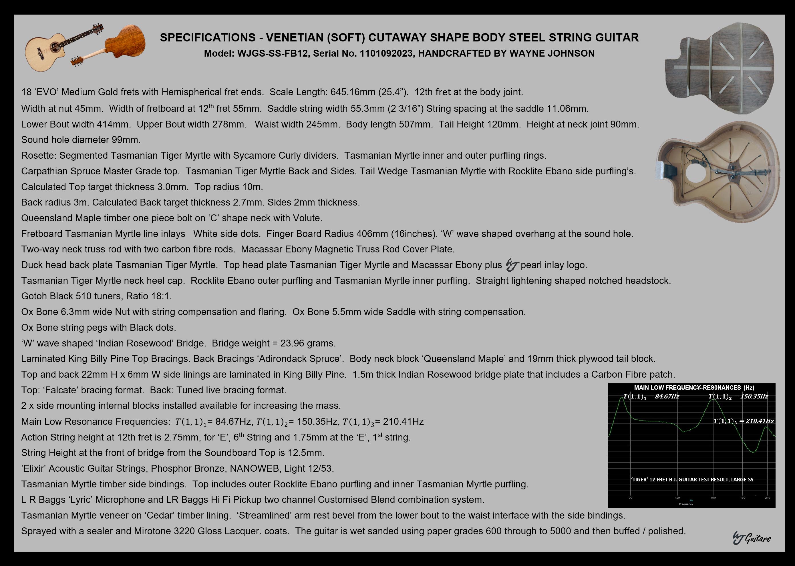

The ‘Main Low Frequency Resonances’ results tested for this guitar are:
For large Steel String guitars, the table for the ‘Main Low Frequency Resonances’ in the Gore / Gilet, ‘Design and Build’ book, Table22.1, page22-7 are: 90Hz, 160Hz, 202Hz, or, 90Hz, 170Hz, 214Hz respectively.
This guitar build is slightly larger than an ‘OM’ sized guitar and is a ‘GS’ size body that includes a streamline arm bevel that offsets the tops bass side symmetry. The tested results are not exactly on the target values as per table 22.1. I have checked using the ‘Table of Musical Note and Their Frequency and Wavelength’ and from the frequency testing results no clashing notes are evident. The guitar sound is very good for playing and I have not noticed any woof notes or, honking overtone frequency problems.
I have included gallery photos and specifications of the guitar, see photos.

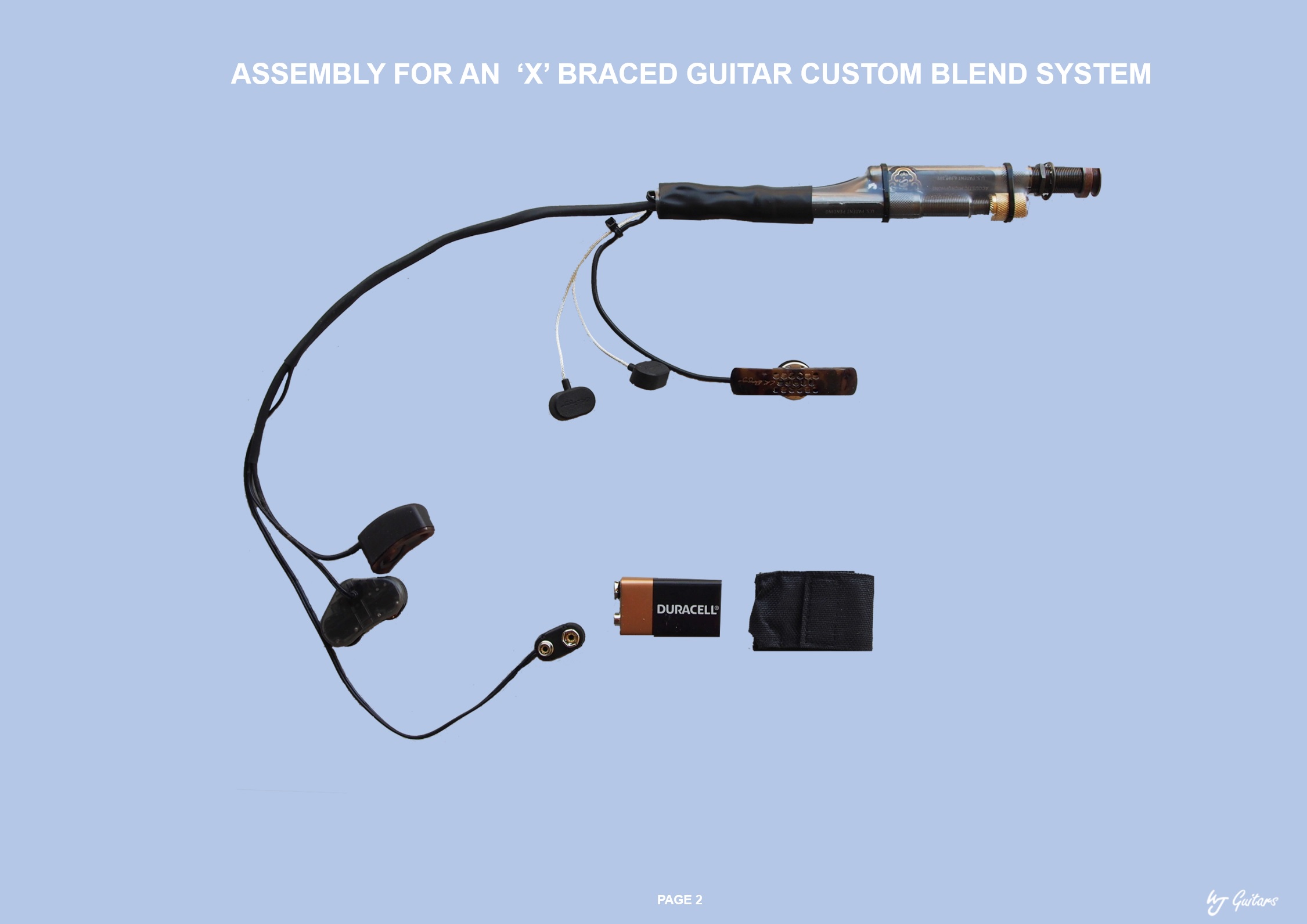

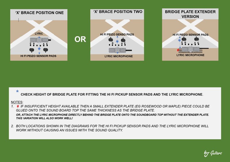

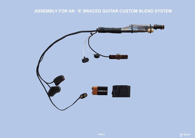

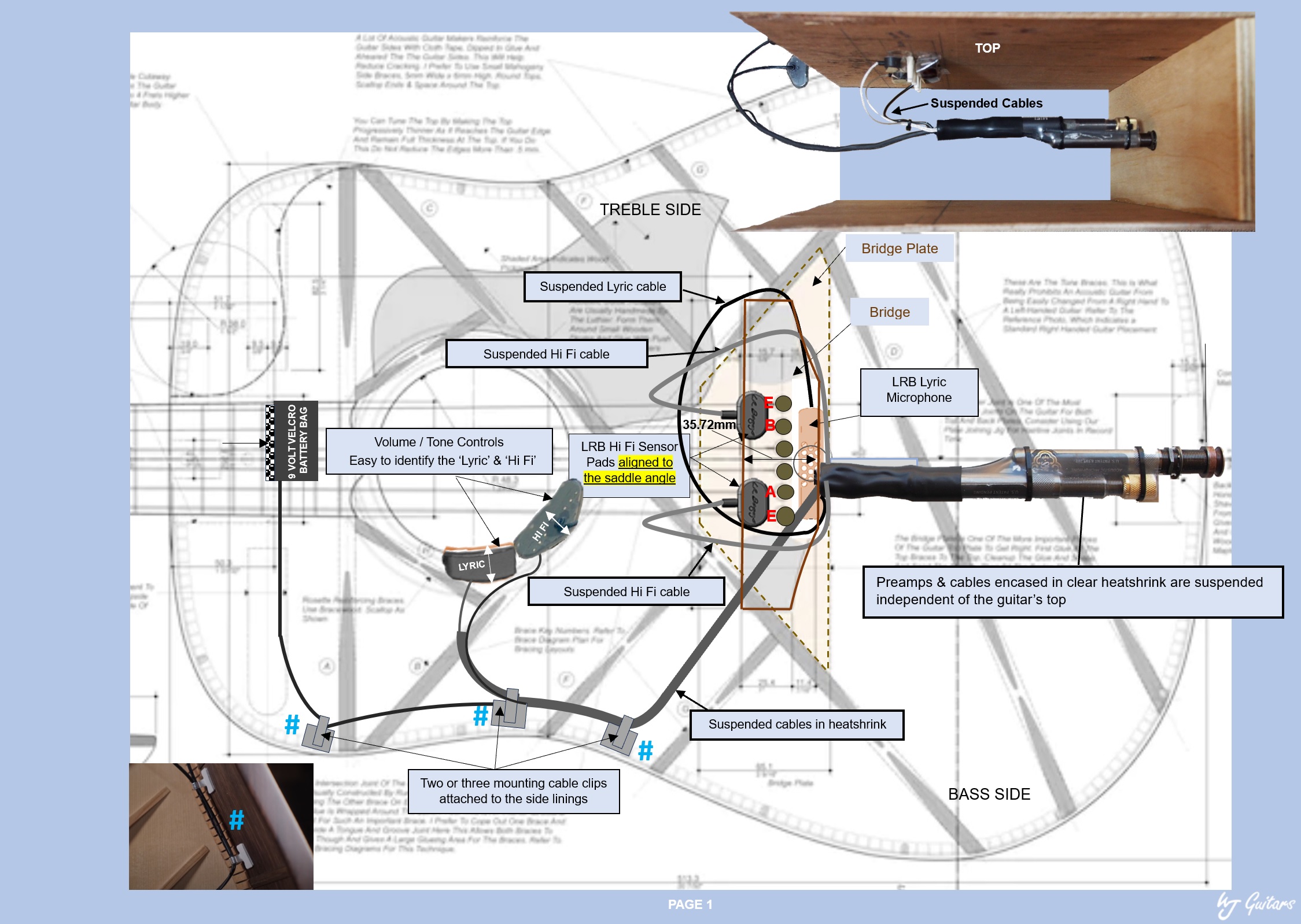

I have prepared more information for installation of these pickups for 'X' braced guitars. See below.
Yes Martin, I probably have reached the top of my video preparation abilities, although there is always room for improvement. Doing all the tasks by yourself takes a long time being the guitar player, setup and recording the camera shots, plus do the audio recording and photo work. I hope that this information maybe helpful to others and provide more type of options for installation of acoustic guitar pickup systems for their clients.

There has been some interest in my Custom Blend System. I now have an order from a musician in the USA with a similar playing style to Tommy Emmanuel.
I will be assembling the Custom Blend System and shipping it to my client who has arranged for installation by a luthier in his new Martin D-18, 1939 Authentic, with through saddle.

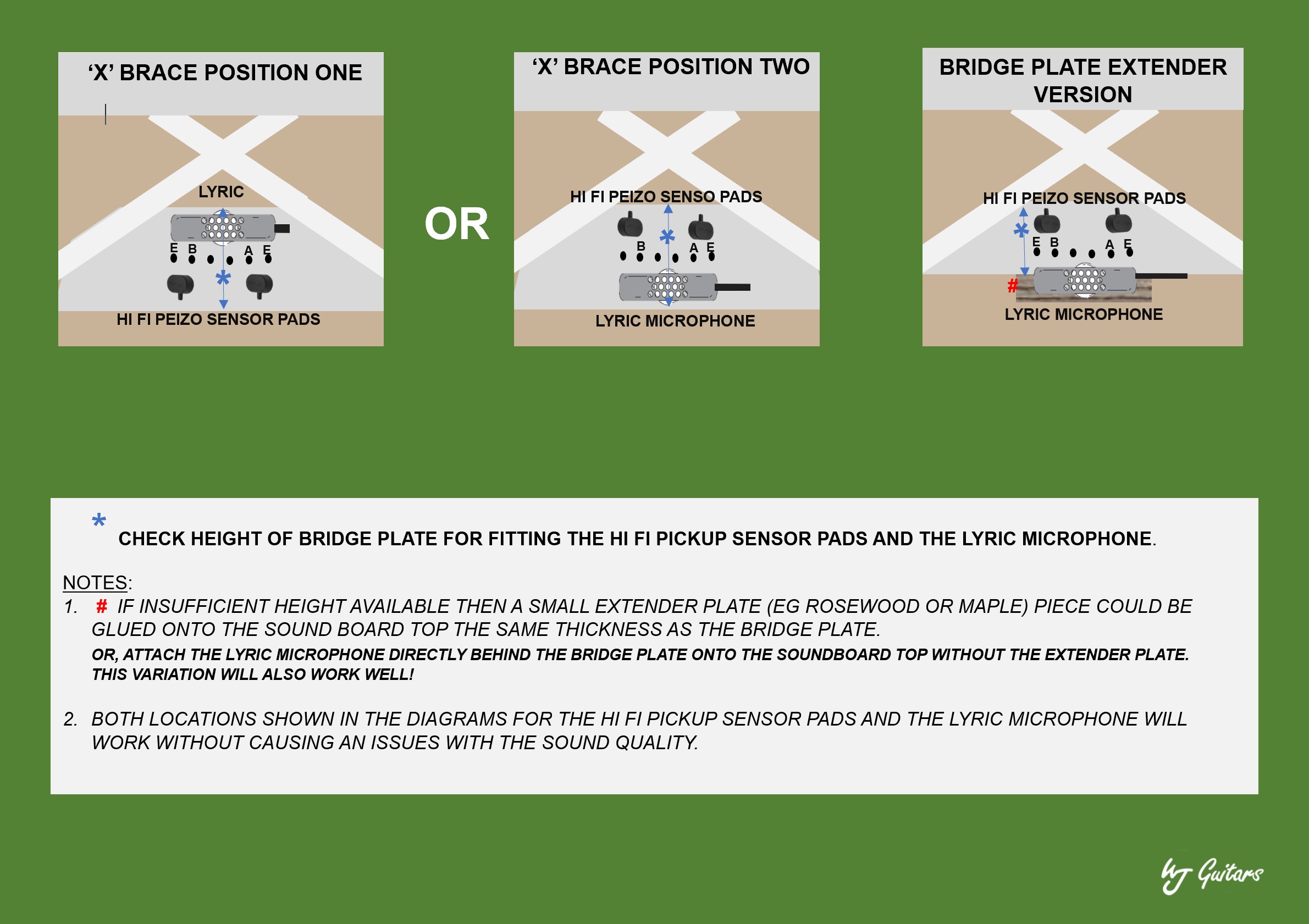

Here are some more details regarding an installation of the 'Custom Blend System' in an 'X' braced guitar. See photos.

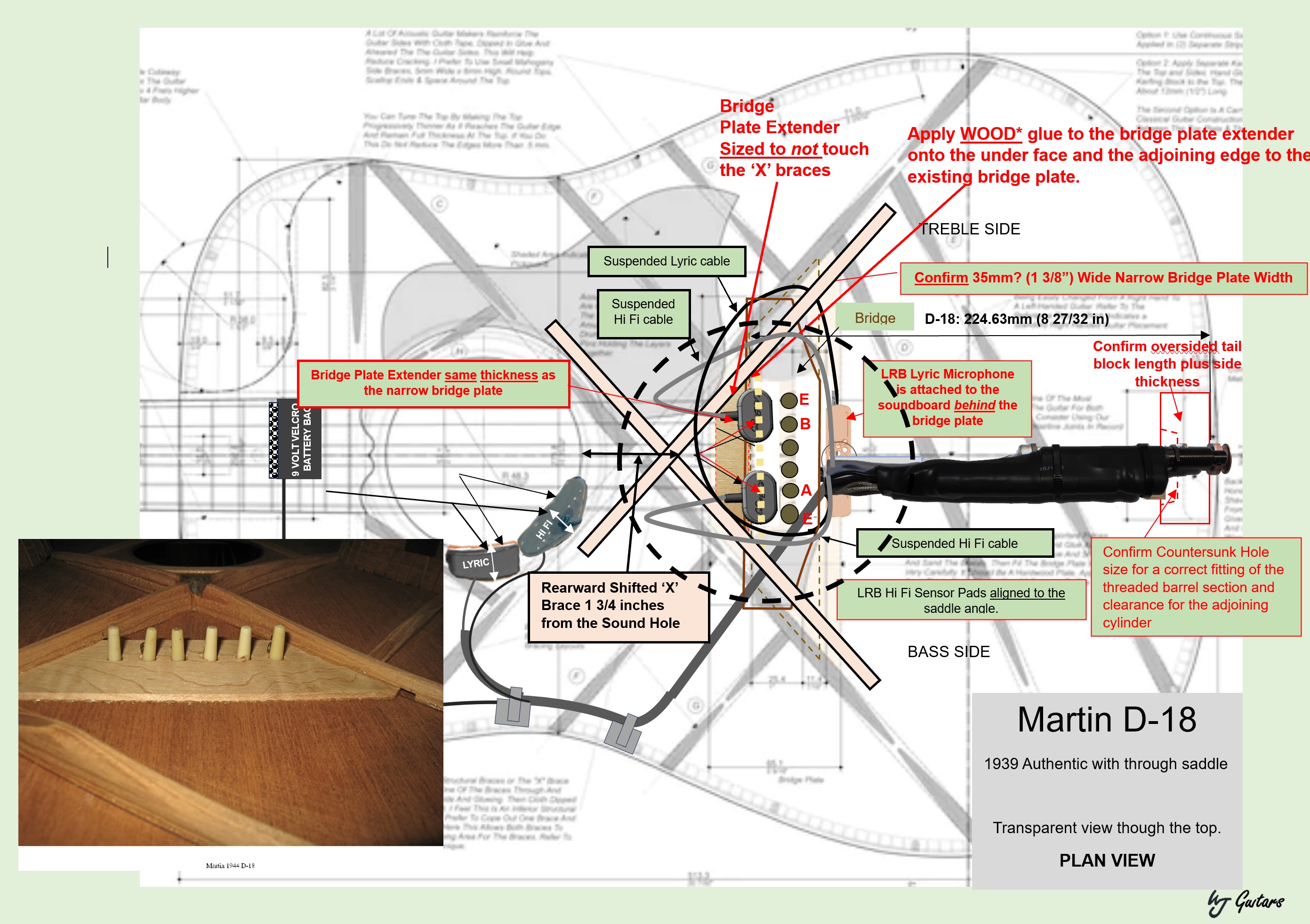

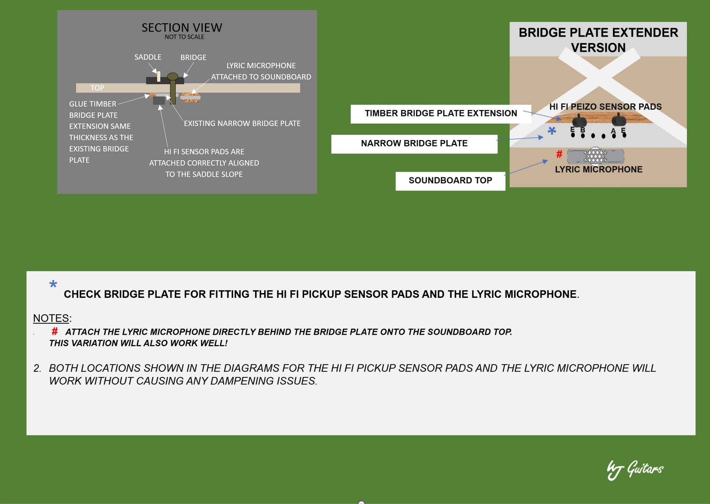

Here is more information to consider when installing the 'LR Baggs Hi Fi and Lyric Microphone Custom Blend System' in a Martin D-18, 1939 Authentic with a through Saddle.
The Martin D-18 Authentic has a Narrow Bridge Plate, Rearward 'X' Brace and an oversized Tail Block. For a correct installation of the 'Custom Blend System' in this guitar requires:
1. Making a bridge plate extender to fit the LR Baggs Hi Fi Sensor Pads correctly aligned to the saddle. The Sensor pads output level will drop off and sound thin if they overhang the edge of the bridge plate. See attachment.
2. Attaching the LR Baggs Lyric Microphone to the soundboard top slightly offset from the back edge of the Narrow Bridge plate. It is not recommended to fit the Lyric Microphone overhanging the edge of a narrow bridge plate. See attachment.

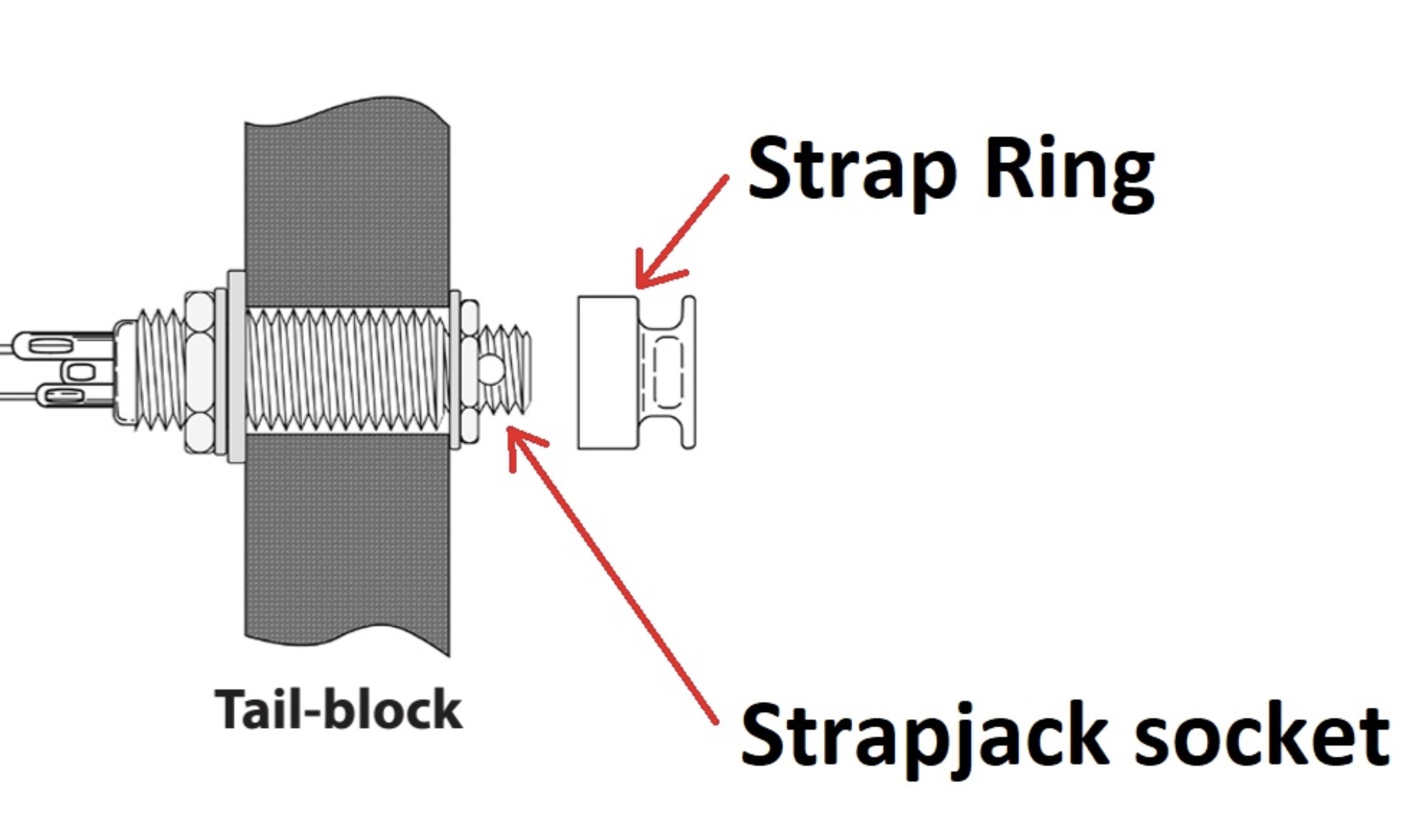

3. Countersink boring the Tail Block inside the guitar box to suit the length of the hole required to fit the threaded section of the 'Output Socket' connector to protrude the right amount through the tail of the guitar to fit the Strapjack Socket and Strap Ring to overcome the depth problem of an oversized tail Block. See attachments.
I hope that this information maybe helpful to know about when installing the 'Custom Blend System' in an acoustic guitar that has a narrow bridge plate depth and oversized tail block.

Thanks Wayne for some excellent detailed guides
