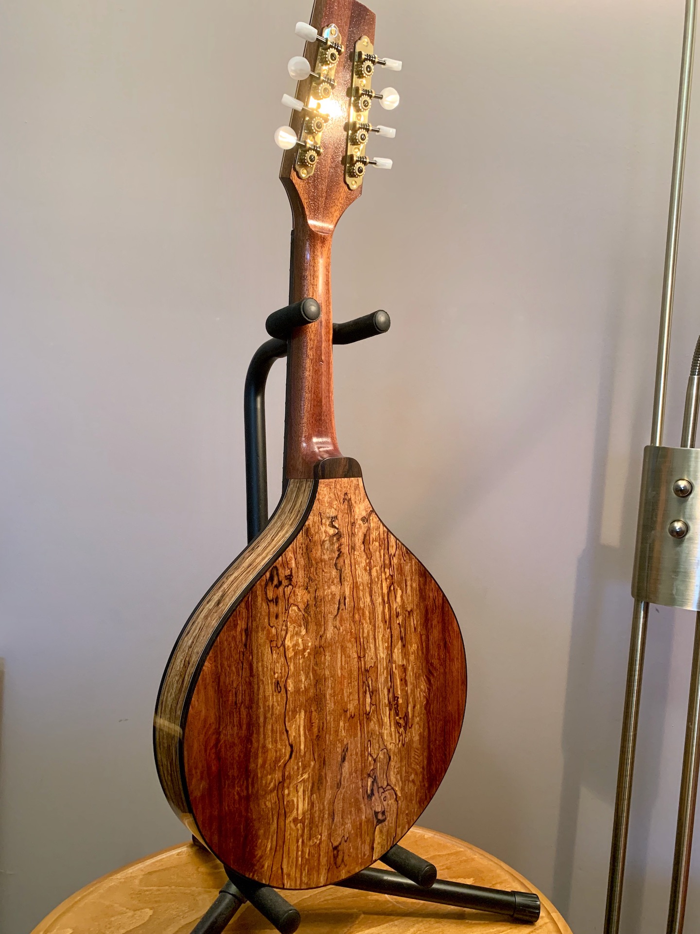

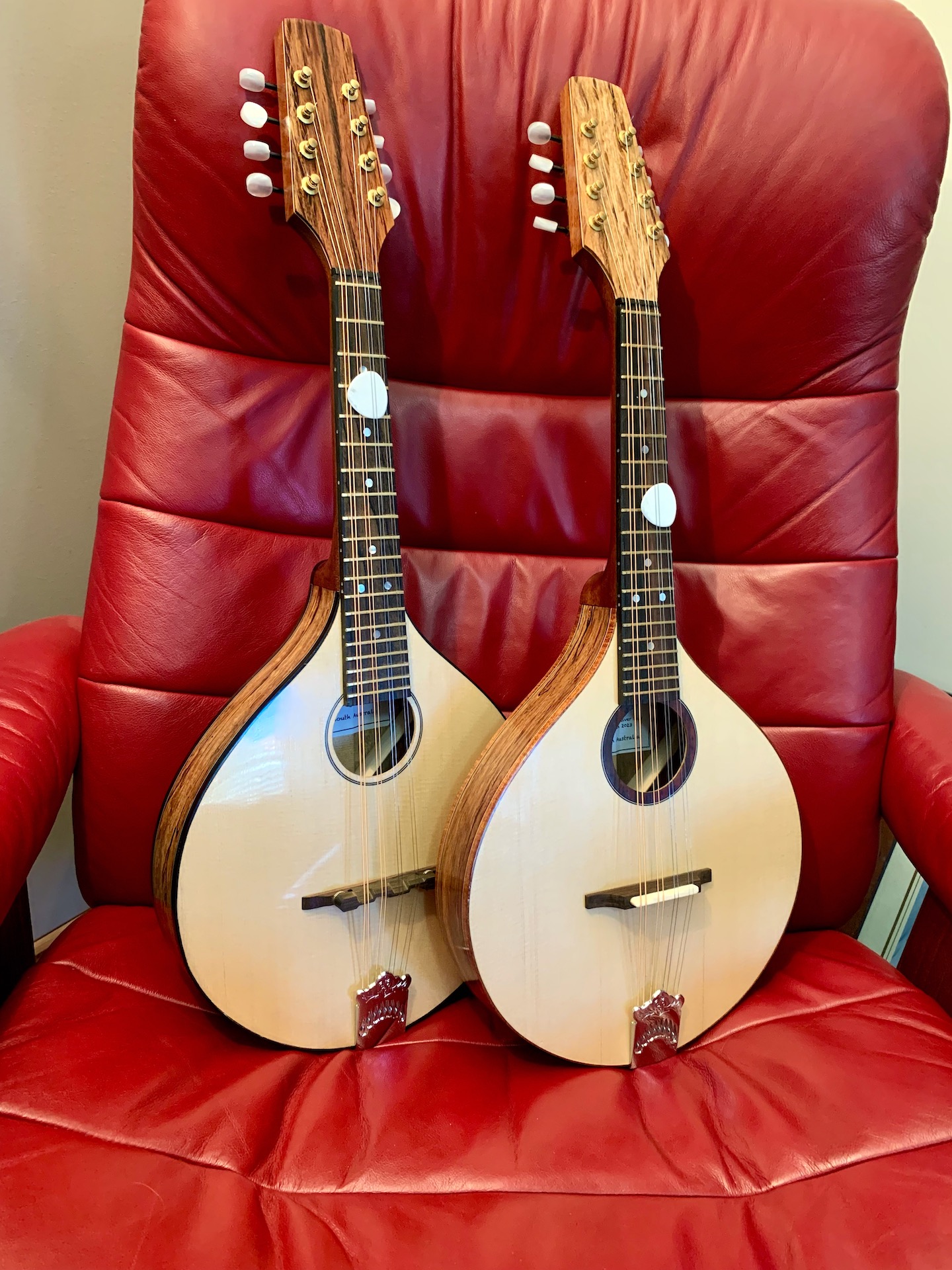

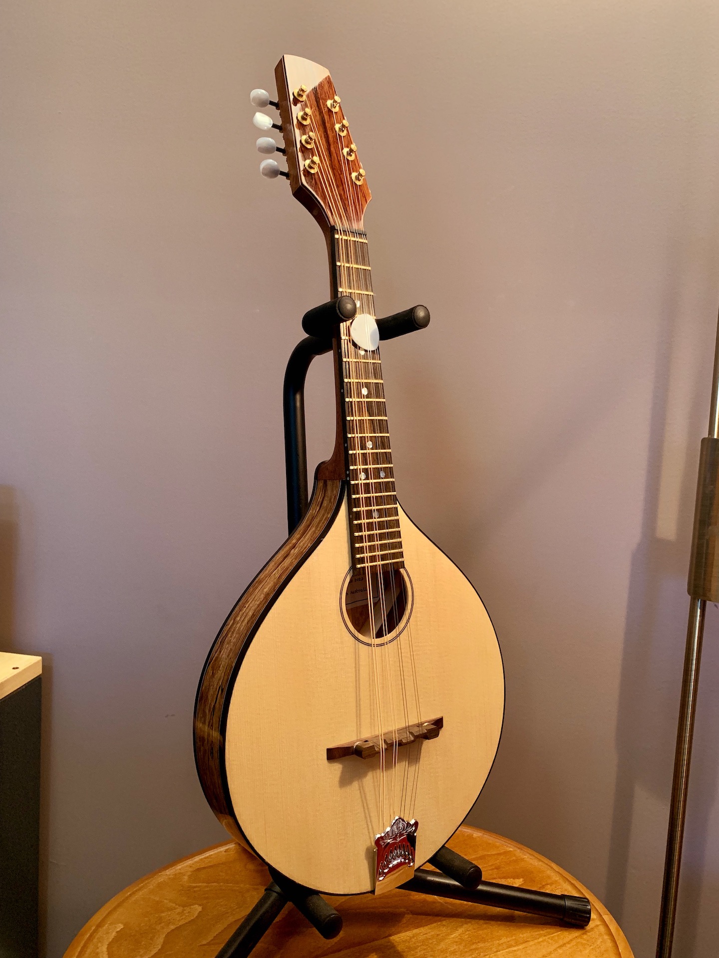

Just completed the second of two mandolins in Englemann Spruce and River Oak. This one has a ziricote finger board and ebony binding and is finished with hardened shellac.
It's twin has an ebony fingerboard and blackwood binding and is finished in Osmo PolyX.
Bob Holbert

Bob, these mandolins look great and are built excellently built! I like the hard shellac finish.

Thanks Wayne. The hard shellac finish has loads of potential - just need to up my execution. Pore filling on this one could have been better, but I like the fact that it is an achievable gloss finish applied by hand, and can be done over a few days. I put on several coats a day for about 3 - 4 days, and flatten with wet and dry once there is enough finish to work with, and then work through to 12000 with Micromesh and finally finish up with a bit of wax polish. It looks and feels nice, and doesn't need a spray booth or protective gear!
I need to find a local mandolin player who can critique the instruments for me to help me up my game - any volunteers?

Even tho the pic of the back is a still image, I can almost see the shimmer of that river oak and the the finish. Well done
Thanks Trent. I think this one is a keeper - it's possibly the best I've made technically and musically, and it looks lovely, Bit scared to play it though!

They both look lovely Bob. What are your thoughts about the two different bridge styles that you have used on them? One adjustable with thumb wheels. The other fixed height and looks lighter. I am quite a novice in mandolin style instruments and don't know the pros and cons of each type.
Bob_H
Posts: 166
Re: Mandolin in Engelmann Spruce and RIver Oak (redux)
Post by Bob_H » Tue Oct 03, 2023 10:11 am
Mark McLean wrote:
Tue Oct 03, 2023 5:35 am
Thanks Mark. I'm very much a beginner builder myself. Ultimately I would like to be able to build the bridges myself, and as my builds become more predictable that's what I intend to do. I think it is probably lighter and provides a more direct contact with the soundboard. While I will probably replace the thumb screw bridge in time, it is very adjustable, up and down, to help with setup and the like. With the other style, you can always take a bit more off, but it's more difficult to put it back on when you go too far!
