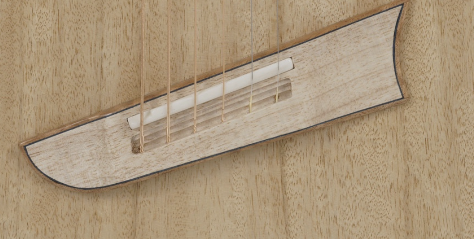

This one is a Breedlove and is pretty simple. You would want to draw it out at large scale and work out the angles. Do something like a countersink for the ball ends to slip out of sight.
It is actually more beefy than it needs to be. You can route out a channel across the middle to reduce the weight, and it also looks more elegant IMO.

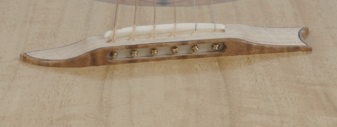

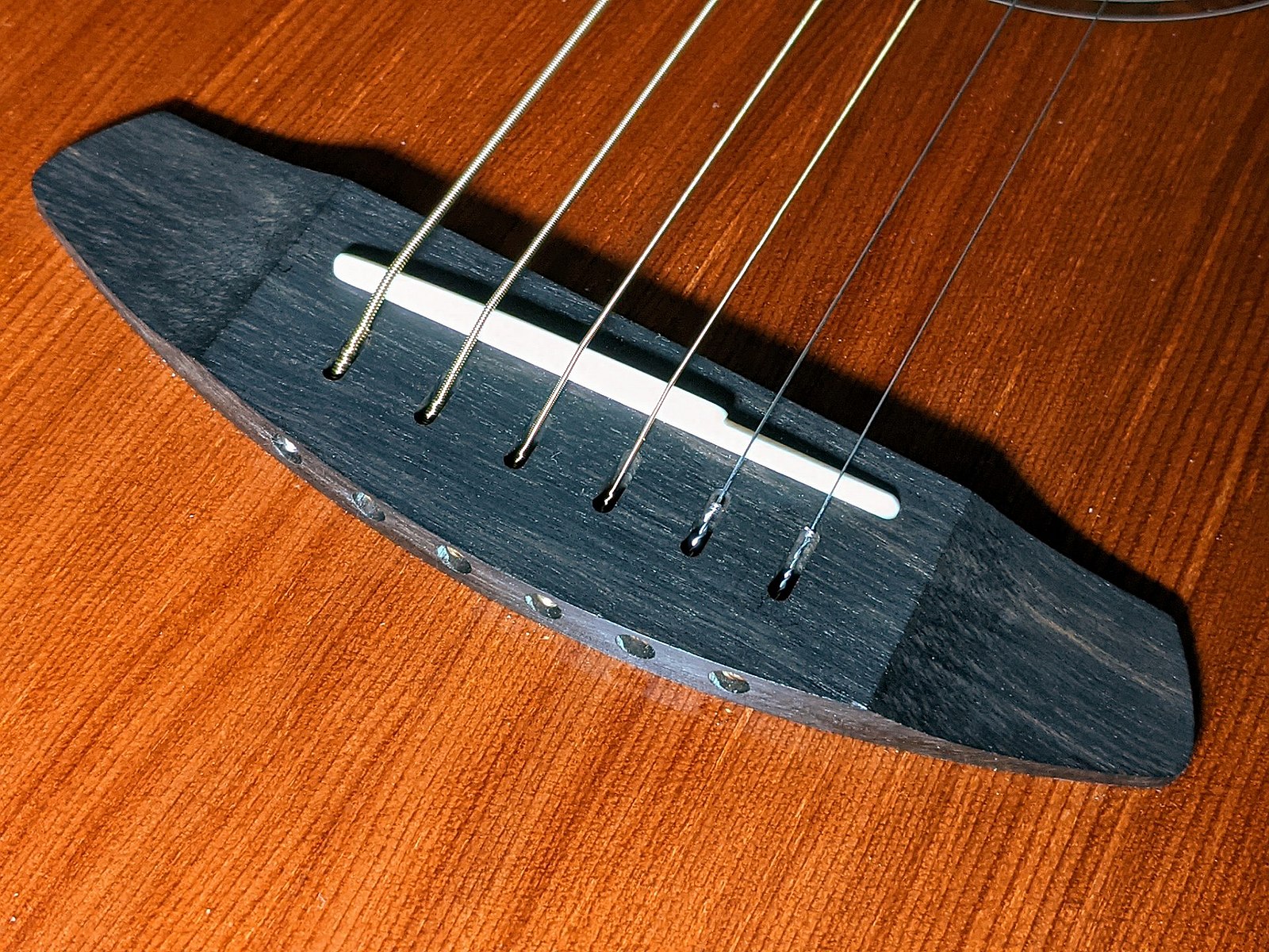

I put a pinless bridges on a number of falcate builds including this multi scale.
I didn't have any trouble keeping it under 20g and I even included an extra inlayed wear bone for the ball ends. 17g from memory but then again the "white" blackwood was particularly light. Also remember you should also deduct the pins' weight too if you want to compare apples.

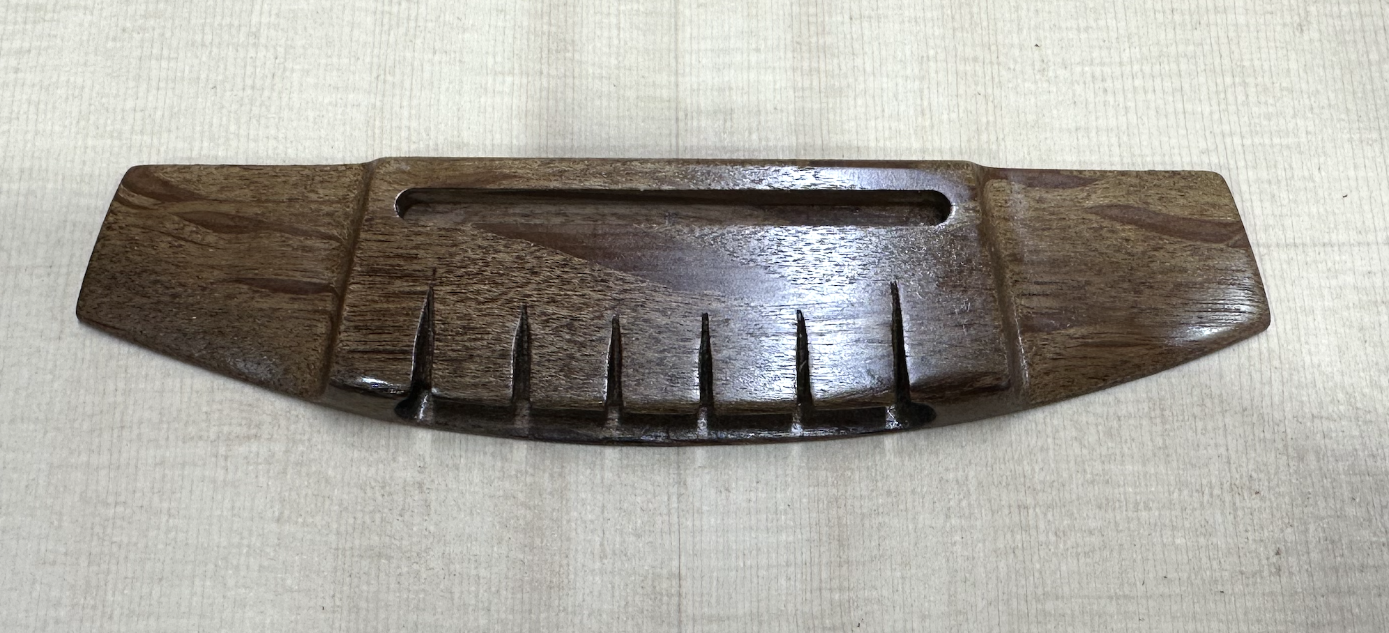

Another design we've been using a bit is a slotted version for even easier string changes. There is also a unseen wear bone inlaid in this one too.
