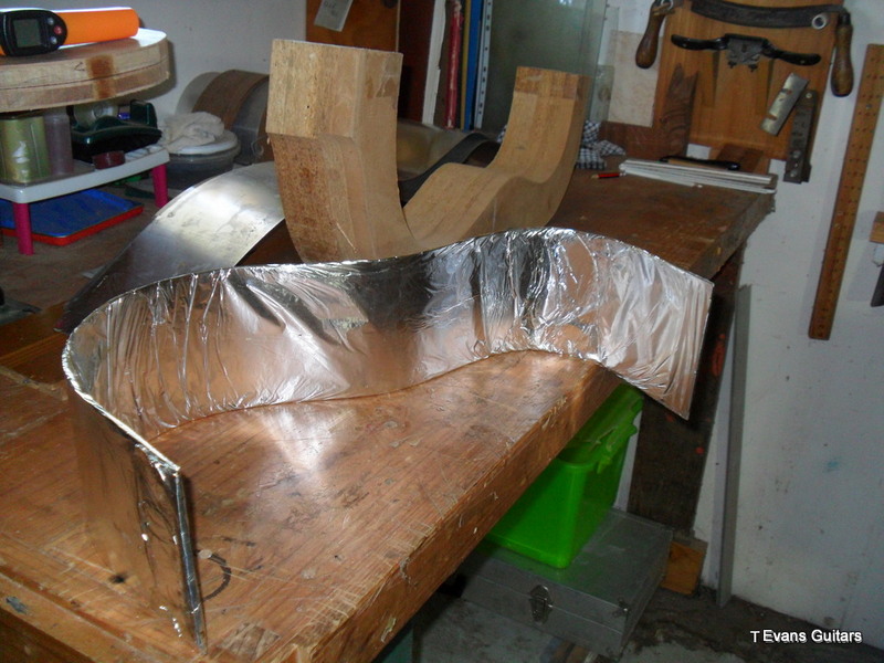

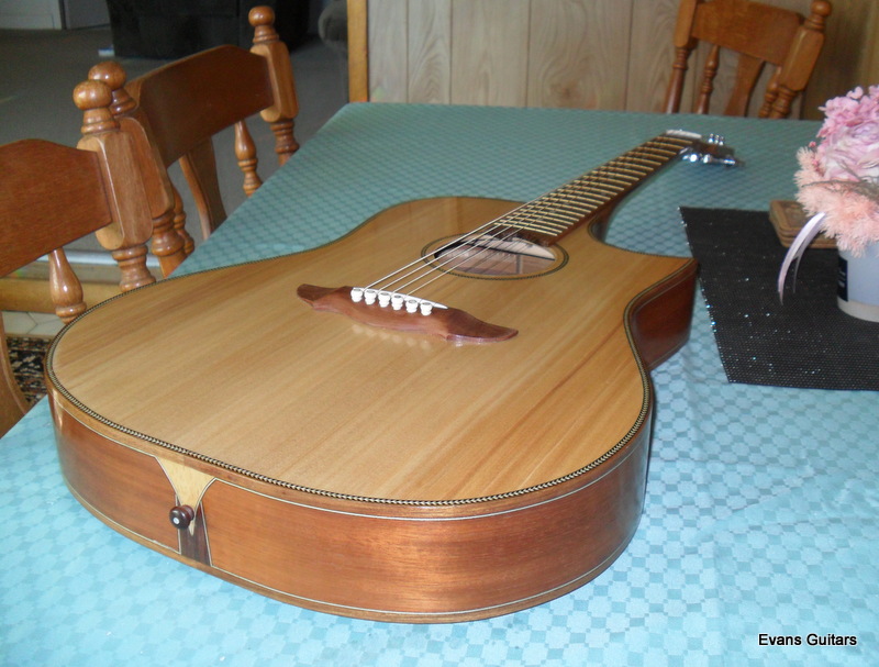

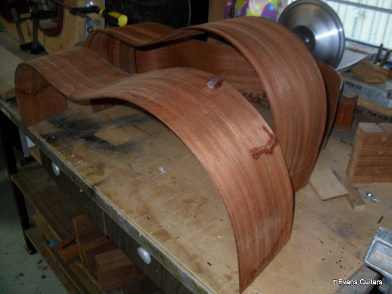

Hi again, I just came across these pics.
After the first failure, see the front side, I did what is seen in the next pic. To get the perfect bend out of the second set I wrapped the whole sandwich in foil as well. This pic shows the sides just taken out of the mould. I did not waste the damaged side I made a thin-body acoustic. But that's another story...
