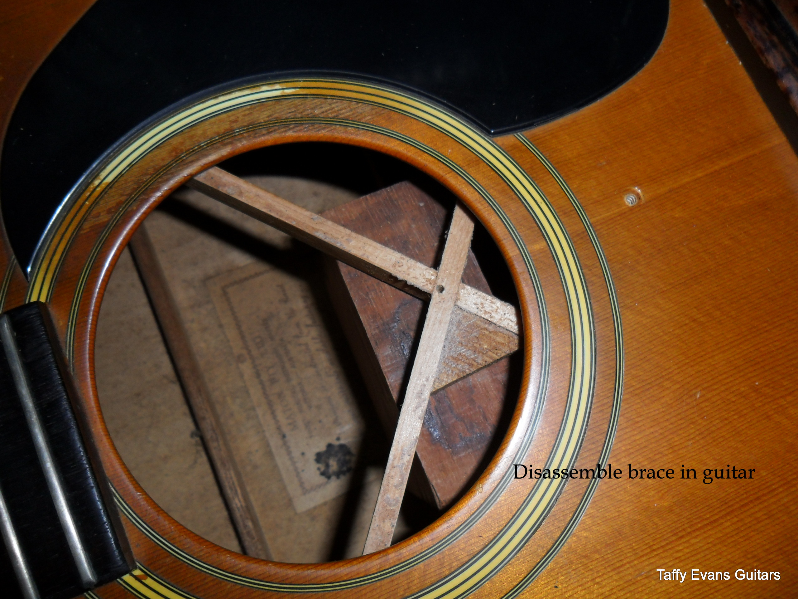

Hi Andy 54, I have come across that glue when it is hot and sticky but I can't tell you the type of glue used. I have a 2008 Maton on the bench at the moment that I had removed the fingerboard from, but I did not experience that issue.
A lot of the Matons I get are experiencing glue failure, especially older models. More recent ones have bridge failures and in the older guitars the white looking glue seems to turn to powder, and of course, let go. One old Maton came in with the complete X brace assembly detached from the top and lying in the bottom of the guitar.
