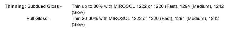

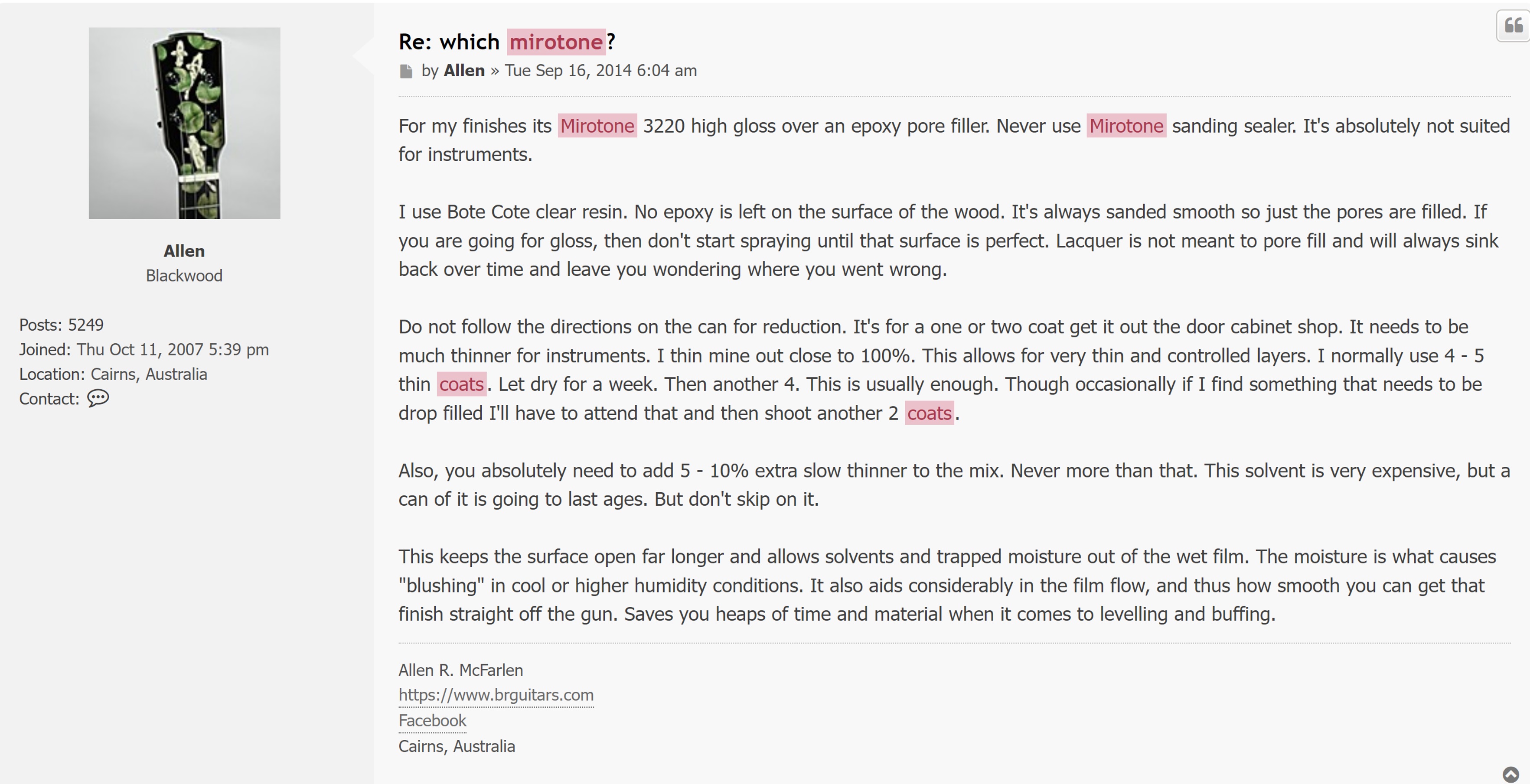

I was reading a post by Allen 16th Sept 2014 regarding using Mirotone 3220 (see below) and would appreciate if Allen could confirm how much to thin Mirotone 3220 for Full Gloss spraying an instrument.
The post first indicates to thin each coat to around 100%. What thinners do you use to achieve around 100%? Is it Full Gloss MIROSOL 1222 or 1220 (Fast), 1294 (Medium), or 1242 (Slow). I am in Sydney and would expect that 1242 (Slow) would not be necessary.
The post then mentions to add 5 - 10% extra slow thinners to the mix. Is this additional thinners different to the thinners required to achieve the 100% thinning?
I would appreciate if Allen can confirm.

I've been mixing my miritone as per Allen's post for about 10 years now. I started off using miritone thinners but one time my supplier never had any and they told me general purpose thinners would be ok, so that's what I've been using for about 8 years, I just get it from autobahn, it's way cheaper too.
I thin mine to 100%, equal parts thinner to lacquer, I also use slow thinners in it.

Thanks Wayne for confirming about the thinners percentage. Generally, after completing all the coats how long do you wait for it to curer before the final buff and polish?56nortondomy wrote: ↑Thu Apr 04, 2024 4:33 pmI've been mixing my miritone as per Allen's post for about 10 years now. I started off using miritone thinners but one time my supplier never had any and they told me general purpose thinners would be ok, so that's what I've been using for about 8 years, I just get it from autobahn, it's way cheaper too.
Maybe Allen will chip in with more info.
I final completed the grain filling with Bote Cote epoxy. The guitar build for my client has Carpathian Spruce soundboard top and Panama Rosewood. This rosewood needed three applications of epoxy to fill the grain.
I thinned equal parts of the Mirotone 3220 with a 100% thinners plus a mixed of 10% slow thinners. The first spray coat applied was great! This lacquer / thinner mix works real well. I will apply 4 coats, level sand between coats and then wait a week for it to settle. I will then proceed to apply another 4 coats and level sand between coats and then wait for it to cure (say around 14 days?) to be ready for buffing and polishing.

14 days should be fine Wayne. I spray 15 coats in total, 5 coats per session, I used to spray 10 but I decided to up it
I think with the extra coats there’s less chance of sanding through when it’s levelled, just my take on it. Wayne

When I contacted 'Mirotone' earlier this year regarding their thinners:
I was advised that using either 1222 or 1220 are very similar and that both achieve the same result as a fast thinner.
At this stage there is no indication on 'Mirotone's' Website (https://mirotone.com/) that they are in receivership. I guess we will see what developments and actions occur in the future.
