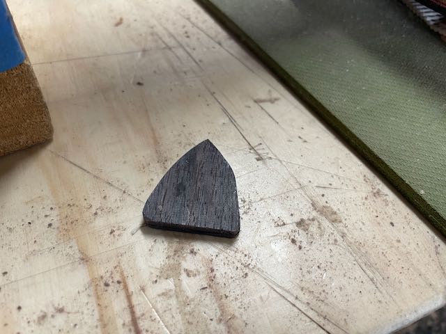

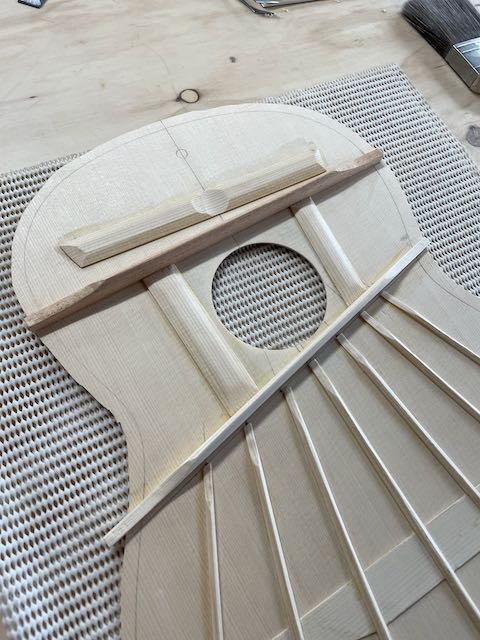

bridge patch
240722 bridge patch.jpeg (334.7 KiB) Viewed 35331 times

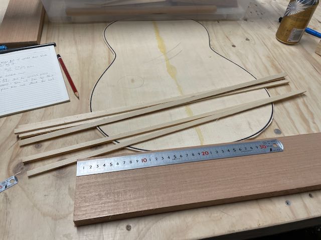

getting some braces ready
240722 braces.jpeg (291.04 KiB) Viewed 35331 times

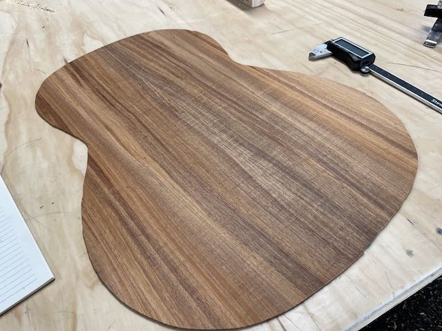

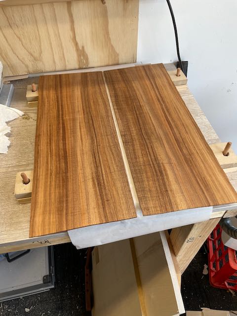

Day 2

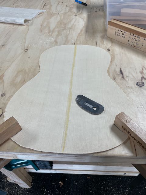

cleaning up the jointed top
240723 jointed top.jpeg (270.68 KiB) Viewed 35331 times

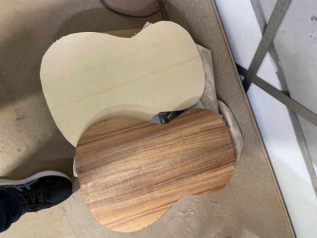

top and back about to be thickness sanded
240723 top and back.jpeg (326.1 KiB) Viewed 35331 times

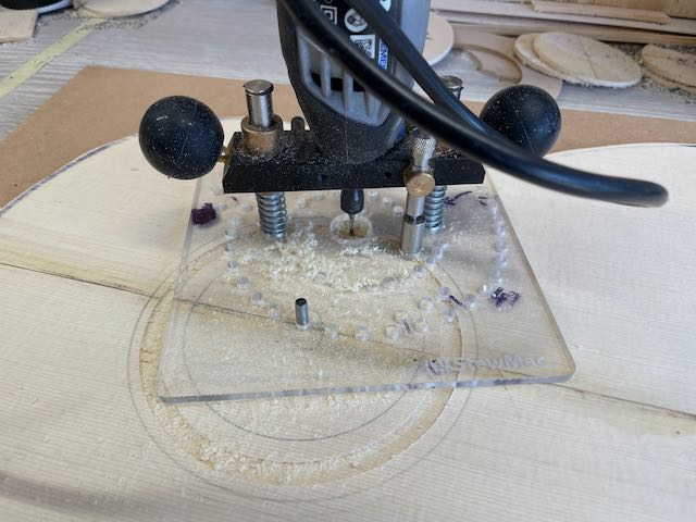

prepping for the rosette channel
240723 rosette prep.jpeg (286.53 KiB) Viewed 35331 times
cutting the rosette
240723 rosette cutting.jpeg (305.64 KiB) Viewed 35331 times

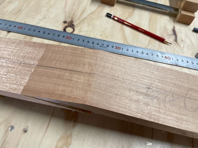

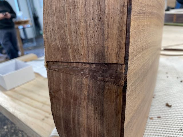

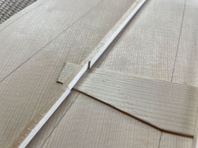

scarf joint
240723 scarf joint.jpeg (353.81 KiB) Viewed 35331 times

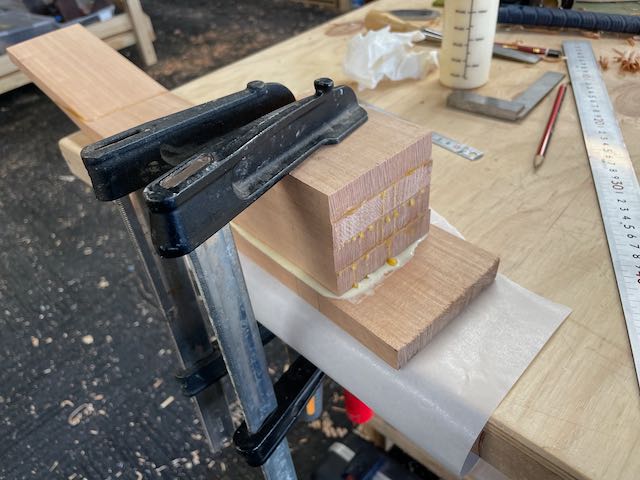

heel block (maybe a little too much glue!)
240723 heel block.jpeg (341 KiB) Viewed 35331 times

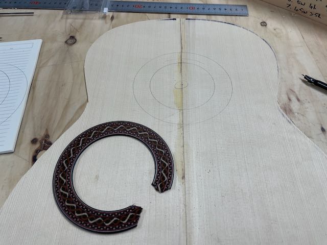

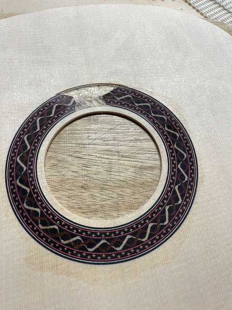

rosette in
240723 rosette in.jpeg (482.73 KiB) Viewed 35331 times

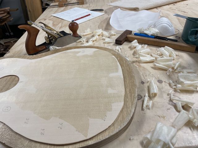

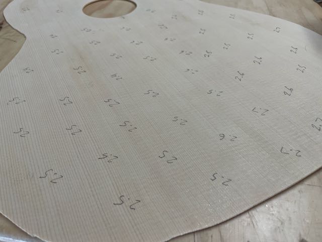

thicknessing the top
240723 thickness top.jpeg (331.21 KiB) Viewed 35331 times

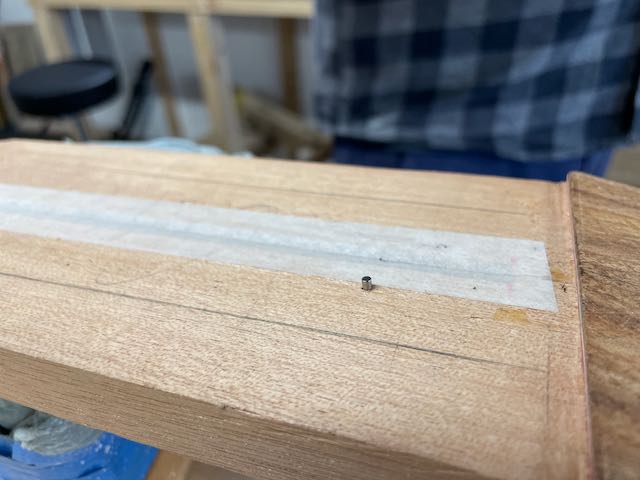

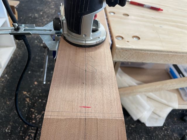

Routing the truss rod channel:
240724 truss routing.jpeg (298.69 KiB) Viewed 35146 times

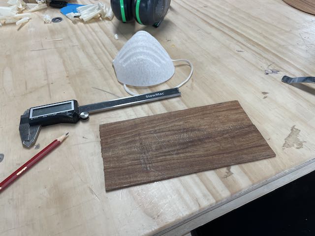

Prepping the headstock veneer (definitely wanting to keep using the beautiful timber):
240724 headstock veneer.jpeg (336.88 KiB) Viewed 35146 times

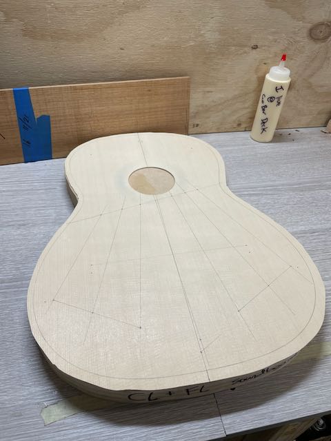

Marking out the top bracing:
240724 marking bracing.jpeg (269.33 KiB) Viewed 35146 times

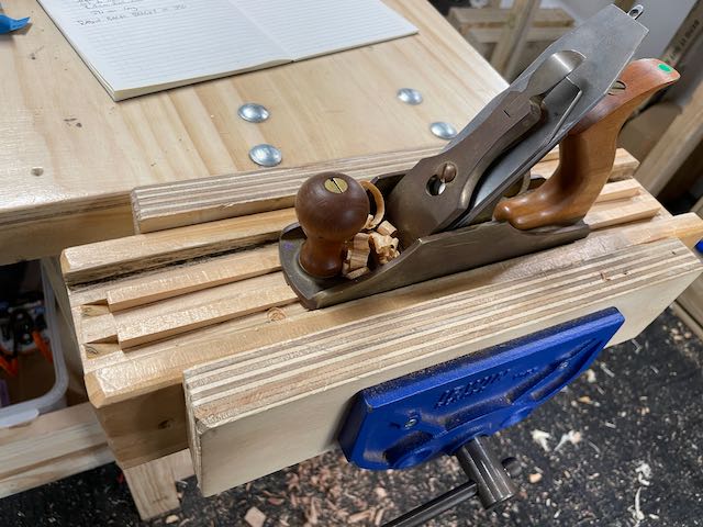

Rough shaping some of the braces to size. This is one good example of the kind of upskilling that comes from an intensive course like this. Before now, I had a limited way of thinking about this step. Now I'm thinking about when to use different planes (block vs bigger, for example), moving between two shooting boards with different heights, and when to use a plane clamped upside down in a vice).
240724 brace shaping.jpeg (369.14 KiB) Viewed 35146 times

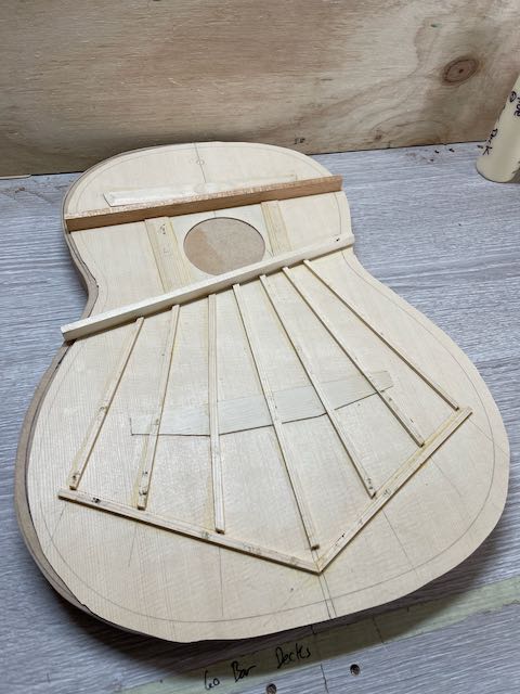

And the final pic for Day 3 ... All go-barred. This is where I wrapped up the day, with the top glued up in the go-bar deck:
240724 all go-barred.jpeg (430.08 KiB) Viewed 35146 times

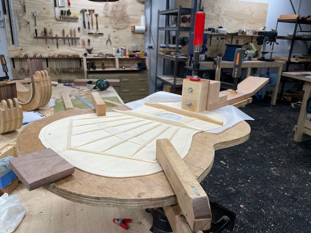

I arrived on the morning on Day 4 to find nicely glued up top braces:
240725 top braces on.jpeg (53.16 KiB) Viewed 35145 times

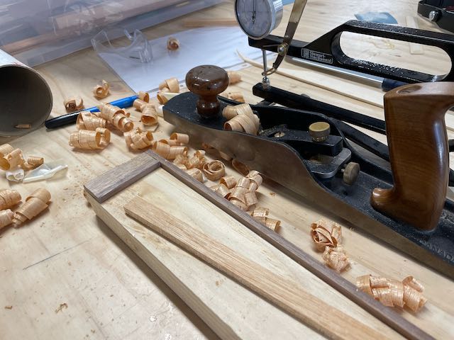

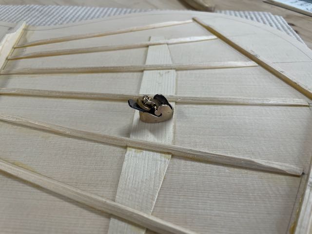

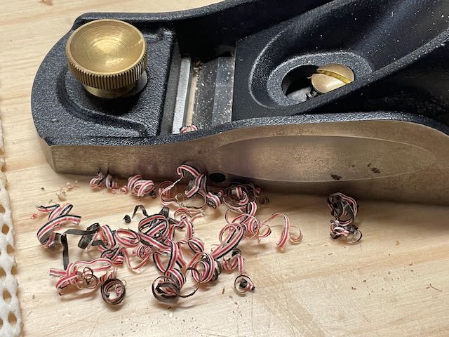

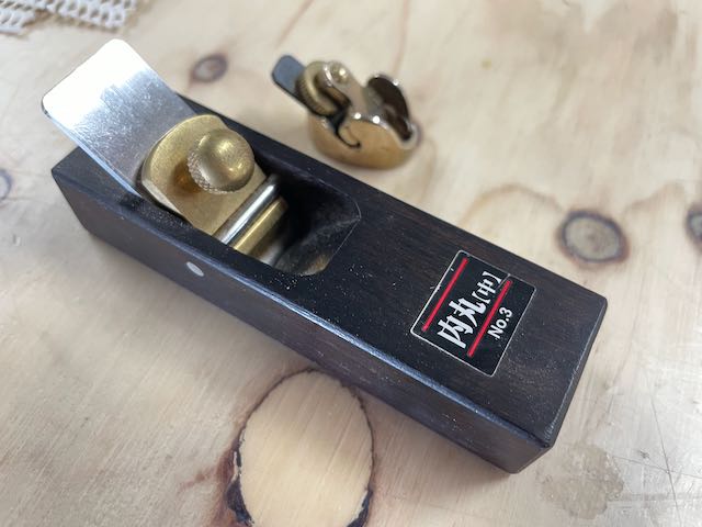

I enjoyed using these two little planes for brace shaping:
240725 tiny planes.jpeg (346.27 KiB) Viewed 35145 times

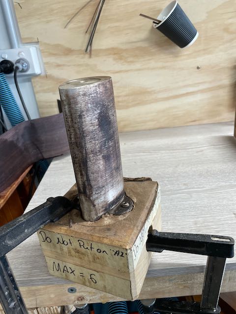

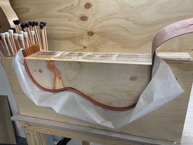

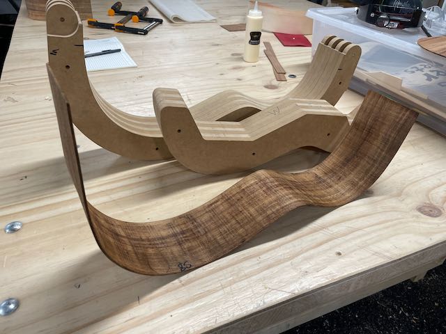

On to side bending. We started with the iron to get the rough shape, and then moved to the blanket to get the sides finalised:
240725 bending iron.jpeg (326.37 KiB) Viewed 35145 times
240725 bent side.jpeg (435.93 KiB) Viewed 35145 times
240725 blanket.jpeg (387.11 KiB) Viewed 35145 times

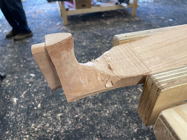

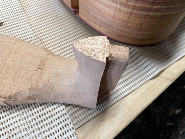

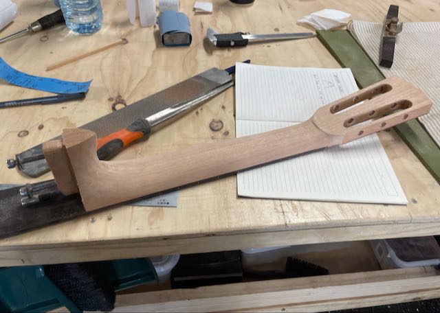

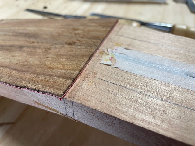

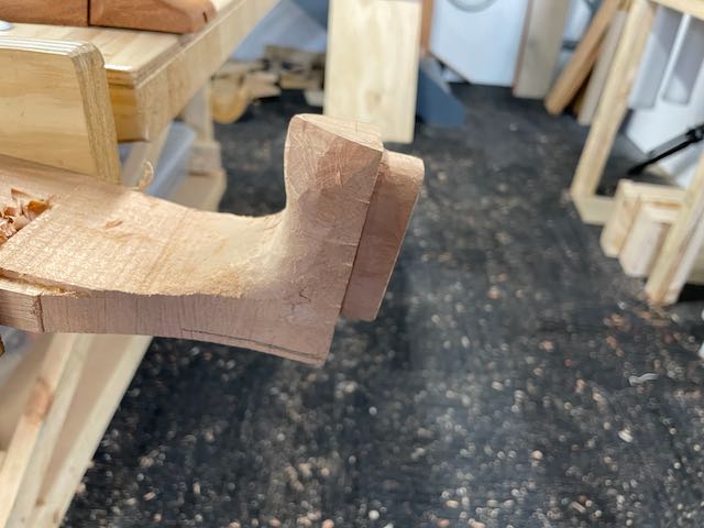

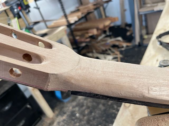

Beginning of shaping the neck tenon:
240725 neck tenon.jpeg (297.56 KiB) Viewed 35145 times

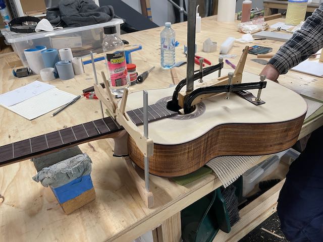

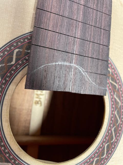

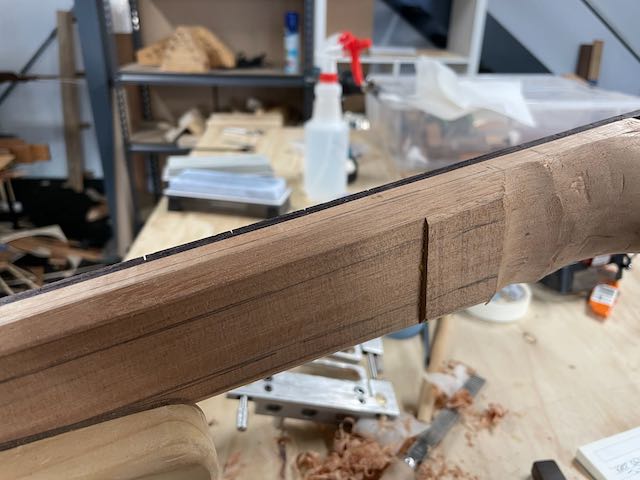

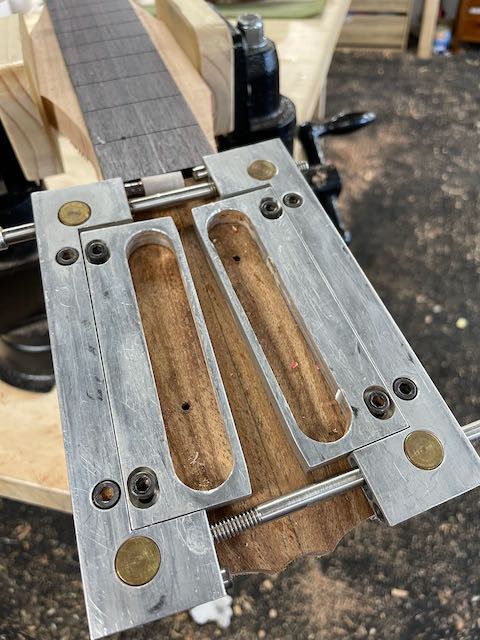

Getting a start on the neck fit with hardware, etc.:
240725 fitting neck.jpeg (283.73 KiB) Viewed 35145 times

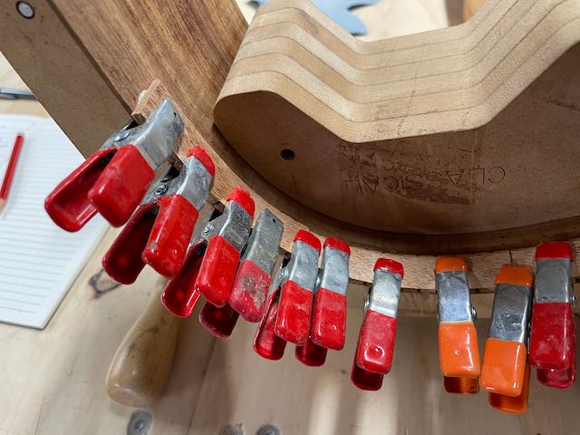

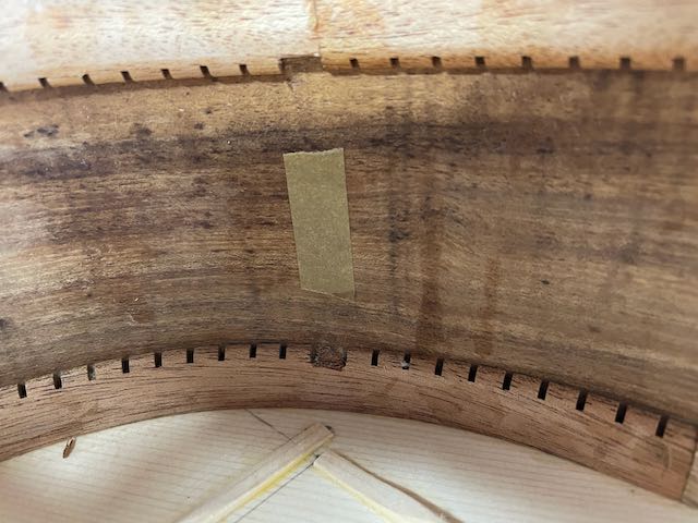

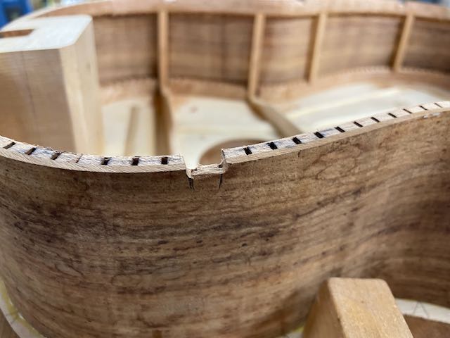

Glueing in the kerfing:
240726 kerfing.jpeg (353.17 KiB) Viewed 35119 times

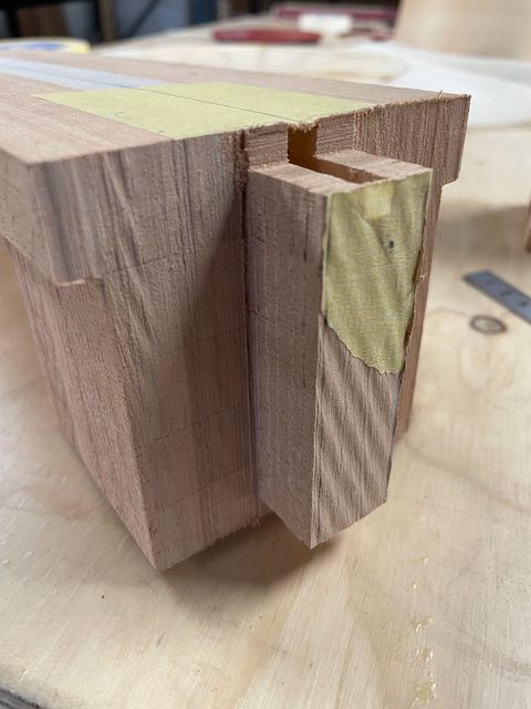

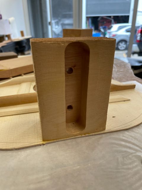

Neck block mortise:
240726 mortise.jpeg (269.95 KiB) Viewed 35119 times

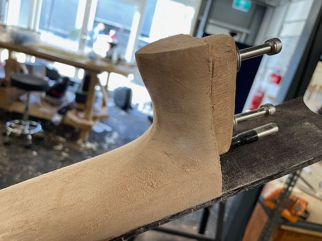

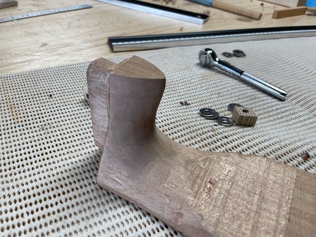

Start of heel shaping:
240726 heel shape start.jpeg (303.12 KiB) Viewed 35119 times

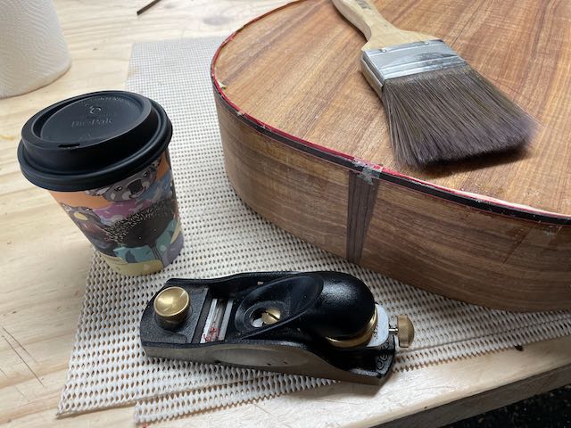

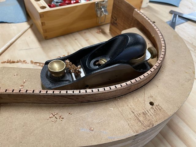

Planing the kerning flush:
240726 trim kerf.jpeg (379.35 KiB) Viewed 35119 times

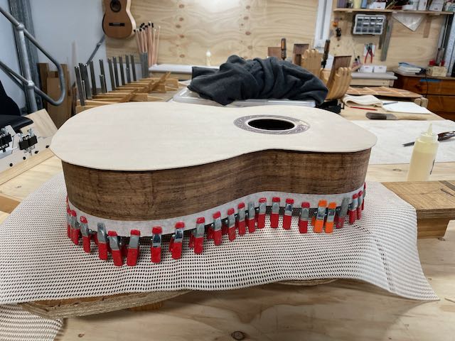

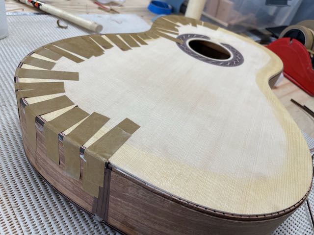

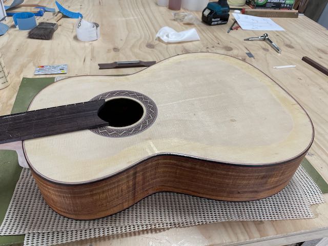

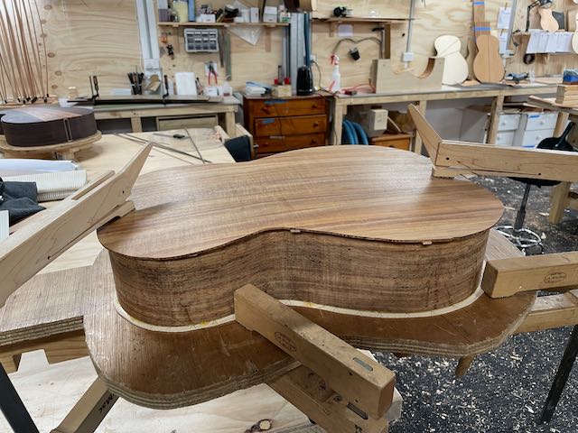

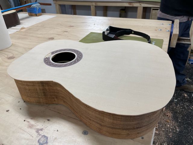

Gluing the sides to the top:
240726 gluing sides.jpeg (375.31 KiB) Viewed 35119 times

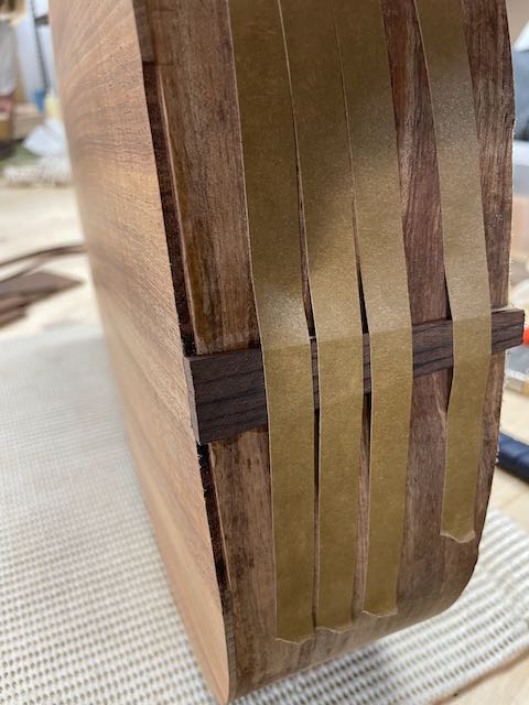

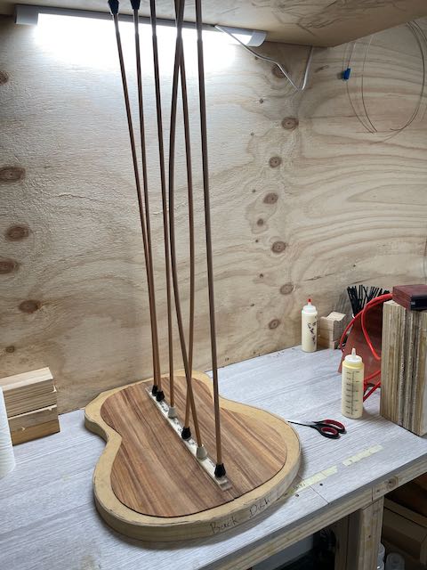

Gluing in the marriage strip at the go-bar deck:
240726 marriage strip go-bar.jpeg (442.87 KiB) Viewed 35119 times

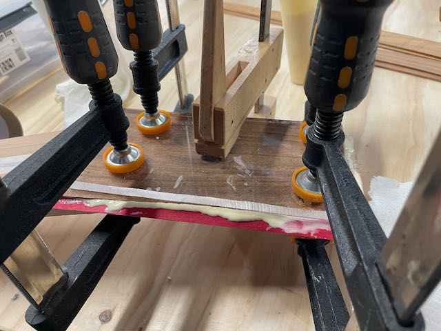

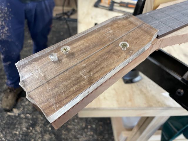

And the last bit for the day, gluing the headstock veneer:
240726 glue headstock veneer.jpeg (379.13 KiB) Viewed 35119 times

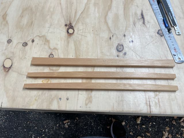

Shaping the back braces with a jig for proper radius:
240729 back braces.jpeg (372.81 KiB) Viewed 34823 times
Back braces nicely shaped:
240729 back braces shaped.jpeg (328.25 KiB) Viewed 34823 times

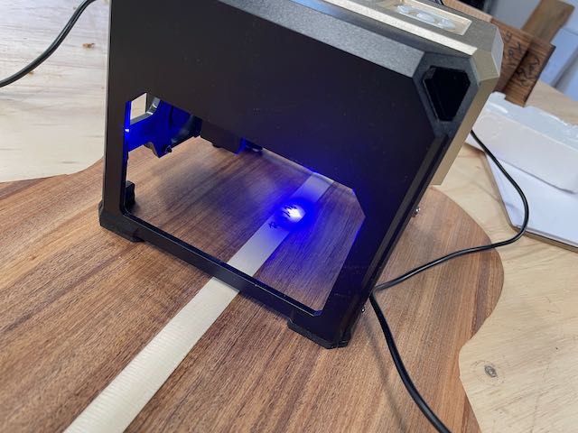

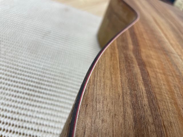

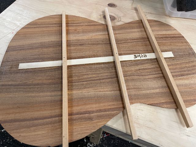

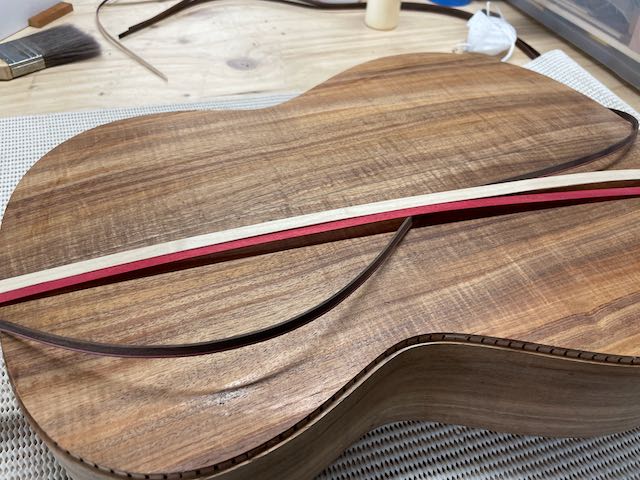

Laser engraving marriage strip:
240729 laser.jpeg (419.47 KiB) Viewed 34823 times
I settled on my initials and the year, but went with a handwritten font pencilled by my daughter:
240729 BM2024.jpeg (71.11 KiB) Viewed 34823 times

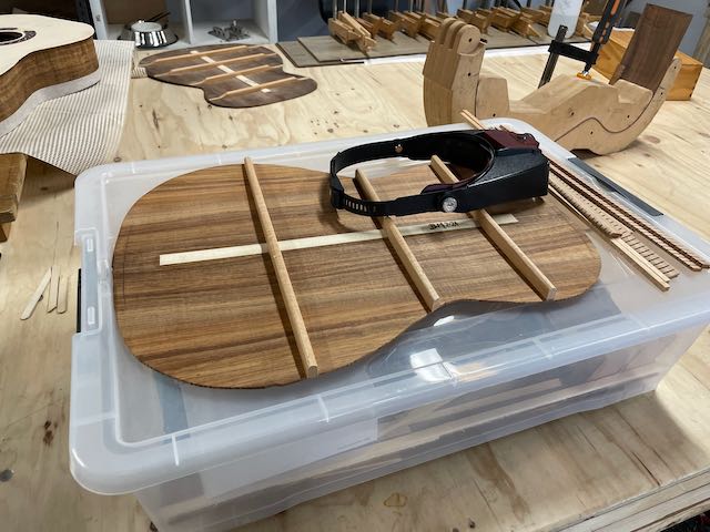

Gluing on back braces:
240729 gluing back braces.jpeg (452.62 KiB) Viewed 34823 times

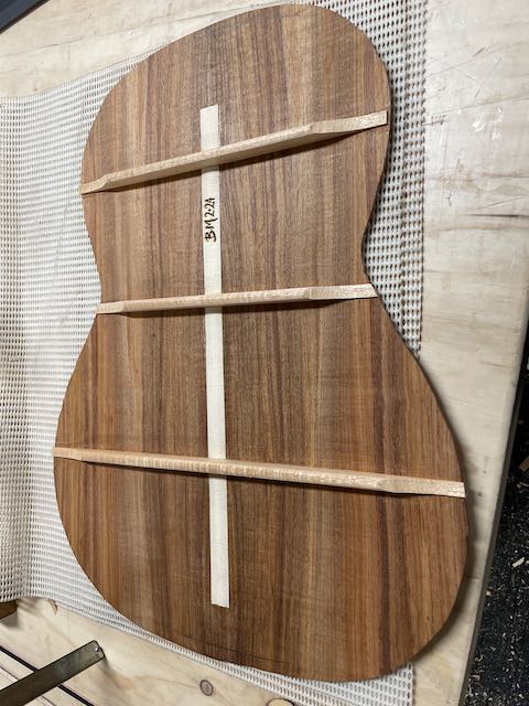

And here they are. I was pretty happy with my shaping of these braces. I felt that I was able to apply some of the trial and error in shaping the top braces, to get these ones a bit more snugly fitting:
240729 back braces on.jpeg (420.02 KiB) Viewed 34823 times

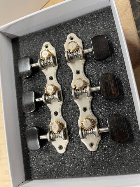

Let's start with a pic of the Schaeller tuners I'll be using:
240730 tuners.jpeg (417.26 KiB) Viewed 34817 times

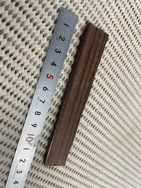

Cutting out a blank for the tail wedge:
240730 wedge blank.jpeg (484.83 KiB) Viewed 34817 times

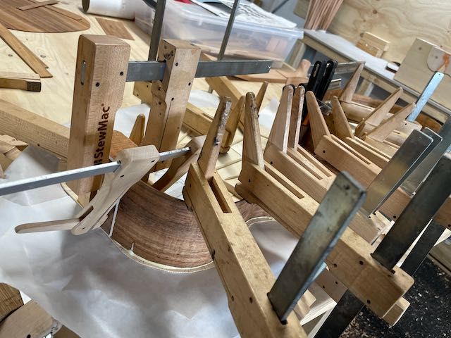

Glued and clamped side braces:
240730 clamped side braces.jpeg (404.63 KiB) Viewed 34817 times

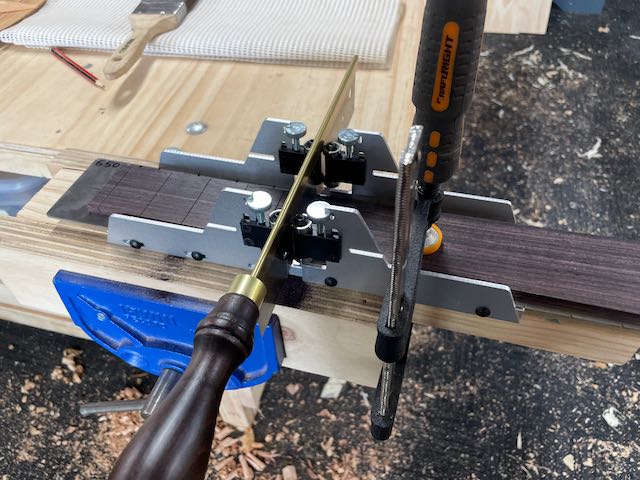

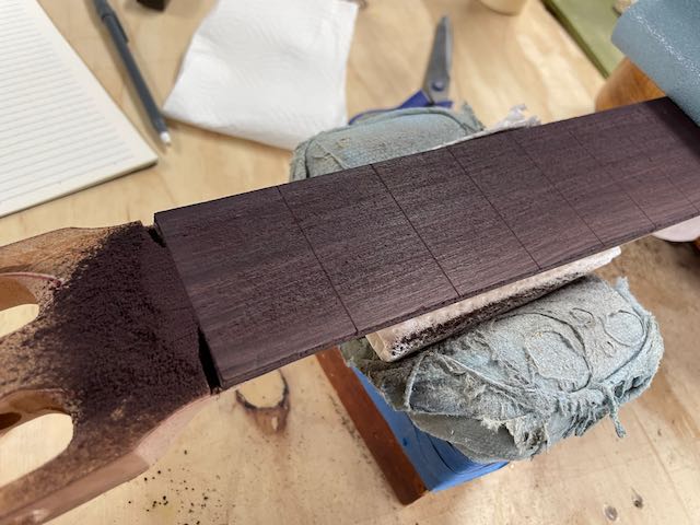

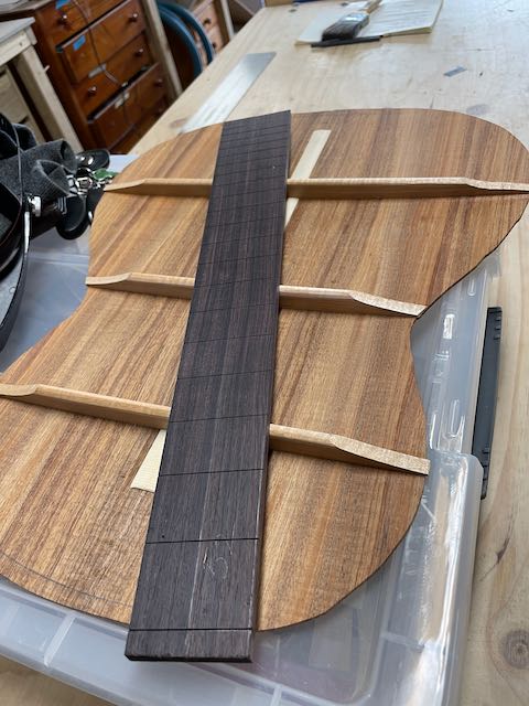

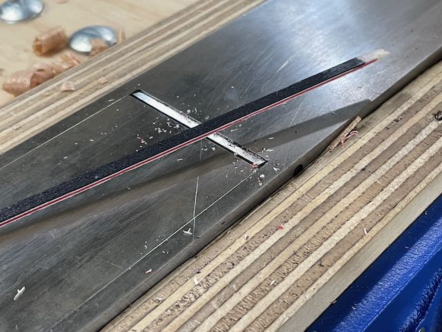

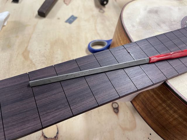

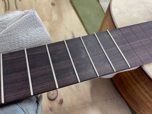

Cutting the fret slots:
240730 fret slots.jpeg (345.87 KiB) Viewed 34817 times

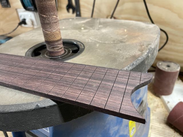

Slotted finger board:
240730 slotted FB.jpeg (434.5 KiB) Viewed 34817 times

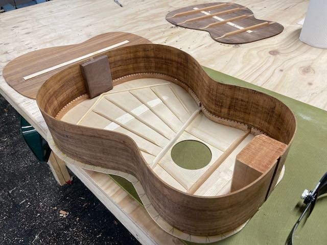

And here's the body so far, now with all braces glued in:
240730 body so far.jpeg (449.19 KiB) Viewed 34817 times

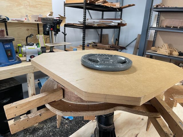

Shaping the back with the radius dish and some weight - "driving the bus":
240730 bus.jpeg (371.52 KiB) Viewed 34817 times

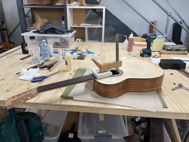

The back temporary clamped on for checking and fitting and marking for notching:
240730 back temp clamped.jpeg (476.99 KiB) Viewed 34817 times

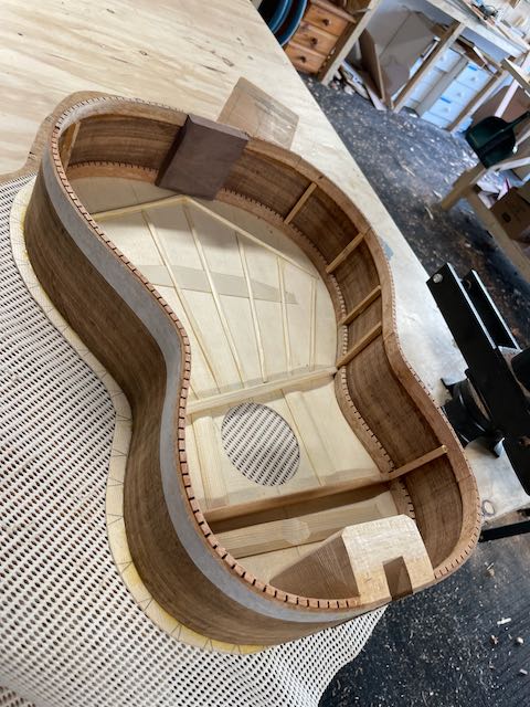

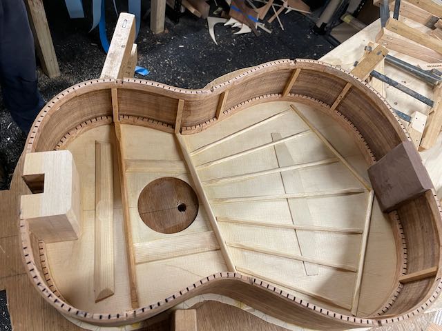

A last look at the insides before they are clamped up!
240730 back last look.jpeg (429.42 KiB) Viewed 34817 times
240730 body last look.jpeg (354.39 KiB) Viewed 34817 times

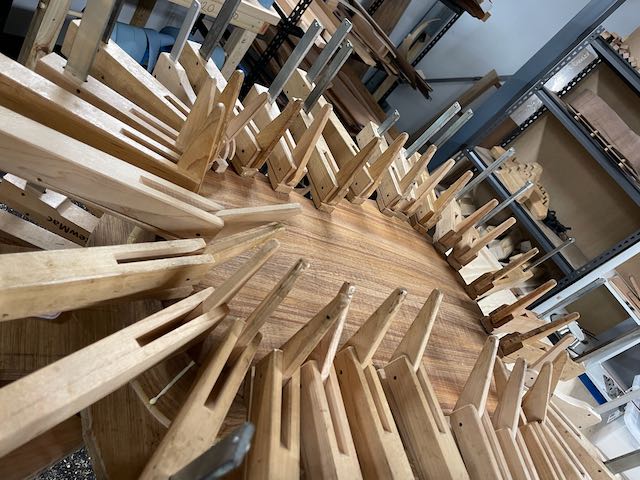

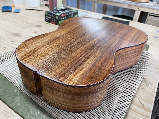

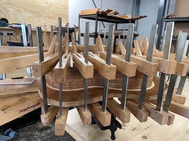

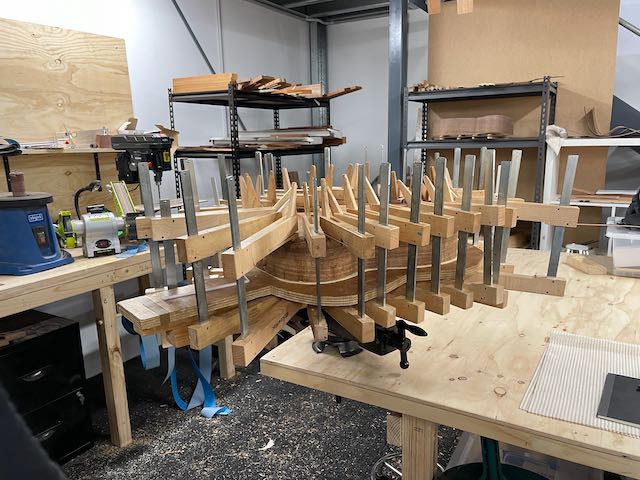

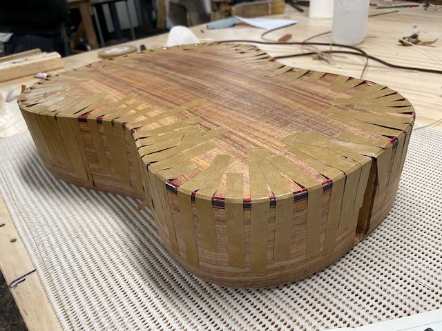

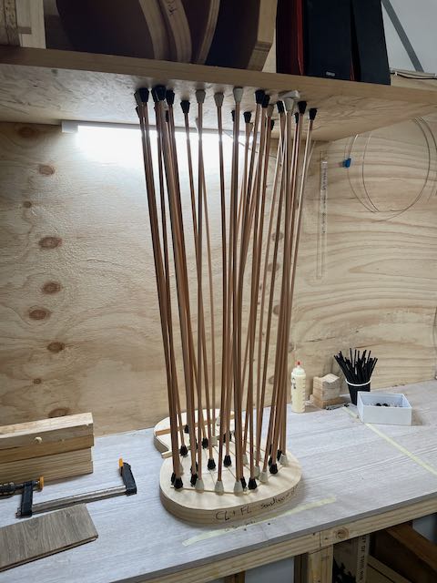

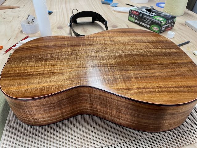

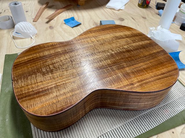

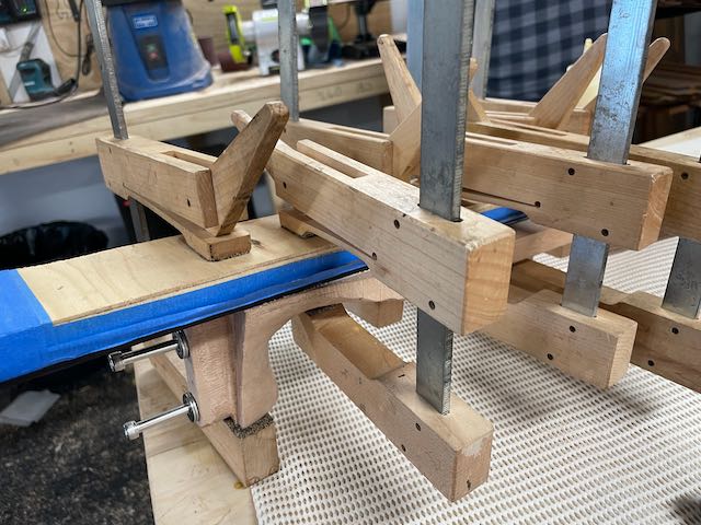

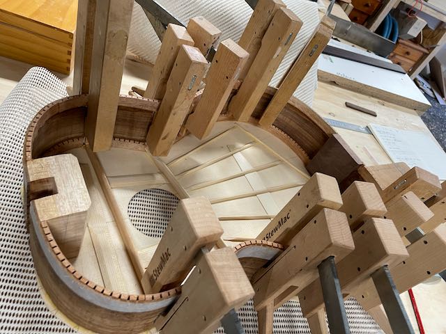

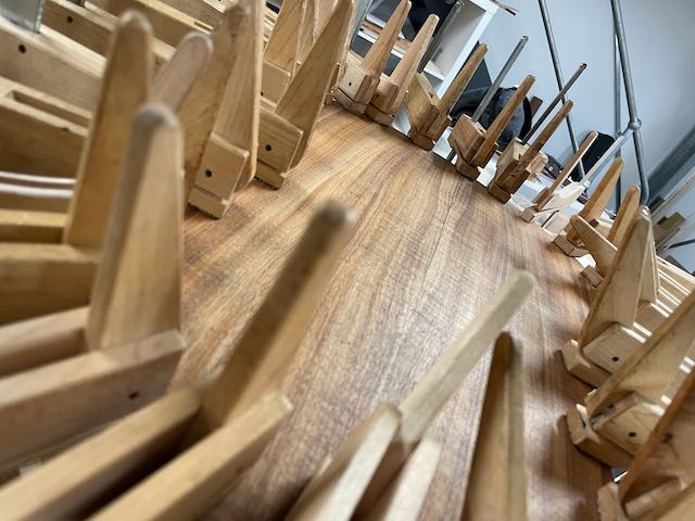

And finally for the day, here are a few pics of the back being clamped on - closing up the box, a big milestone:
240730 back clamped A.jpeg (449.92 KiB) Viewed 34817 times
240730 back clamped B.jpeg (319.07 KiB) Viewed 34817 times
240730 back clamped C.jpeg (453.9 KiB) Viewed 34817 times

Ok, we're now just past the half-way mark. Here's how the guitar looked as Day 8 kicked off:
240731 start Day 8.jpeg (451.55 KiB) Viewed 34759 times

Flush cut top and back to sides:
240731 flush cut.jpeg (375.94 KiB) Viewed 34759 times
Recess for the wedge cut out:
240731 wedge recess.jpeg (384.66 KiB) Viewed 34759 times
Here's the wedge glued in:
240731 wedge glued.jpeg (346.59 KiB) Viewed 34759 times

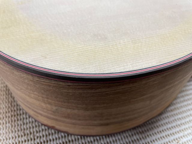

Veneers and binding ready to go in:
240731 veneers binding.jpeg (412.48 KiB) Viewed 34759 times
And glued and taped. Looks a bit mummified:
240731 mummified.jpeg (494.76 KiB) Viewed 34759 times
Day 8 done!

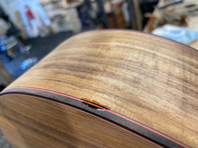

Here's the body with the binding glued in and now needing flush trimming. But an important question from this pic - which of these 3 tools is most important? :D
240801 start Day 9.jpeg (414.88 KiB) Viewed 34759 times

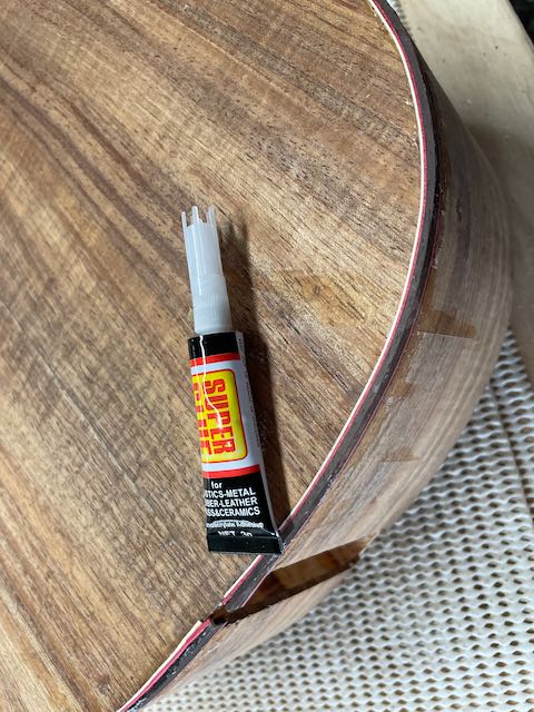

Add a little dash of CA glue:
240801 CA.jpeg (487.78 KiB) Viewed 34759 times
More mummification:
240801 more mummification.jpeg (323.12 KiB) Viewed 34759 times
A close up of this bit of the process:
240801 close up.jpeg (266.12 KiB) Viewed 34759 times

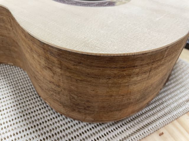

Trimming the purling close with a block plane:
240801 purfling trim.jpeg (348.57 KiB) Viewed 34759 times
(I didn't take pics of this stage, but here I spent hours scraping the sides!)
And another dash of CA in just a few places:
240801 CA again.jpeg (351.13 KiB) Viewed 34759 times
And finally, a look at where things are up to at the end of Day 9:
240801 end Day 9.jpeg (251.24 KiB) Viewed 34759 times

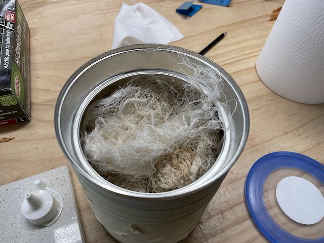

Getting some shellac mixed:
240802 shellac.jpeg (376.64 KiB) Viewed 34759 times

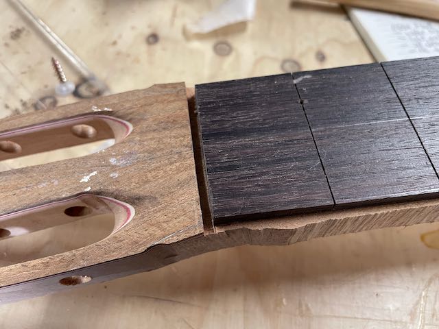

Trimming the headstock veneer to the nut line:
240802 veneer to nut.jpeg (342.37 KiB) Viewed 34759 times
Roughing in the heel:
240802 heel roughing.jpeg (424.15 KiB) Viewed 34759 times
And here's the heel, further along:
240802 heel further along.jpeg (337.55 KiB) Viewed 34759 times

Putting in some little pins for locating the fingerboard:

Rough drawing of the fingerboard end shape:
240805 FB end.jpeg (406.3 KiB) Viewed 34757 times
After a visit to the bandsaw and spindle sander, here it is shaped:
240805 FB shaped.jpeg (343 KiB) Viewed 34757 times
Marking out the end of the truss rod channel on the top, which was also routed:
240805 marking truss.jpeg (321.24 KiB) Viewed 34757 times

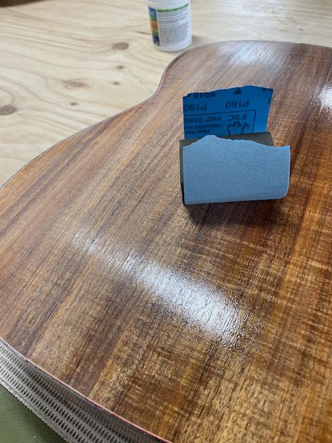

Starting the day by sanding back the sealer coat:
240806 more sanding.jpeg (486.7 KiB) Viewed 34753 times

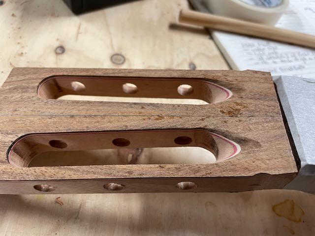

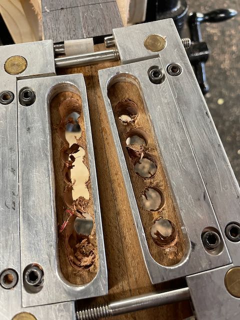

Headstock jig used for slots and tuner holes:
240806 headstock jig.jpeg (430.09 KiB) Viewed 34753 times
Hogging out some timber with a largish drill bit before receiving the router treatment:
240806 timber hogging.jpeg (507.05 KiB) Viewed 34753 times

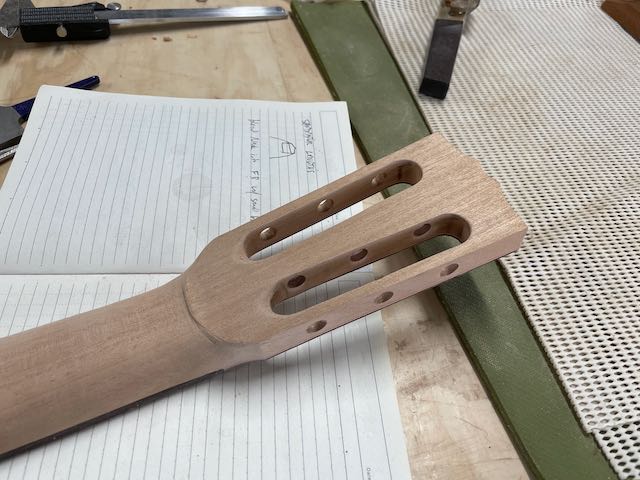

There's still some finessing to do, but here's the headstock mostly shaped:
240806 headstock.jpeg (348.32 KiB) Viewed 34753 times

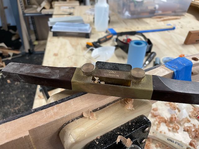

From there it was refining the fingerboard / neck area with a spokeshave:
240806 spokeshave.jpeg (357.34 KiB) Viewed 34753 times

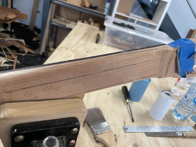

Getting some neck depth marked using the spindle sander, on both ends of neck, but not quite to final depth:
240806 neck depth.jpeg (329.58 KiB) Viewed 34753 times

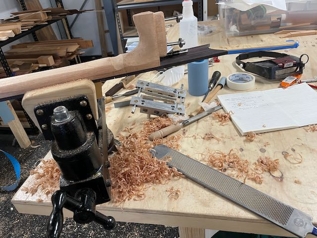

And my final bit of neck work for the day, using a farrier's rasp:
240806 farrier.jpeg (477.03 KiB) Viewed 34753 times

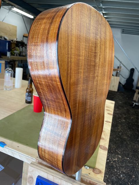

I finished the day with a last bit of sanding and finally ... the first bit of french polishing the body. I didn't take pics, and I only have one video, so here's a bit of a screen grab:

Getting ready for a little french polishing:
240807 wadding.jpeg (367.73 KiB) Viewed 34618 times
After a little french polish:
240807 FP.jpeg (545.15 KiB) Viewed 34618 times

The heel is coming along:
240807 heel coming along.jpeg (422.63 KiB) Viewed 34618 times

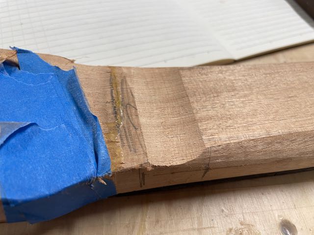

Working on the headstock to neck transition:
240807 headstock neck trans.jpeg (299.86 KiB) Viewed 34618 times
Here's the neck at this point:
240807 neck.jpeg (252.7 KiB) Viewed 34618 times
I still need to clean it up a little, but the transition is coming along:
240807 rear headstock.jpeg (396.3 KiB) Viewed 34618 times

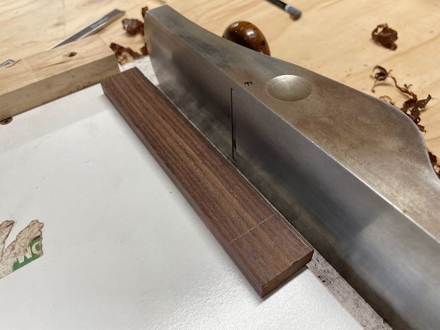

Preparing the bridge blank - shooting board and plane first step:
240807 bridge prep.jpeg (270 KiB) Viewed 34618 times

And, we wrapped up the day by attaching the neck!:
240807 neck attached.jpeg (350.87 KiB) Viewed 34618 times

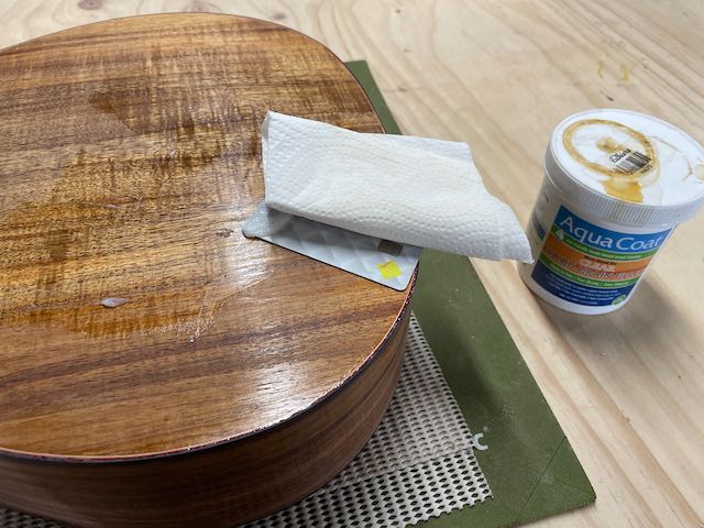

The finishing schedule interests me. 10 spit coats before going in the aquacoat? Might try this myself. Ive been using Aquacoat on my last few builds but results haven't been that outstanding
bernm
Posts: 63
Joined: Wed Jun 11, 2008 8:44 am
Re: Classical Build - Toscano Guitars Intensive
Post by bernm » Thu Aug 08, 2024 12:00 pm
kiwigeo wrote:
Thu Aug 08, 2024 11:41 am
Looking good.
Those sealer coats were for preventing any discolourisation from the Aquacoat on the blackwood. After leveling that back a little and then filling with Aquacoat, it’s on to what I assume would be a usual french polishing schedule.
Post by kiwigeo » Thu Aug 08, 2024 12:04 pm
I'm used to 2-3 spit coats prior to pore filling...that's with Indian Rosewood.

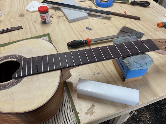

Getting ready to level the fretboard:
240808 prep levelling.jpeg (56.52 KiB) Viewed 34431 times
And the levelling in action:
240808 FB levelling.jpeg (53.28 KiB) Viewed 34431 times
Slight filing of the fret slots:
240808 slot file.jpeg (308.71 KiB) Viewed 34431 times

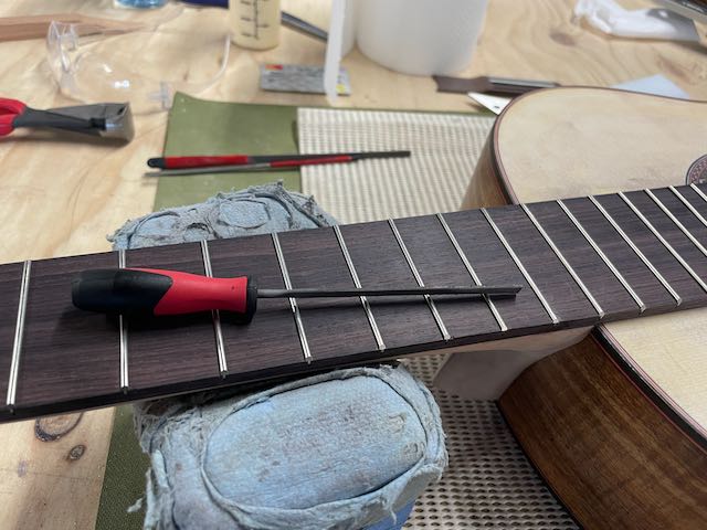

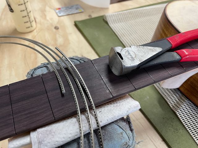

Getting ready to cut fret wire:
240808 prep fret wire.jpeg (379.48 KiB) Viewed 34431 times
Frets going in:
240808 frets going in.jpeg (363.47 KiB) Viewed 34431 times
A fretted guitar:
240808 fretted guitar.jpeg (87.45 KiB) Viewed 34431 times

I spent way too much time today working this step (due to some mistakes on my end), but here's a heel cap in progress:
240808 heel cap progress.jpeg (341.32 KiB) Viewed 34431 times
Further sanding and refining of the neck:
240808 sanding neck.jpeg (355.14 KiB) Viewed 34431 times
And we wrapped up the day with the bridge and heel cap glued on:
240808 end Day 14.jpeg (395.55 KiB) Viewed 34431 times
