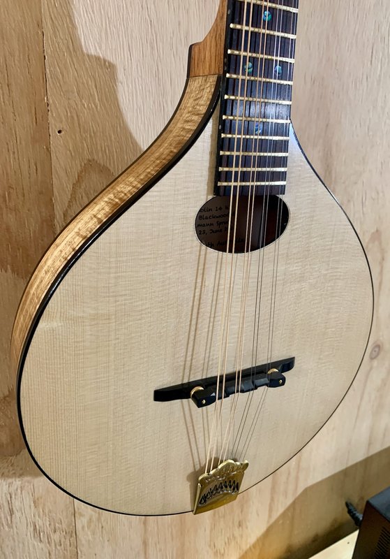

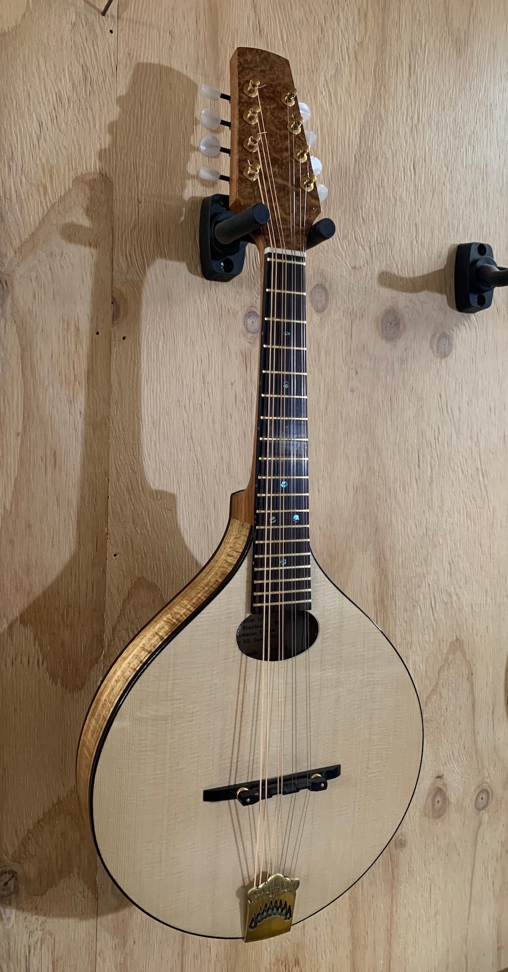

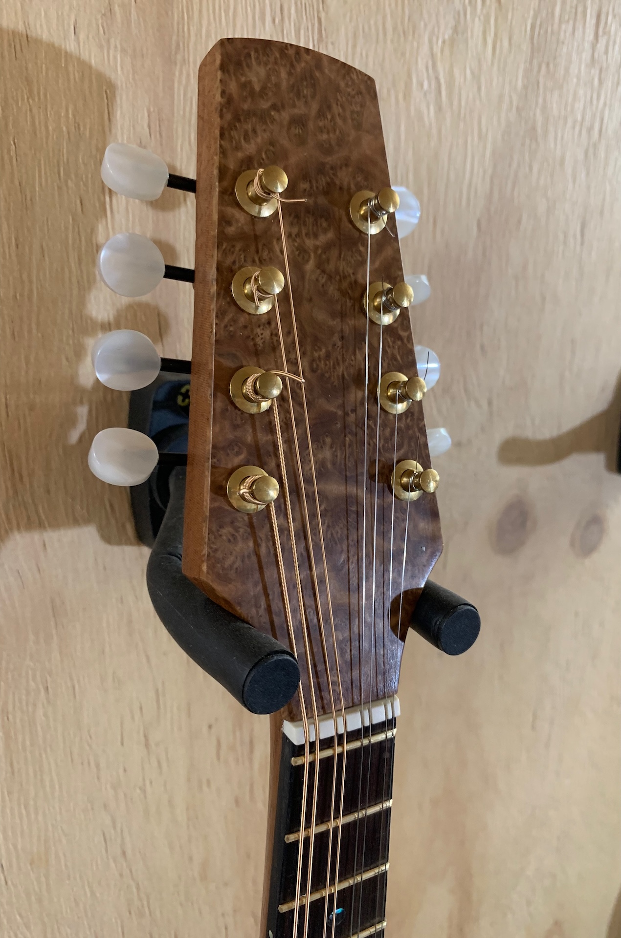

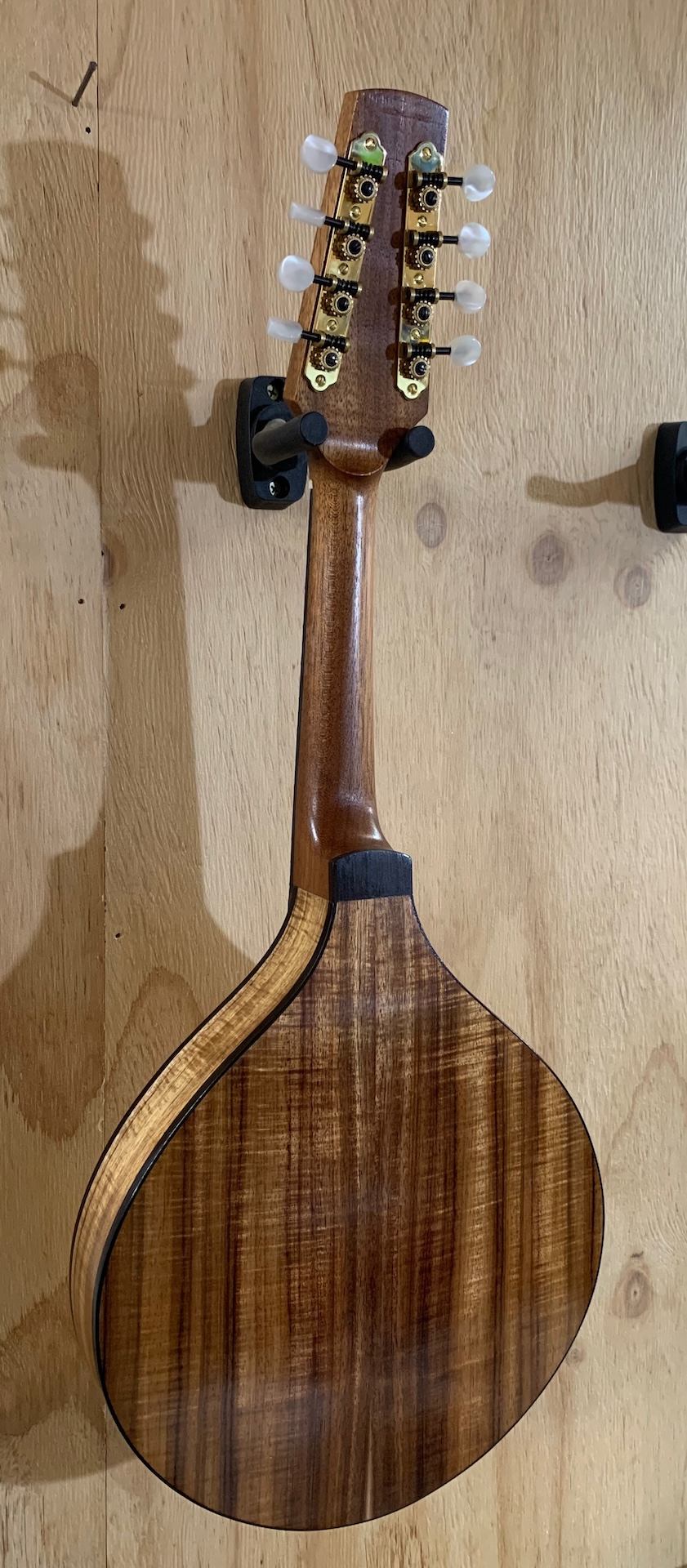

I have just completed a flat top mandolin in Engelmann Spruce and Otway Blackwood. It has a mahogany neck and Macassar ebony fingerboard, with a mortise and tenon attachment joint. Coolabah burl headstock veneer and ebony binding. I used a wipe on Osmo Poly X Gloss finish.

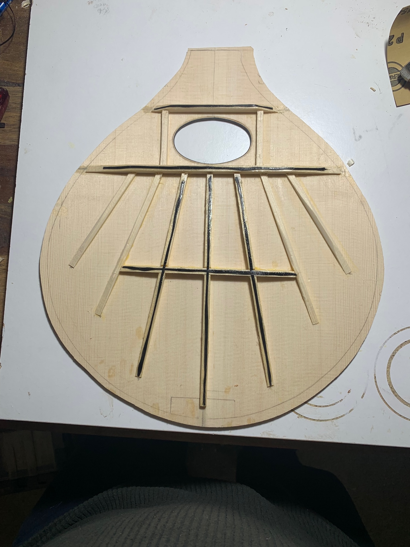

I have had a crack at implementing the bracing approach described by Australian luthier Peter Coombe in a series of posts in Mandolin Cafe forum, involving lightweight fan bracing and carbon fibre reinforcement (see https://www.mandolincafe.com/forum/thre ... er-bracing). I am very happy with the outcome - it yields a cleaner, cleaner tone than I have been able to achieve in previous builds, while maintaining volume and sustain. I look forward to seeing how it develops over time.
