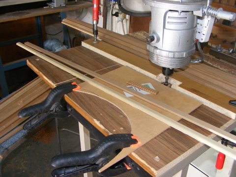

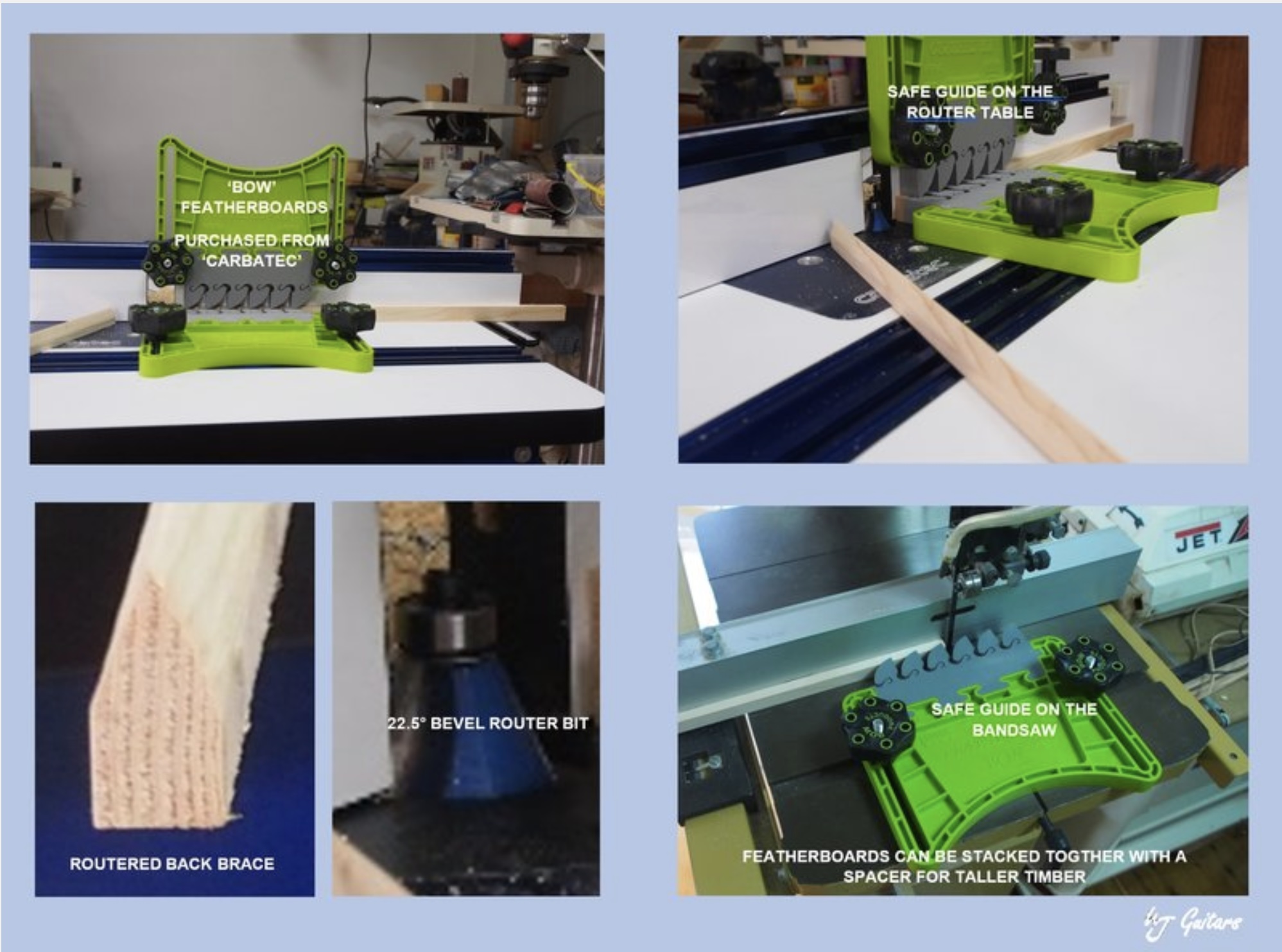

Re: chamfering braces
See photos of router table to make chamfer braces.

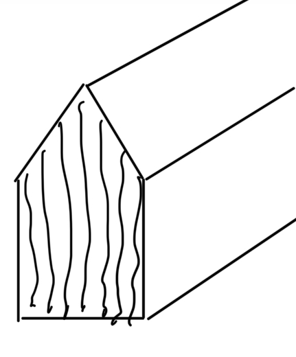

The screw holding the brace should be on the centre line of the brace and penetrate half the height of the brace (~10mm). I use two screws, one at each end, and pick up on the same screw holes when I flip the brace to rout the other side. The screws should end up no where near the cutter blades. My fixture is wider than it is tall, which helps with stability. As drawn, yours appears taller than it is wide. The lower part of the brace in the fixture (which becomes the top of the brace) is stabilised by being in contact with the router table and firm pressure from the bearing holds the spruce against the fixture. Always have the bearing pressed against the spruce or you will likely get chatter.mac007 wrote: ↑Fri Oct 18, 2024 7:44 amHi
I'm chamfering 20x10 spruce using 'the book' method of screwing the brace to a rebated fixture and freehand routing on a table against the top bearing.
It all seems a bit hazardous- the 1/2' router is a beast!
Anyone got a better way apart from hand planing?
thanks
mac
My fixture is made from a heavy lump of Tas oak, (any other dense hardwood will do). The extra mass stabilises things, and I feel pretty safe doing the cut in one pass, as per Fig. 7-6 in the Build book. If in doubt, make the fixture bigger! Think about the grain direction when you set the piece in the fixture and you should get quite a smooth cut. If you don't get a smooth enough finish for your liking (usually a function of the sharpness of the cutter), rout a little lighter and then finish off with a couple of strokes with a block plane, with the brace still in the fixture. Then flip the brace and repeat for the other side.

I'm sure your method is OK-I'm going to try the featherboard support suggested earlier so the 20x10 is supported/constrained 3 sides and feed the spruce through progressively using each new piece as a push stick.
And not stand behind the infeed in case it kicks back but the featherboards should trap it OK

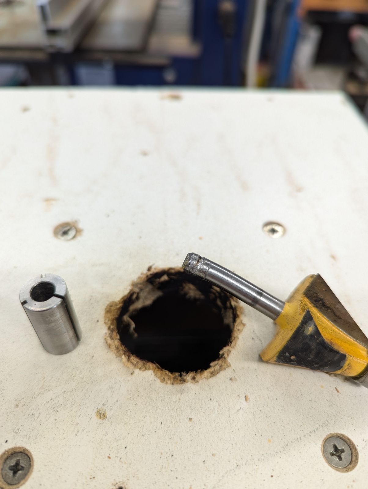

I was using a 1/4" with a collet reducer in a Makita 1/2" but seconds after I started the router this happened.
BTW The cutter was fully seated and tightened and the collet was also a 6.35 Carbitool ie a snug fit. It became airborne and gave me quite a moment!
After the smoke cleared I vowed to not use a reducer and stumped for a 1/2" Carbitool.
I think maybe the 1/4" shaft and top heavy cutter got a little "off concentric" (revised) as it sped up and it bent and released!
Yikes!!!
I gave up using collet reducers many years ago, due to eccentricity issues. I never had an incident, but it always looked like one waiting to happen. I now only use routers where proper interchangeable collet sizes are available (primarily DeWalt (1/4", 6.00mm, 1/8") , Makita (1/4", 1/8"), Triton (1/2", 1/4", 6mm).
If you can, dear readers, please get rid of your reducers ASAP!
Hi, I had the same problem with the reducing bush in my Makita ½” router. I have converted it to an overhead pin router and only use the ½’’ shank bits. I suppose I could also use it to shape braces, but I enjoy the handwork. But I use it similarly to shape my kerfing strips as I do those in batches.

Jeesh, you really dodged a bullet there MK, congratulations.mac007 wrote: ↑Tue Oct 29, 2024 7:25 amI was using a 1/4" with a collet reducer in a Makita 1/2" but seconds after I started the router this happened.
Thanks for the input-I'm planning a bulk run this week with the featherboard set-up
MK
I wonder whether the alignment has always been asymmetric and that was the cause of the chattering in the first place?
possibly
Also the router was a "give-away" from a local woodworker group and maybe it's a bit worn and not rotating perfectly true.
