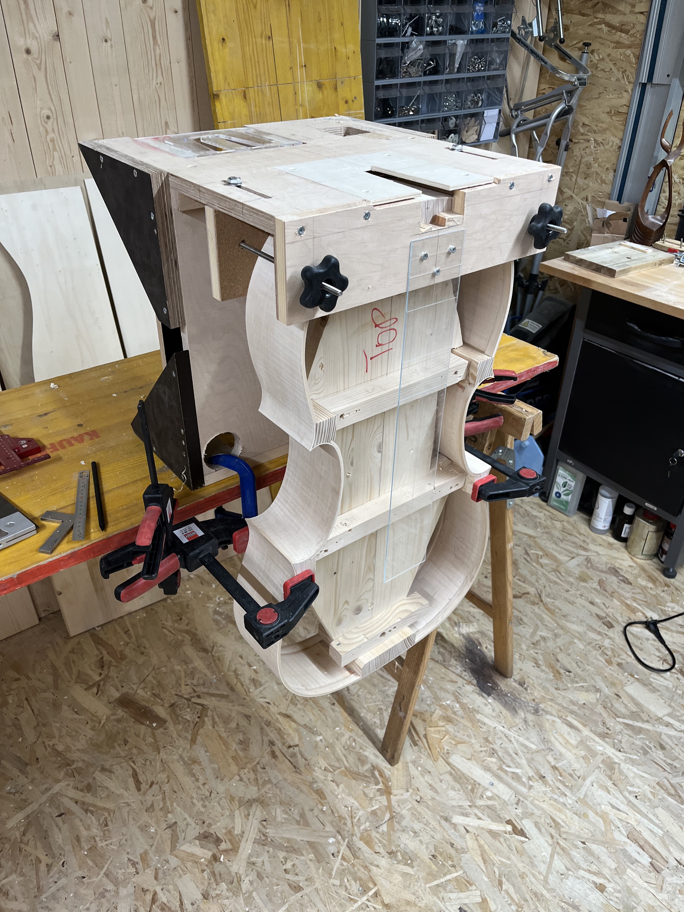

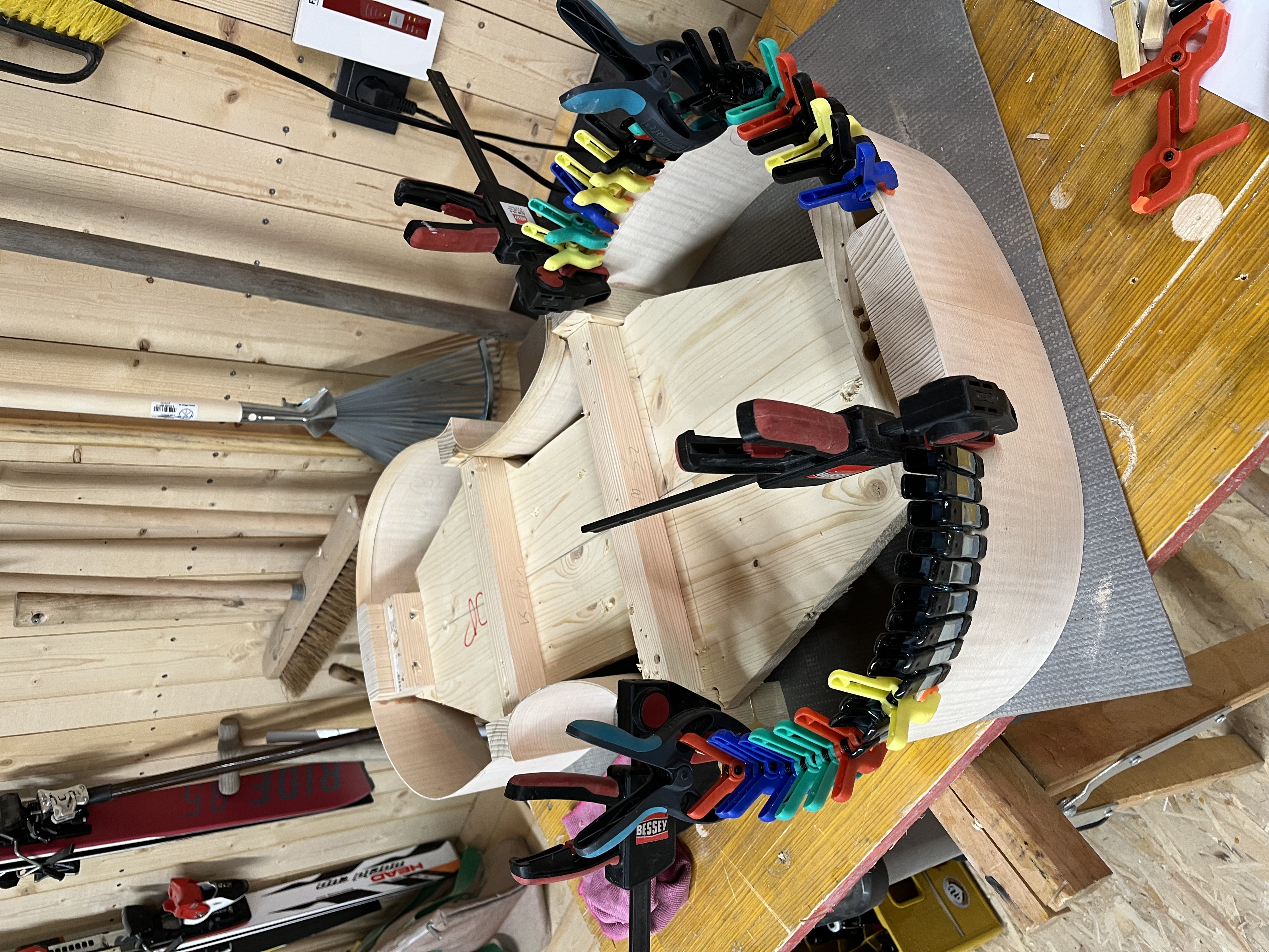

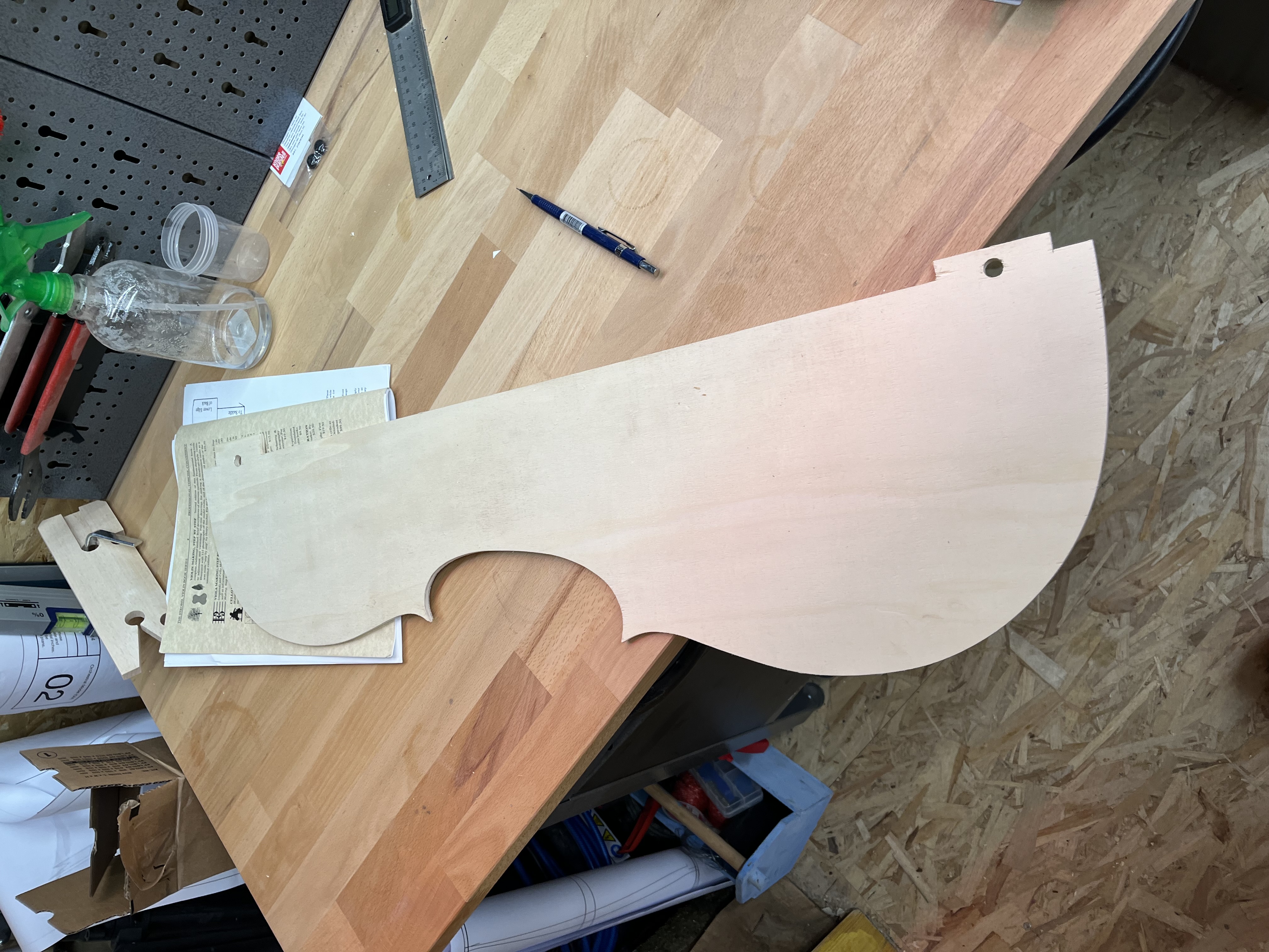

creating templates and the inner mold
the inner mold
thicknessing the ribs down to 1,7 using the safety planer
bending the first c-bout
first center bout installed..

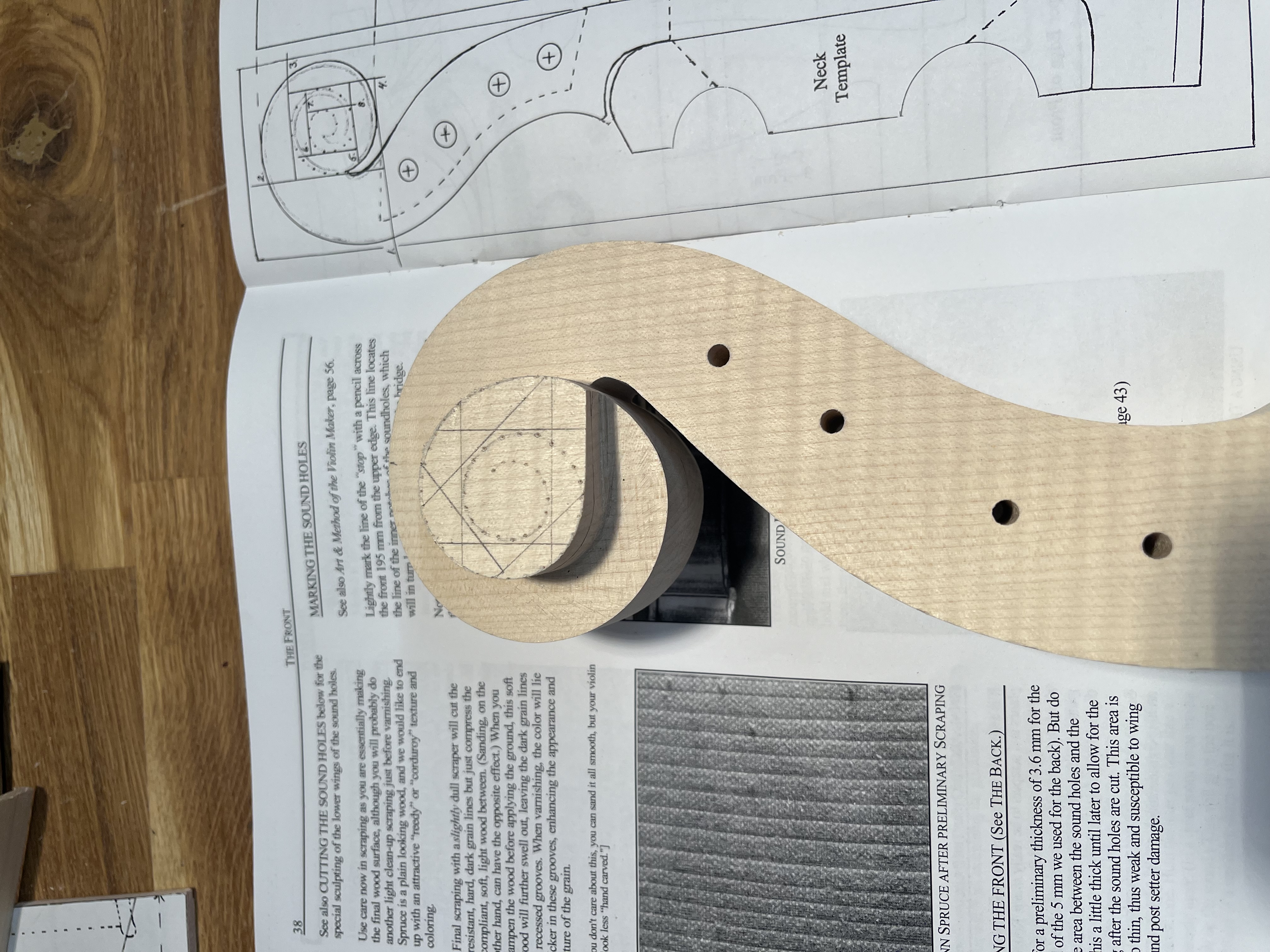

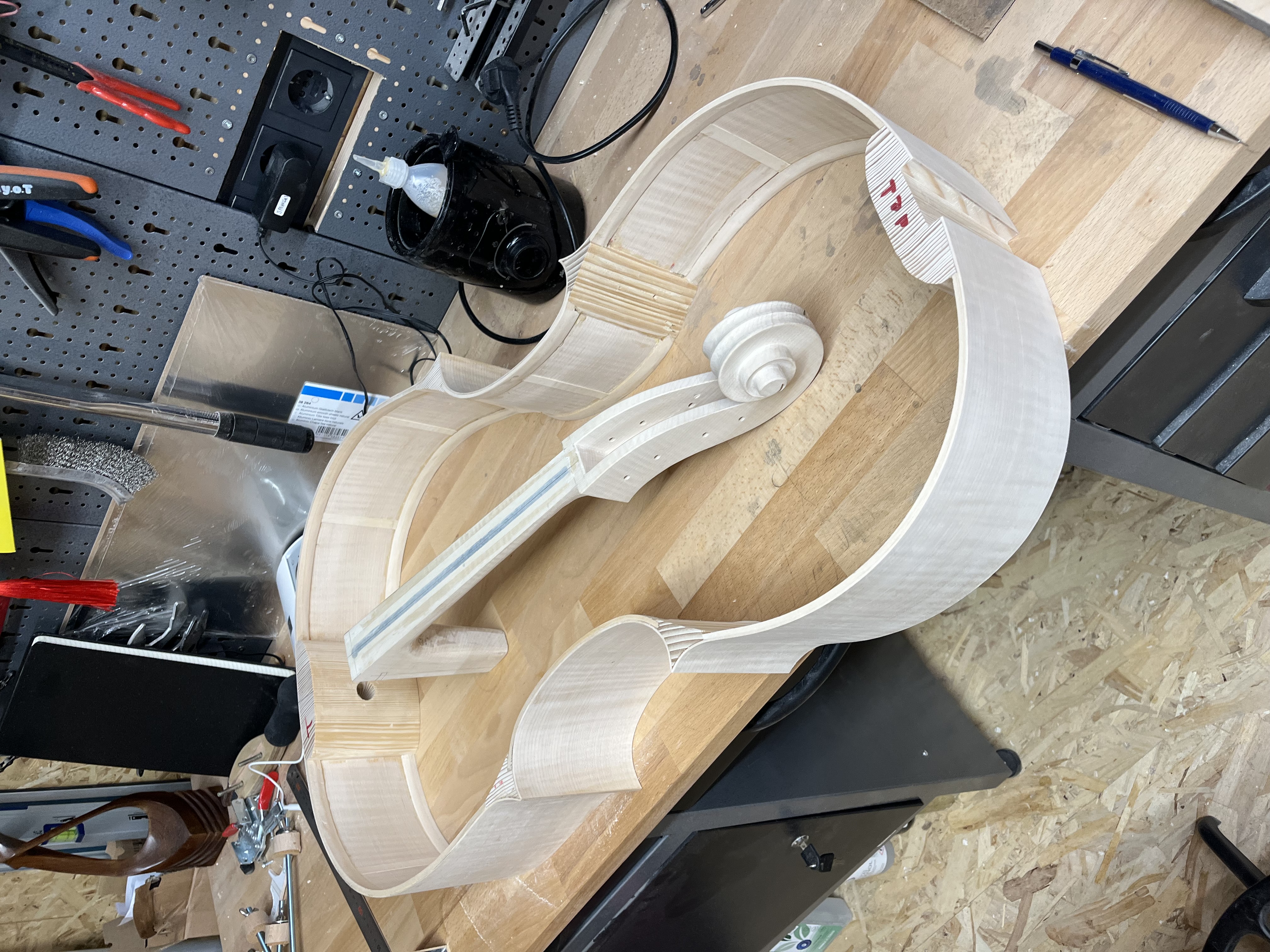

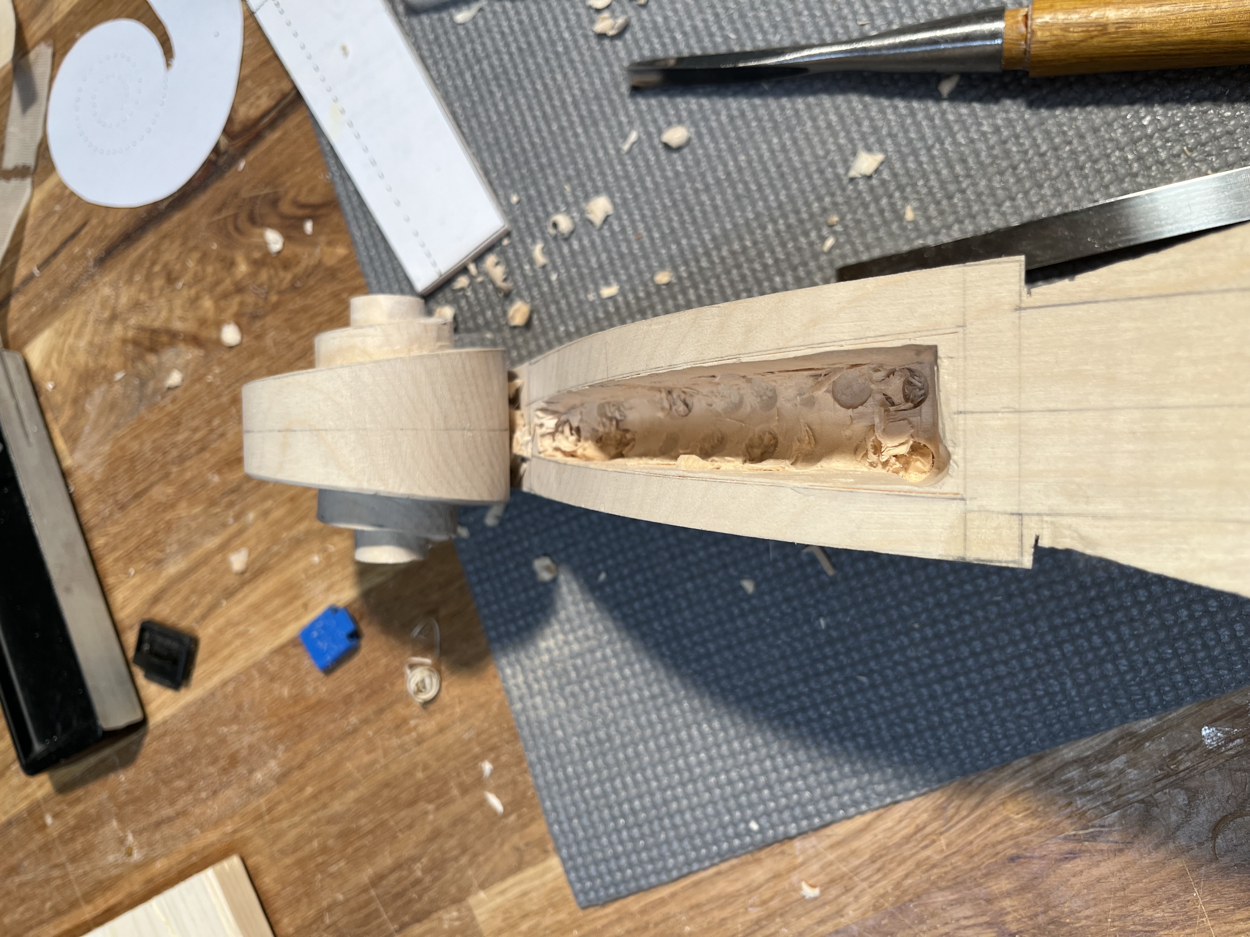

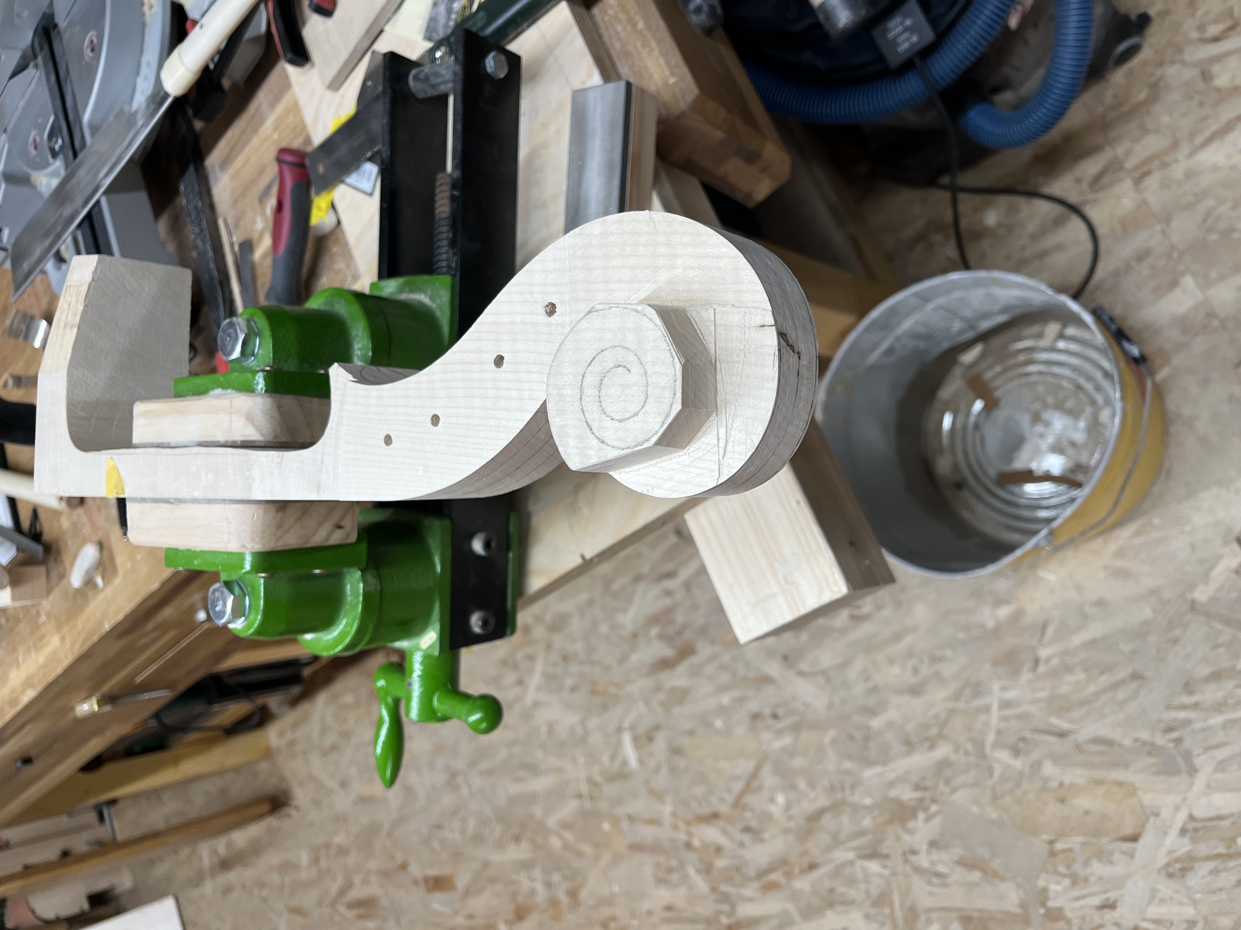

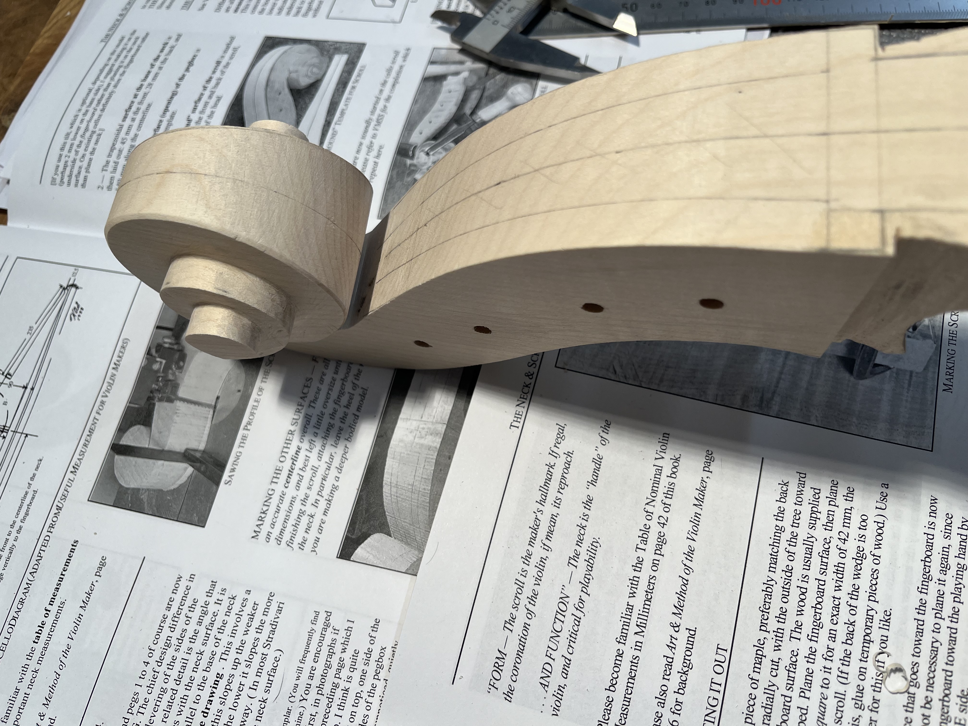

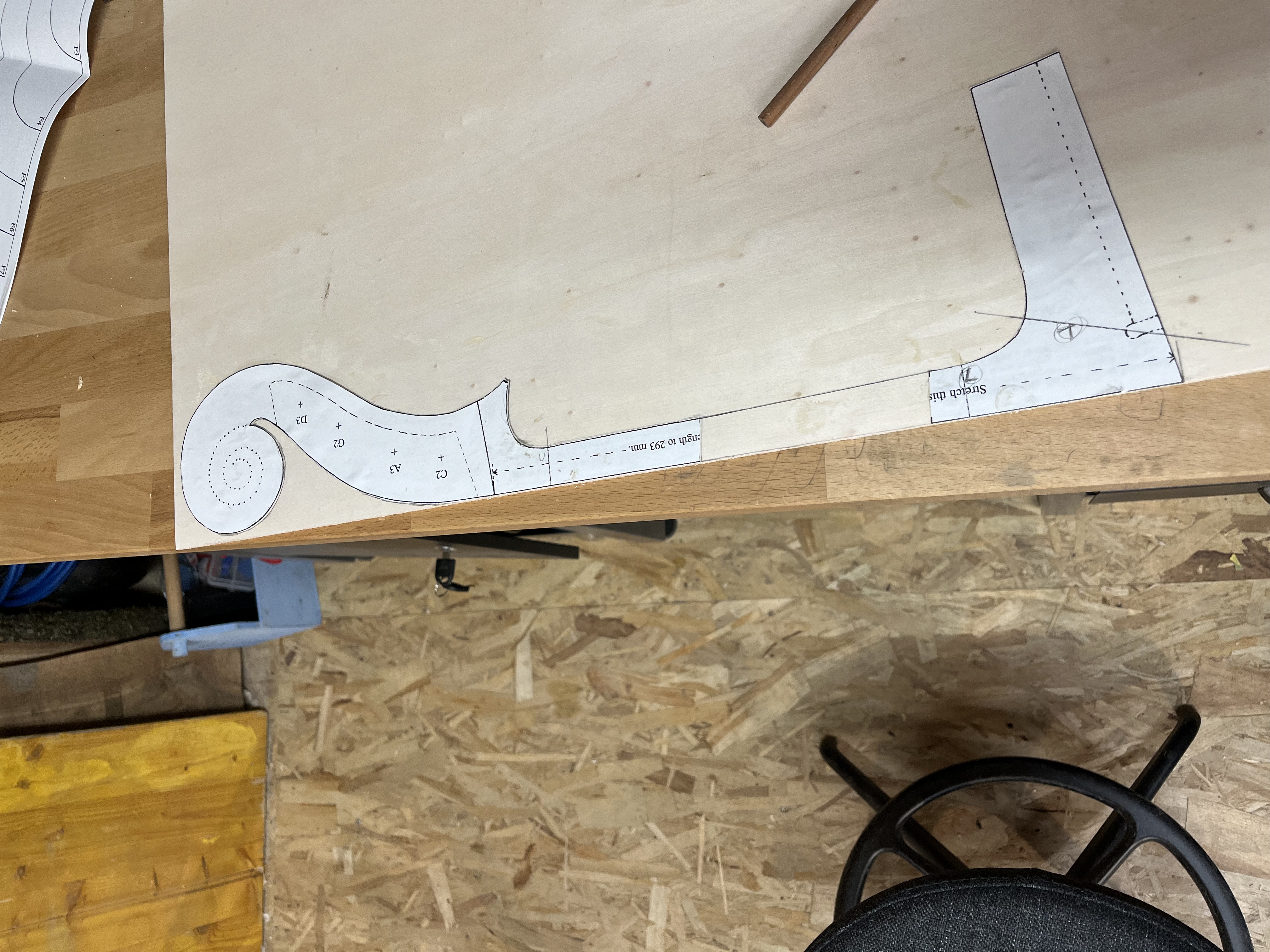

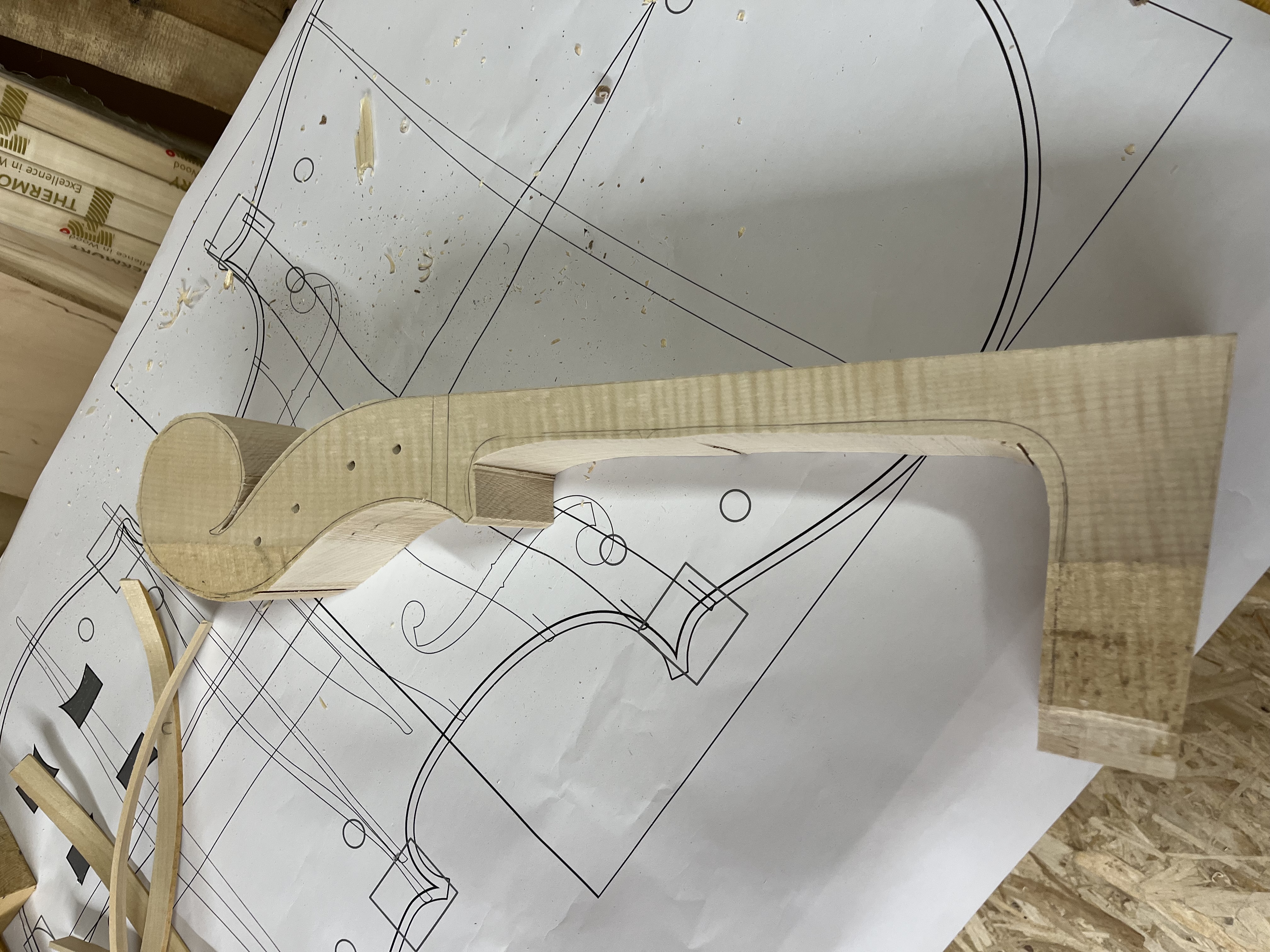

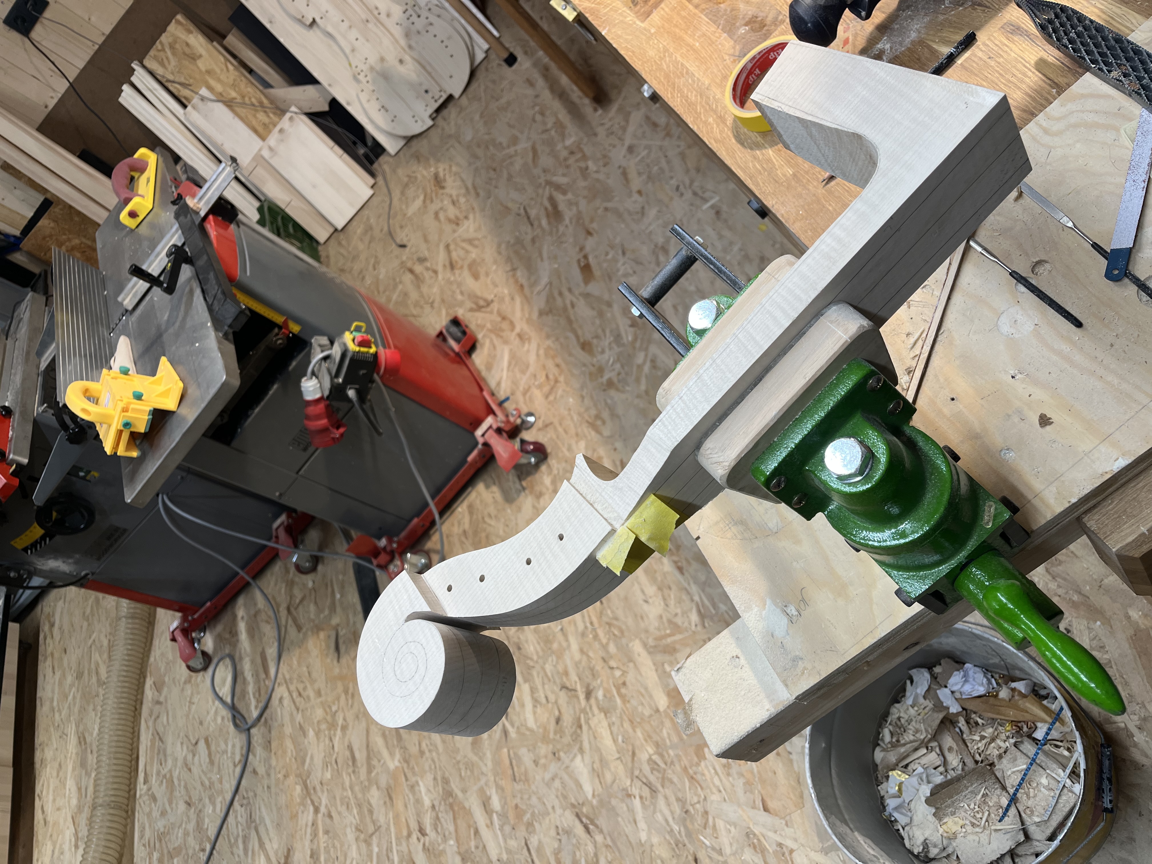

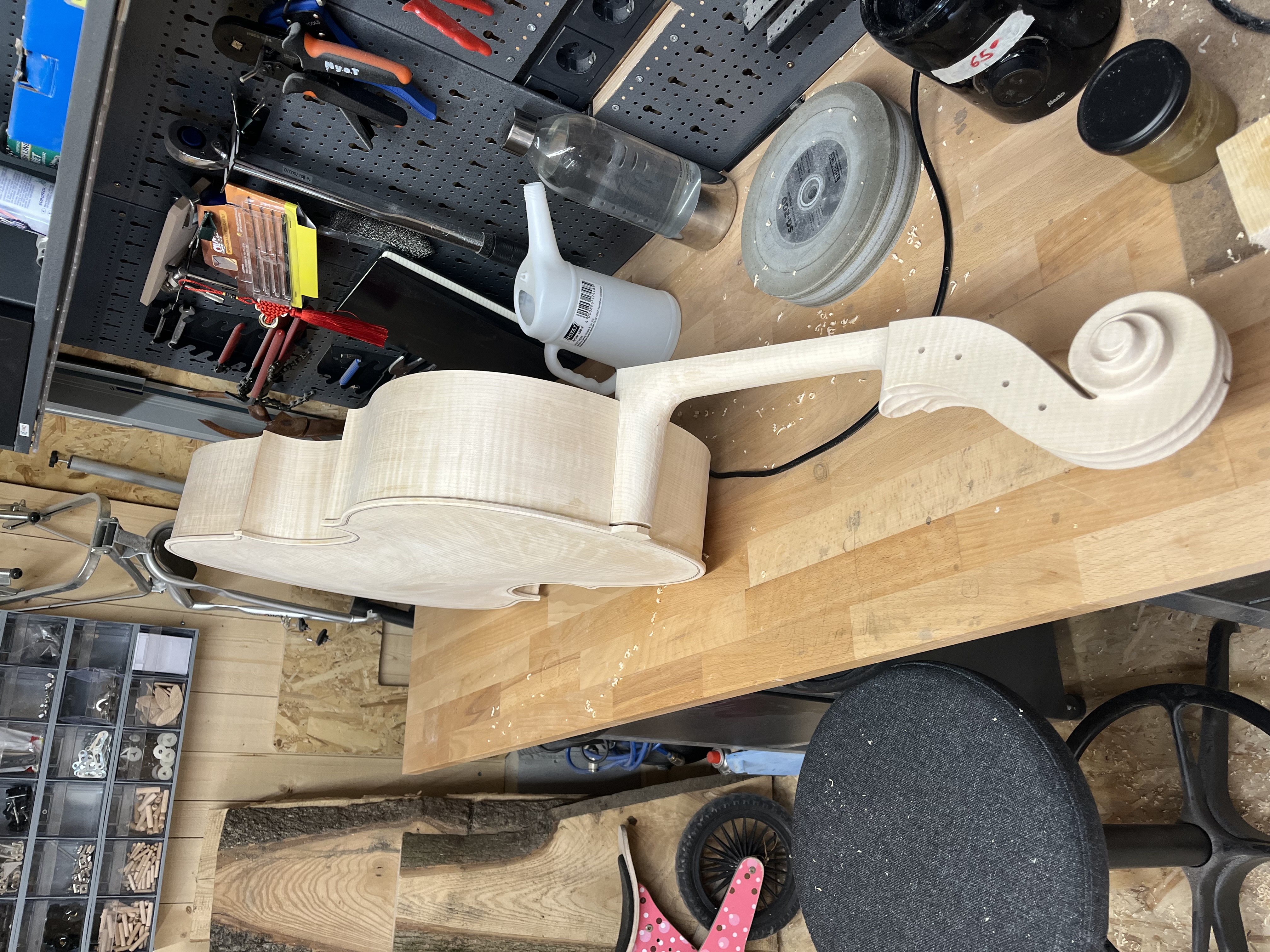

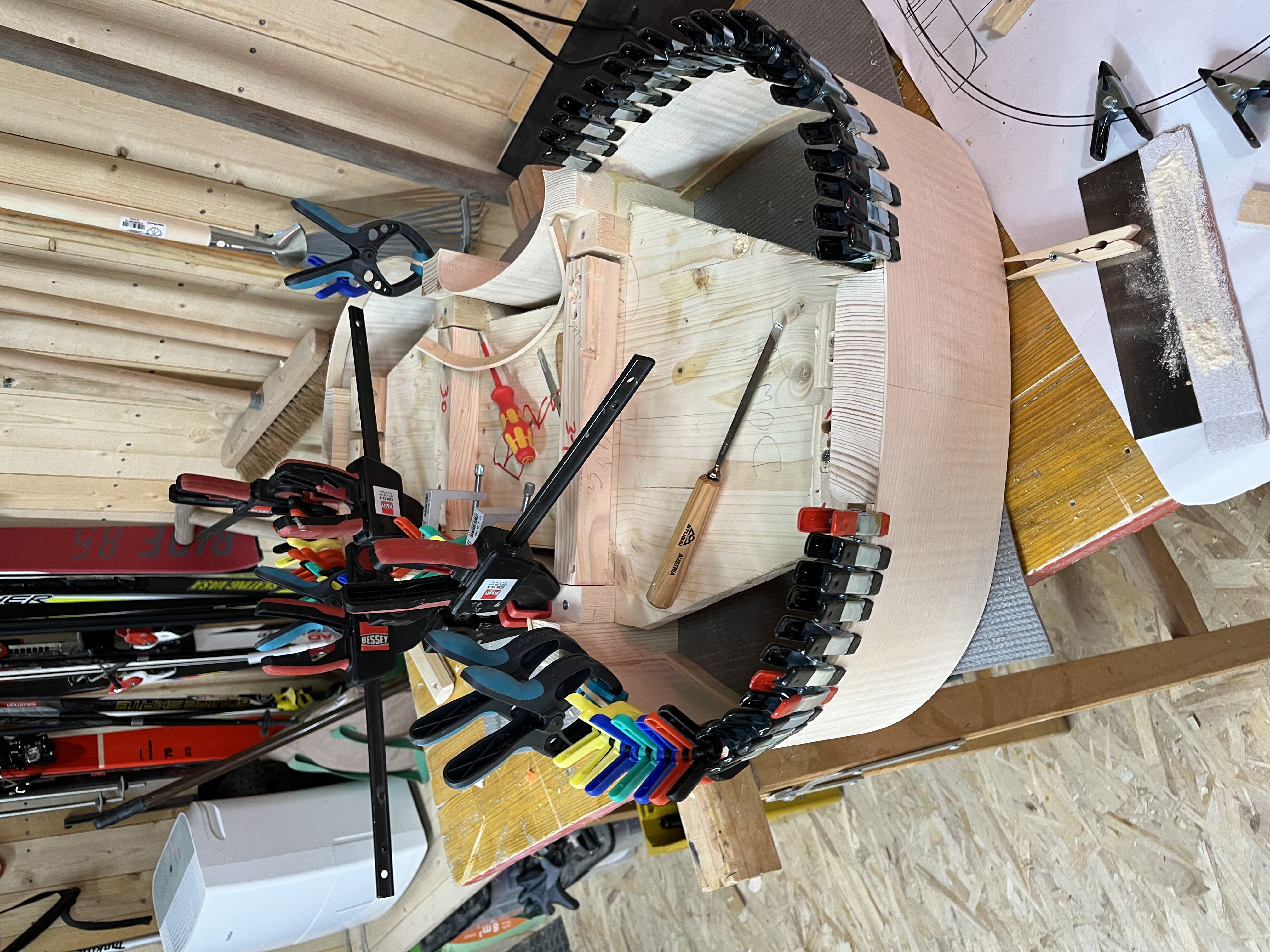

the cello work has been continued, of course, so I would like to share the progress. So far, no great discouragement or major accidents like sawing off the wrong parts - so I think, maybe this is a really great opportunity to practice mindfulness and devotion rather than just "get the work done" .... I am really enjoying this kind of work...
so here are the new pictures, finishing with the rims, and linings, and starting on neck/scroll which I was very afraid of (still am, since I am far from finished)
greetings, and best wishes for 2025
chris

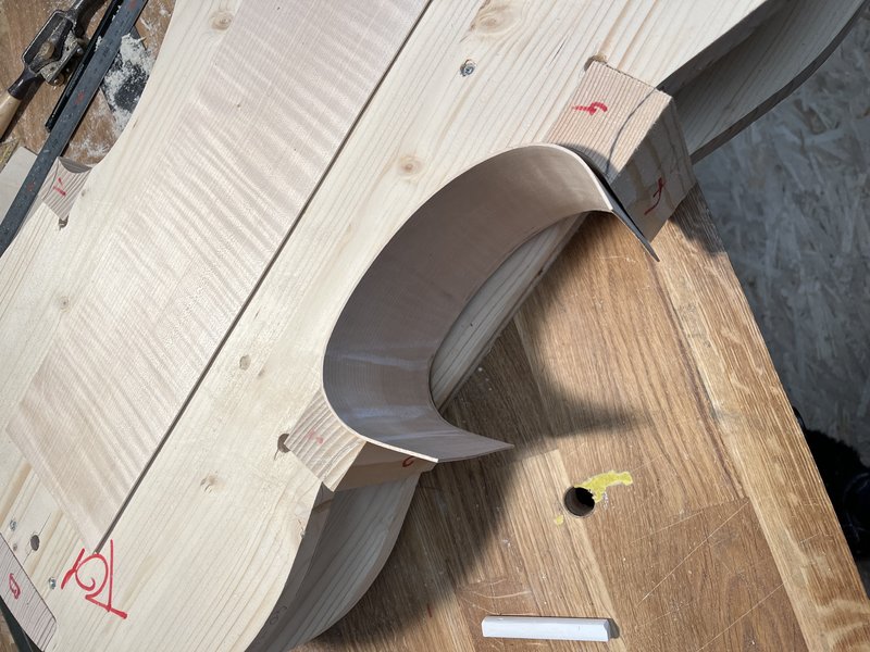

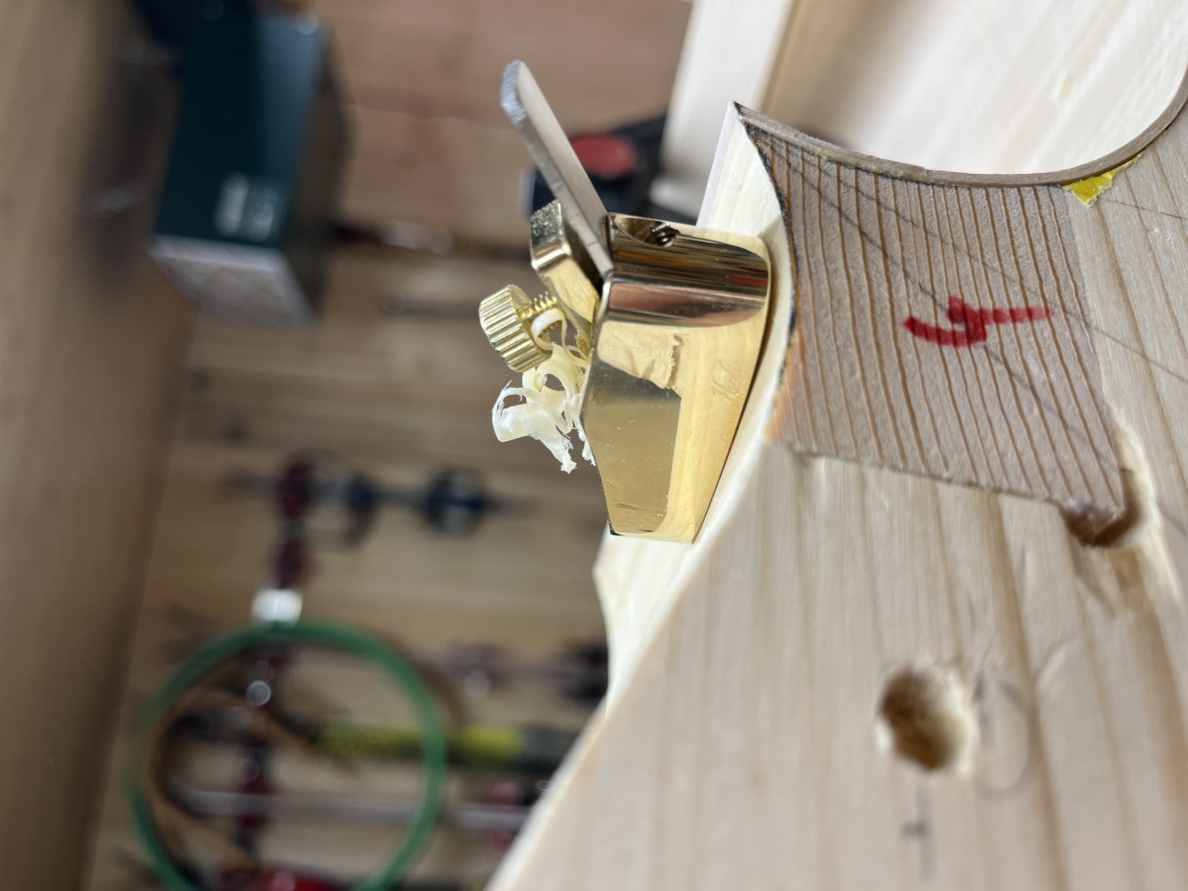

Post by chrisBk » Thu Apr 24, 2025 12:38 am
Hello,
just a little update on my work, I hope someone is interested and I am looking forward for comments and questions.... :)
work goes rather slowly, mostly due to the fact that a lot of the work is done manually- also I didnt have too
much time lately.

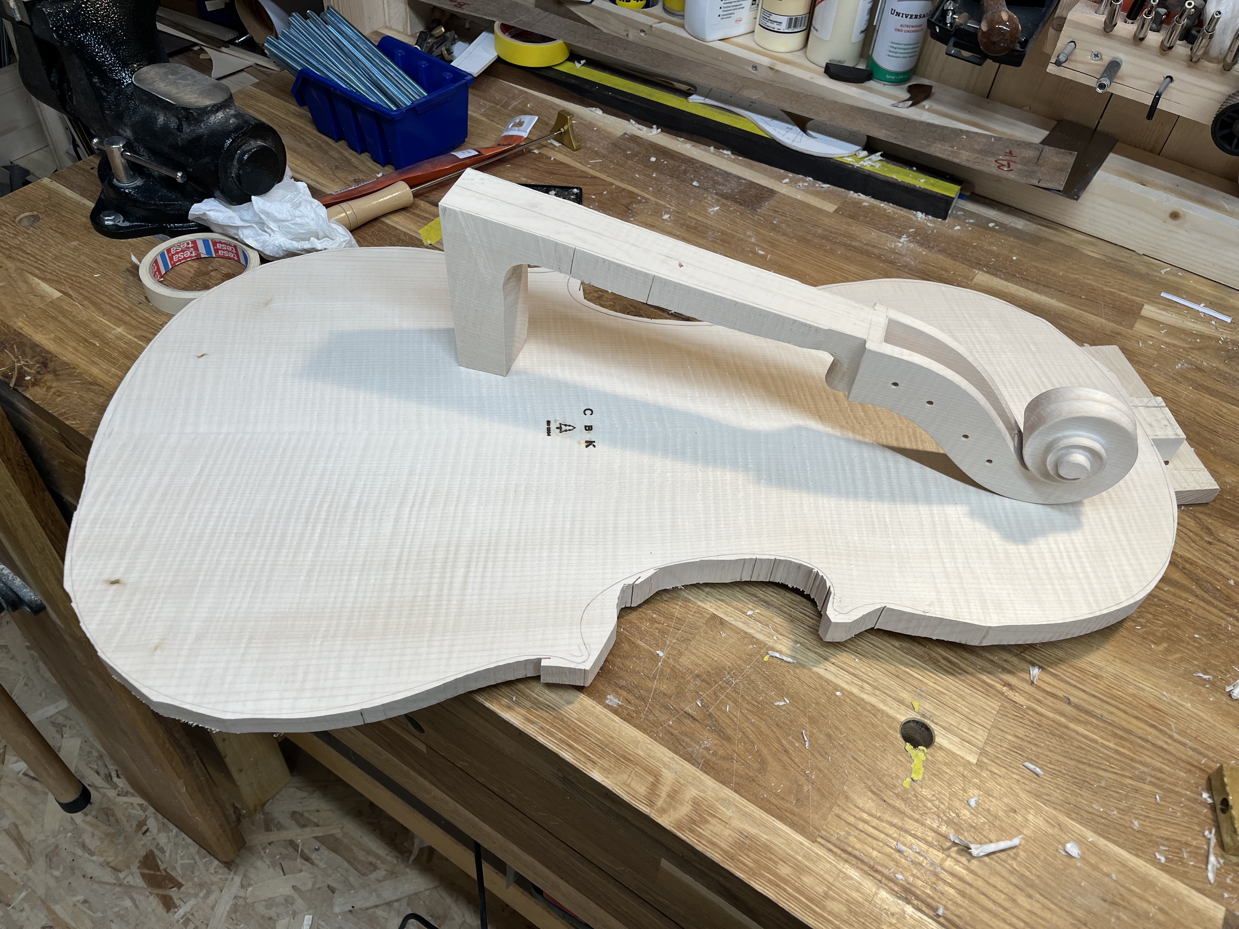

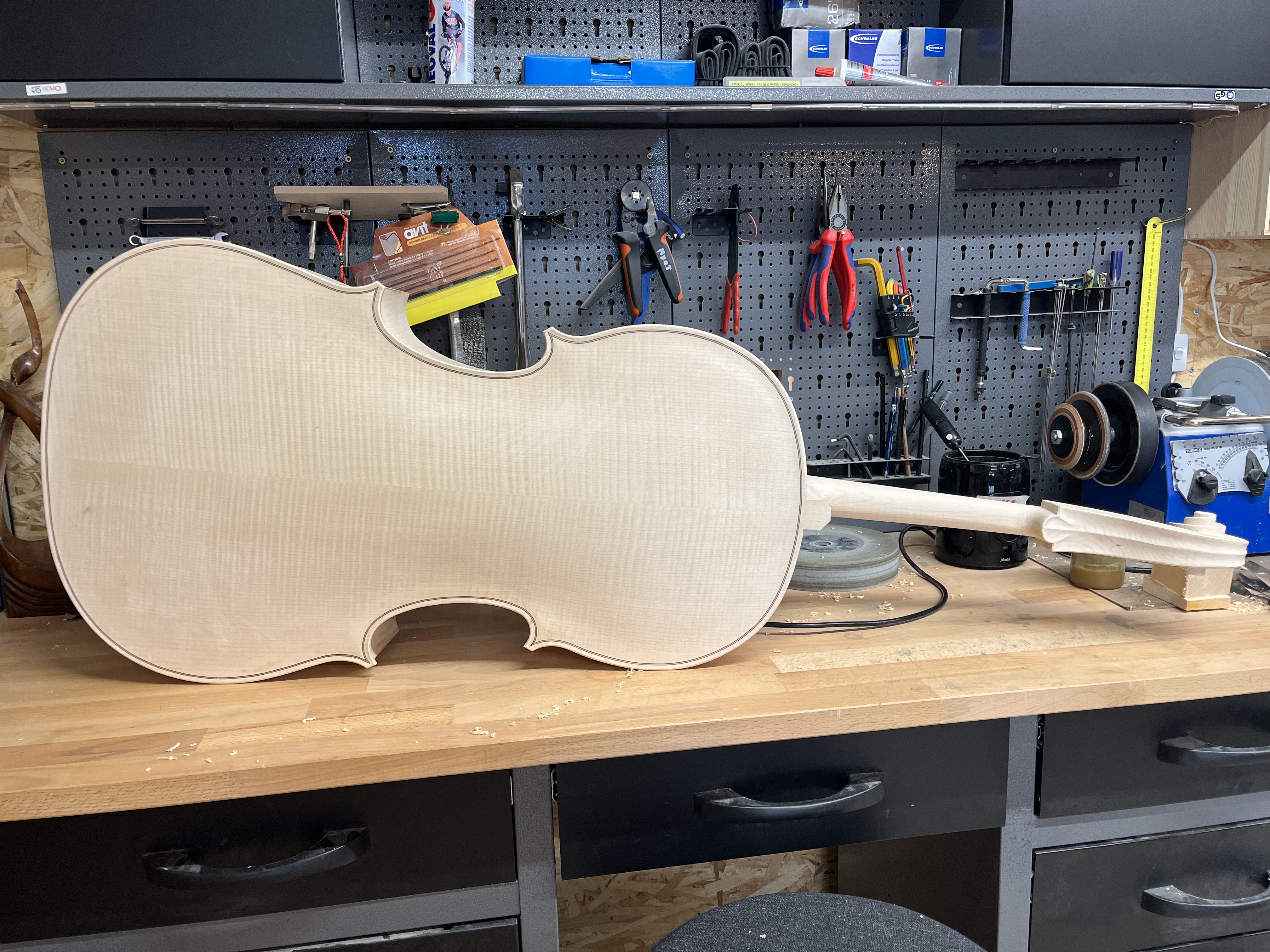

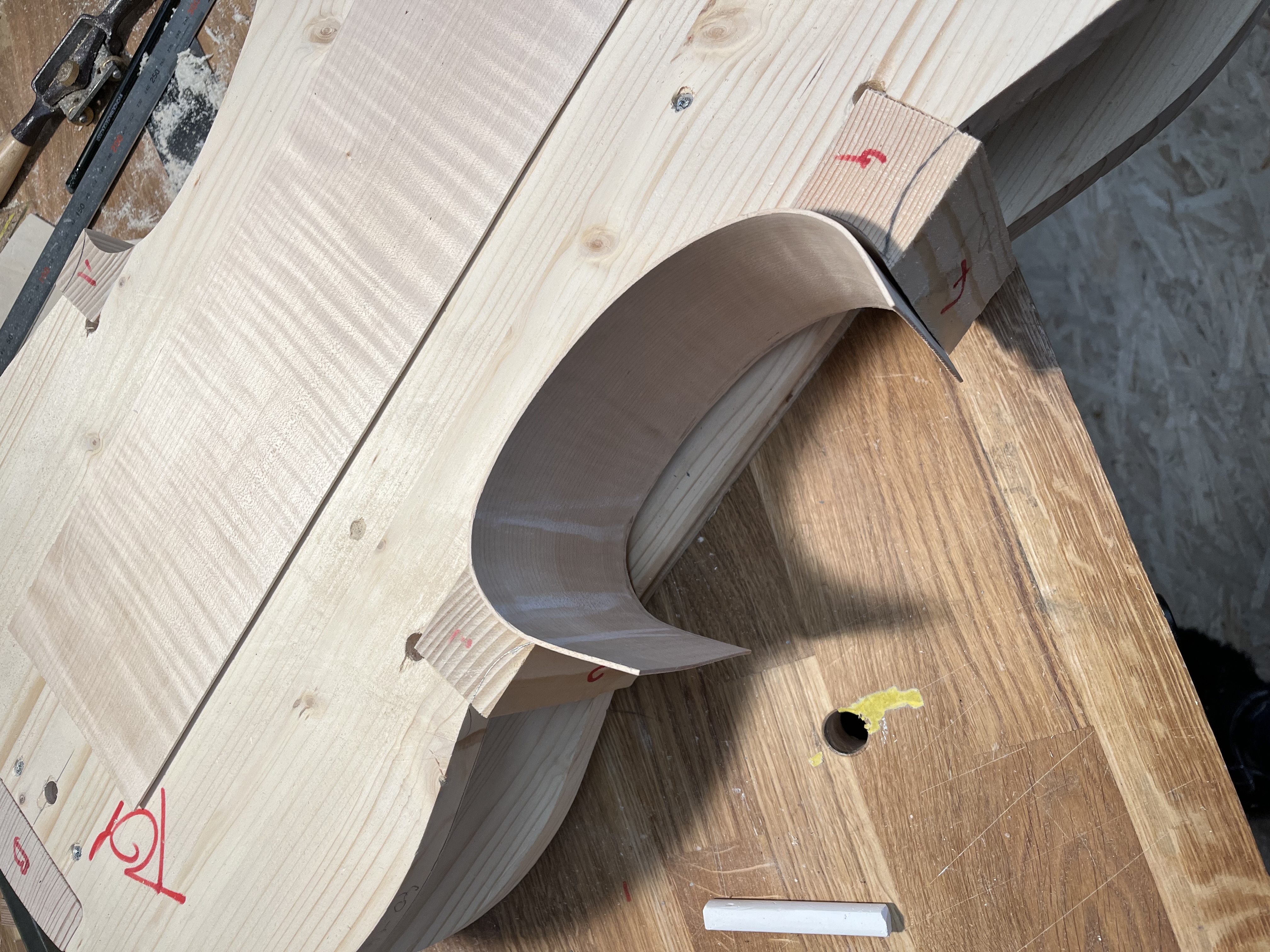

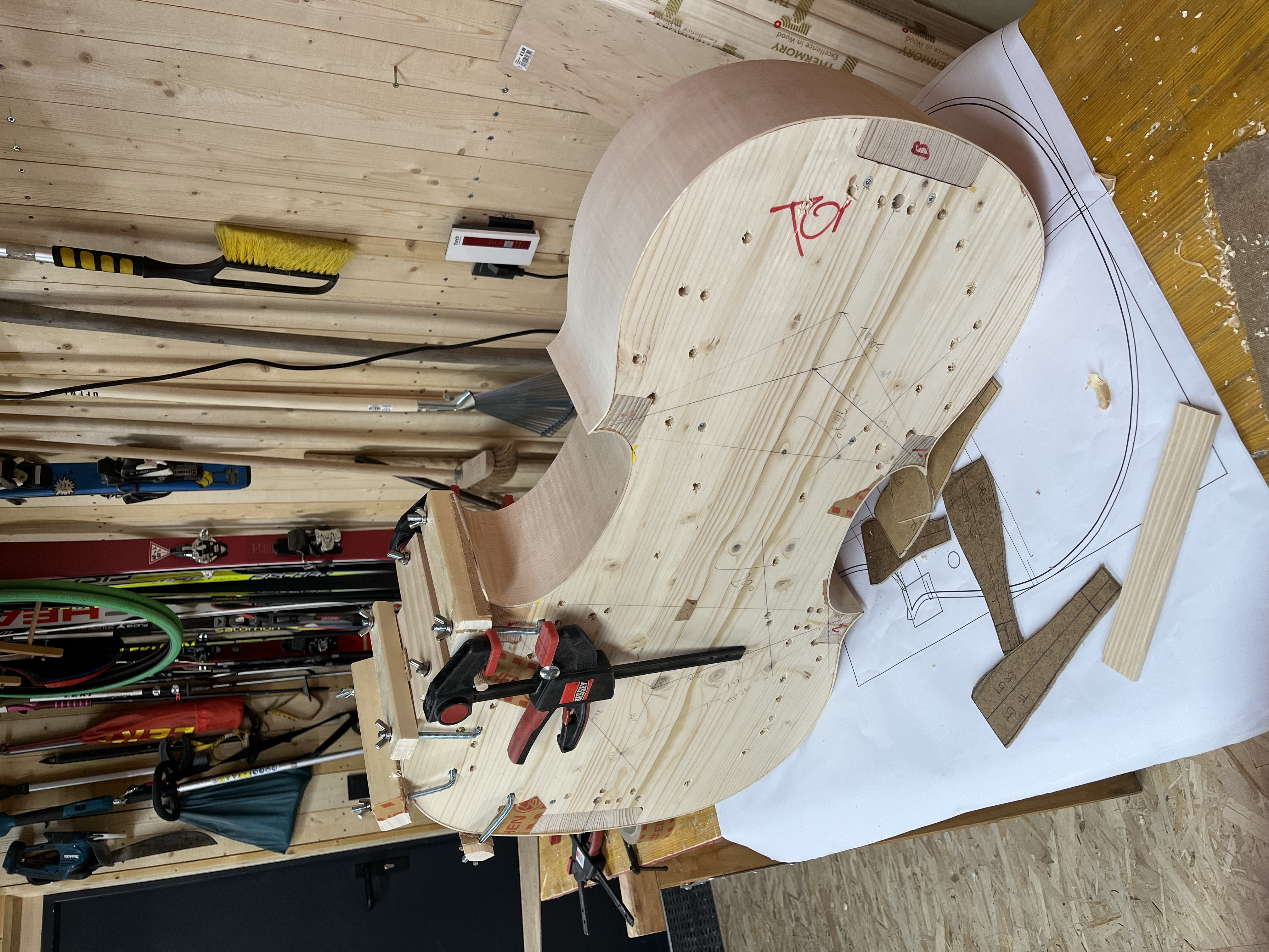

What I did:
-complete or almost complete the neck and scroll

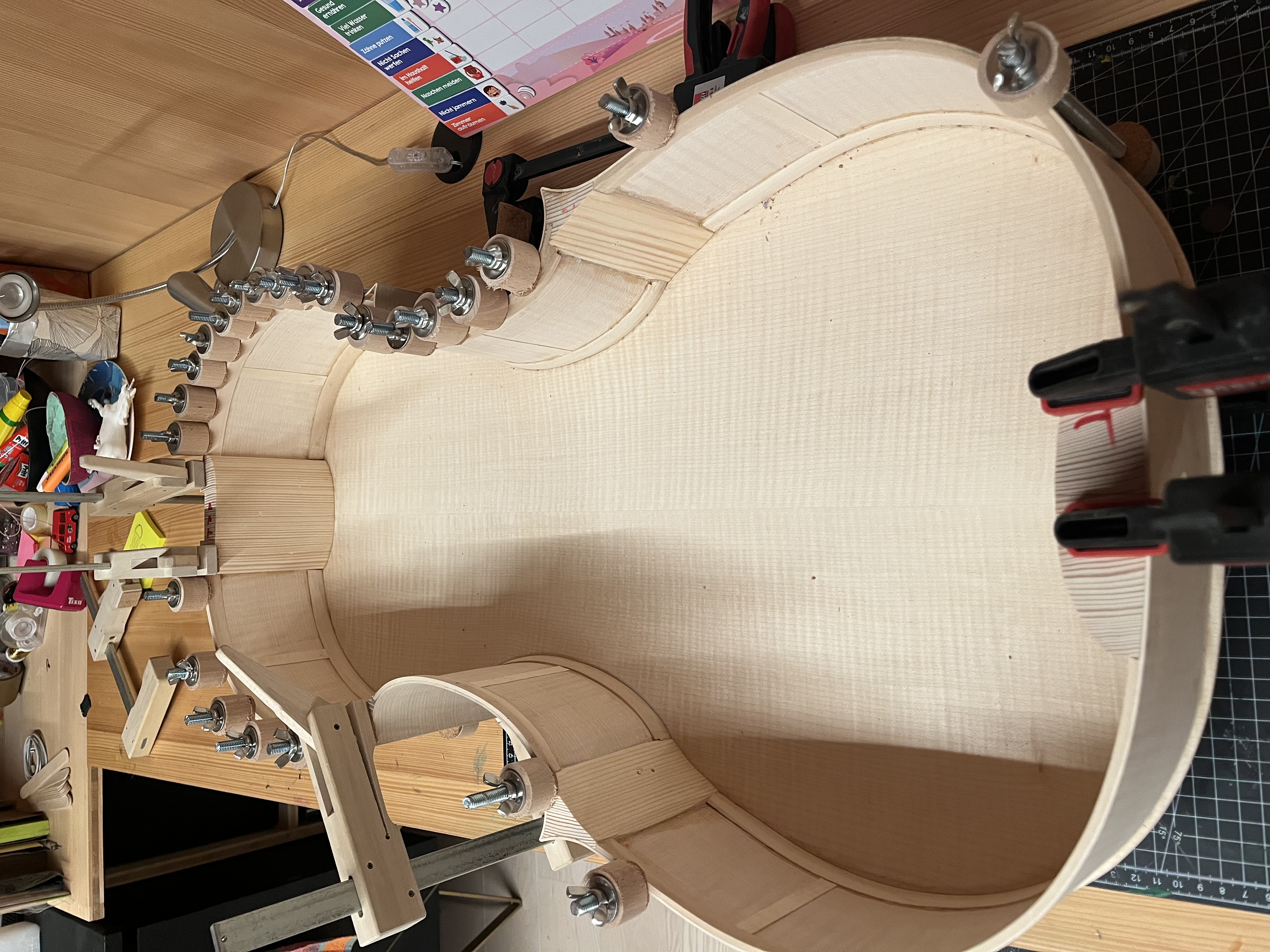

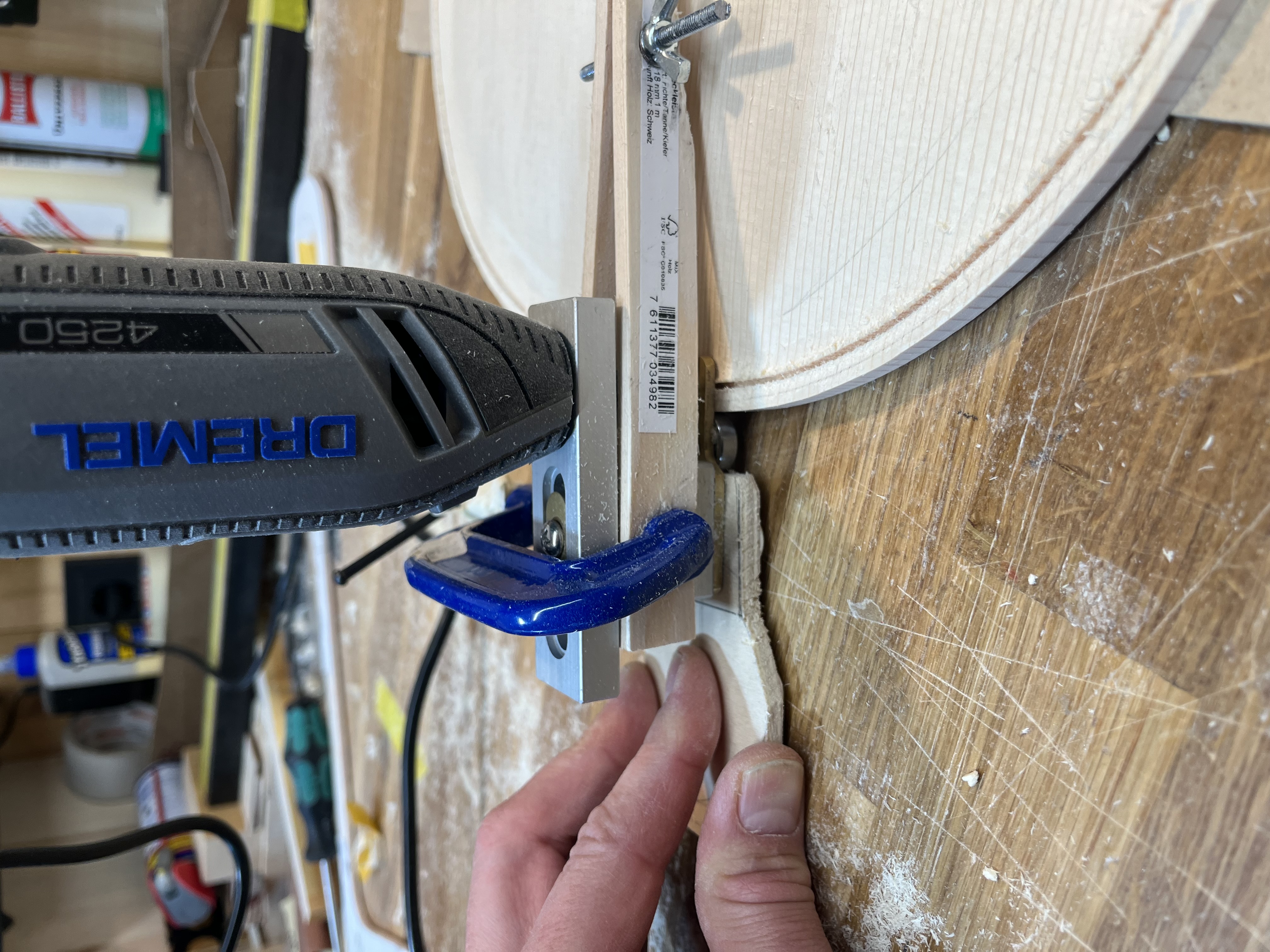

-complete the back with the arching and then the purfling (done with dremel router), graduation of the back
-I used the neck angle jig from robbie o brien to route the mortise for the neck, which seemed to work perfect- so far perfect angles...traditionally, this is done after gluing the back and the top on, with chisels, I thought I might try it a new way..
-glue on the back and start on the front, where I am now.
thanks for commenting!
Chris

I love watching the birth of this instrument. Thanks for the beautiful documentation. Your work looks very skillful and elegant, especially on the neck scroll. I am interested to see that you can graduate the outside arch of the top using the Safe-T-Planer, which would be a great way to hog off a lot of material to begin the shaping. I am trying my first archtop guitar top at present and I feel quite intimidated by this part of the build. I imagine that a guitar top would be so much smaller that the Safety-T-Planer might not be suitable? What wood species have you used for the neck and end block?

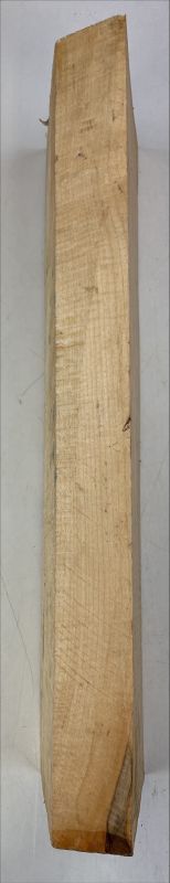

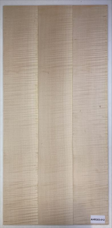

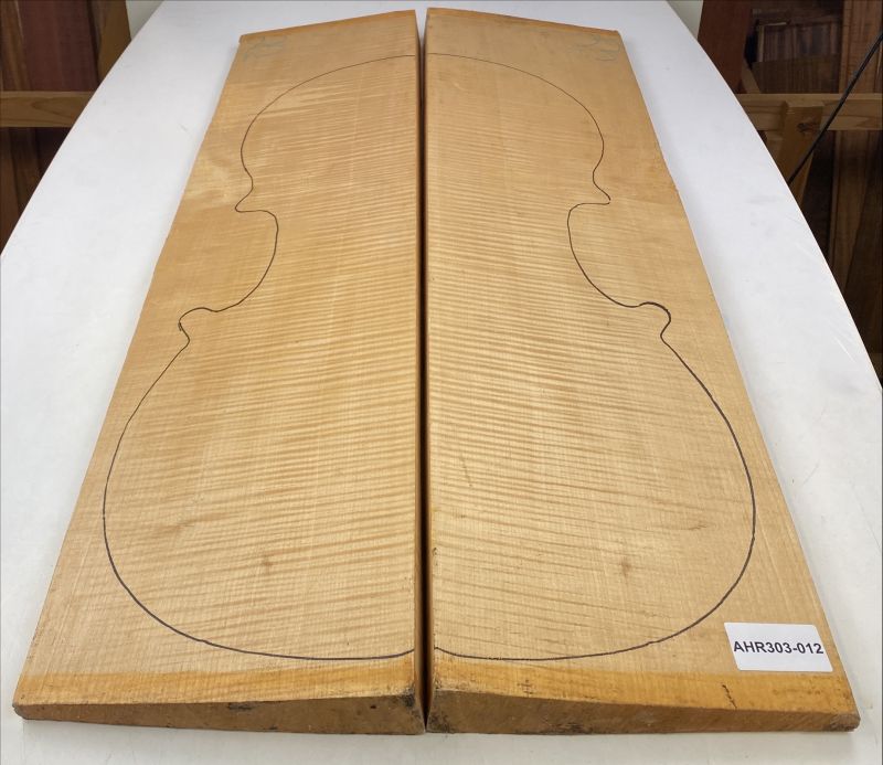

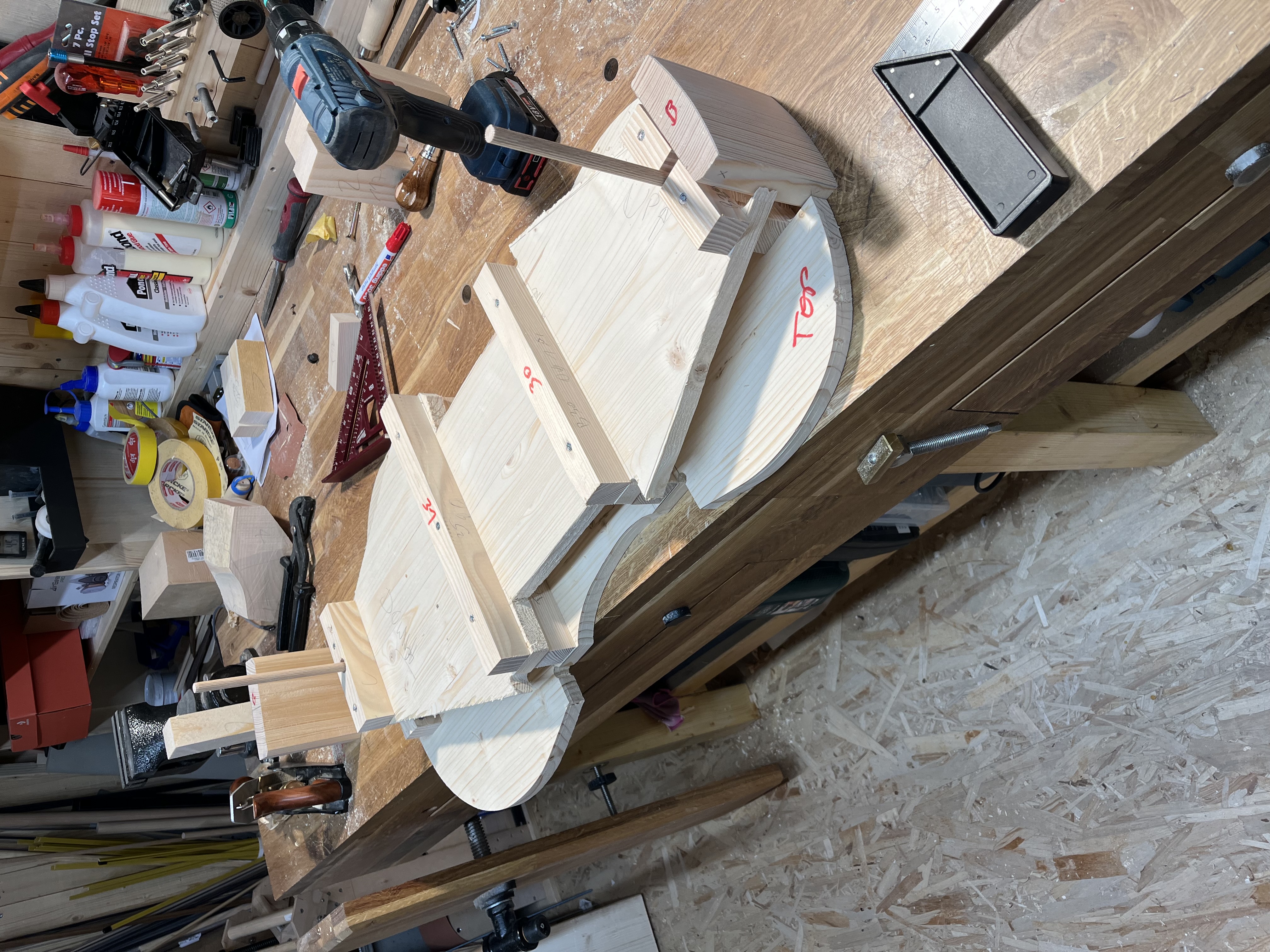

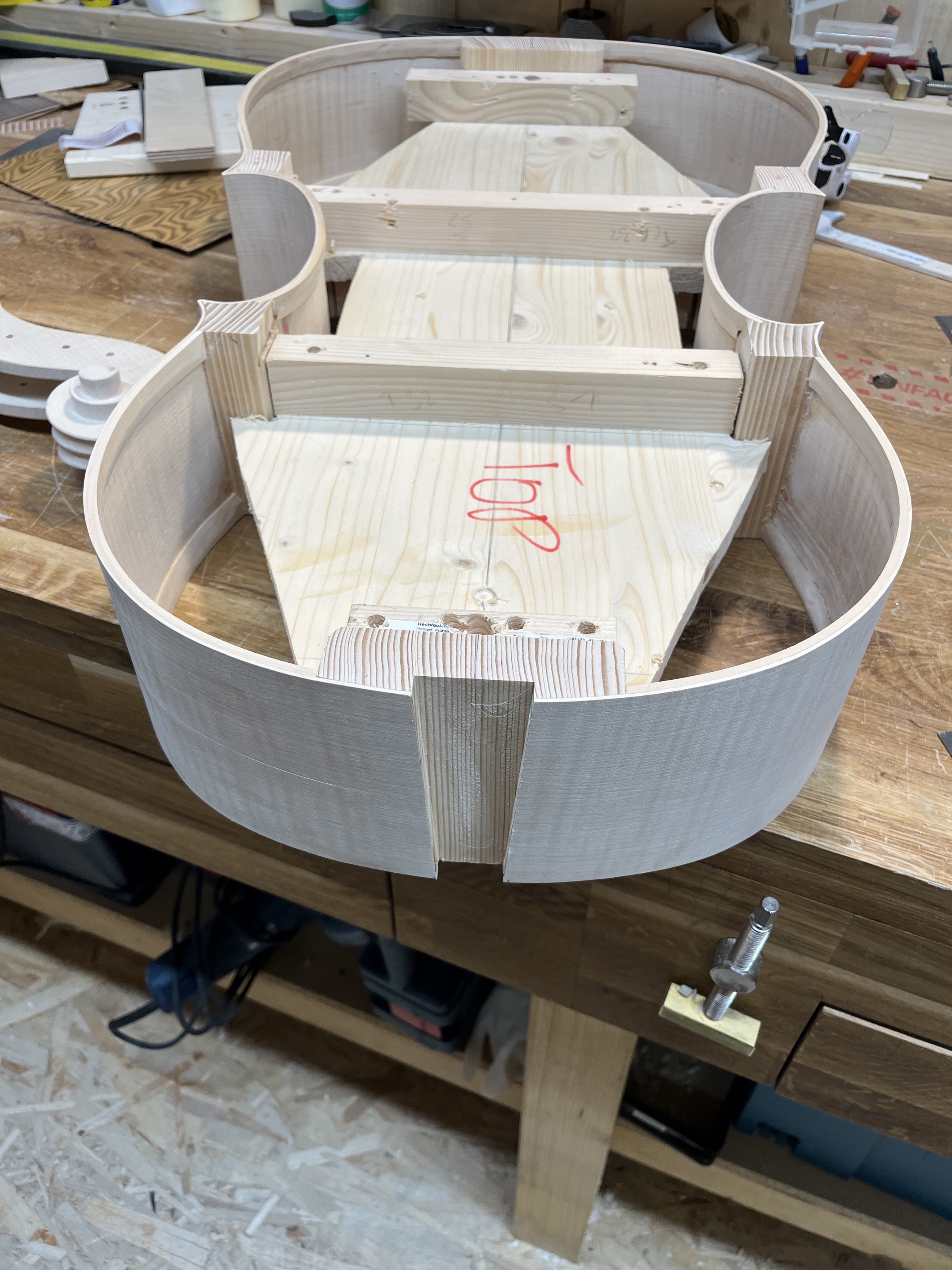

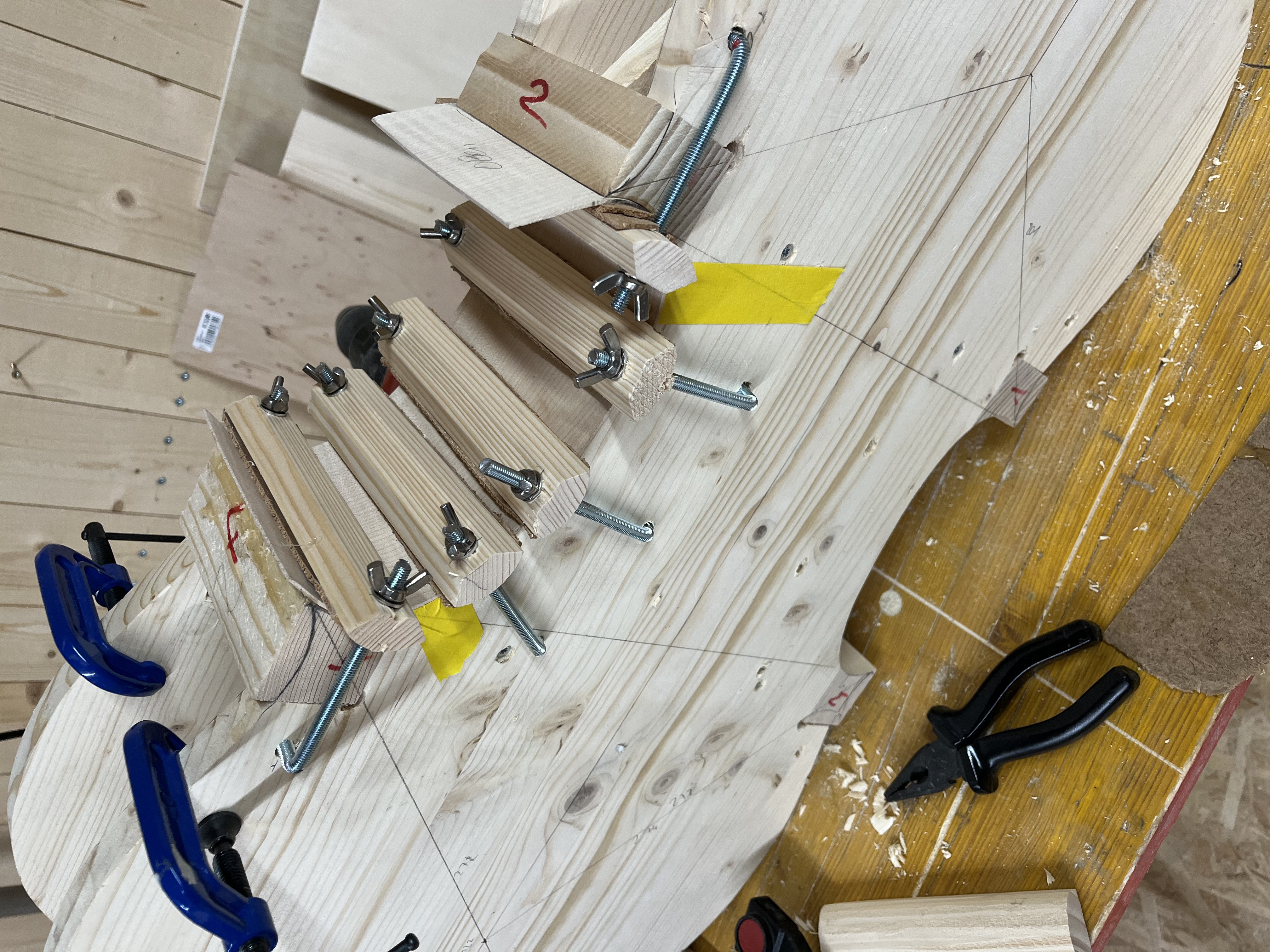

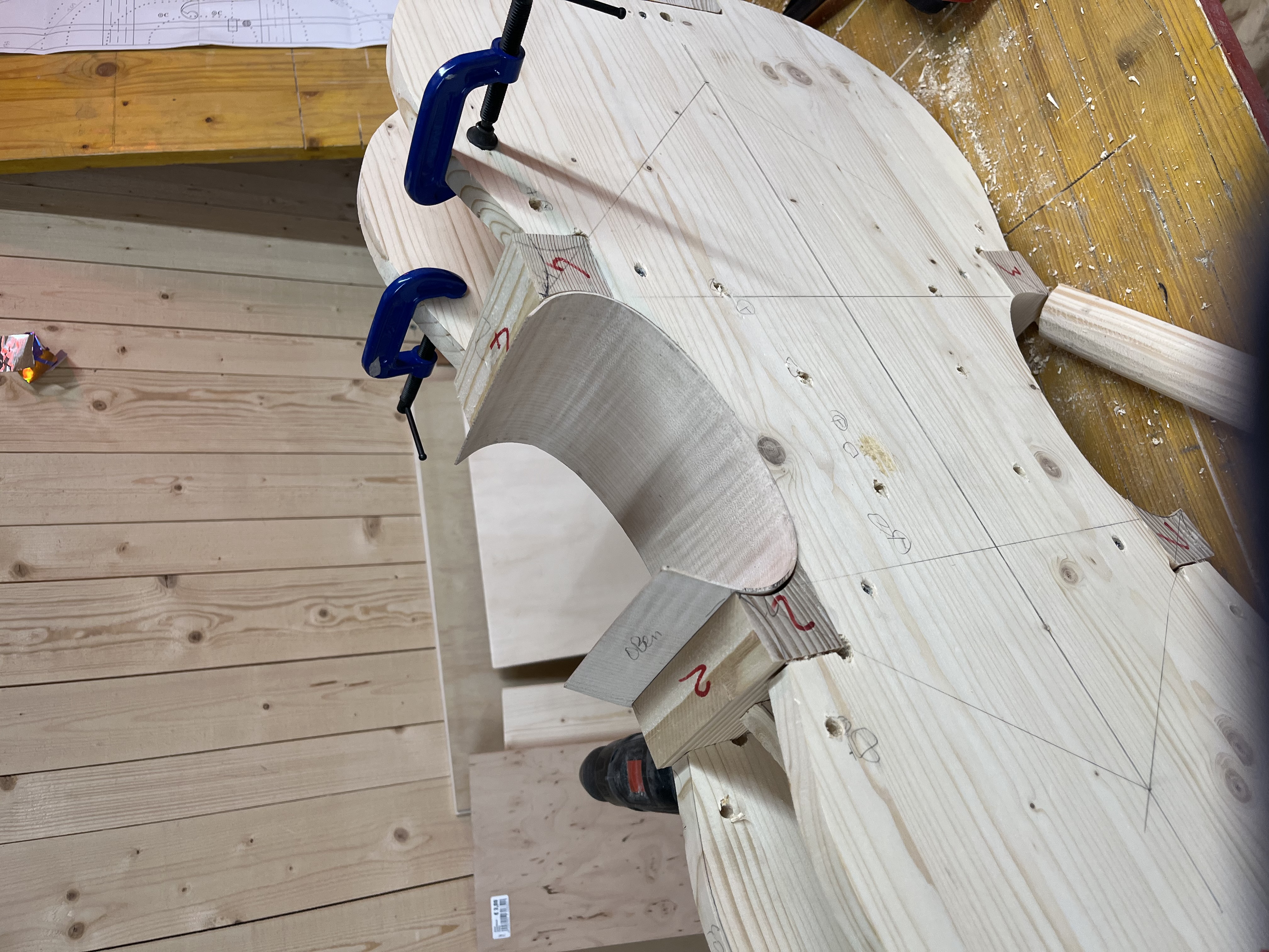

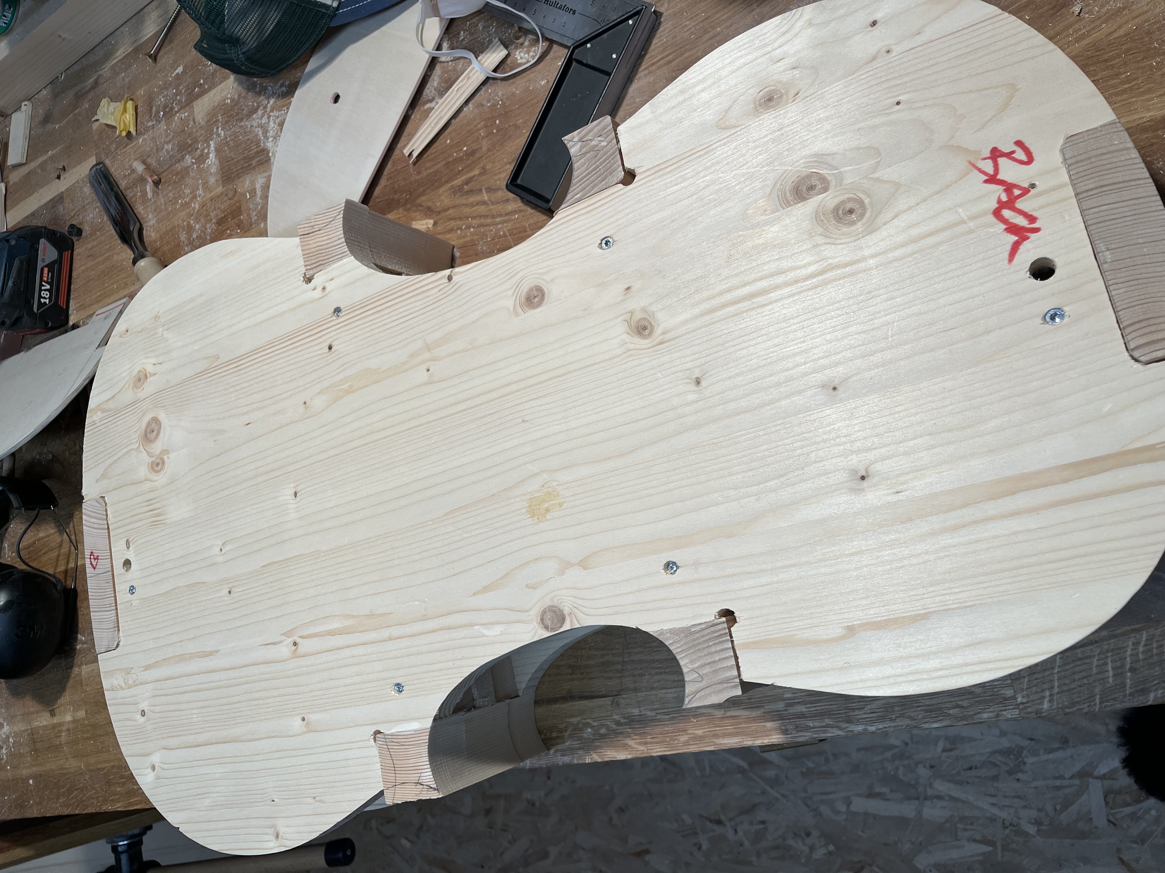

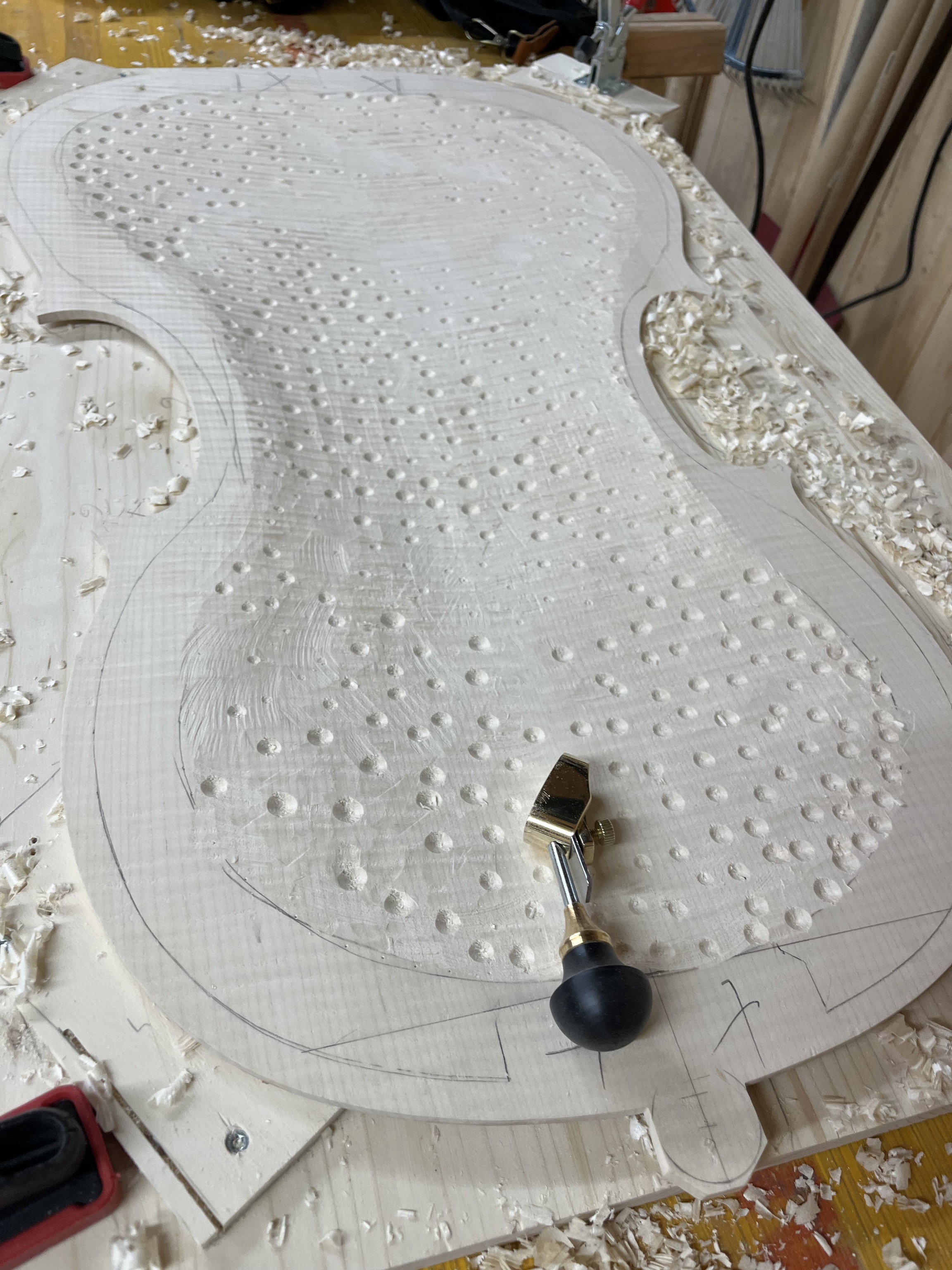

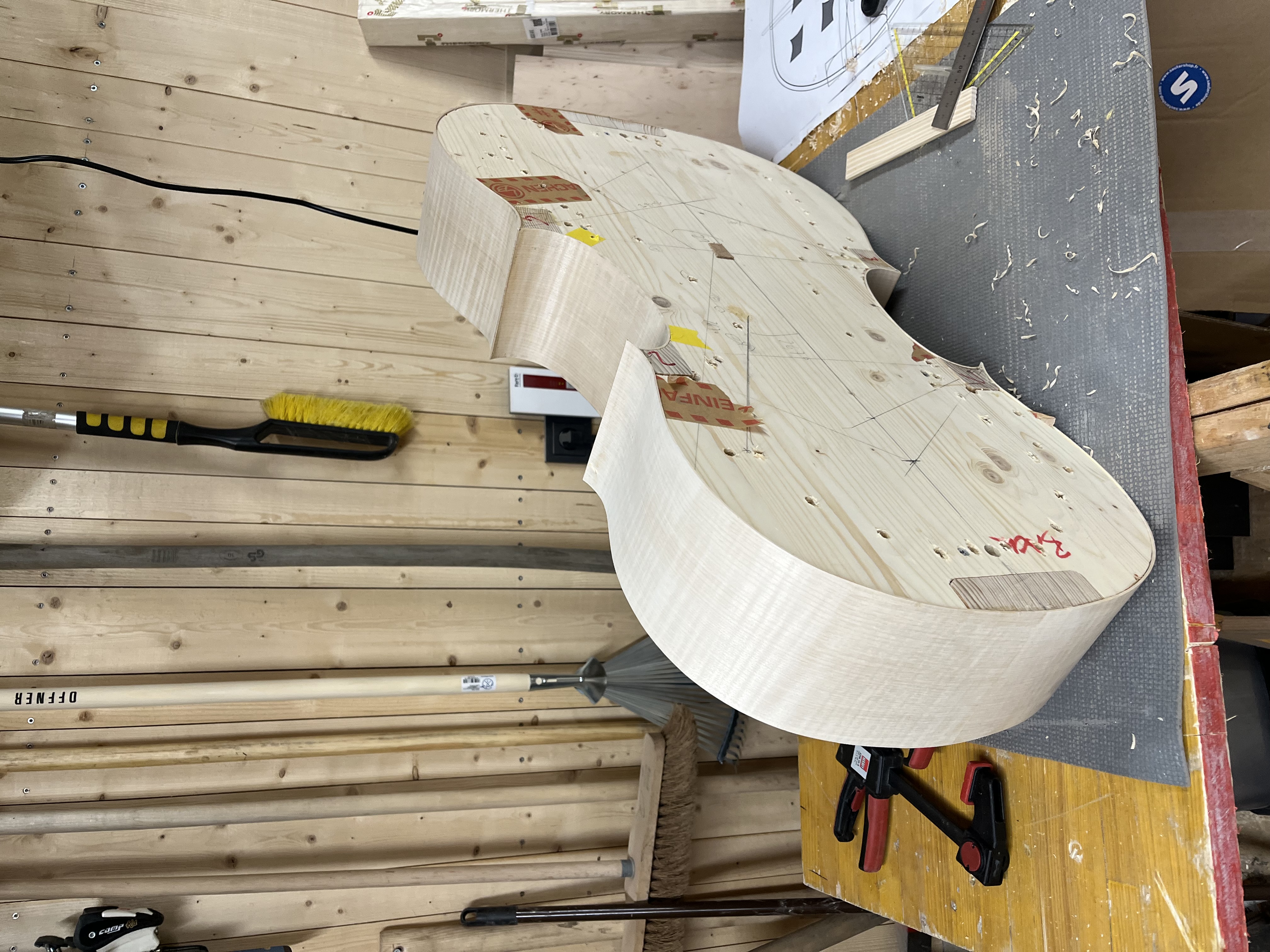

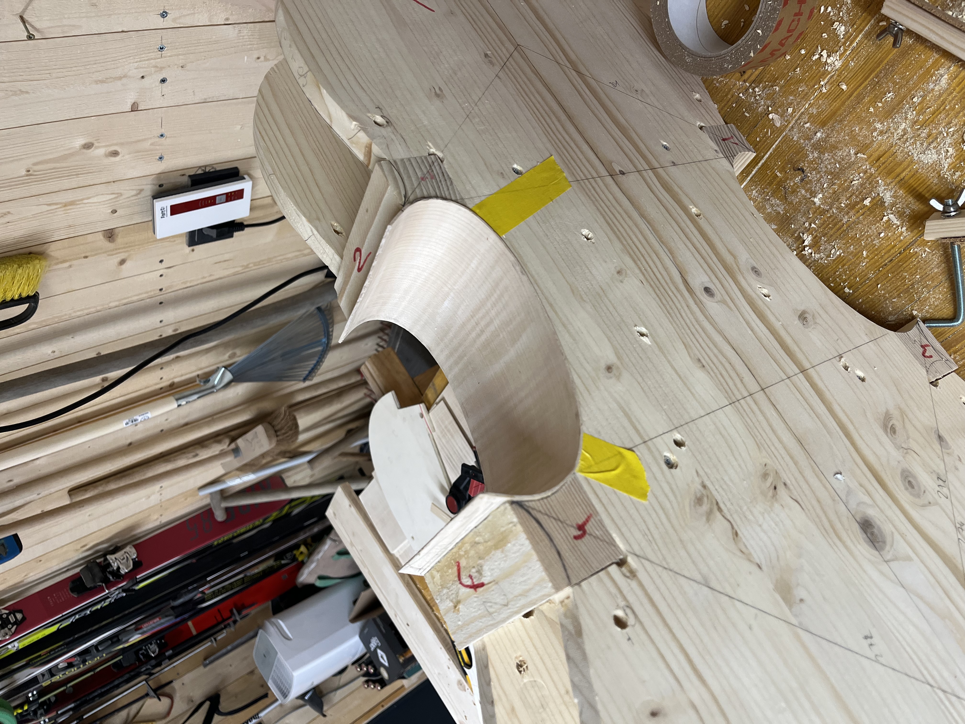

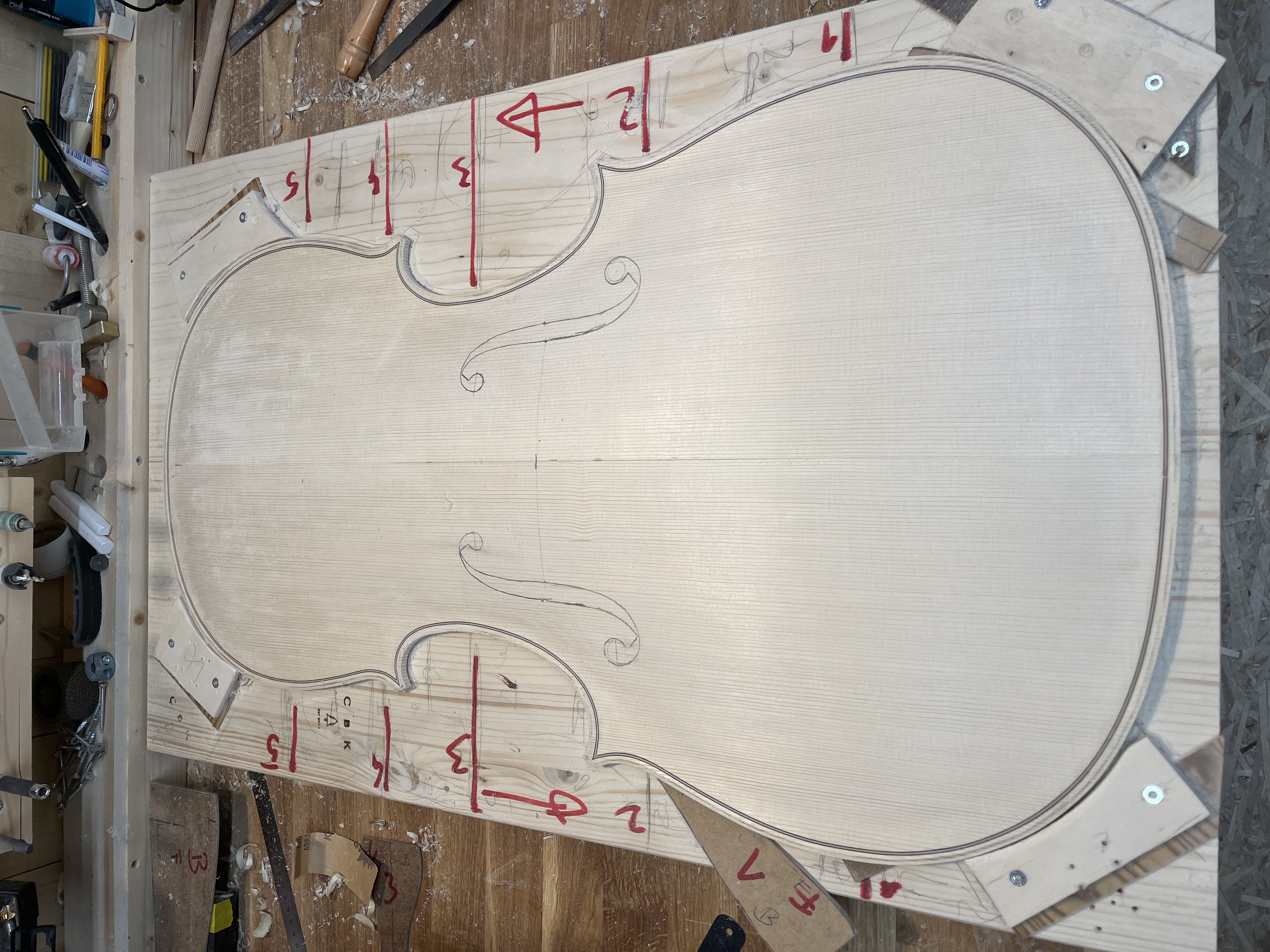

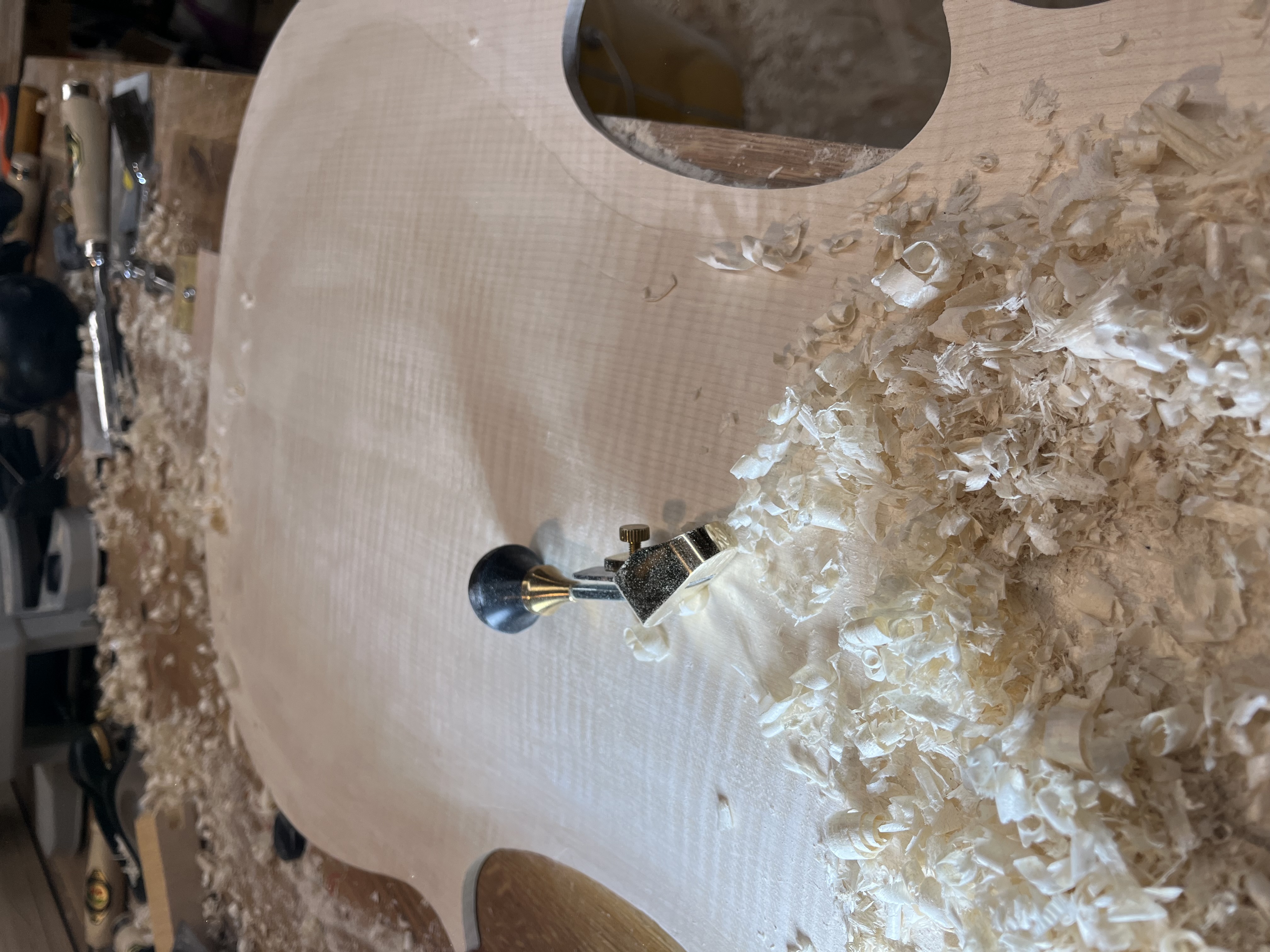

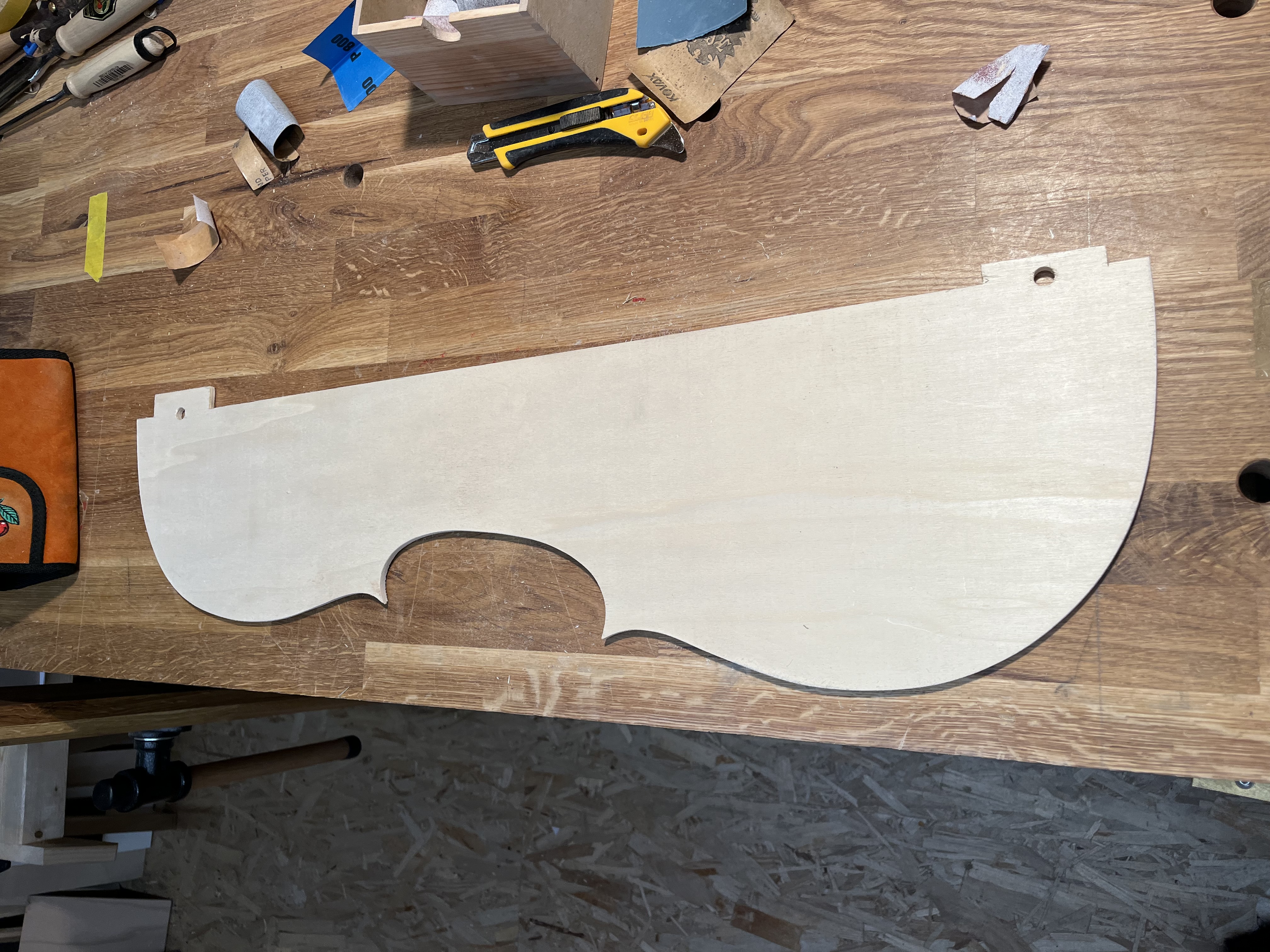

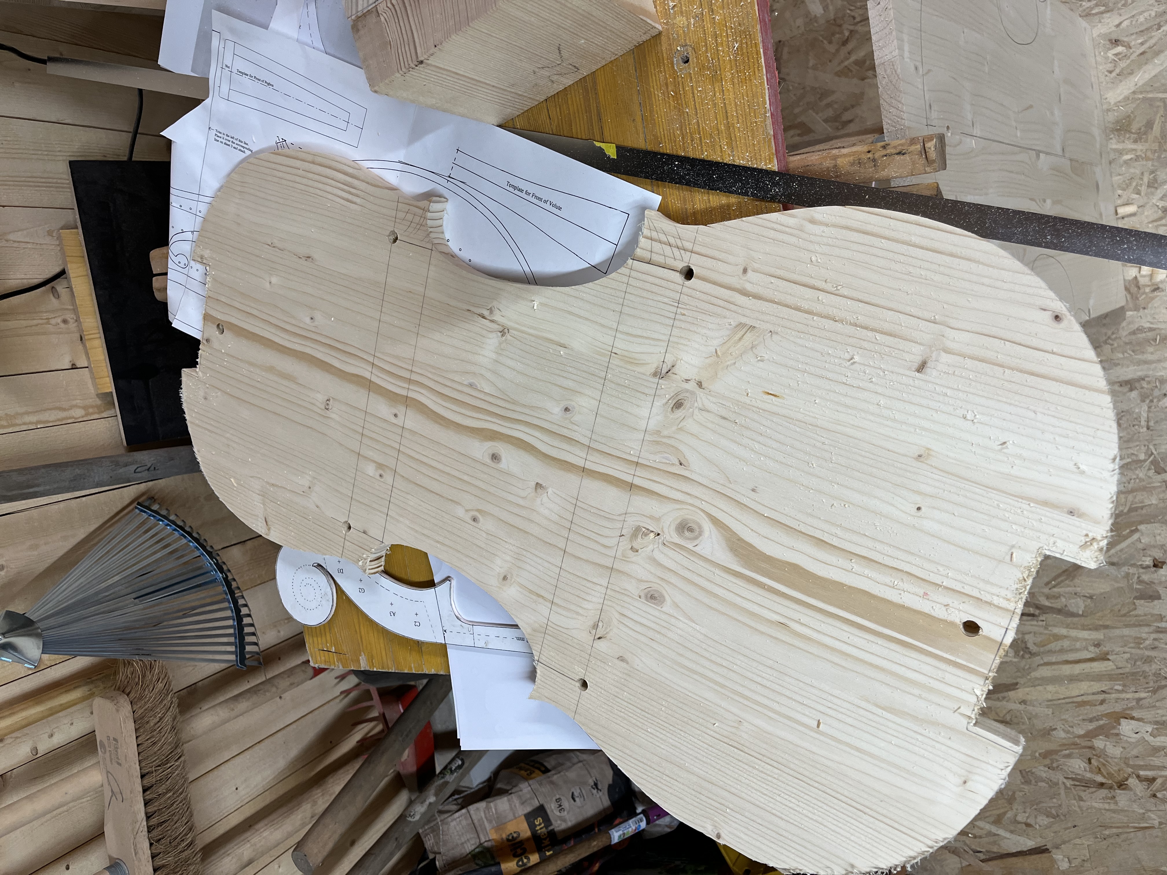

...small update from my work on the top,
also I added some fotos of the raw wood before starting my work

thank you dave, yes everything seemed very intimidating, but as for the maple, it doesnt allow you to screw up too much, because of its hardness, and then you have some practice for the soft spruce top, so it is agreat way to learn to work very careful, awesome!
Best wishes - Mark
thank you Mark for your kind comment. i was amazed myself, that the scroll actually turned out like a scroll!
using the safety planer was a great help, but still, it took a long time, mm by mm taken off, for archtop, i think you can also use it, or make graduation holes or whatever.
neck, sides, back are always maple, and top always spruce. almost no exception with bow instruments. the blocks are spruce.
