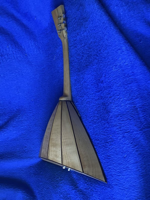

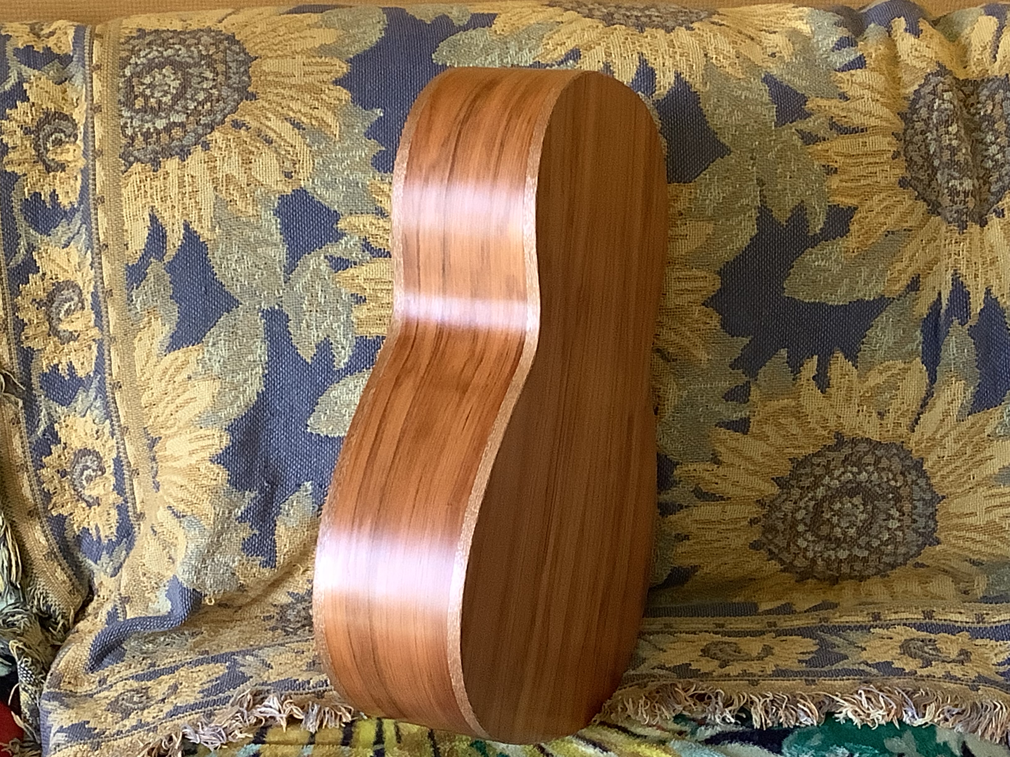

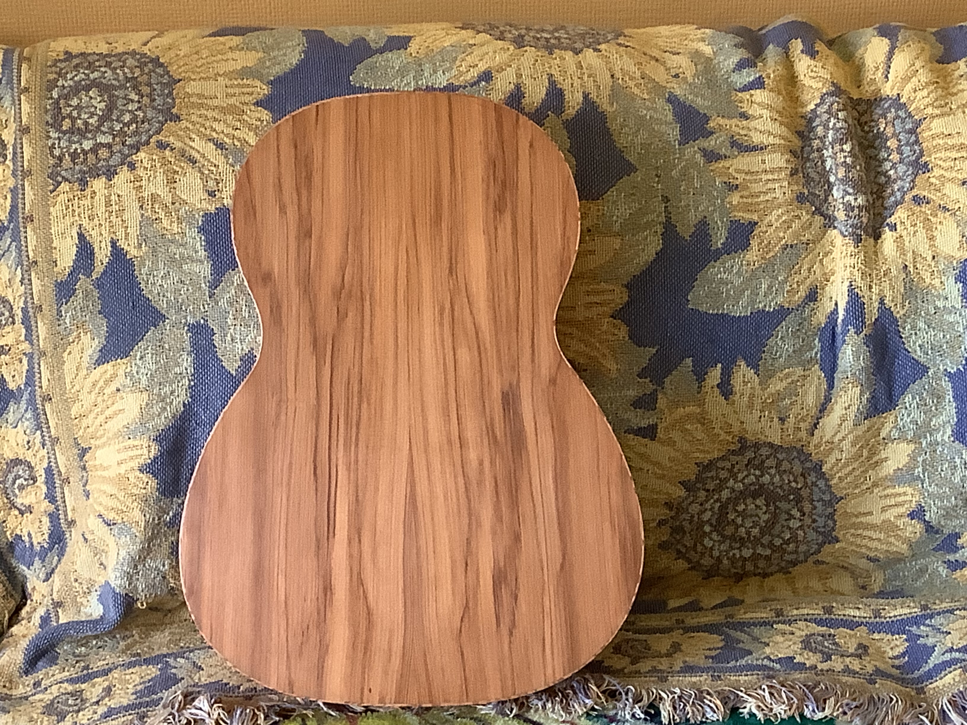

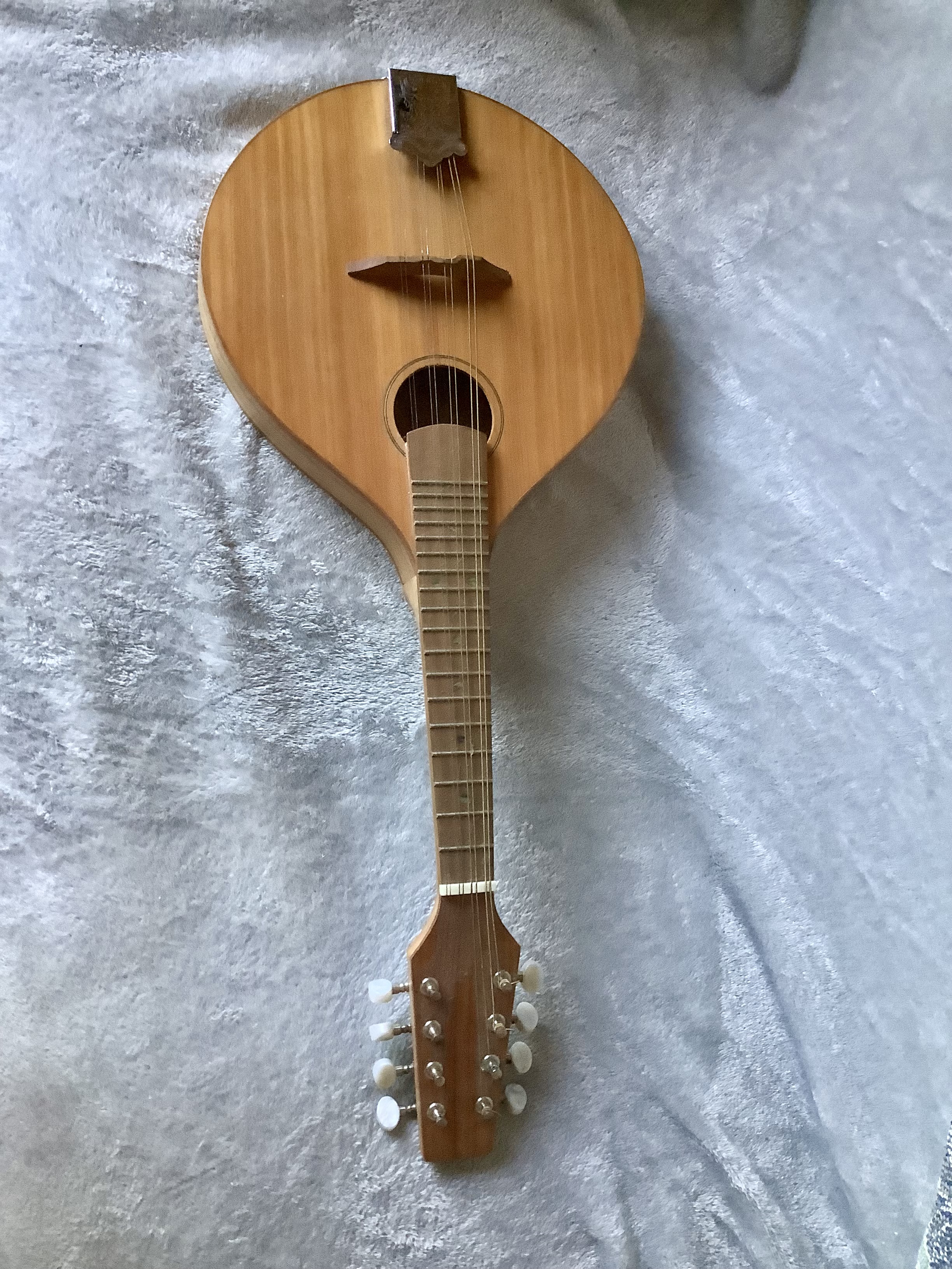

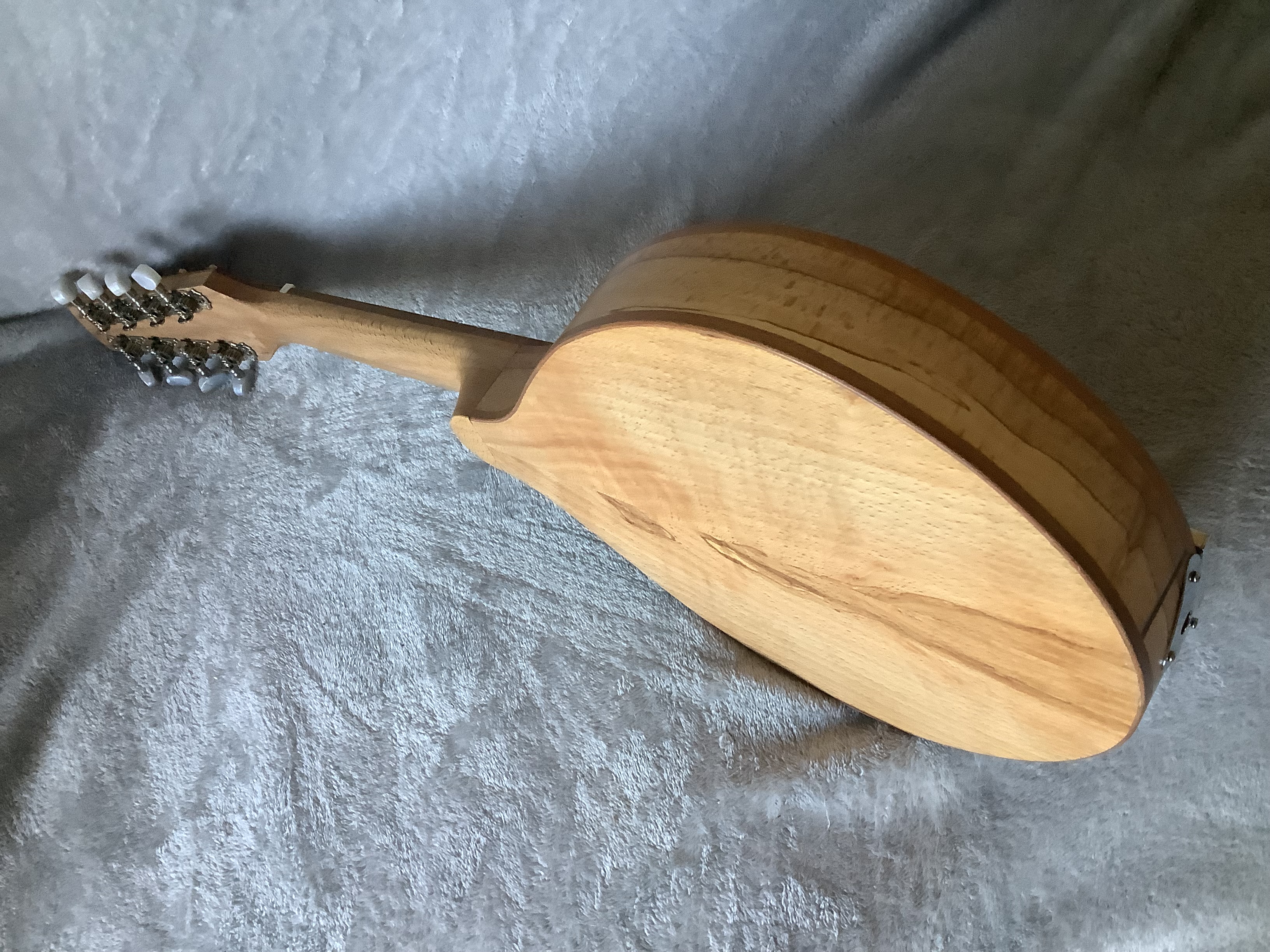

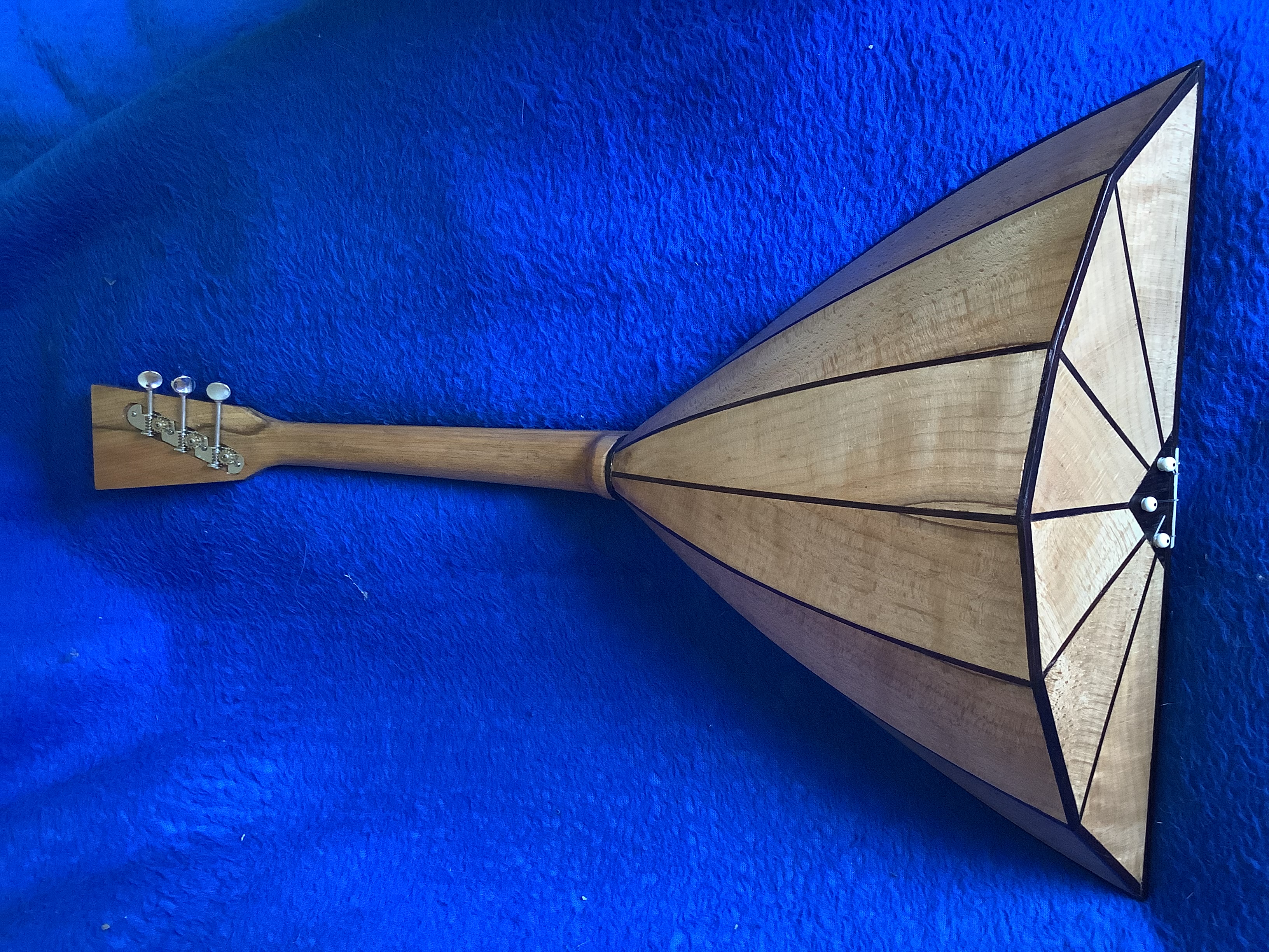

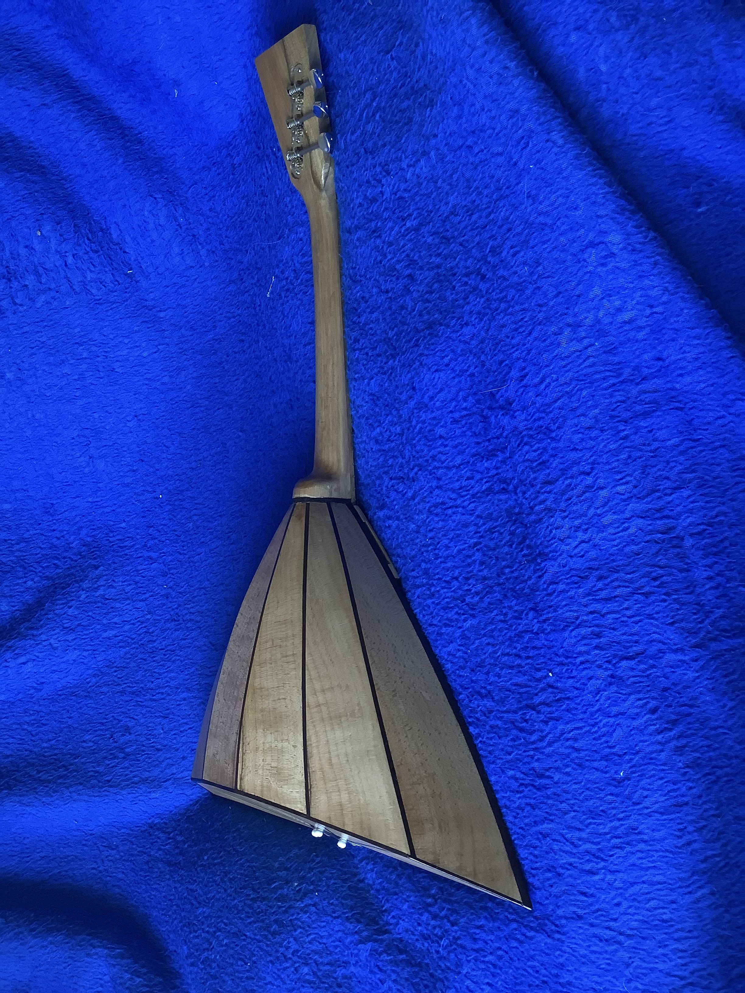

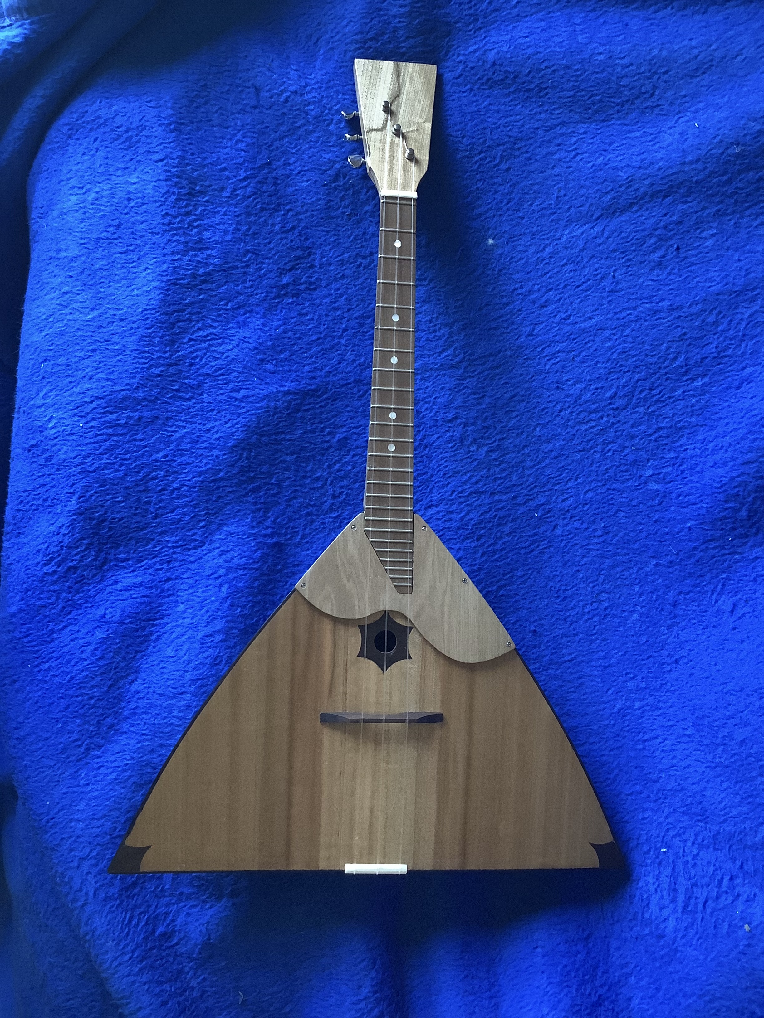

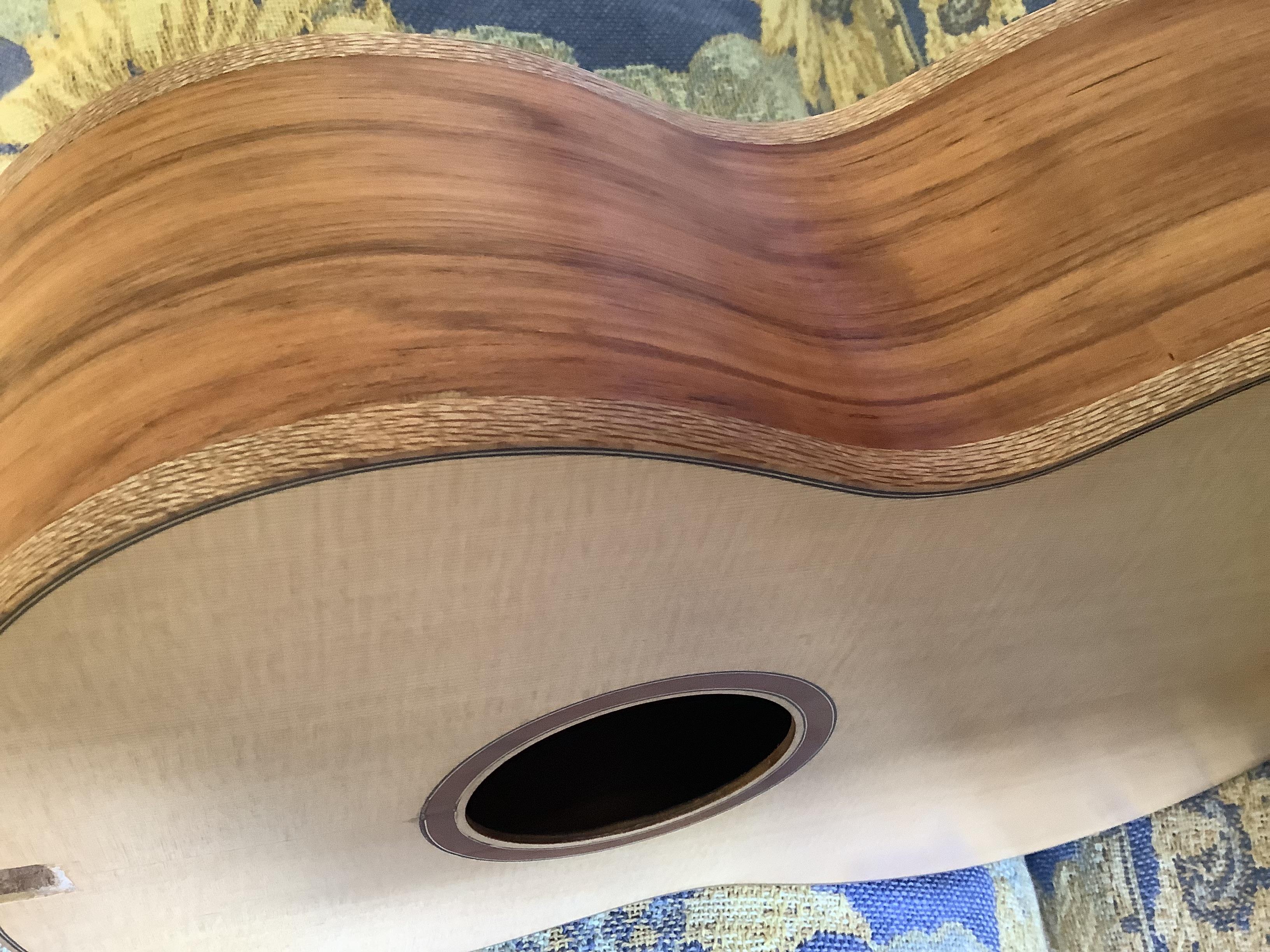

Mangeao top, black maire b&s
Rimu body, rewarewa bindings
Black maire b&s, matai top, river salvaged swamp maire fret board

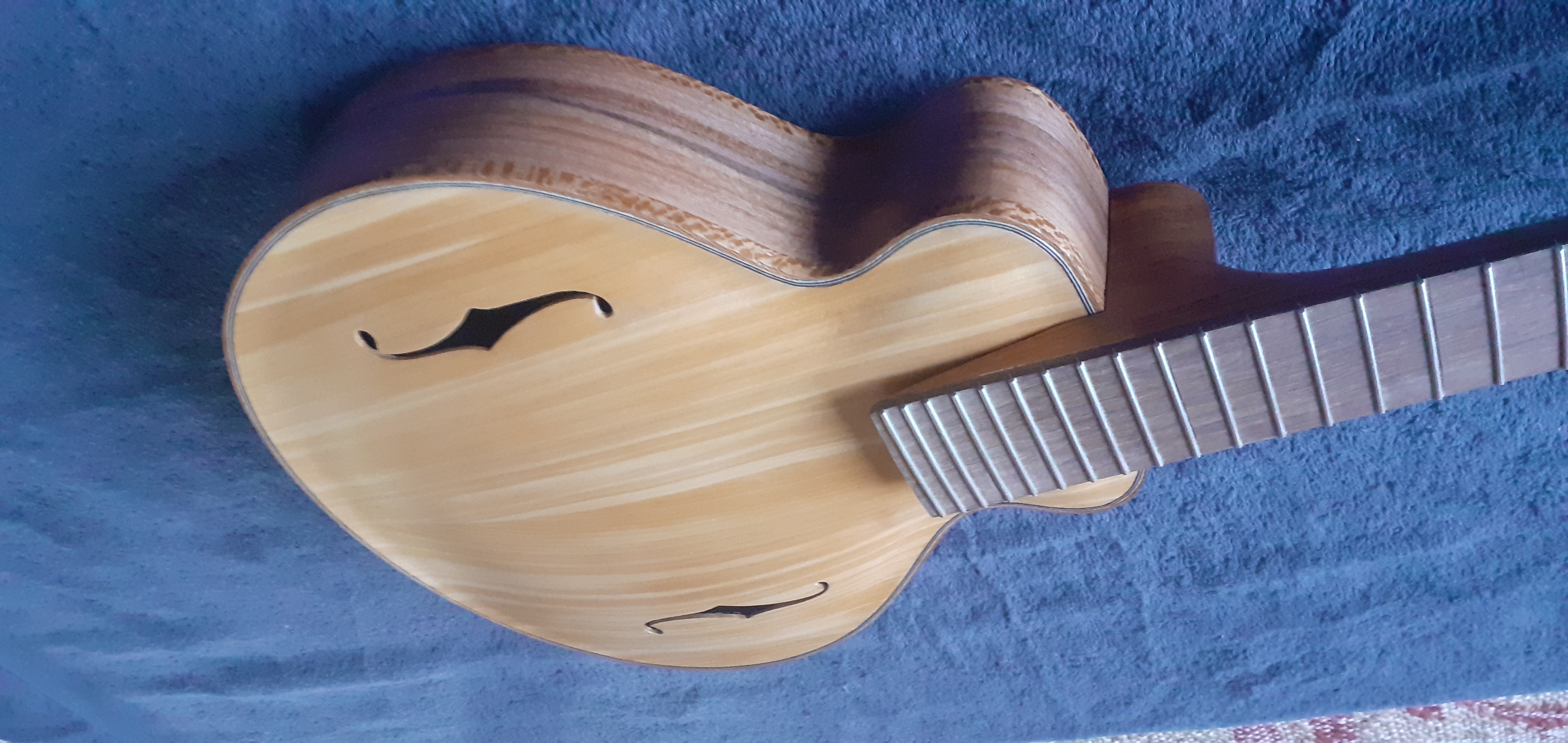

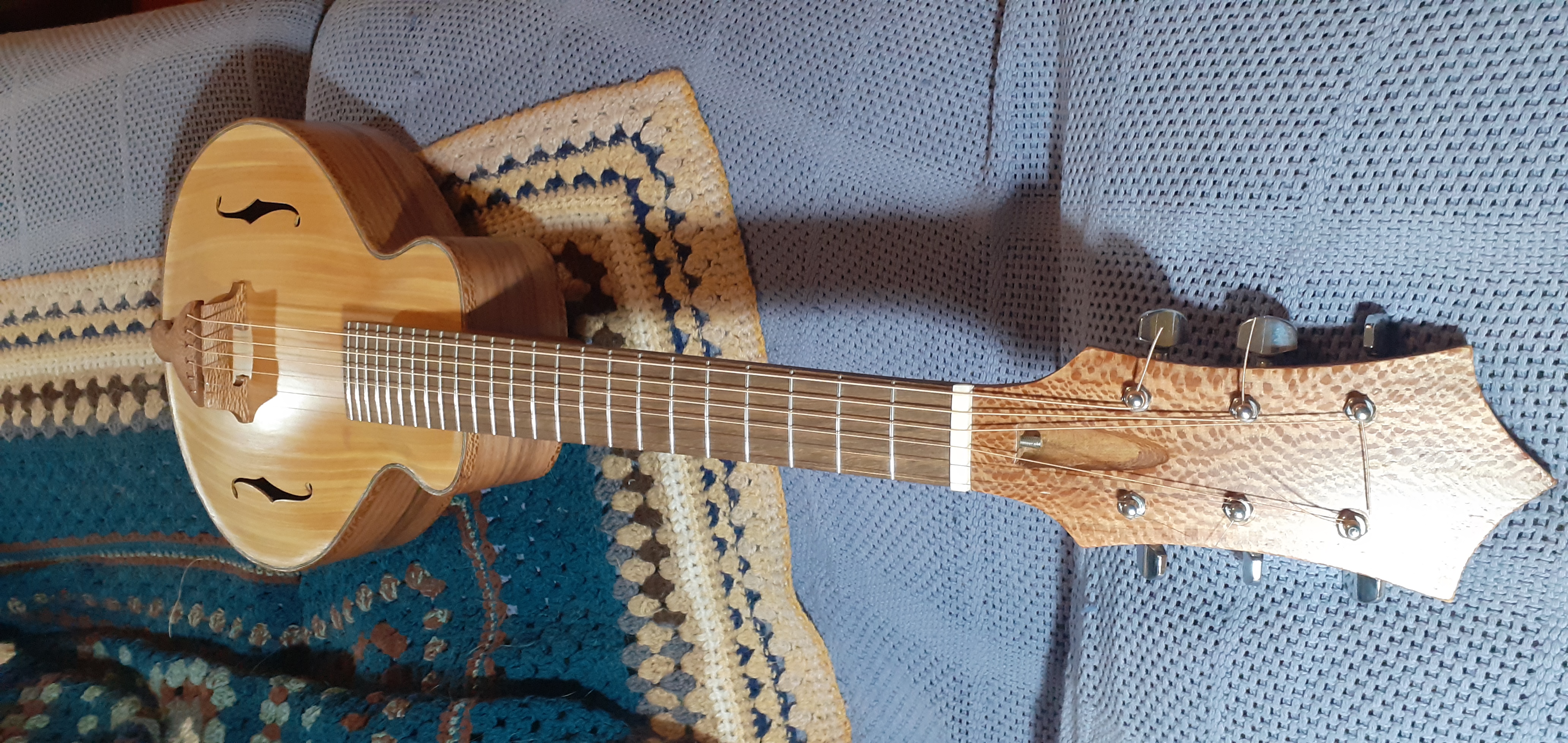

And a pohutakawa small body archtop.

Post by Andos » Thu Jun 12, 2025 6:21 pm
Damn predictive txt.
Archtop not arthropods
I don't even know what an arthropod!
