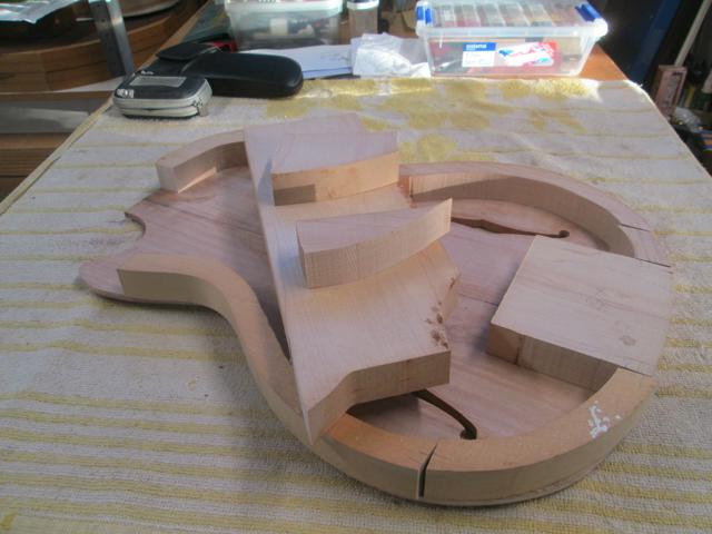

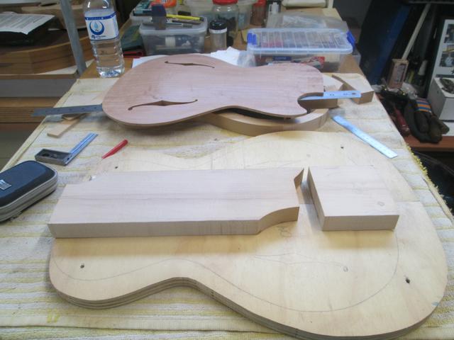

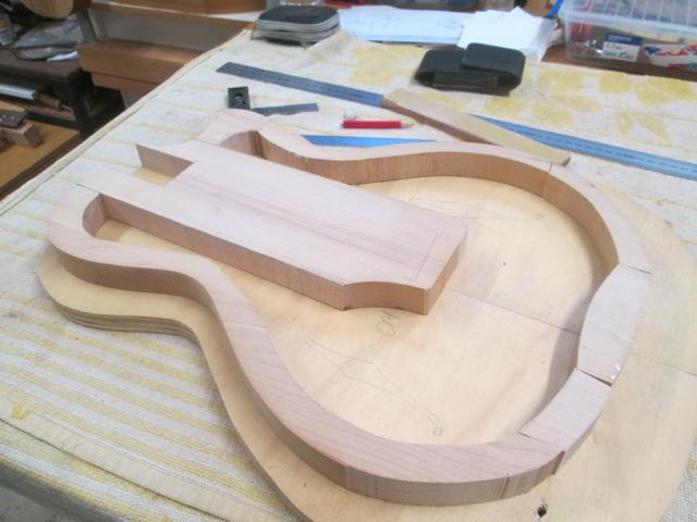

Another way is try and fins four pieces of pine say 20mm thick and laminate a top and a back. Cut out the shape of the PRS on the top and back and then find some pieces that will fit between these like a sandwich. If you need to weight reduce you can glue the middle bits together and maybe with a jig saw cut a hole in the middle piece. The picture tells a better story. With a top and a back 20mm thick you can have a go at carving. If you would like me to find the carving vids for you I can but just do a search in youtube Les Paul PRS carve and something will come up.
Contact me via our forum Private email service and I can send you a contour I just uploaded from the net.
Good luck Johnny, there is nothing more rewarding than carving a top and back. Noe easy though, patience my friend.

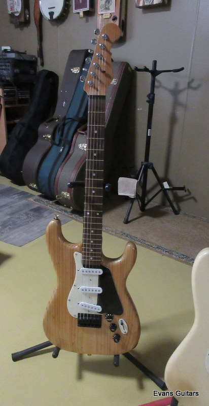

Here is a photo of a solid pine body I built to see what it was like. It is laminated. The neck is also Pine cut on the quarter, and is as stable as any. Taff
First, he practiced bending sides using MDF. Then he built the whole acoustic guitar body out of ply from Bunnings. He is now confidently but carefully building with solid timbers.
