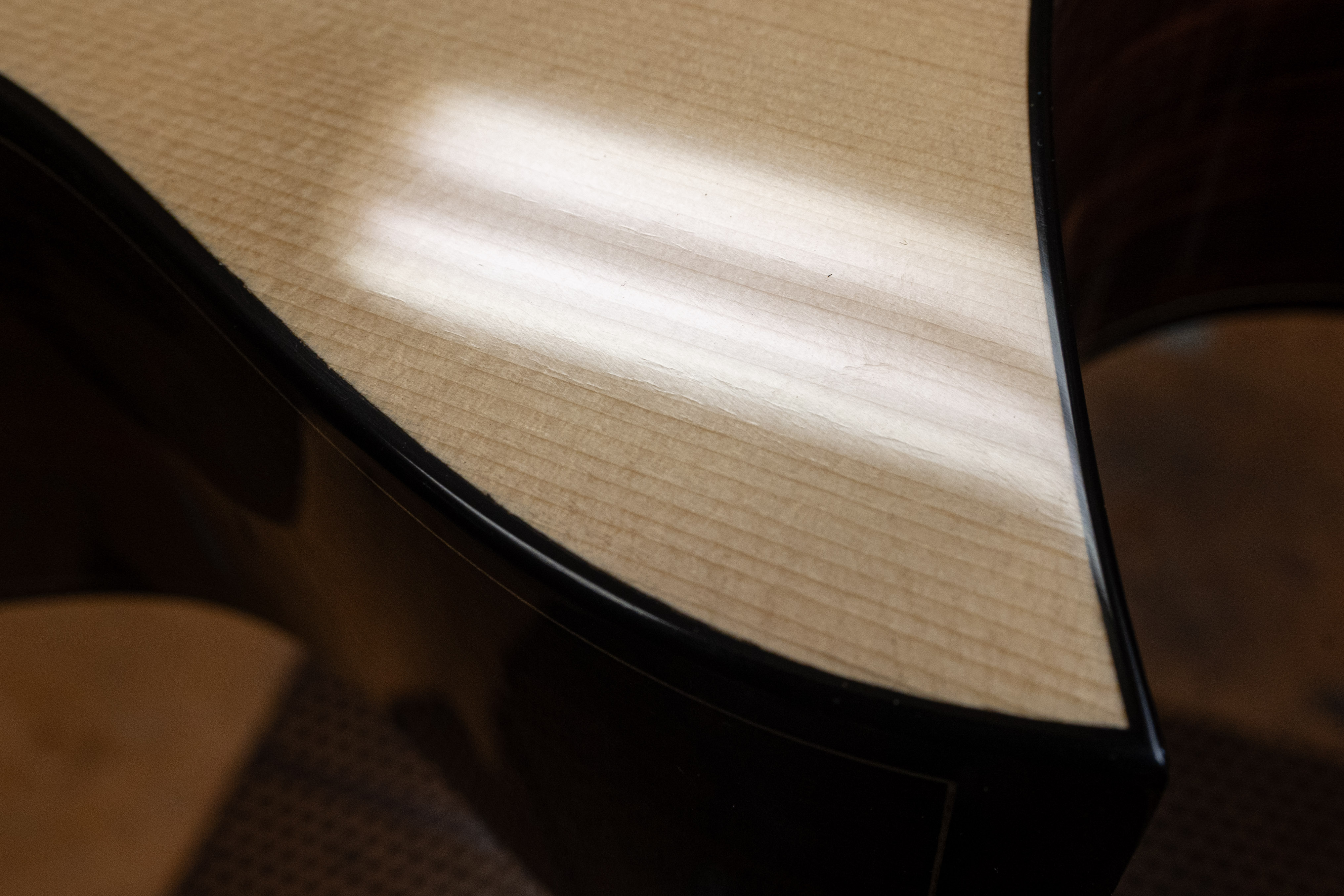

I'm doing a shellac finish for the first time and having an issue with what appears to be crazing. My application was I wiped on a bunch of thin coats of shellac over time until there was enough buildup to level sand and buff. It looked good for about a week, and then I noticed some micro cracks starting to develop in a few places around the top only. The back and sides seem to be ok.
Does anyone have an idea of the cause, and possible solution for this issue? Ideally I'd like to repair rather than re do the finish. And next time avoid it entirely.
I've attached a photo, not of my guitar but of one that has a similar looking issue but more sever than it appears on mine. You can see it around the reflected light. On mine it looks like the beginning stages of this sort of thing.

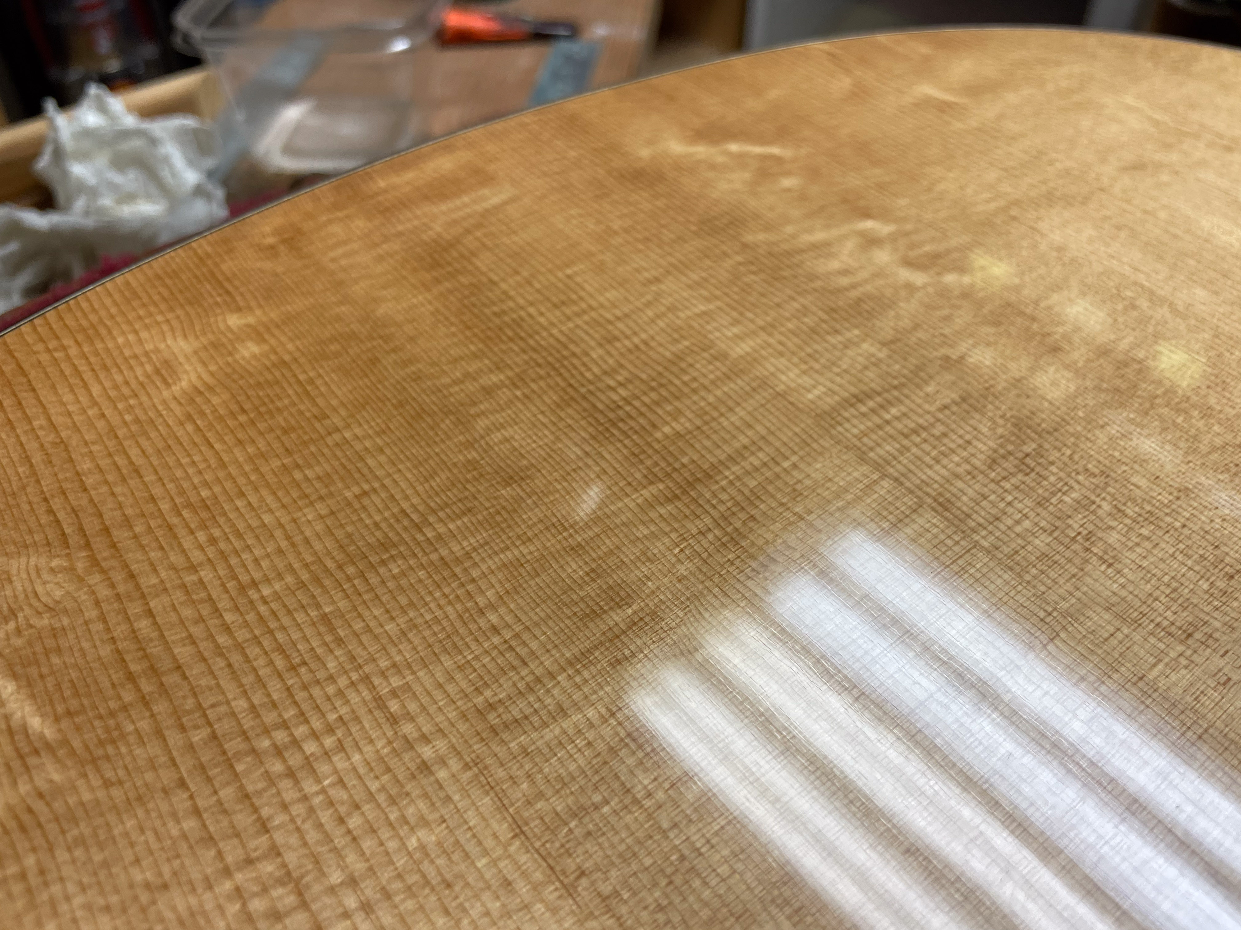

Here is the crazing on my guitar. It's really only noticeable in certain lights and was hard to capture in a photo. My plan is to sand it down until it looks like the cracks are gone, then re build up the finish more slowly following Alan's method. I wonder though if there's a risk that the lower levels of shellac would possibly appear ok, but would also be prone to crazing. Maybe I should go back to bare wood?
Re: Shellac finish question
Have you considered going over it with just alcohol on a pad and some pressure? It would be like spiriting off in a French polish routine. If it’s really only .002 thick it might do it for you.
It’s hard for me to imagine 24 coats of 2 pound cut being only .002 thick, but I’ve been wrong more than once, it’s hard to admit though.
Nothing to loose really since you’re considering sanding back anyway.
You make a good point Jim, I'll try that first. There was a bit of sanding in between coats which made things thinner.
