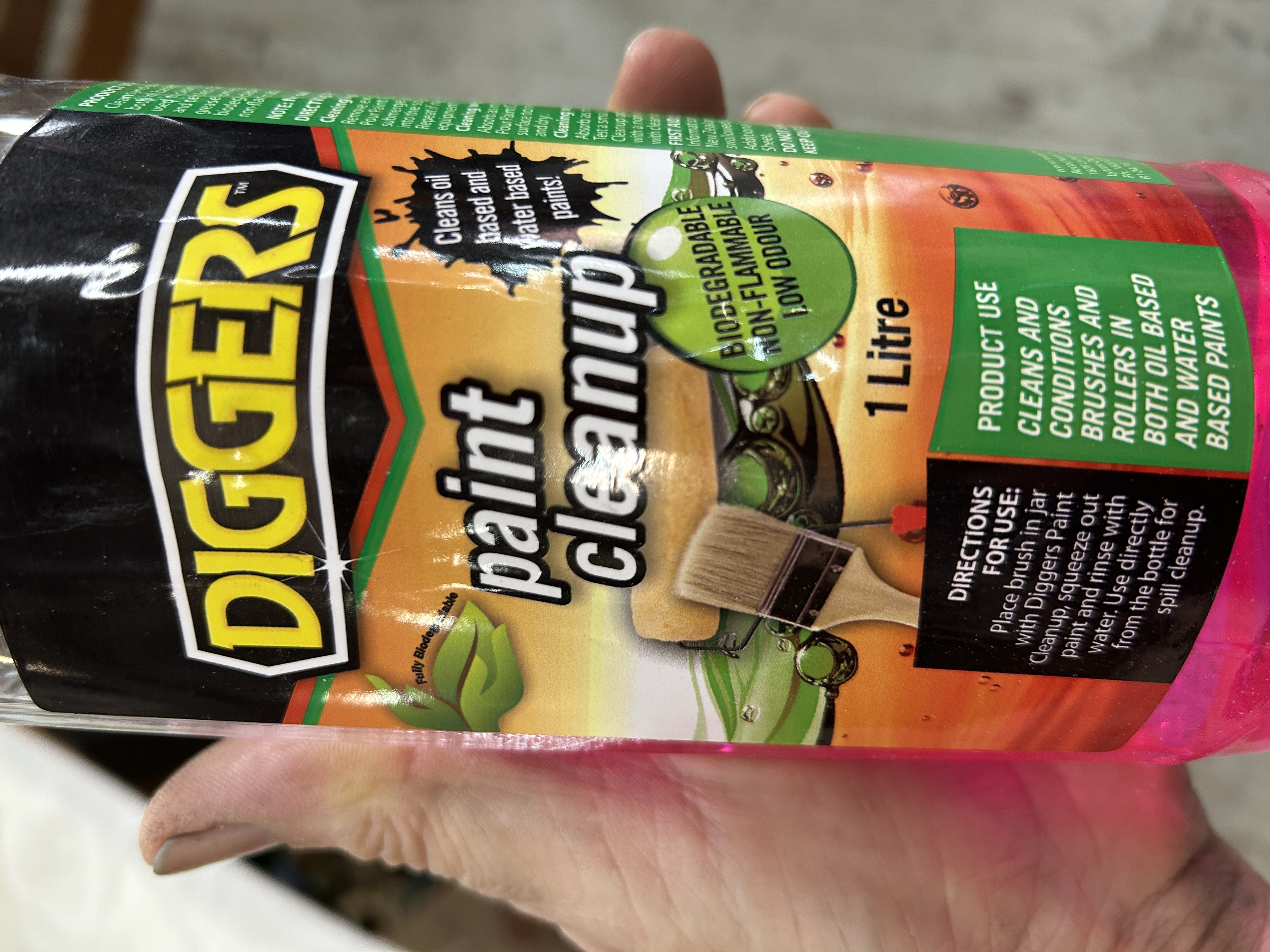

i've been using "diggers paint cleanup" as a stone lubricant instead of water.
It's fantastic, clears out all the clogging accumulated steel residue as you go and make for a really clean stone that cuts faster.
I dropped a bit of food colouring in to make it look pink and keep some in a spray bottle next to my 400/1000/3000 stones.
A small thing but we've been finding it a bit of a game changer here.

Thanks for the tip Matthew...will give it a go.
Info on the product here: https://diggersaustralia.com.au/product ... t-cleanup/
