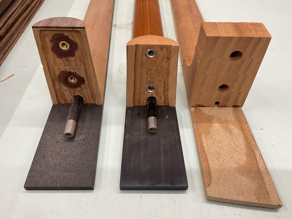

Post by Mark McLean » Fri Feb 28, 2025 11:09 pm
On the OLF forum Ed Bond recently posted a nice photo to illustrate that idea of slightly routing out the centre of the heel and leaving a rim which is the actual mating face against the guitar body. It would be a real pain to try to floss the entire heel block to get the right angles but this makes it manageable. If you are using threaded inserts for bolts you need to install them deep enough that you can rout or carve out some stock without hitting them. (Threaded inserts are not my favorite hardware, I prefer barrel nuts).
