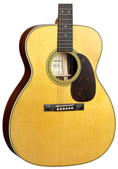

Hi,
I am adding a G octave string to my latest OM build as per Martin's M7 Johnny Marr .
Any suggestions on spacing the nut?
EG I was thinking of marking it out as per a regular 6 string, then splitting the suggested (StewMac?) .070" between pairs (12 string) either side of the regular G location.
So it would be about 1.778/2=.89mm either side of the 'usual' single G.
I hope this makes sense.
There may be some trial and error to find the best comfortable fit.
Any suggestions appreciated
MK
BTW FWIW Martin don't seem to add an extra pin at the bridge-they just run the paired G from the same hole
MK

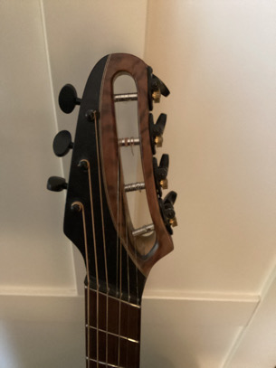

This is my seven string headstock. Seeing it won’t help you much because I did some unconventional things that you probably don’t want to copy - half slotted and half solid peg head, and it is fan-fret multi-scale (just for the fun of doing it, not because it is better). Also has a zero fret.
It might be a good idea to find some pictures online of the headstock and nut area of the Martin guitar and enlarge it and print it so you can take some detailed measurements of how they do the string spacing. It is interesting that they have updated an idea that was actually around in the 70s or 80s as the Roger McGuinn signature HD-7. I guess the younger generation now has never heard of the Byrds so it is a sensible marketing decision to reissue it named for a newer generation guitarist who also likes jangly sounds.
If you haven’t already done so, plot out the path that the strings will take from those tuner positions to their respective nut slots and make sure the angles are OK. Will that 4th string (the octave G) get to the nut without bumping into the post for the other G?

LOL.....looks like must have been some serious mind altering substances while designing that headstock!!!
- Posts: 1174
Re: 7 String spacing
Just some of that nice stuff that comes from your neighbors in the Adelaide Hills
Mark-
That headstock is pure genius......
