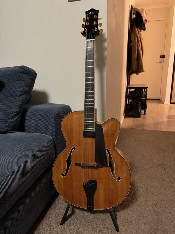

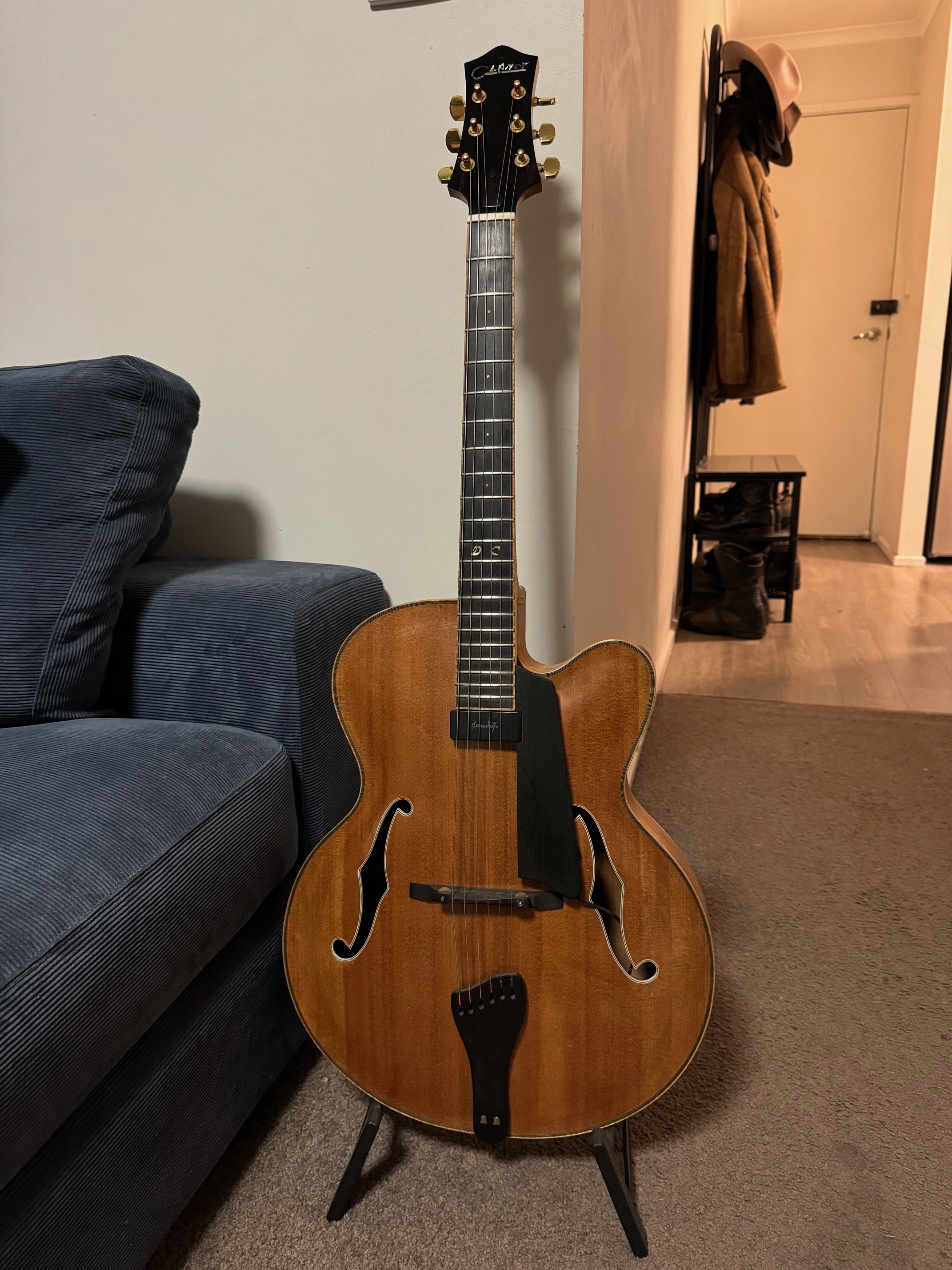

I've used Qld Kauri for the top.
It's now around 15 years old and I'm still impressed with the acoustic sound of it.
Never broken the halves & re glued, sorry.

Thanks Craig and Wayne,
That's a beautiful looking build Craig - could you describe the tone? Is it cross braced or other, and do you remember what thickness you went to?
