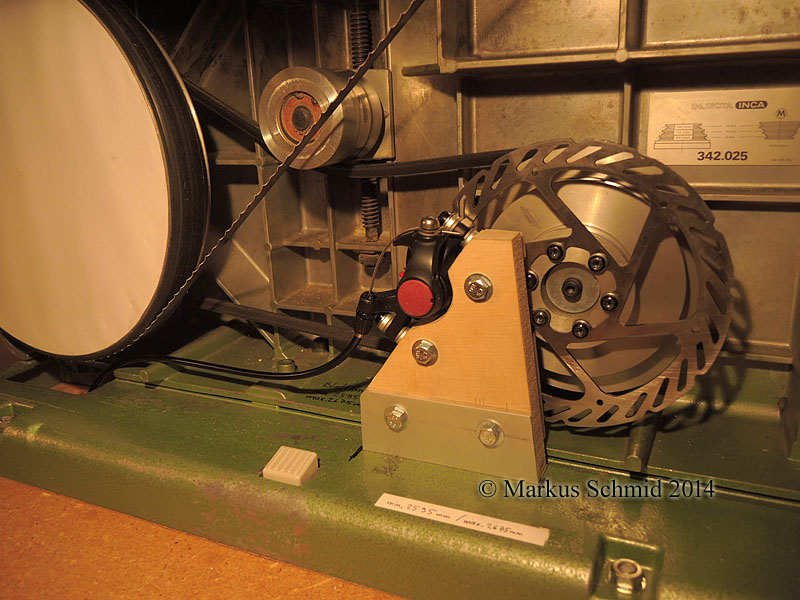

So I retrofitted the bandsaw with a foot-operated bicycle disk brake. When I step on the pedal a microswitch first cuts off power, which triggers the main switch off too. The foot one millimeter or so further down actual braking starts and the saw stops as fast as I want. Once I take foot pressure off the pedal the microswitch closes again, but as the saw's main switch is off

The pulley with the disk is spinning counter clockwise, so that the plywood support of the brake gets pushed against the bottom of the saw frame.

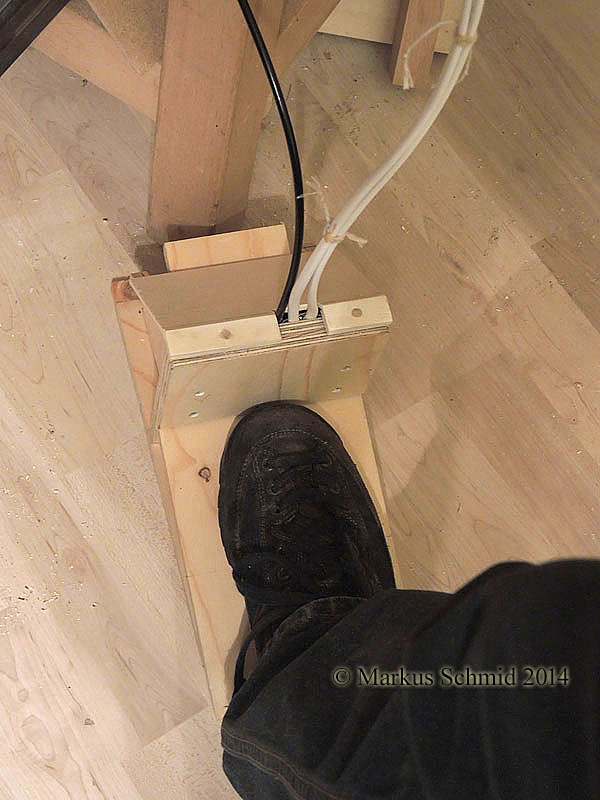

The foot pedal, obviously!

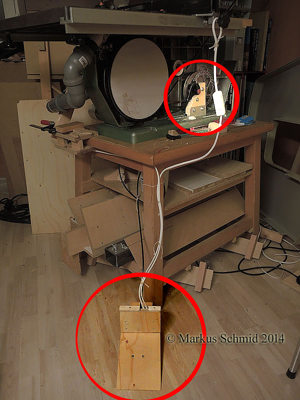

The whole "brake system" in one picture.
The white thing hanging down from the fence is an additional switch, which allows me to "unplug" the saw without actually pulling the plug. ;-)

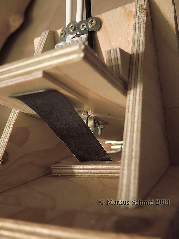

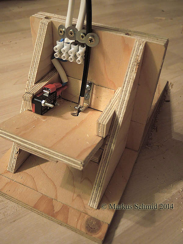

The innards 2: microswitch, electric and mechanical wiring.
The innards 1: in order to keep the microswitch closed without using the brake's business end spring I had to install a spring (a section of a de-toothed old saw blade) to the pedal.
