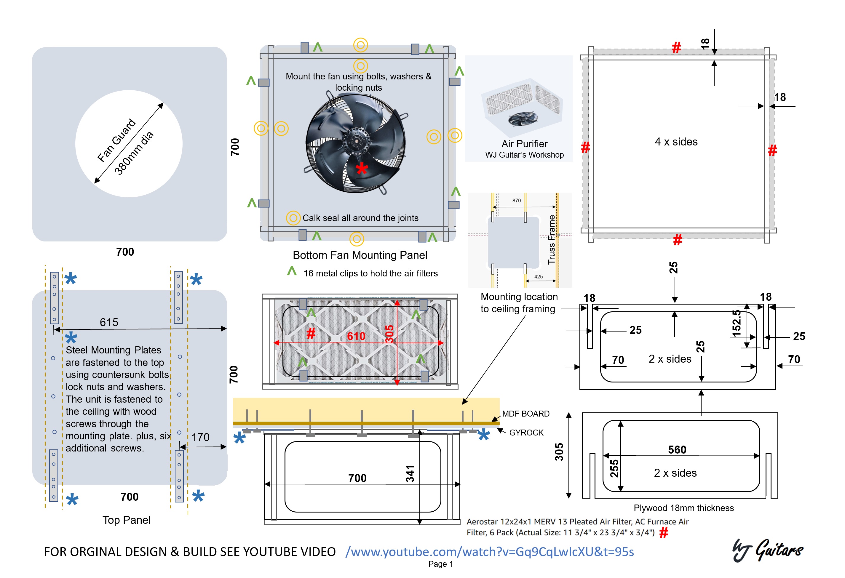

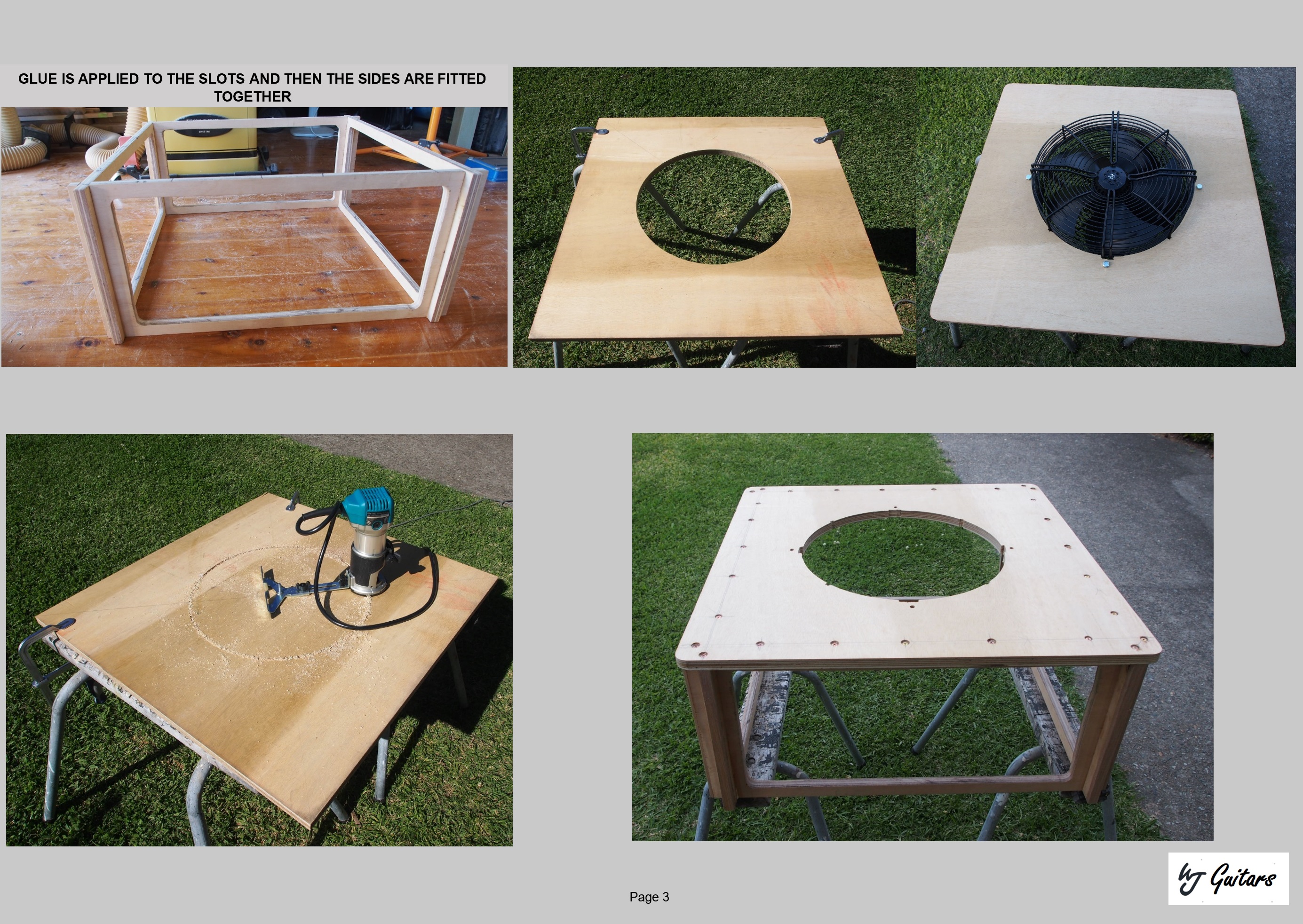

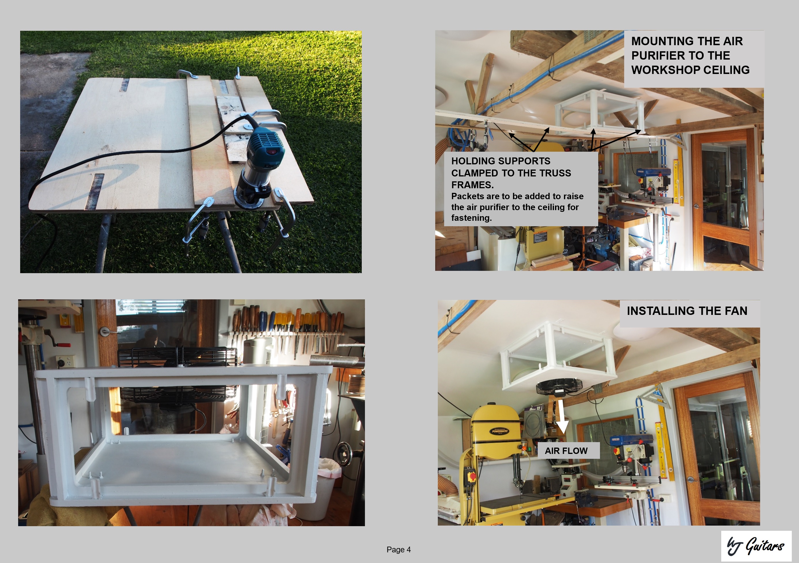

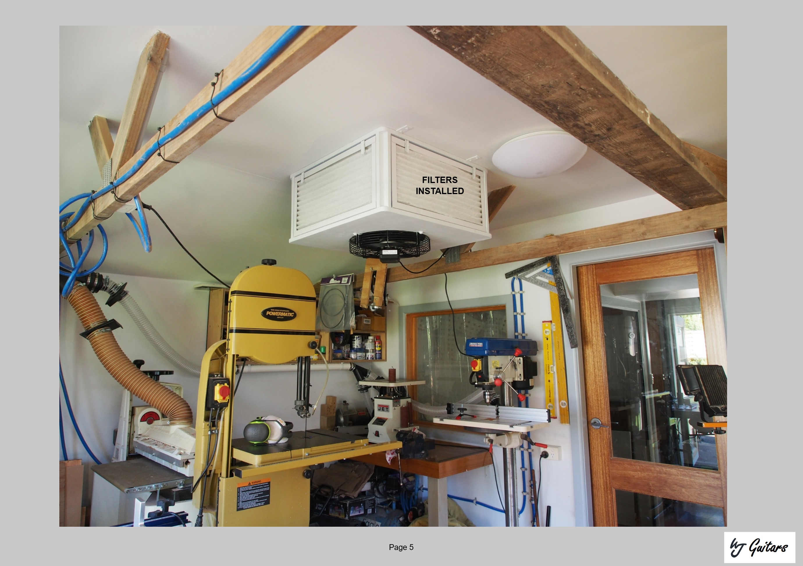

I decided to take some time out from my current guitar build and improve the level of dust extraction in the workshop by installing an Air Purifier on the ceiling. This has involved searching the internet for a DIY Air Purifier that I found and have constructed. See link below.
https://www.youtube.com/watch?v=Gq9CqLwIcXU&t=95s

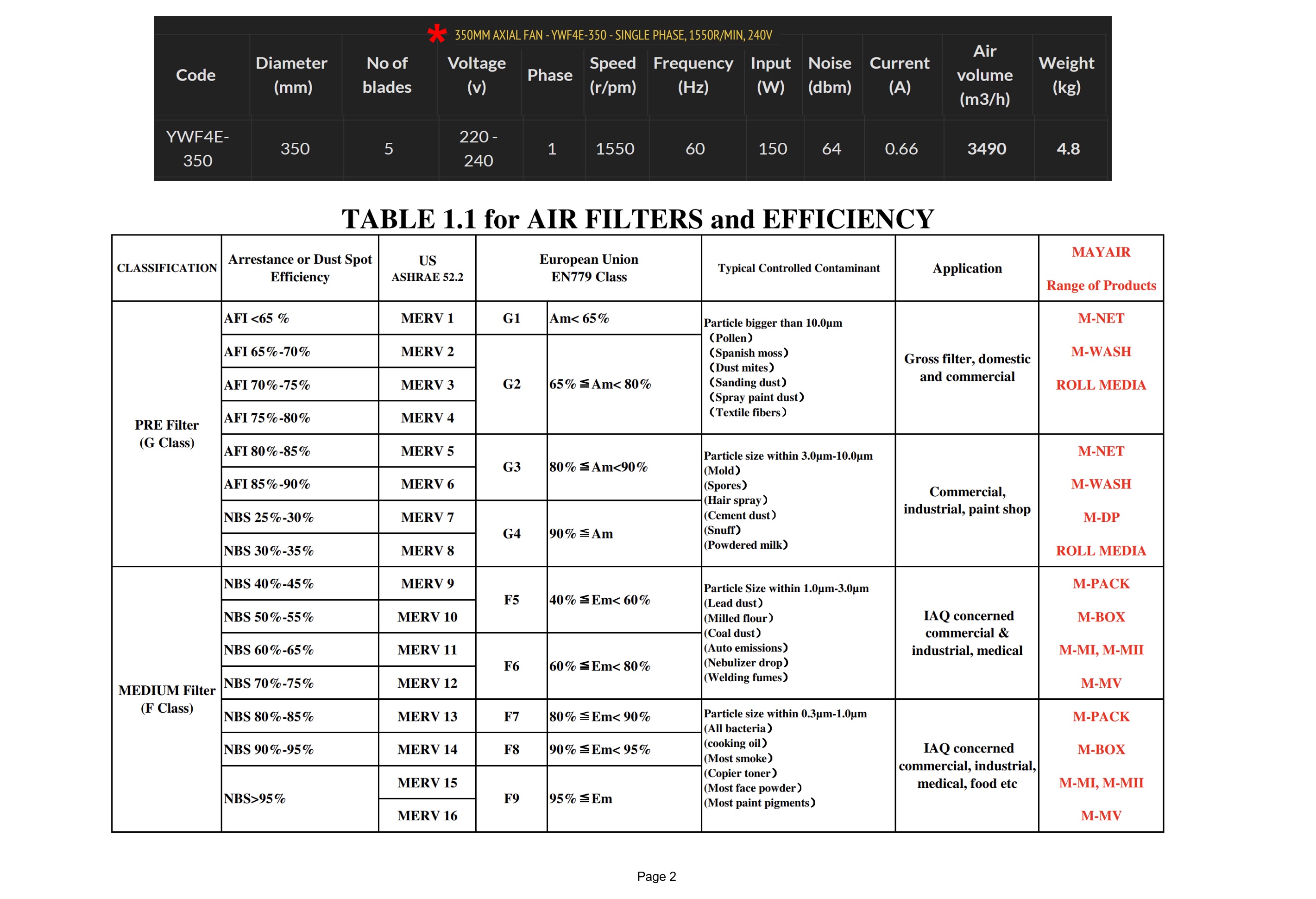

For my Air Purifier build I decided to purchase an efficient industrial fan and used ‘MERV 13’ Pleated Air Filters. See attached drawing, filter efficiency table and photos below. It is possible to make the Air Purifier large or small depending on the size of your workshop. There are a range of filter sizes available. The Air Purifier will work more efficiently when located more centrally in the room away from the wall corners and with the windows and doors closed. When using machines keep the Air Purifier running and continue running for around one and half to two hours once the machines are switched off.
At this stage I have purchased the filters and may consider in the future to make my own filters, as you can purchase the filter material in a roll and make your own frame. This would help to reduce the running costs when the filters require replacement.

Thanks Gaz for your comments. I am happy with my air purifier. So far I have found that 30 minutes running time is all that is required after machine work is finished. The exhaust fan is very efficient, however, it does not have any variable speed controls. I think if you want to run an air purify for long periods than having variable speed control would be an advantage. I also think that the fan's air volume 3490 (m3/h) efficiency is more than actually necessary for the air purifier to work. The domestic fan shown the youtube would still work ok. The fan that I installed being industrial should last a long time. Having the high efficiency factor means that I don't have to run the fan for extensive long periods.
If you decided to make your own air purifier make sure that you check out the range of filter types and sizes available, plus seal all the frame joints.
