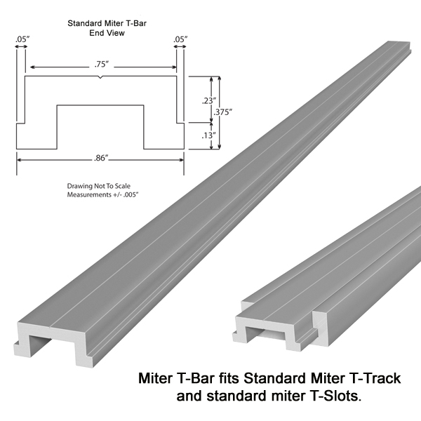

T-Track is sort of like duct tape - it has more uses than you can imagine.
Incra T-Track ($17.99 per 4 foot section)
Rockler T-Track ($19.99 per 4 foot section)
McMaster Carr T-Track ($9.94 per 4 foot section)
Because that was spread out, here's a recap of pricing from 2 popular brand names, plus McMaster Carr:
They are all extruded aluminum, and all appear to me to be the same dimensions. Looks like if you want a color anodized extrusion, you pay twice as much.
Kreg is another name in this arena, and their stuff is priced at the high end of the scale - my guess is that these guys all probably buy the same aluminum extrusions from the same metal extruder/fabricator.

Getting back on "track" so to speak, I notice that the Incra track looks to be the tallest with a deeper 'dust' recess at the base of the track. The sides are also relieved resulting in a strong looking "I" beam profile and the McMasters Carr product looks to be the same extrusion without the anodizing.
The Kreg track looks to be a different extrusion, it is more 'solid' form and the shallower T bolt head slot could be a good thing or a bad thing as far as binding and jamming during adjustment.
The track offered by Hartville looks to be different again with thinner walls. it is slotted on the outside of the profile and I imagine this would be to add strength. This may be a good thing but I suspect it is to compensate for a cheaper, softer, alloy used in it's construction.
To me the tensile strength of the alloy would need to be a major consideration in this application. So aside from the anodizing, that may be why you pay a premium for both the Incra and the Kreg products. With that in mind, it looks like the McMasters Carr product offers the best bang for your buck but I would like to do a flex test to compare the tensile strength of the Incra product against that offered by MC before i could be firm on that.
