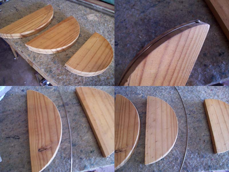

Post by DarwinStrings » Fri Oct 22, 2010 1:00 pm
I thought I should re-post this one as I find it useful and cheap. The photos tell the story, you just have to work out a radius for the jig that suits your fret radius, it will be smaller that the radius you want to end up with in your wire. Make the slot just wide enough not to bind on the wire dogs.
