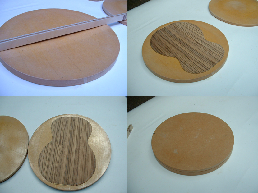

I have been experimenting with veneer uke back press into a radius. Here are some pics of the jig I used.
Back press
It’s a two part mould, positive and a negative. I used 3 veneers and the centre one is cross grain (like ply) and Urea-formaldehyde resin to glue them. The thickenss is 1.6mm thick.
